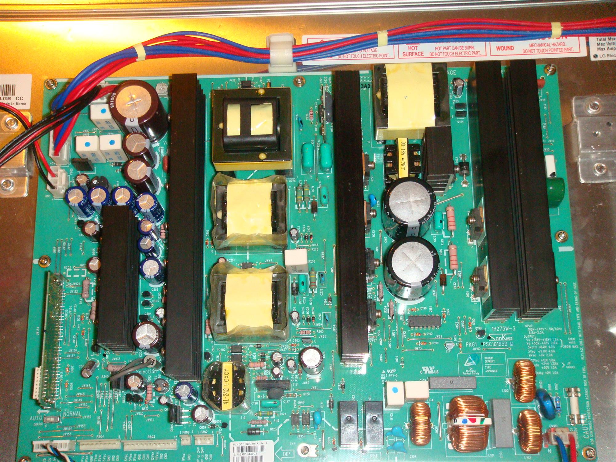

    I've done a bunch of forum reading and have a similar story as often posted: I got a Vizio model P42HDTV10A 42" plasma for free from a friend. No picture (either from any source or a startup screen) and no sound. TV has an orange led when on standby, turns green when powered on. Can not be turned off other than by pulling the power cord.
    I can solder, desolder, can read a circuit diagram and work a multi meter so I thought I'd make a project out of getting it to work. That being said, this is my first experience inside a TV. Hopefully with all your help I can get it going again, or at least determine its worth more as a dumpster filler than as an actual TV.
    I have a few extra boards that came with it. I have downloaded the service manual (though some pages are missing) and done the following things so far:
    -Visually looked for bad caps. I don't see any, but again, I'm new at this.
    -Turn TV on, hear relay click.
    -Tested power in to the main and sub power boards, 118v. Seems good.
    -The sub power board outputs 5v and 12v to the main board, again seems as it should.
    -The main power board has some funkier outputs. The output values as printed on the board are shown in the pic below.
    http://www.jerseylooker.com/random/B...e/IMG_0740.jpg
    For readings from the output of the main power board I get:
    To the main video input board:
    RLY ON - 6.1v
    Vs ON - 6.1v
    To the X and Y sus boards:
    +5v: 10.4v
    Va: 151.5v
    Vs: 410v
    The outputs to the X and Y boards are about twice what they should be. What should I look at/for next? I can provide pictures of anything needed. Some preliminary ones of the main power board below:

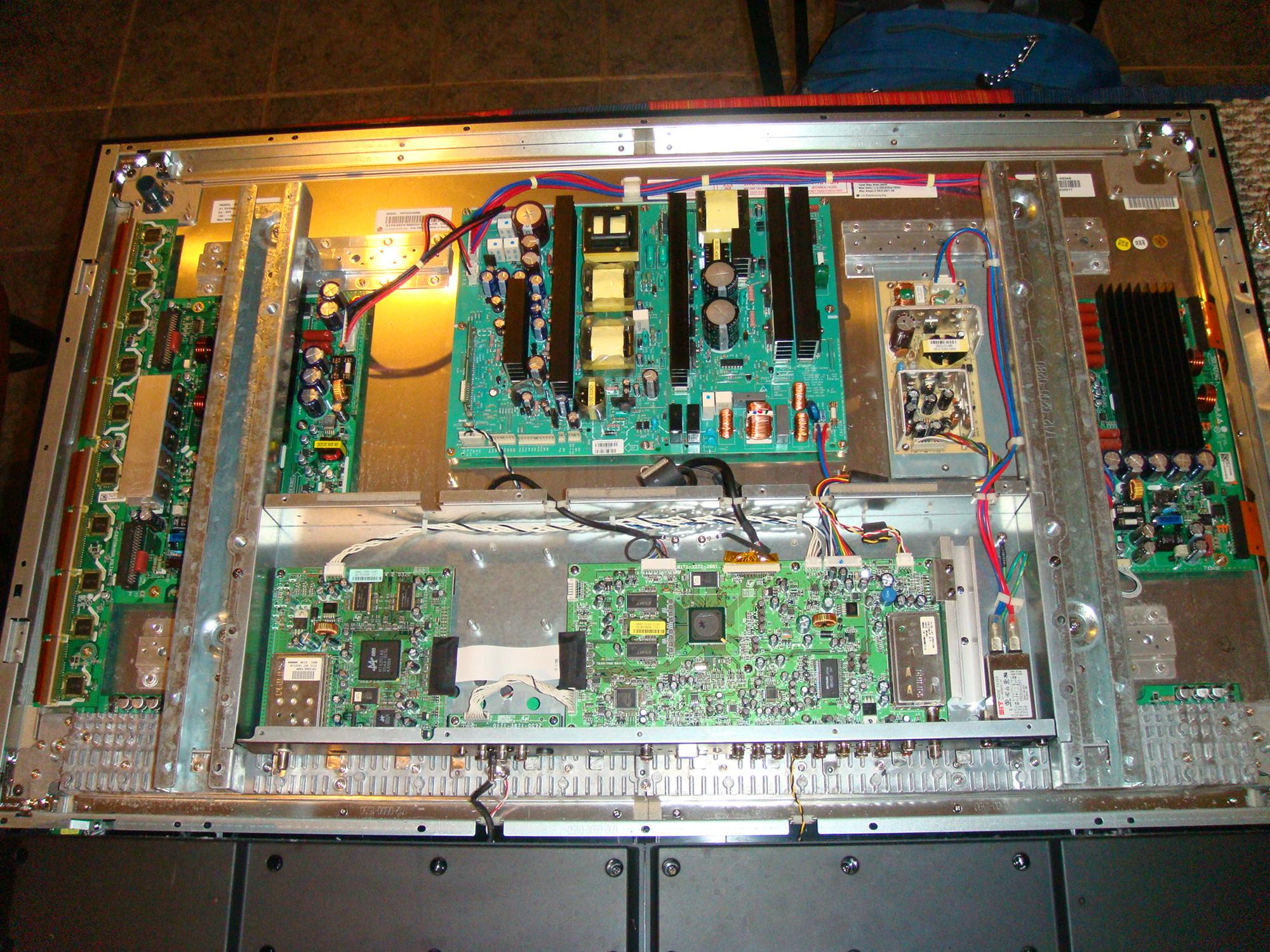

    Let's cover the basics.
    1. For a number of reasons pictures should be hosted on this site. Use 'Manage Attachments' - below the text entry area. I suggest a minimum of 1000 x 1000 pixels. The site limit is 2000 pixels in either dimention.
    2. Quality is more important than quality. Let's start with only three pictures. One should be an over-all shot of the back of the TV (cover removed, of course), the second a similar shot covering the power supply, and the third a single shot of the 'main board' - the board with the input connectors.
    3. Detail is important - we can get a log of information from a sharp, well lit picture from directly overhead. A blurry one shot under dim light doesn't do much good (neither does a reflection of the camera flash covering a large part of the board).

      You know, in all the forums I frequently post on, it drives me nuts when people don't use the forum to host pictures for threads; so I have no Idea why I didn't do that here! Sorry!
      In any case, attached are 3 pics. If they are not good enough, let me know.

        OK, I'll be serious. First of all, this is based on an LG panel. The sustains are notorious for shorted hybrids. However, the symptoms are not consistent with that problem. Let's try one thing. Black / blue / red cables run from the upper left corner of the power supply to the sustain boards. Disconnect them, then see if the TV can be turned on and off with the power button.
        Next, on the back of the plasma panel is a white label with the voltages the panel requires listed. Still with the cables disconnected, check those voltages. A quick alignment guide for the panel can be found here.
        I am REALLY concerned about the unusual voltages you are seeing. What did you use as the ground point?

          PlainBIll, thanks for your replies!
          I'm using board mounting screw heads as ground points. Generally either the one on the bottom middle of the main power board, or the one below that, that only holds down a ground wire. I try other random ones as well to confirm my readings.
          Also, I ran to the shop and got my decent meter instead of the crappy harbor freight one I keep at home. I think it may be busted or I was on some wrong setting when I tested prior.
          I pulled all three connectors in the upper left that go to the sus boards (but did not disconnect the one in the lower left that goes to the main board). I can again turn on the TV (have the green led on front come on anyway) but still can not turn it off.

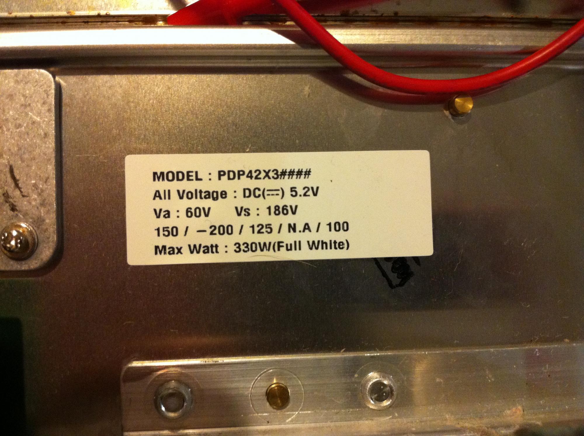

          Below is the panel voltage sticker (not hi-res, guessing its ok for this one). With the cables still disconnected, and after alignment I get 60v and 186v coming out of the main board. Seems good there. If I connect the Y and X boards, I get nothing out of the main power board (the relay clicks as if turning off). If I connect just the X board, I get the proper 60v and 186v out of the main board, and the proper 100v on the Xsus board (after alignment). So, I'm thinking something funky with the Ysus?

            Good work. Yes, the problem is the Y-sustain, and probably the hybrid (under the large heat sink).
            Here's the problem - I have a fair amount of experience with this panel. Replacing the Y sustain is a pain, but doable. Replacing the hybrid is a major task. On an LG TV you would have one of two possible problems - either the TV would shut down by itself, or you would have a 'sound with no picture' problem.

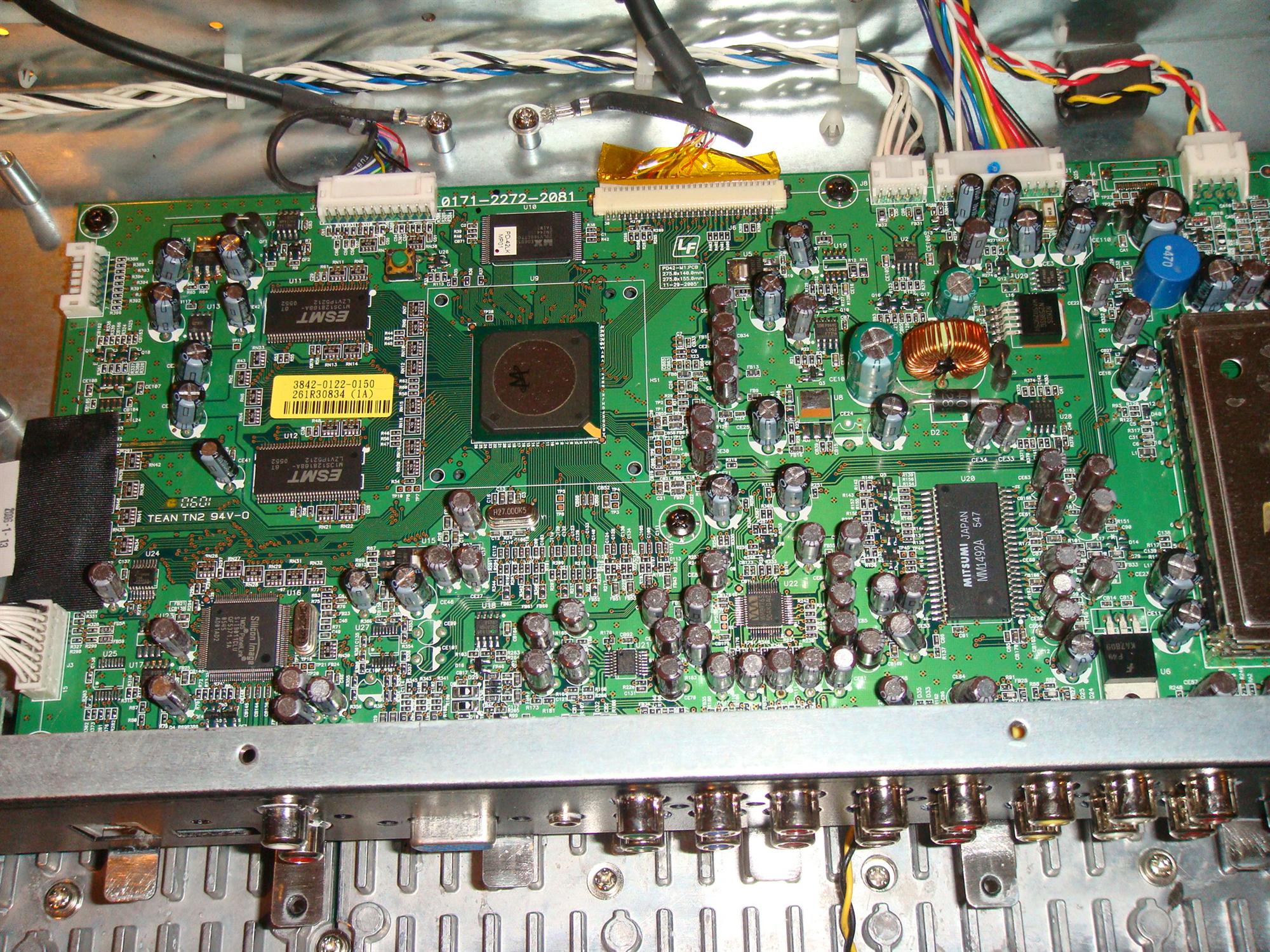

            Some models of Vizio main boards have the 'turns on, but won't turn off' problem; that is a bad U33; I don't see a U33 on this board. And that leads to the fact that unrelated failures on different boards is very unusual.
            PlainBill
            • MattC
              • Aug 2011
              • 10
              Re: Vizio P42HDTV10A: no picture, no sound
              So then tonight, out comes the Ysus board! Looks like online/eBay replacements are not terribly expensive for a full board. My soldering skills are average, so I'd probably cook the board trying to replace the hybrid.
              Yea, I saw U33 mentioned in some other threads. I couldn't find it either. Worst case, if the main was bad too, I have an extra for this thing I can swap in.
              Stay tuned, I'll let you know how things go with the Ysus.
