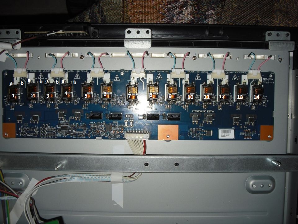

    The results still don't make any sense, but you did clear up one thing. Your DMM shows a '1' at the left side of the display to indicate the signal is over range. Also, the meter is set on the correct range for the test.
    To clarify things, I've marked up a picture of the inverter. The transformers are numbered 1 - 14. I've labeled the terminals at the top with the letters a and b. With the meter set to the 2000 ohm range, measure the resistance from 'a' to 'b' on each transformer. Don't mess around with marking up a picture, just make a list with two columns - transformer number, resistance. And show all digits of the resistance reading.
    It is very unlikely the resistance of more than one transformer would be over range. If that happens, switch to the 20K range and recheck.

      If I'm doing something wrong please let me know but as pictured i'm still getting the same results on all except the ones I pointed out earlier that just read 1 .

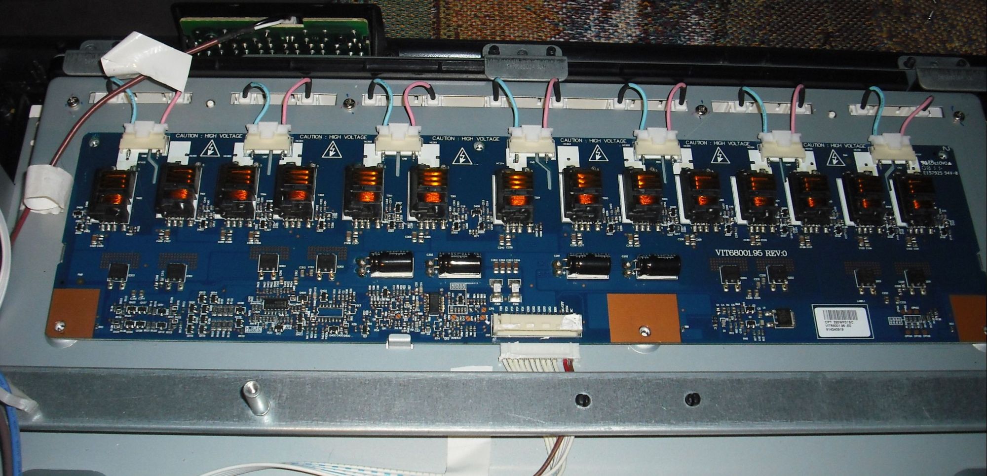

            Next, there aren't any really good pictures of the inverter. Could you take several, including one really good one of the area where the power and control cable connects.
            Have you checked the fuses?
            Are there any numbers on the transformers?

                      From pin 1 - p2=1, p3=002, p4=1, p5=1, p6=1
                      From pin 2 - p3=1 p4=1, p5=1, p6=1
                      From pin 3 - p4=1, p5=1, p6=1
                      From pin 4 - p5=975, p6=972
                      From pin 5 - p6=002

                        All right!!! Nothing like giving you the wrong pins to measure.
                        Set the DMM on the 2000 ohms range and measure from P4 to P5 on each transformer and report the numbers. All readings should match to within 3% (about 29 ohms). You are hoping to find one outlier.

                          Is there suppose to be a decimal somewhere? If looking at the previous inverter picture....from left to right. Tested p4 to p5 on each transformer.
                          @2000ohm setting - 970,987,989,989,982,982,988,997,980,985,986,994,999,973.

                            Interesting - you get a range of 970 to 999 ohms, almost exactly 3%. What's more, that's a pretty consistent range of values. I would have to say those transformers are good.
                            Now we are left with the mystery of why the backlights don't come on.

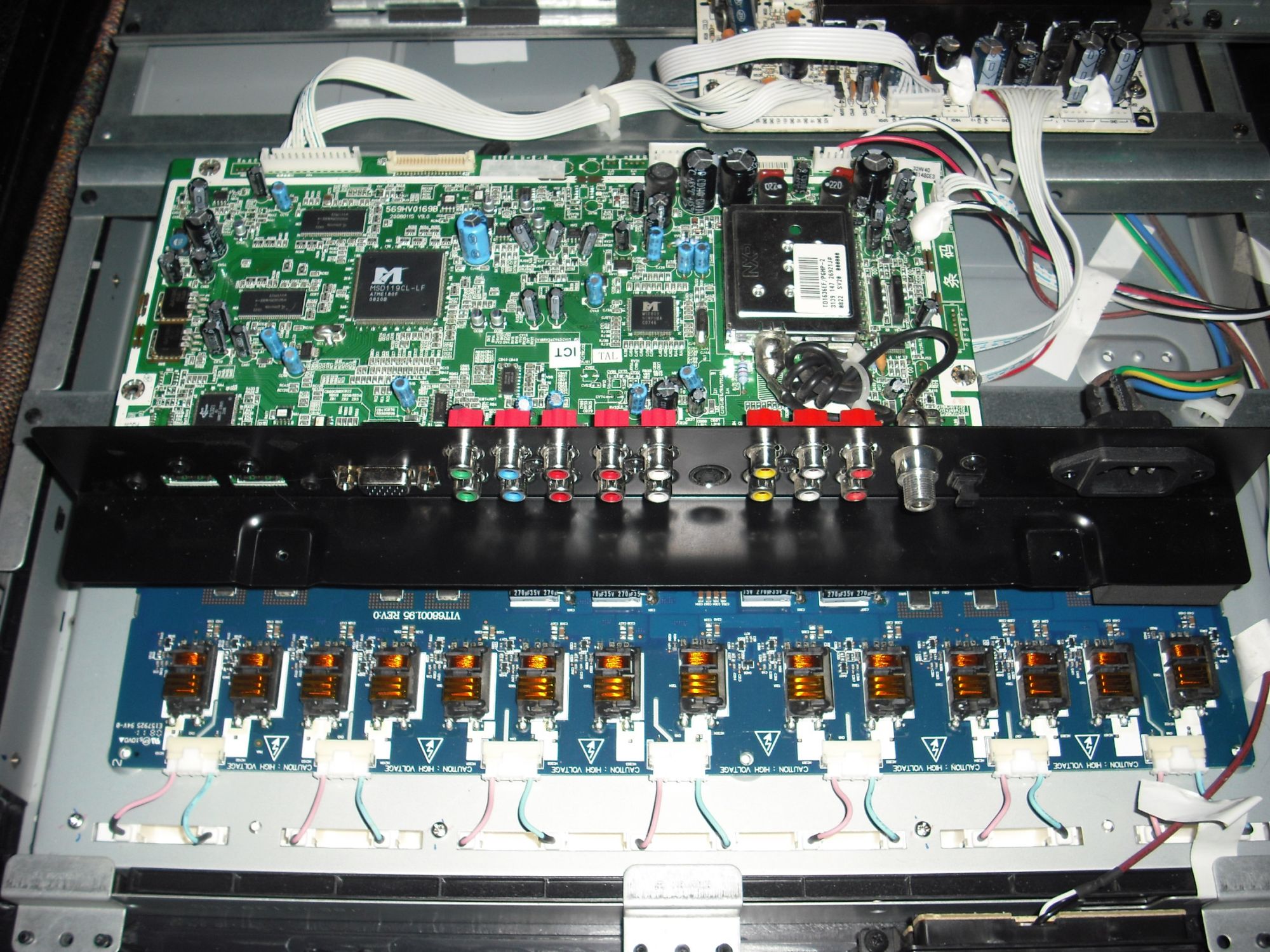

                              The problem I was having with the inverter was when the inside of the TV was put together, the Mainboard sits OVER the inverter....covering the half with the power connector. So when tom66 was trying to help me, I had to keep removing this board and that board in order to test.....then put it all together again to test something on the power board. Most tests came back ok. As far as checking for a quick flash when powering on....I think I tried that already and saw nothing, but i'll try again tonight when it gets dark, and I turn off all the lights.
                              EDIT: Something else....I can't remove the metal cover for the T-Con Board without tearing down the whole panel as it looks like the cover has a lip that goes from over the board to under the panel...after taking out the screws it will lift up a little but won't come out.

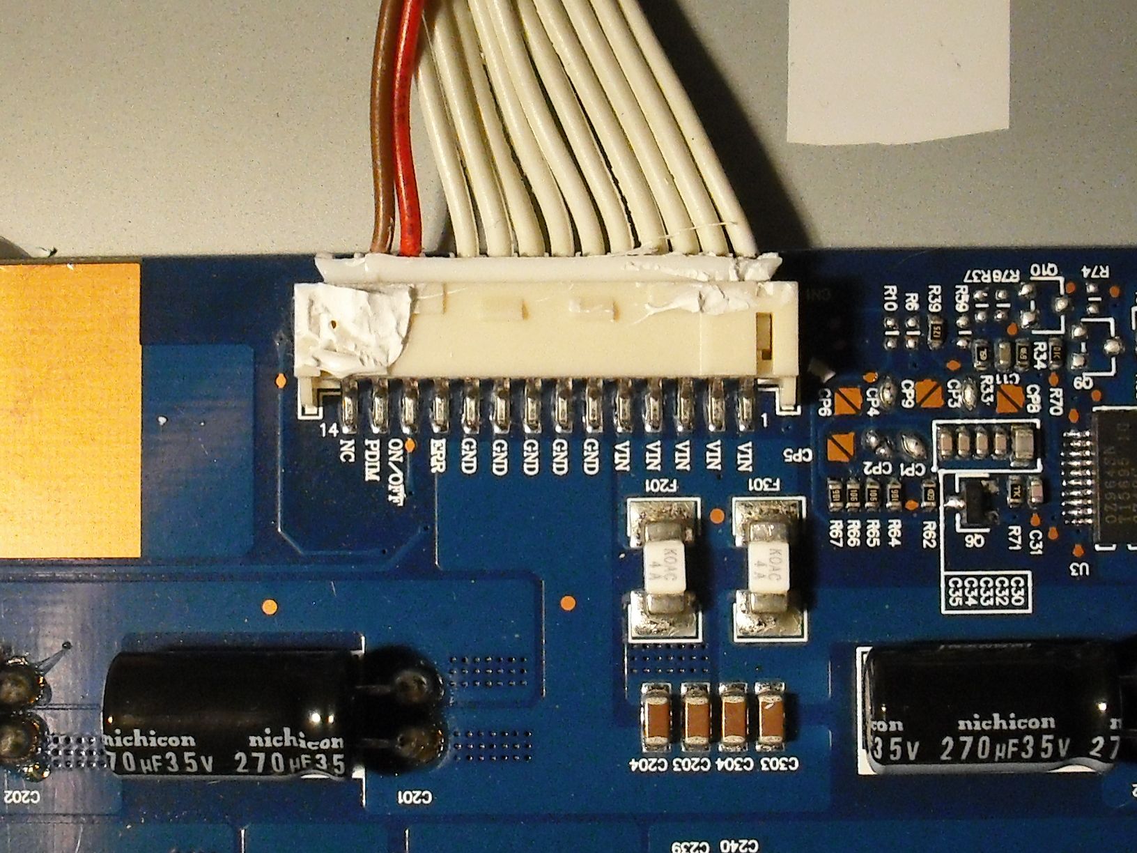

                                    I can't remember, did you check the INV_ON pin when trying to turn the TV on?
