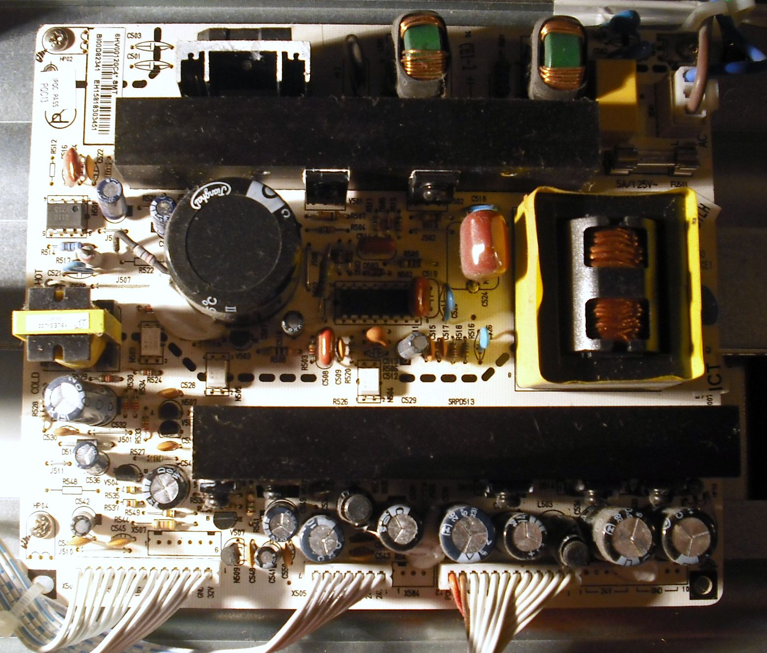

    So I picked up yet another freebie today (Dynex DX-LCD32) blue power light comes on, I get sound but no picture, I see nothing using the flashlight trick. No swollen caps, checked the voltages on all 3 connectors as shown on the first picture...from left to right:
    1. 5.0v
    2. 0.00
    3. 0.00
    Now what? Did I do something wrong?

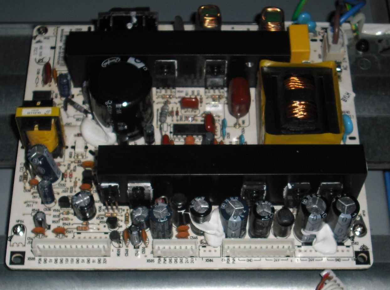

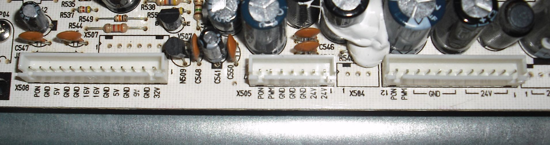

      So I tested the power supply again and here's what I got on the first connector on the left as pictured above:
      32v = Travels from 31.6 - 32.2v
      9v = 0
      5v = 0
      16v = 0
      5v (next to PON)= 5.1v
      The other two 24v connectors are reading 24.2v
      What next?

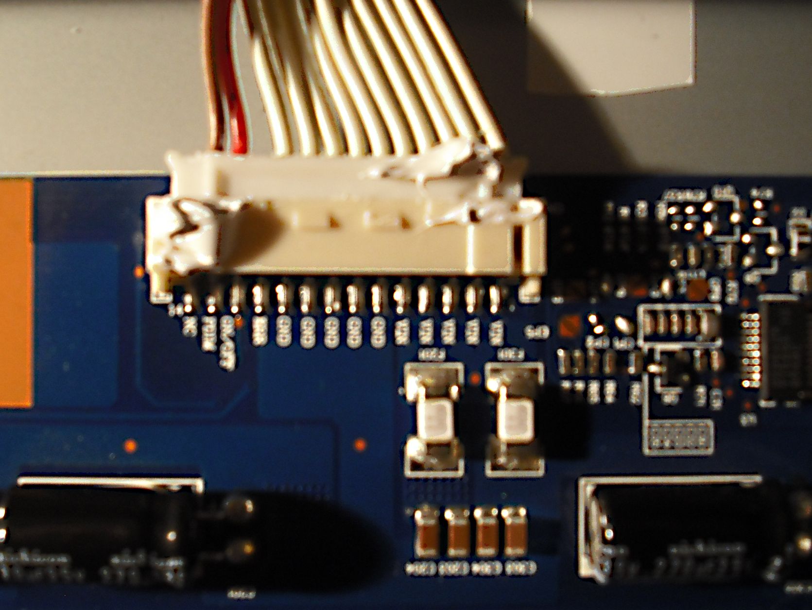

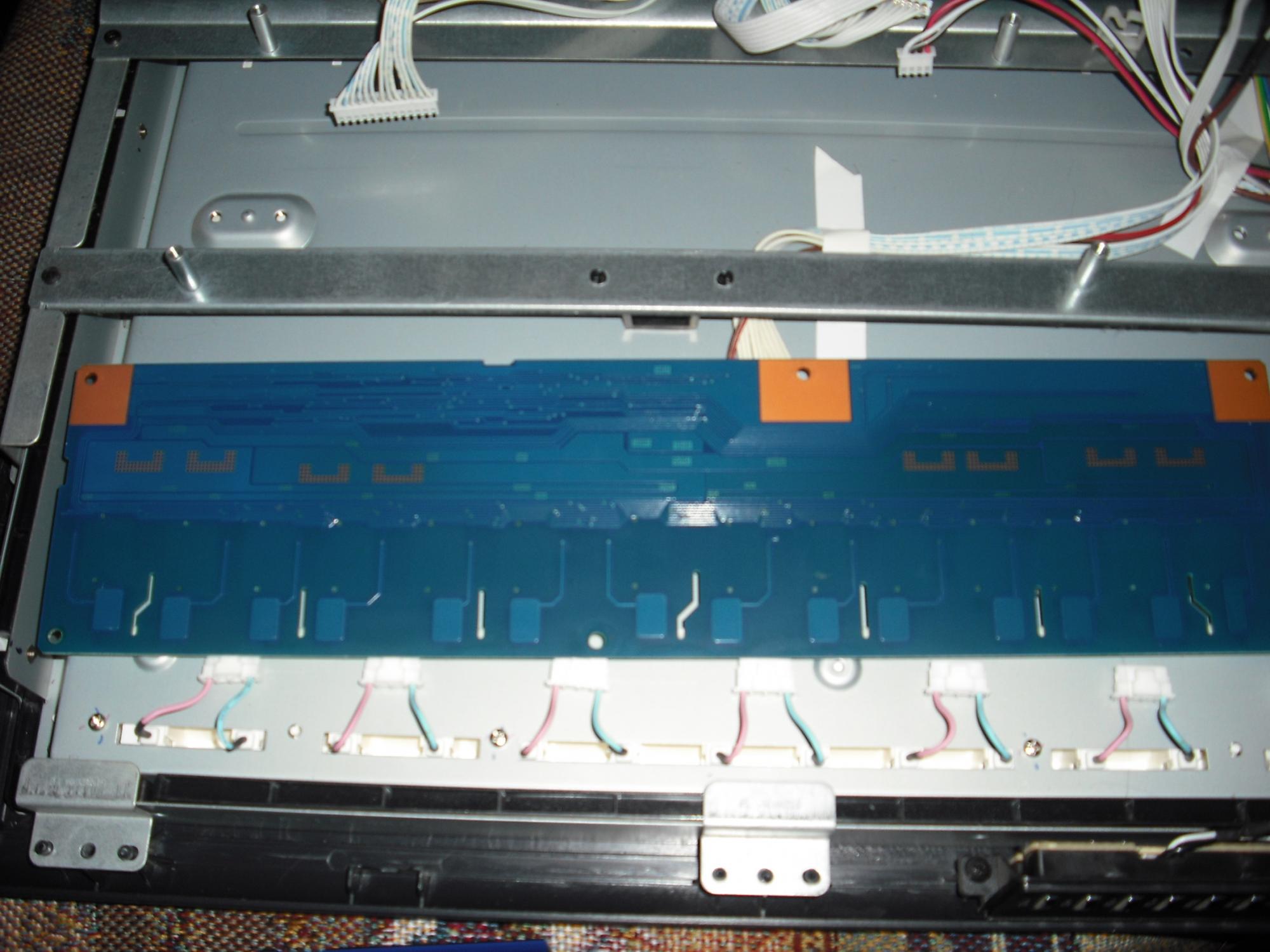

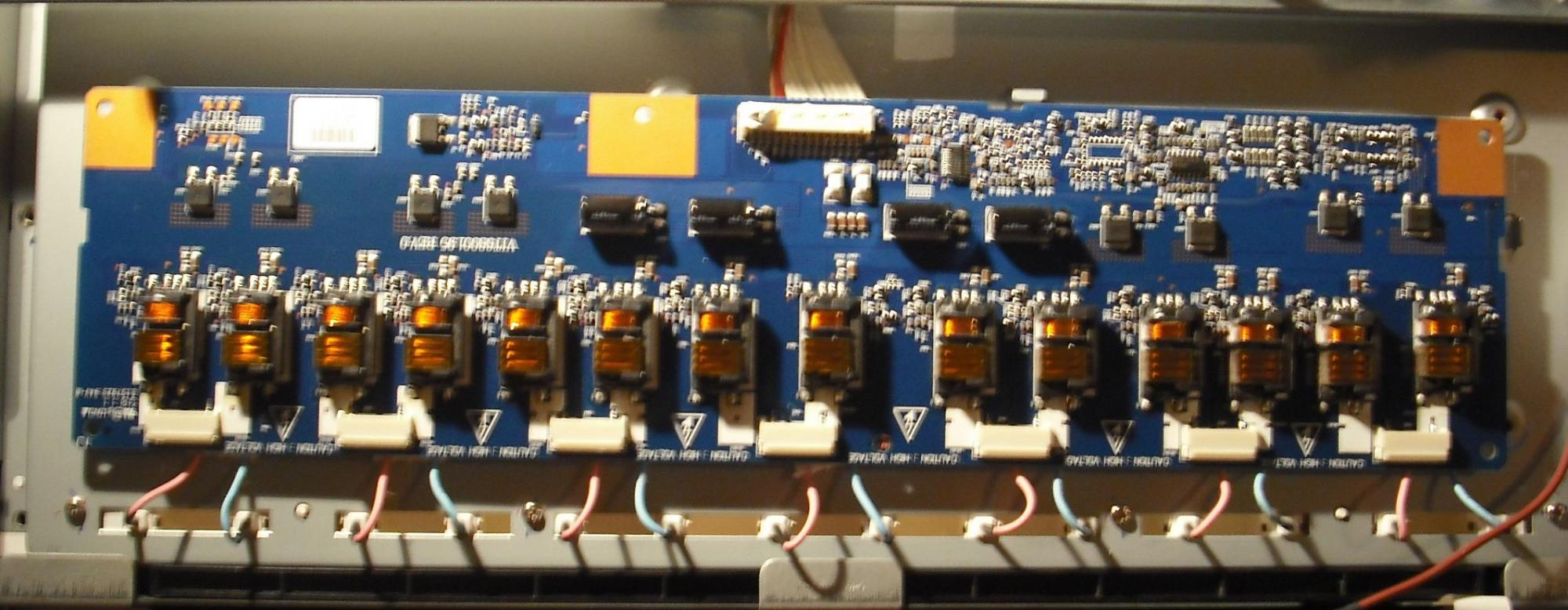

            Hmm. Can you post a close up shot of both the top and bottom of the inverter where the connector fits on the board - clear and focused. It's usually easy to see the power and ground connections... not so easy for the ON/OFF, DIM, ERROR etc. pins which go to various parts of the board.

              Sorry but this was the best I could do for now as the battery on my camera went dead just as I was snapping pictures. In case you're wondering there is nothing printed behind the connector....and as you can see, there is no bottom side to the inverter board....everything looks to be surface mounted.
                Re: Dynex DX-LCD32-09 Sound but no Picture
                I can quite clearly see text next to the connector which says "GND" and "VIN", as well as others, although I can't read them well.
                There are two fuses, the white objects right next to the connector.
                Using your multimeter, test the fuses for continuity.
                Set your meter to the 200 ohm range. Touch the leads together, and record the measurement, it will be around 1 ohm. Then, touch the leads to each fuse; record the value, and subtract the previously measured lead resistance, and post your results. You should get fuse resistances of less than 2 ohms, otherwise they have failed and need to be replaced, after determining why they have failed. (DO NOT bridge the fuses with wire - you must first find out why they have blown, if they have blown.)
                Also, check the voltage going to the inverter pins. Test the voltage on each fuse, on the end closest to the connector. Place negative lead on some metal part of the case. Place positive lead on each fuse positive. Record and post results.

                  I tested the fuses and got .09 on both. As far as testing voltages on the inverter.....stupid question here, the mainboard covers up the inverter board when put back together....how can I test the voltages without screwing the mainboard back in place and without causing a short?
                    Test the voltages on the PSU board, which is connected to the inverter.

                          I cannot check them on the main board....the connector that says ERR,DIM,etc. is on the inverter board and the other end of that cable goe's to the power supply that you had me check....24.2v. The connector on the power supply that supplies power to the mainboard is where I was having trouble.
                          32v = traveling between 31.6 and 32.2v
                          9v = 0
                          5v = 0
                          16v= 0
                          5v next to Pon=5.1

                            Don't the connectors on the inverter board go to the PSU? Measure the corresponding pins. I might be missing something here, so let me know if I'm being stupid.

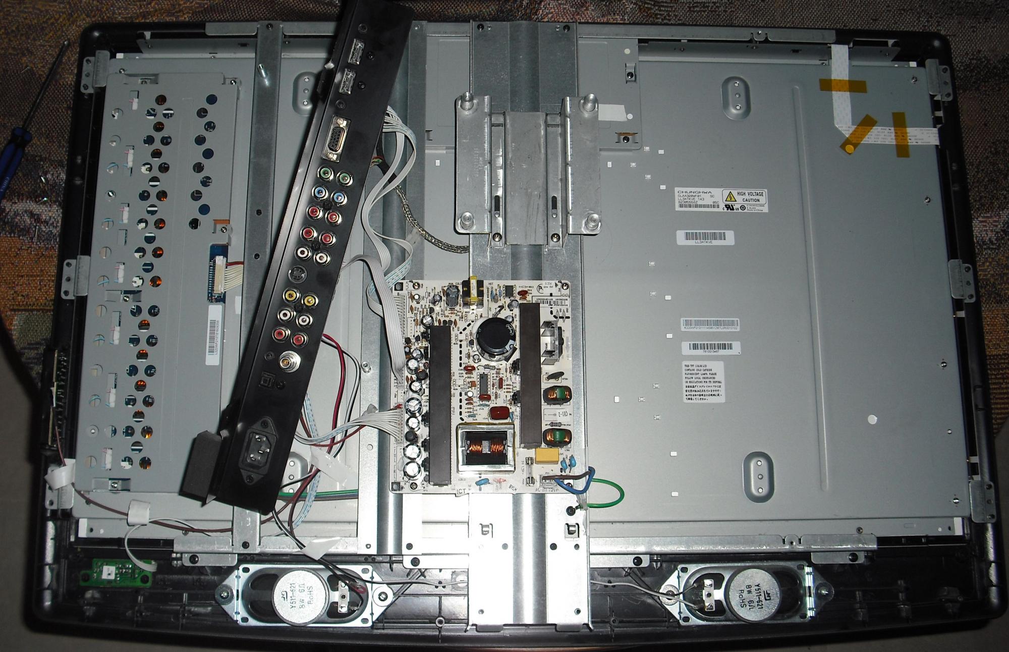

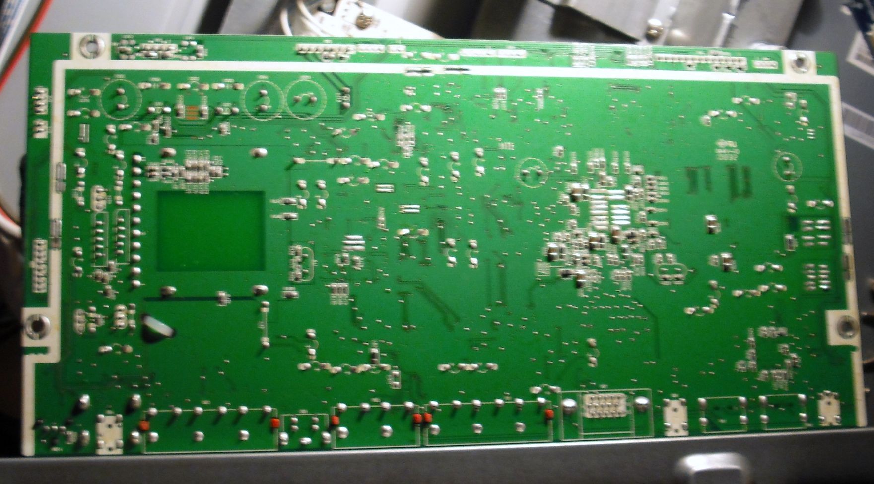

                              Maybe i'm the one missing something....if you go back to the top of page (First Post) and open the first picture on the left, you'll see 3 sets of connectors on the power supply....the one on the far right is the one going to the inverter board....that's the one that tested 24.2v

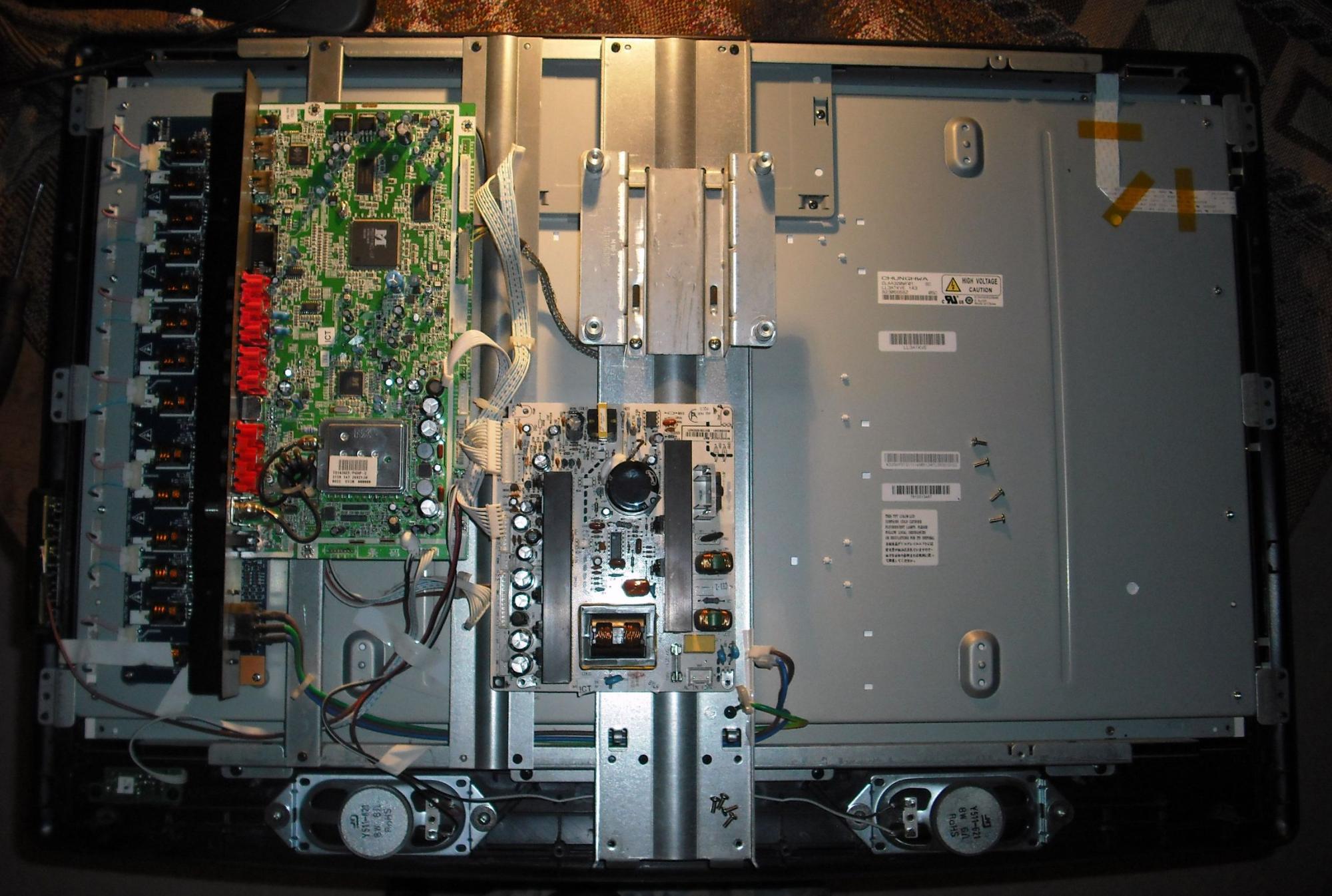

                                Can you post an overall shot of your TV? I need to see the layout.
                                The DIM, ON/OFF etc. wires must go somewhere, so try and trace them; do they go straight to the main board, or to the PSU, or to somewhere else entirely? (In one case, I had the wires going to the Tcon... which is odd, to say the least.)

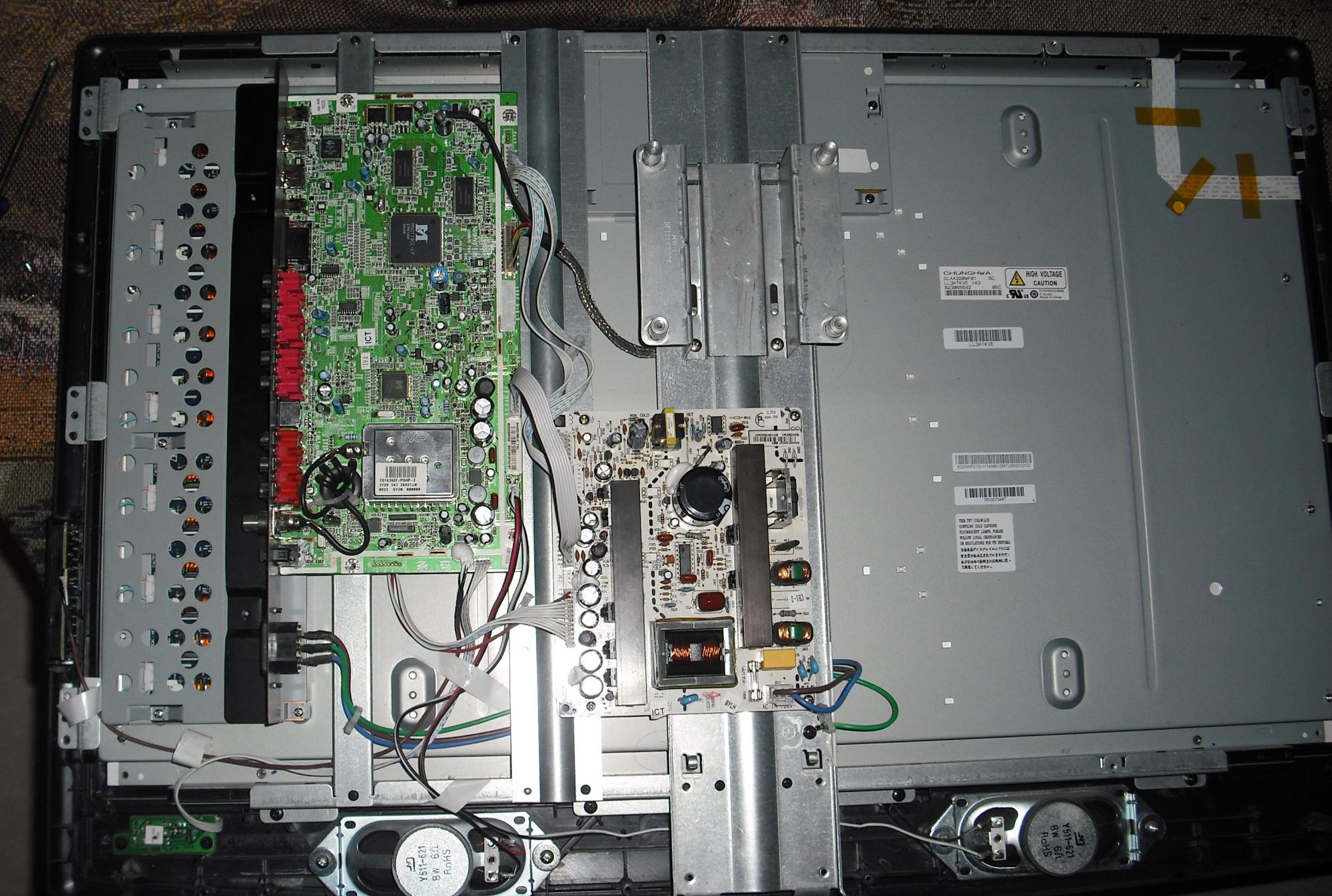

                                  I think i'm the one confusing you! The first pic is the overall shot - the second pic is with the mainboard lifted up so you can see the cable going from the psu to the inverter. You had it right.....the connector with DIM, ON/OFF is the one on the inverter board end.....the other end goes to the 24v power supply connector. I'm assuming i'm not doing a very good job explaining myself.....or maybe i'm not understanding what you're asking me? I was forced out of bed 3 hours earlier than usual and i'm tired! LOL
                                    Yes, the wire goes from the inverter and goes to the PSU. It should be possible to trace each one and find out where they go to the PSU connector. It's also possible the cable will split, and some will go to the main board. Either way we need to see if the inverter is actually being told to come on (the main board here being a problem if it is not), or if the inverter itself is faulty (or if the CCFL tubes are faulty.)
