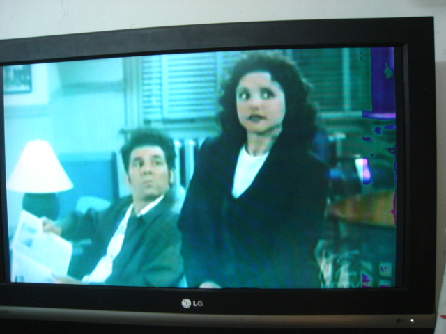

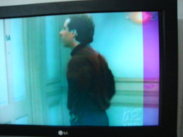

    LG 32" lcd tv
    i have uploaded 2 pictures, 1- showing when the background color is white or light the tint is fully visible and 2- when the bg is dark or black then the tint goes away...on a completely black screen the tint is not visible
    i bought it like this because it was cheap and as i don't watch much tv i didn't mind changing it to 4:3, which does not cover the tinted area of the screen... the previous owner said it was like this for about a year...
    i have some free time and i was wondering if this is fixable...anyone have any ideas?
    any help would be appreciated

    Bad driver on the flex conductor in the LCD panel. Unrepairable unless you have the specialized (expensive) equipment.

        looks like the panel is going bad, although i would unplug and reconnect all connectors including the tcon cable.
        the other issues, im willing to bet thats another issue. this set may ot be worth your time and money to fix...
