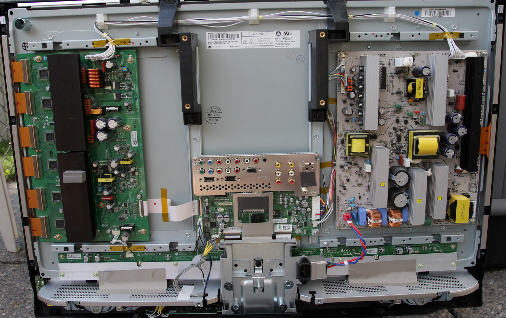

    Hi all, been busy haven't been on here much. But I thought I'd scrap what I should be doing and have a go at a plasma TV
    Got this not too old Plasma from a business associate, who got it and a dead monitor from a client. The story as I remember it, the owner called service as it was under warranty, tech came, said it needed a main board, called it in and someone (store, warranty company, LG?) said they'll replace the set.
    He got a new one, and got to keep the dead one.
    So, plug it in, turn it on green light flashes for 9-15 seconds or so then goes red.
    This is my first plasma, so I'll be in n00b mode

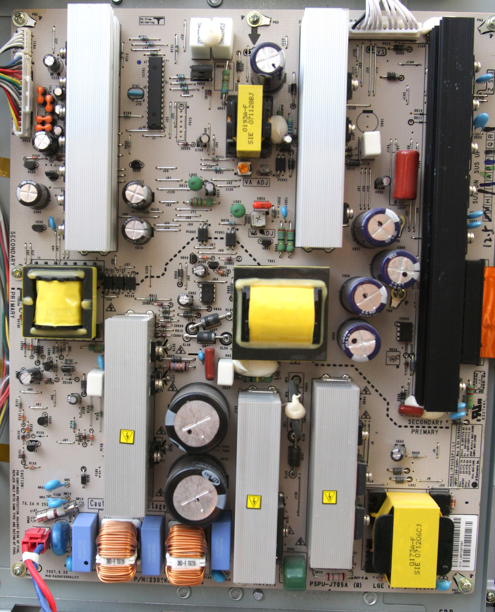

    5vsb is fine. 5v on the connector that goes to the YSUS board is 5v for a few seconds every so many power on attempts, but never for long, otherwise it's .8v or less. If I unplug the YSUS, it goes green and 5v is 4.9ish steady. The 2 5V pins on the cable that goes to the Ysus measure 1.something megohms to ground, so doesn't seem shorted.
    With the YSUS disconnected and the TV powered on, the Power supply will light both elements of an 1157 bulb which draws a measured 1.5ishA on the 5V out to YSUS connector. Not a great test but all I had this evening.
    How much load should I put on the PS to test?
    Now, what confuses me is ZSUS. There's no board marked as such, but there are 3 pins on the top right connector on the power supply labelled zsus, and there is a ribbon cable coming out of the power supply board to the panel.
    So is this board also a ZSUS, or am I missing something?
    I'll try to get better photos when I can set it up in some light.

    OK, it looks like they have combined the power supply and the Z-Sustain. The main board and the main logic board also seem to have been combined.
    The symptoms would seem to indicate a problem with the Y-sustain, while the history would indicate the main board. Of course, the history is hearsay. I have a couple of suggestions. the first is simple and should be safe. Hook up a signal source (one that includes sound) and step through the inputs until you hear the sound. The service manual is on Elektrotanya, but it's REALLY short.
    PlainBill

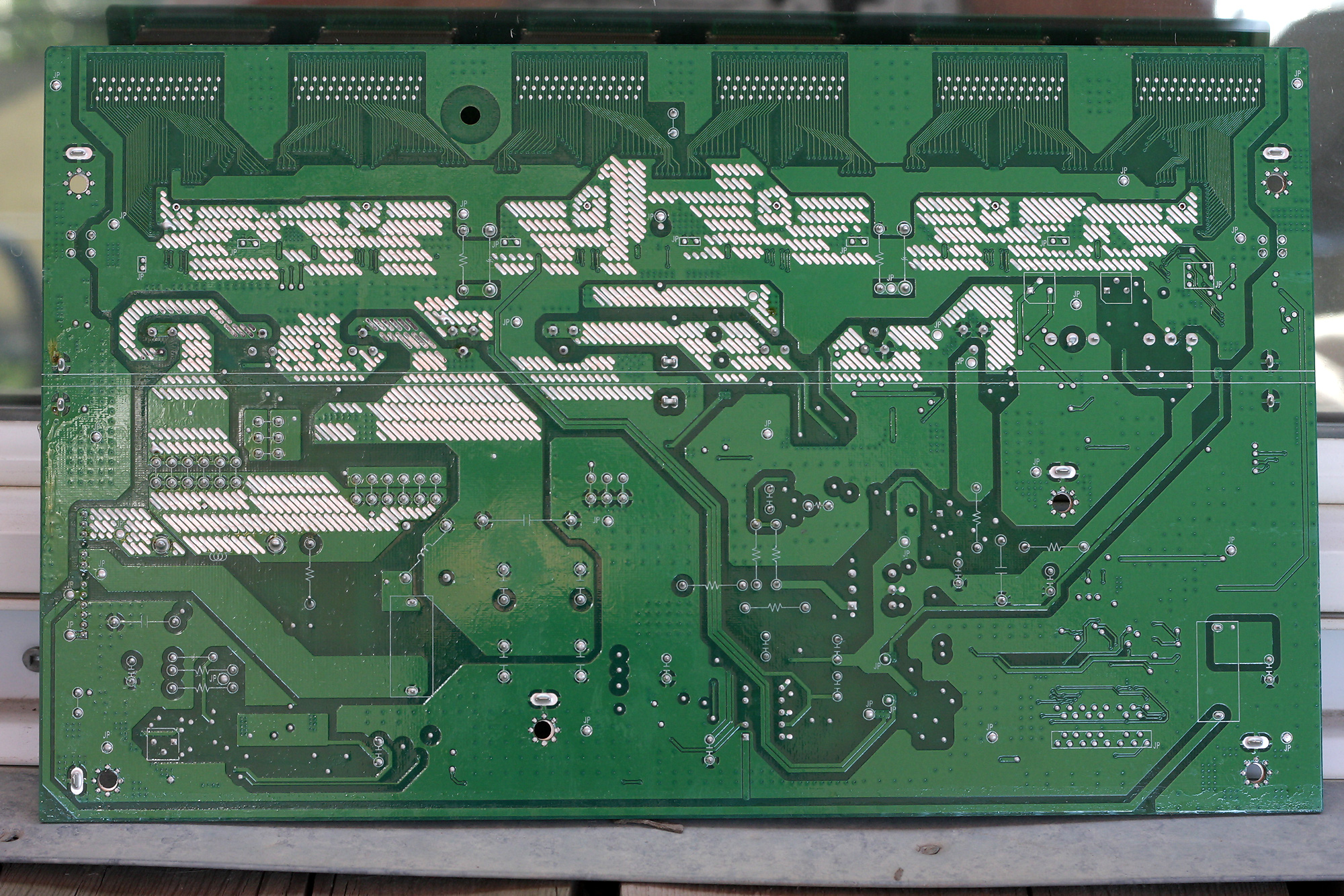

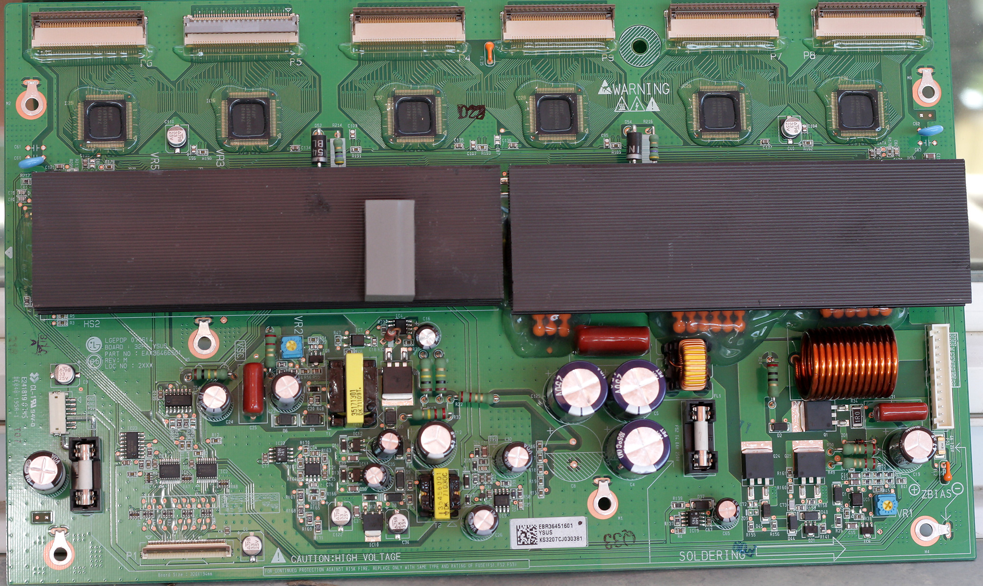

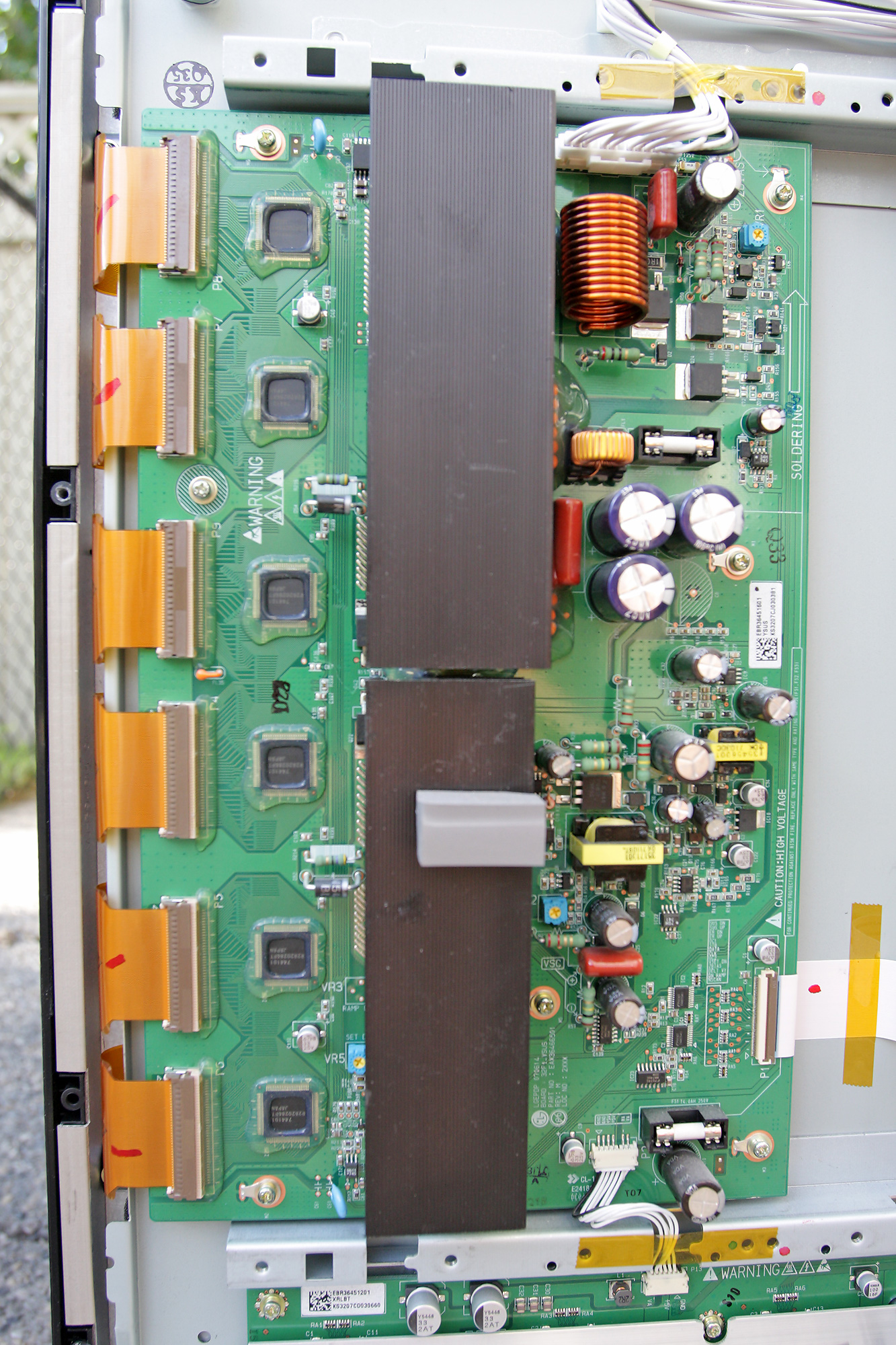

          Removed YSUS and had a good look at it. I'm assuming the buffers are on this board (remember this is my first Plasma) that's what it looks like to me.
          No hybrids (is that good?)
          The board is very clean, no spots that look like they've been hot. All buffer chips look good under magnification (no burn marks, pinholes..)

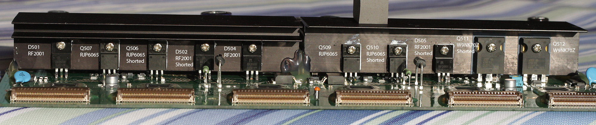

          Several of the 3 terminal devices on the heatsinks measure shorted in circuit.
          3 FETs and 2 diodes.
          These include D502 D505 (RF2001) Q506 Q510 (RJP6065) and Q512 W9NK70Z
          36 Monitors, 3 TVs, 4 Laptops, 1 motherboard, 1 Printer, 1 iMac, 2 hard drive docks and one IP Phone repaired so far....
          • smason
            • 1652
            Re: LG 32PC5RV Dead
            The W9NK70Z looks easy enough to find, the RF2001 is a T4, I see T2 and T3 on the internet no T4s. And not much luck on the RJP6065 so far....
