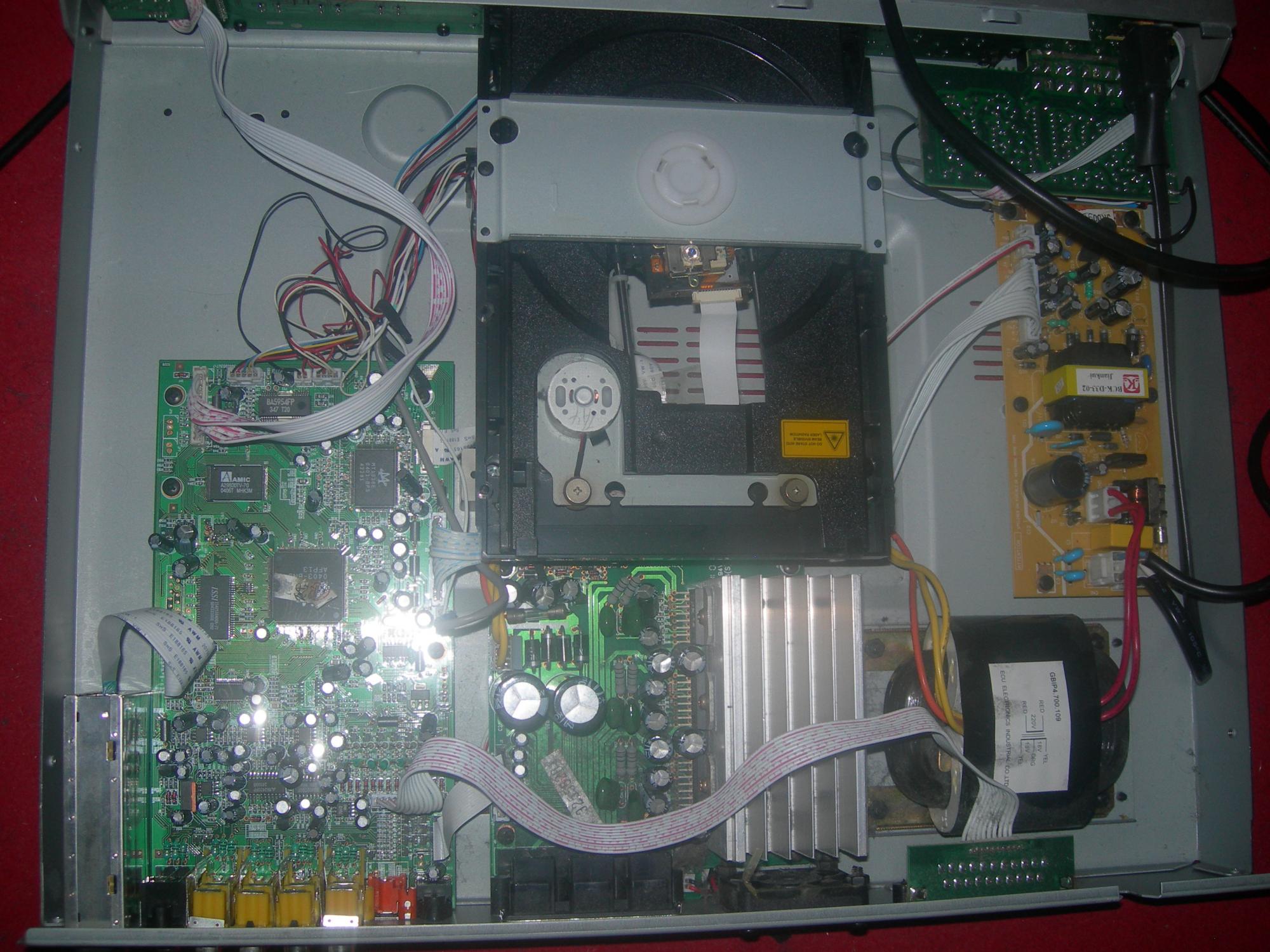

    Got this thing cheap - it's a DVD player with built in 5.1.
    Anyway, the symptoms are it does nothing when plugged in - it's completely dead.
    If you listen carefully you can hear a clicking/ticking sound at 2-3 Hz. I scoped the rails and can see them rising, but they quickly fall, at the same rate. Power supply is trying to switch on but for some reason is failing.

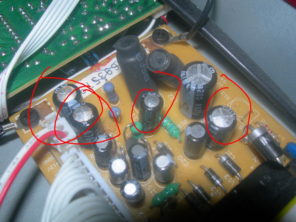

    I have replaced:
    all bulging caps on the secondary side -> same problem
    one non-bulging big cap on the secondary side -> same problem
    the 22u/50V startup/Vcc cap (replaced with a general purpose 22u/35V) -> same problem
    The power switch is Fairchild KA1L0380RB. Max Vcc is 30V so 35V cap should be fine.
    All caps replaced with Panasonic FM or FR.
    Big primary filter cap has about 332V across it which is good.
    Power supply does exactly the same without load -> power supply probably at fault then.
    Only dodgy thing at the moment is that Vcc seems to ripple about around 10-18V even with the cap replaced. Measured from either end of the cap, Vcc to GND. Vcc is provided through a high value resistor. Reads yellow purple yellow gold -> 470k 5%. Measuring it in circuit (with power off) drives my meter crazy, why? It doesn't look like it is connected in parallel with anything. I will try replacing it with a 470k resistor carbon film 5%, perhaps it is just broken, maybe it is burnt out from years of use, although it doesn't look like it. May explain ripple on Vcc. A bad cap failing open, assuming 300V across the resistor, would have it dissipating 0.191W, which is within limits. But a cap failing shorted would bump it up to 0.234W, still within limits, but running near.
    At a loss at what to try next?

      Ah!!!
      Noticed 5V rail was completely dead.
      Tested diode - DEAD SHORT, both ways.
      The 5V is used by the feedback so if it is dead then it will not start.
      Hope this is the only problem but it's faulty either way and it wouldn't work without it.

        Good catch. Your analysis was faulty, however. A shorted diode on any transformer secondary will kill the operation of the power supply. In addition to the primary and secondaries, the standby (main on a single supply design) transformer has another winding (which I refer to as the tertiary winding) which provides run power for the SMPS controller. With a short (or even just excessive load) on the secondary, the tertiary winding does not generate sufficient voltage to provide power to the SMPS controller.
        The ticking sound you observed is an excellent clue. Your noticing the dead power supply rail and following it to the cause was good troubleshooting.

            I'll point out a few things. in no particular order.
            1. You provided neither a model number nor any pictures. In the future I will ignore any of your threads that fail to provide basic information.
            2. Some smaller TVs have a single power supply; in general any TV over 24" will have a dual supply.
            3. At startup the SMPS controller gets it's power from the rectified mains voltage. The tertiary winding provides run power. Calling it a bias voltage is incorrect.
            4. A typical frequency for a SMPS controller is 70 Khz. At a guess, the 5V filter cap is in the order of 1000 uF. You can figure out the impedance there, for all practical purposes it is an AC coupled dead short.
            5. What @#%@#% schematic?? That's something else you didn't provide!
              Pics attached.
              But no model number on the back anywhere...!
              All I know is it is a Proline 5.1 + DVD combined unit.
