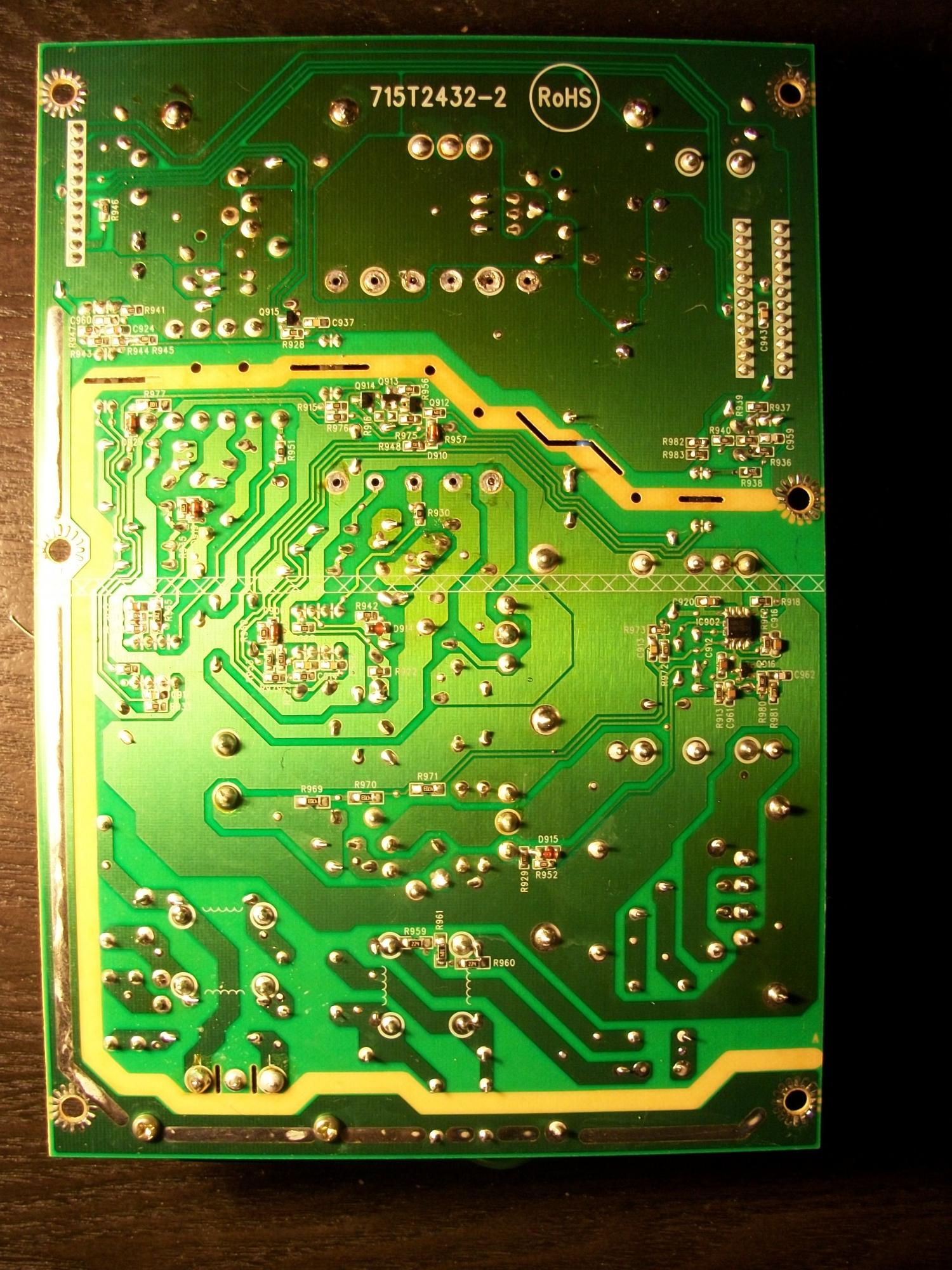

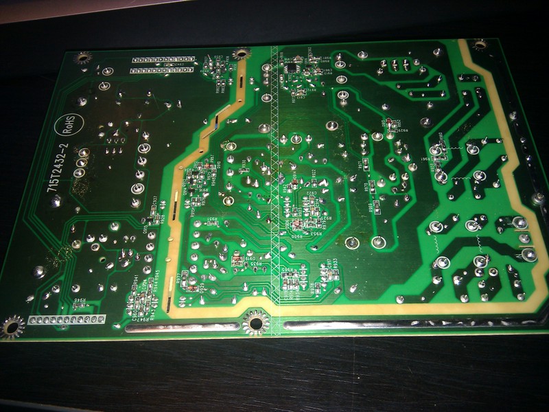

    My phillips 42" LCD is having power issues. Upon taking it apart and examining the power supply, I noticed 3 of the caps were bad. Replacing these 3 caps did not resolve the primary issue. The transformer in the center is producing a consistent repeating chirping sound every second or so. I've repaired leaking caps in the past but never had to deal with an issue like this. Any help is appreciated. Thanks
  • PlainBill
    • Feb 2009
    • 7034

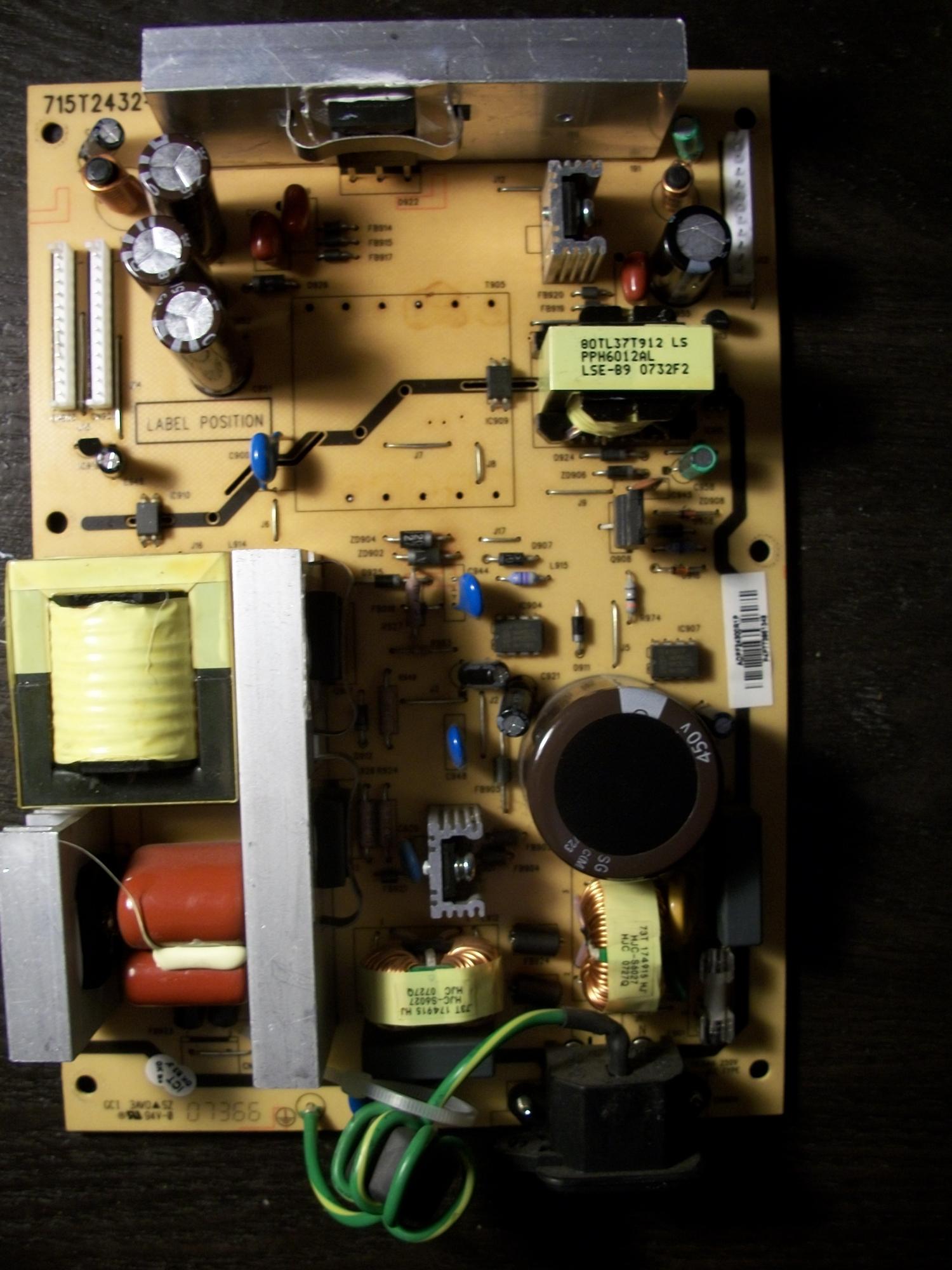

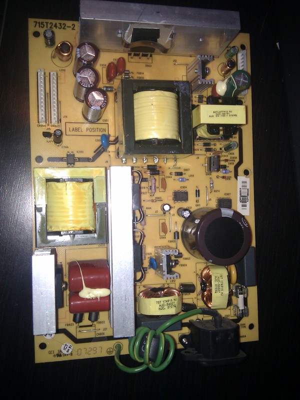

    Re: Philips 42" 715T2432-2 issues
    A chirping sound like that is often due to an excessive load, or a bad startup cap.
    Which capacitors did you replace, and what brand and series did you use for replacements?
    I notice three output connectors. Is there any indication of the function of any of the pins on the connectors?
    Also, please read this post, then review your pictures in that light.

      I replaced the cluster of 3 with the caps found at this link
      http://cgi.ebay.com/ws/eBayISAPI.dll...=STRK:MEWNX:IT
      One of the connectors goes to the power on switch which has an led. The led is lit and changes from red to green when pressed. The chirping only occurs when the power button is switched on. The power button turns green but the screen does not turn on.
      As for the pictures, I apologize. I could not get my camera to cooperate with flash. The reflection took away everything that could be seen.
      • PlainBill
        • Feb 2009
        • 7034
        If they are genuine, those caps should be excellent.
        Good information. That points to a problem with the main power supply. It appears there is only one output from the main supply and the diode on the large heat sink at the top of the first picture rectifies it. Make sure that diode is not shorted.
        Many of us have found that taking a picture during daylight hours without a flash gives the second best results. The best pictures came from someone who had his own indirect lighting setup, but most of us can't justify the space for something like that.
        One other possibility is a short in the load. There is a popular line of inverters supplied by LG that are notorious for causing problems.

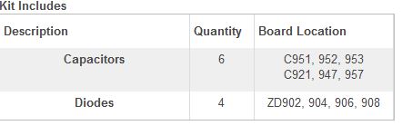

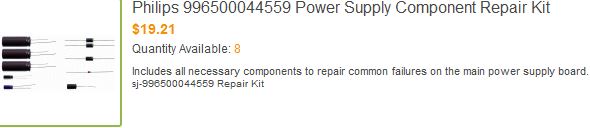

                                        I have used this power kit from ShopJimmy which fixes most of all the common issues on this board including the power supply "chirping" out of about 15 boards I've done haven't had replace any of the switch mode transformers mention in above posting see attached for kit
