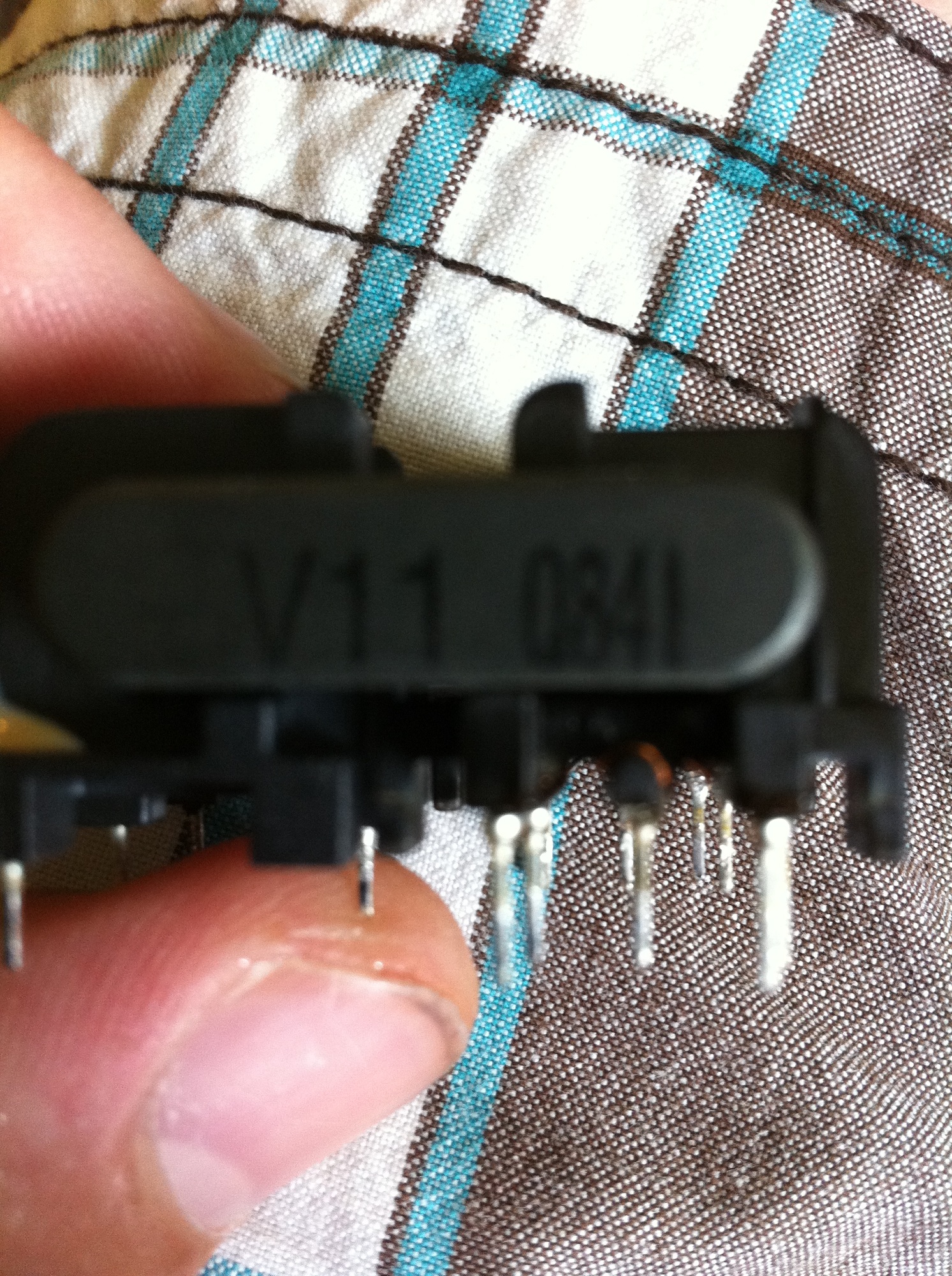

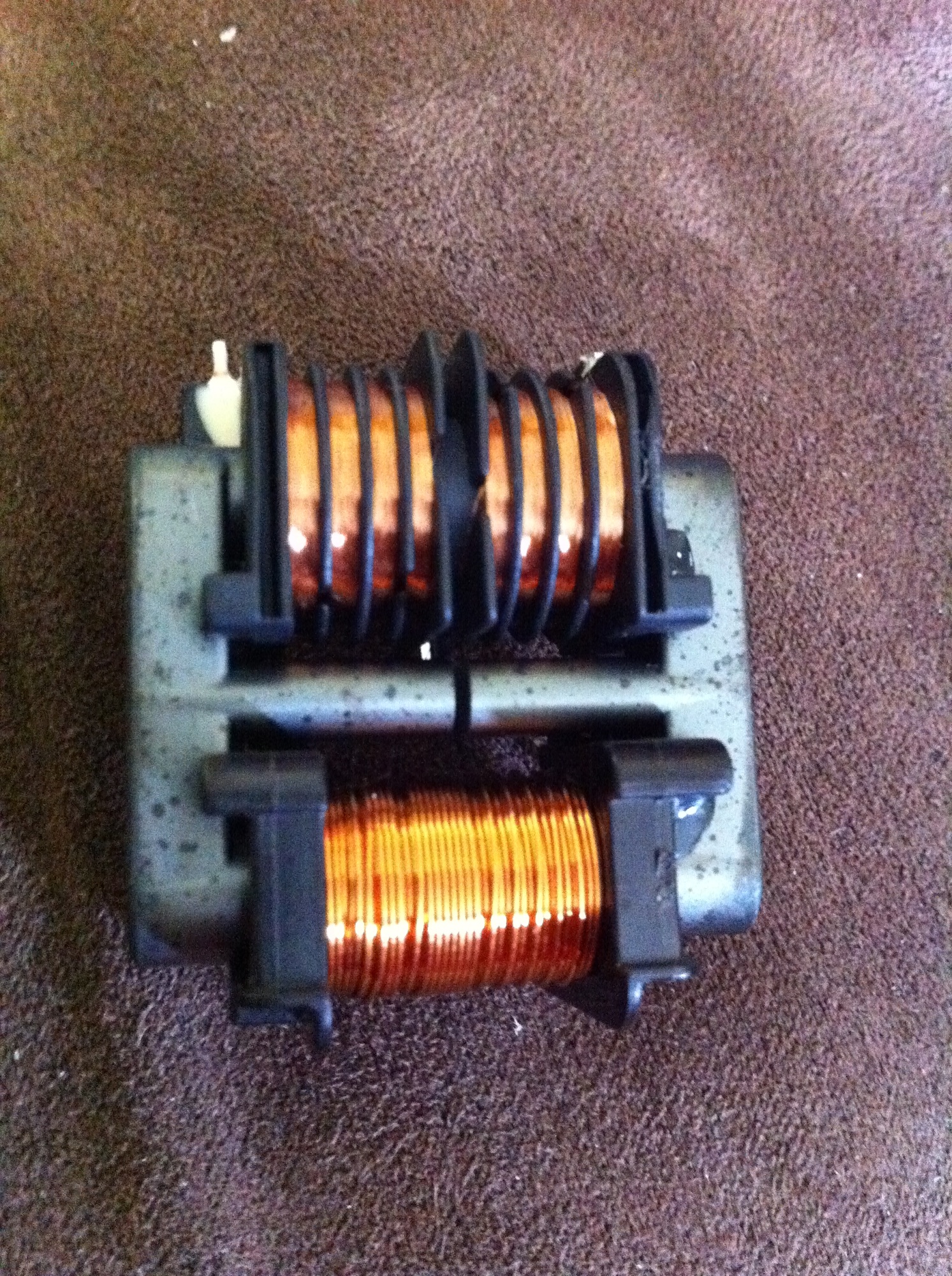

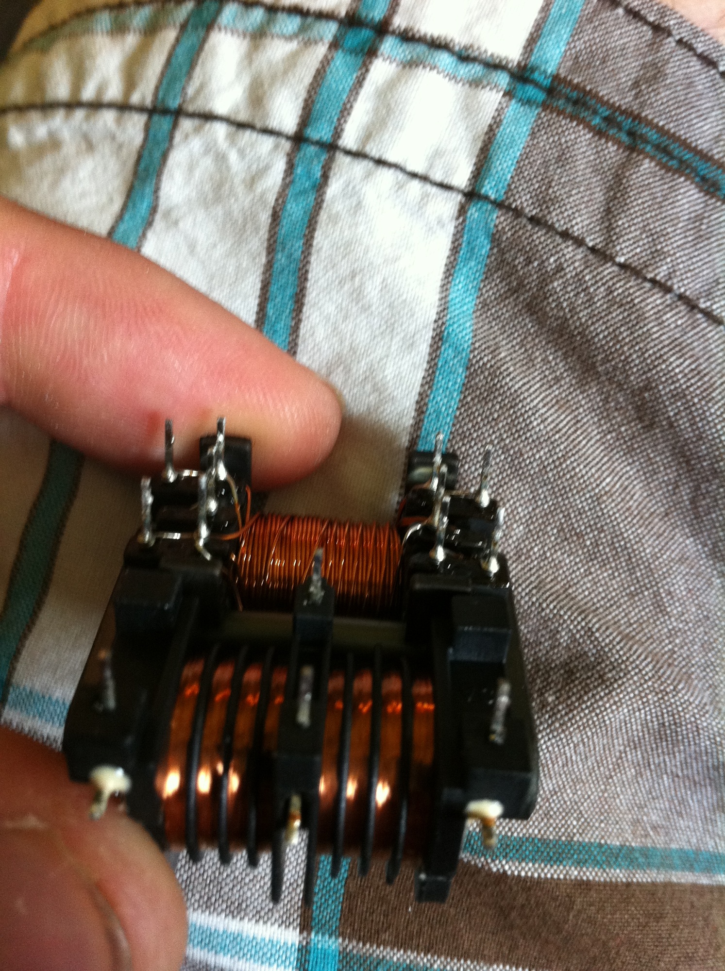

    Can someone help me find a transformer?
    I have the transformer shown below in the pics that went bad in my Sylvania lc195sl9 tv. Transformer came off of the inverter/MUT board # ba8cn0f01021-1 also known as A8AN2MUT. The only lettering on the transformer is V11 Q841. Thanks in Advance! Hope the pics turned out ok.

      I checked for continuity in the transformer the primary side checked good but the secondary is shot. I also heard a buzzing from it when tv is first turned on from a cold state. Also done the sniff test and narrowed it down to a burning smell coming from around the transformer.

              Sometimes these can appear open because when in circuit there is a cap that connects the secondary "halves". Double check and measure from one obvious connection to all the others.
              A Ring test would reveal the flaw.
