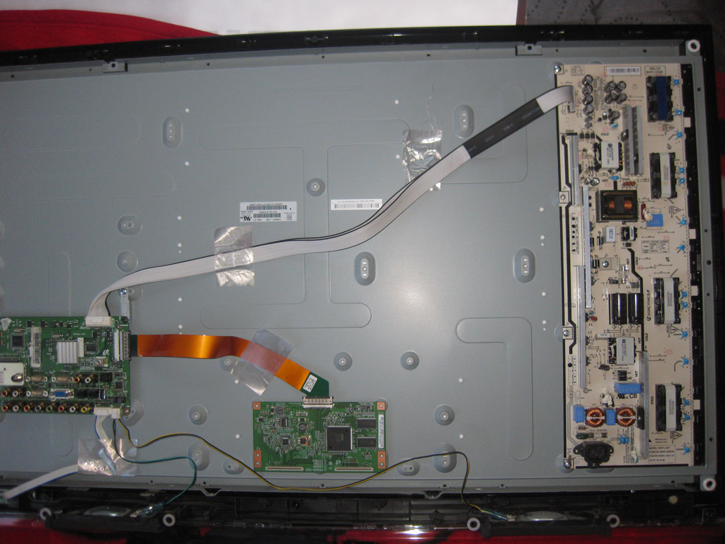

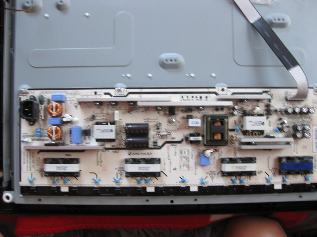

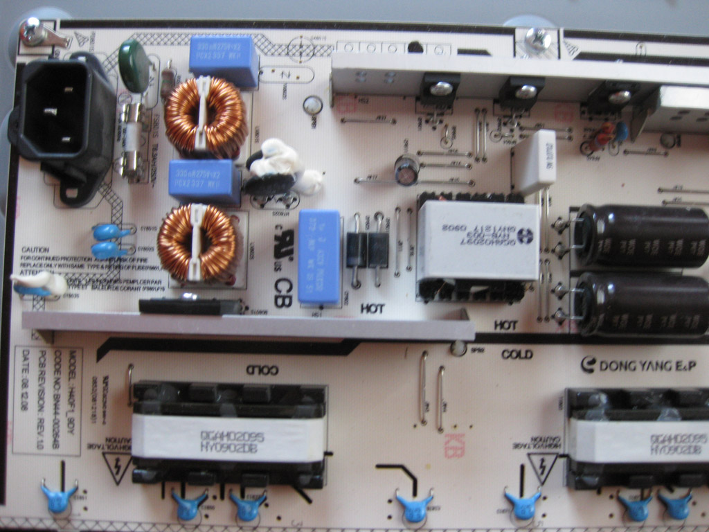

Re: samsung ln40b530p7fxza light up problem
OK to update here are some pics of the whole backside of the TV. Then i took 3 pics of the power supply board, A whole pic, a left half, and a right half. There is also a pic of the main board, and the tcon board.
I have verified that if you put a flashlight behind the LCD it does in fact show a picture. I have checked all the diodes in the board and they all show a rating on one side and infinite on the other just as they should.
I thought i had the right model code but it seems to be this Samsung ln40b530p7f. Hopefully this helps out so i can get this diagnosed and repaired.

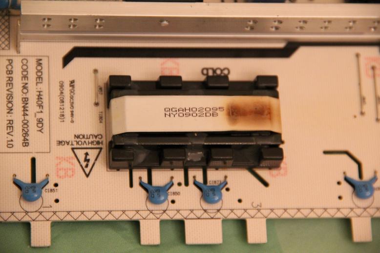

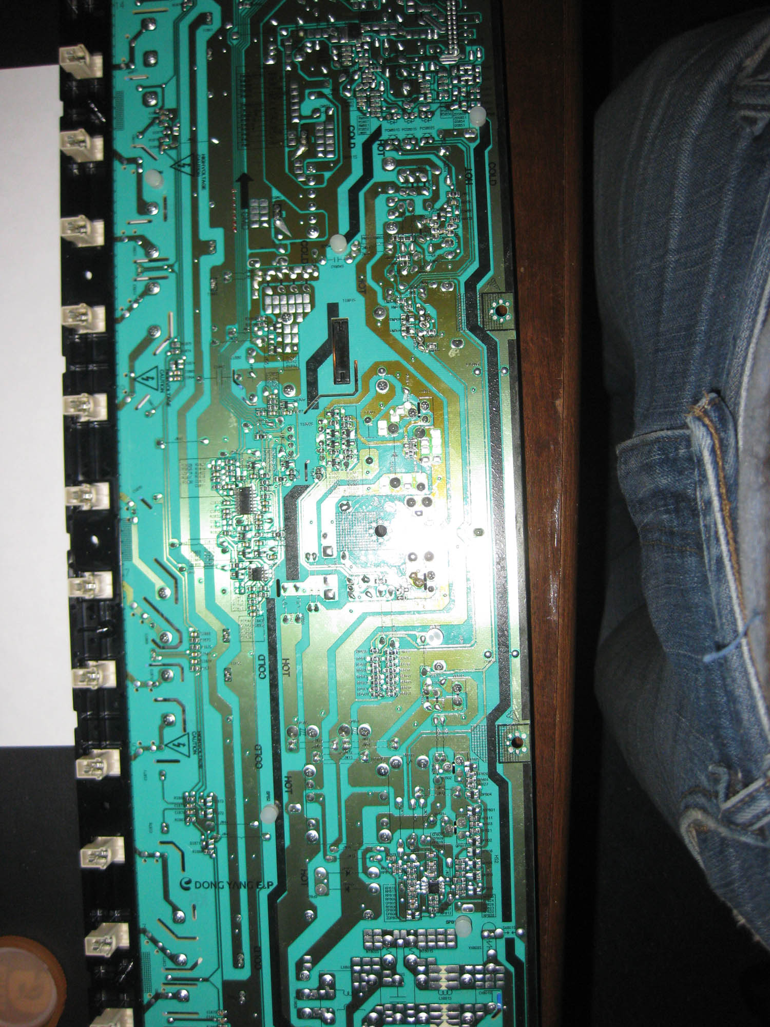

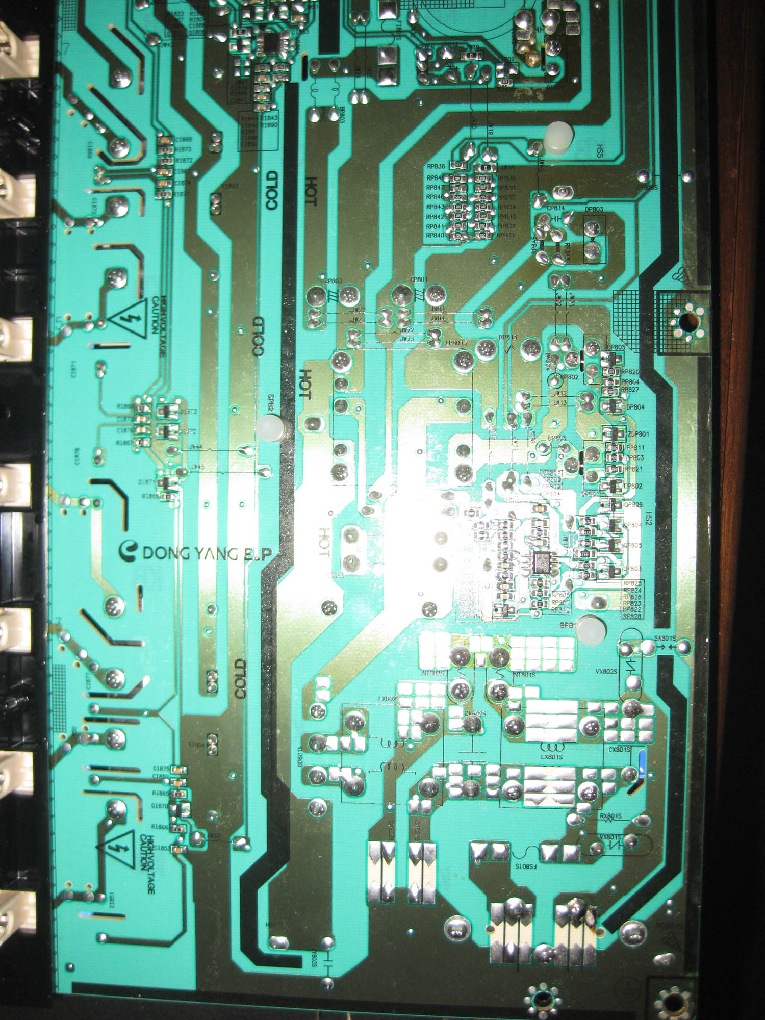

Points to check:
1. It may be necessary to register on Elektrotanya. It's a free registration and I haven't been spammed as a result, so it should be safe.
2. Refer to the last picture. Above and to the left of the bar code label is the pinout of the output connector. Check the voltages.
3. Note the transformer bottom center of the same picture. Is that scorched or is that dust? If it's scorched, QGAH02095 is available on eBay.
4. Pictures of the bottom of the inverter will help troubleshooting if the brown spot is dust.
1. i tried this and it said it was for invite only.
2. i checked the pinout output voltages and they all seem to be in spec. 13v was at 13 5.3v was like 5.32v and whatnot.
3. it is not dust that is for sure. so im assuming that it is scorched but is there a better way to tell.
4. I will have to get you a picture of the back side of the power supply board tomorrow. its late now.Comment
2. Good
3. Compare the resistances of the secondaries
4. Whatever.
PlainBillFor a number of reasons, both health and personal, I will no longer be active on this board. Any PMs asking for assistance will be ignored.
Never be afraid to try something new. Remember, amateurs built the ark. Professionals built the Titanic.Comment
ok i hope i did this correctly
i took measurements on both sides of those qgah02095 and on all 4 of them
first one closest to power plug
side of light plugs 3 is the scorched one
(1.)1.19k /1.18k (2.)1.19k/1.18k(3.) .955k /8.3mega (4.)o/l / 1.2k ohm
other side of qga's
(1.) .1/.1 (2.)1.8/1.9 (3.).1/1.9 (4.).1/1.9
Also did you figure out the register for that site?Comment
Thanks for sharing and your help.
I had the same problem on the same tv. Screen turns off and on. No problem with the sound.
So I saw this forum and dissassemble my tv and have seen the damaged transformer.
First I bring the board only to a "tv repair". They wanted to have the all tv and replaced the entire board for 250$ and keep the old one. They cannot put a new transformer.
I said no and order a new part on ebay (+ a soldering iron in my city) and put the new transformer.
The tv works now pretty well like before. Good for watching "rugby world cup"
sorry for my english and thanks again!Comment
