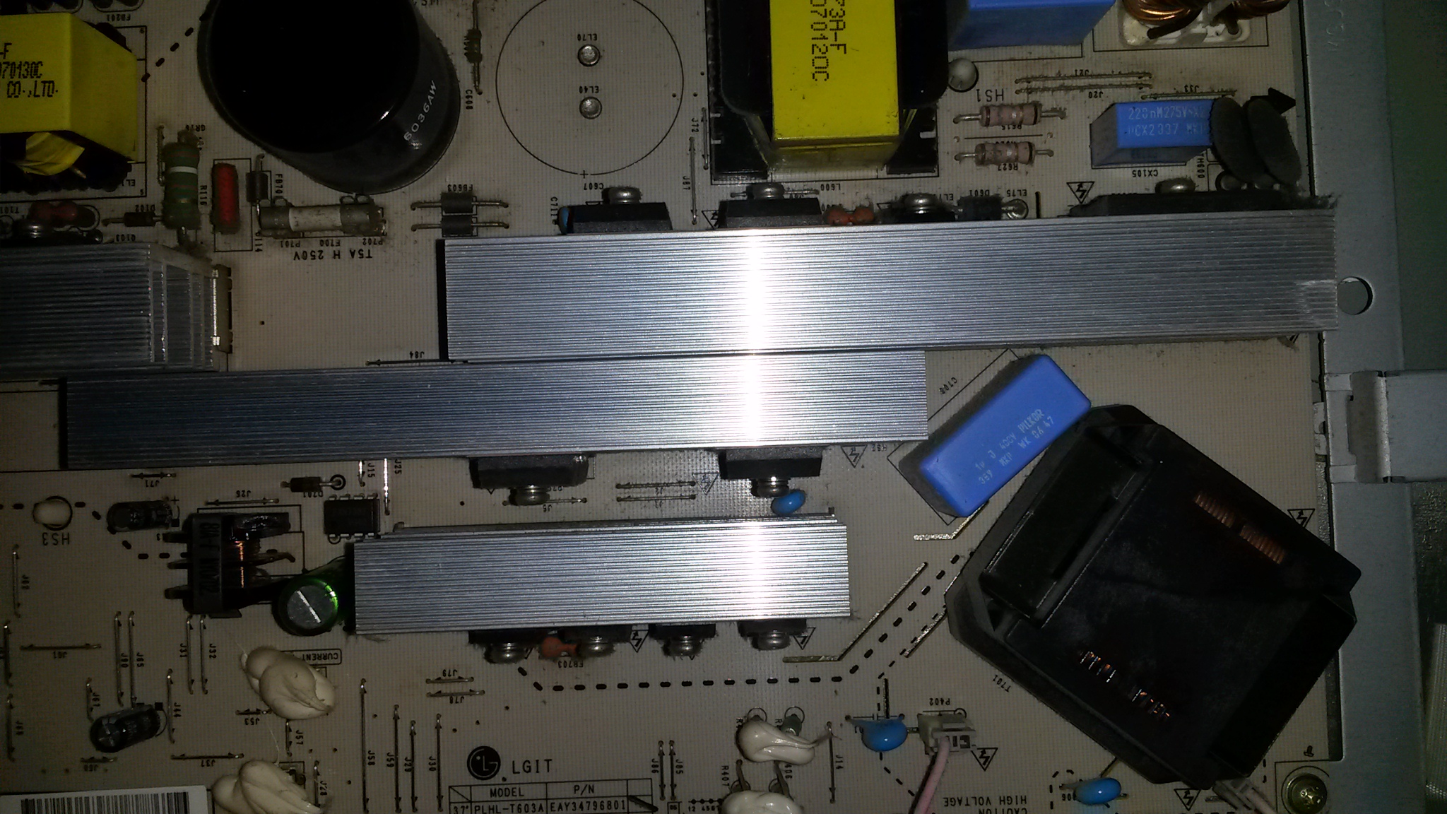

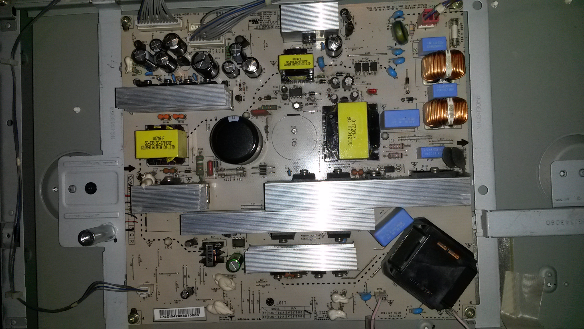

              Hi everybody. I have same problem to startup from standby with LG 37LC52. I donn't know what capacitor to replace. Do you have any schematics or could you help me with C reference designators and values? Thanks a lot.

                The failed capacitors on these models are very obvious when they fail. Post a picture of your power board.

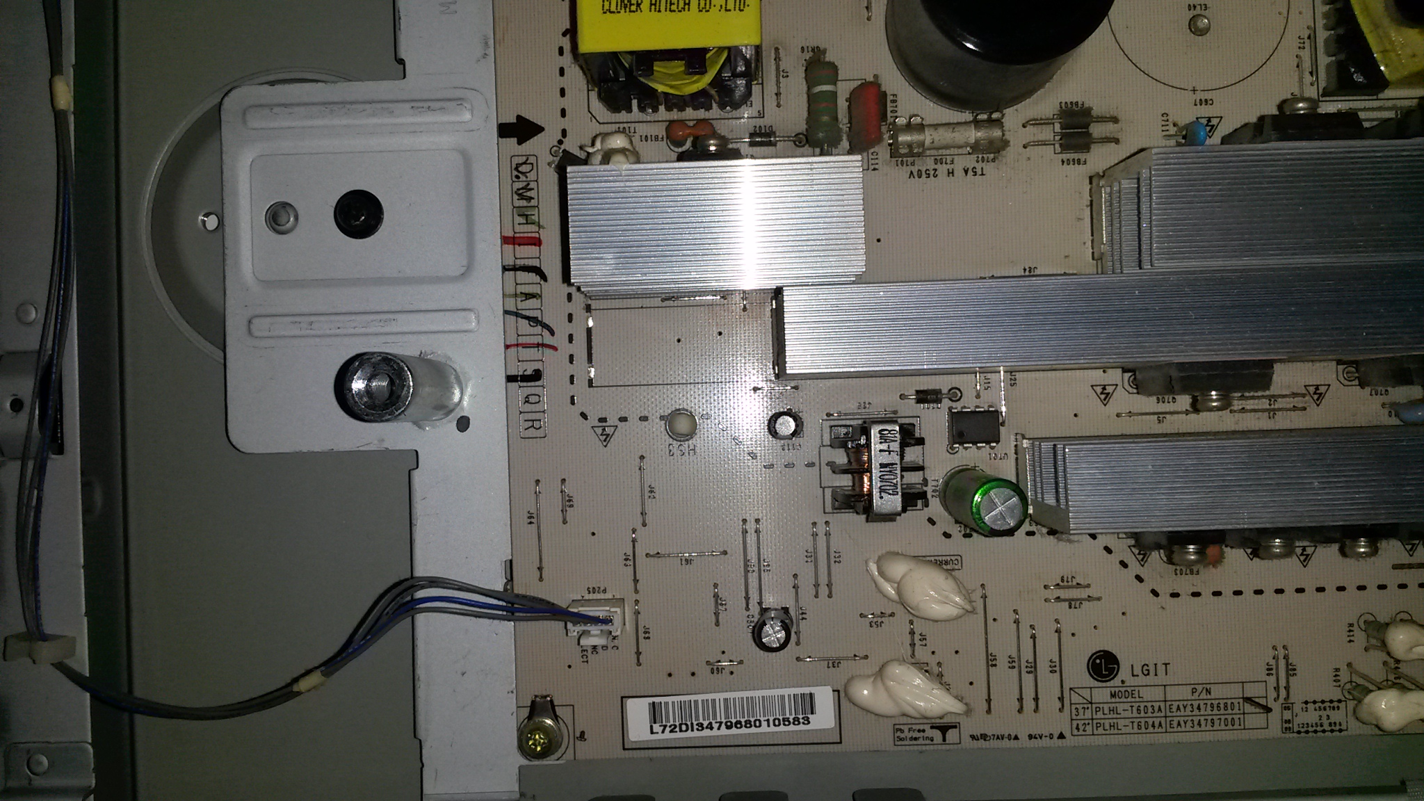

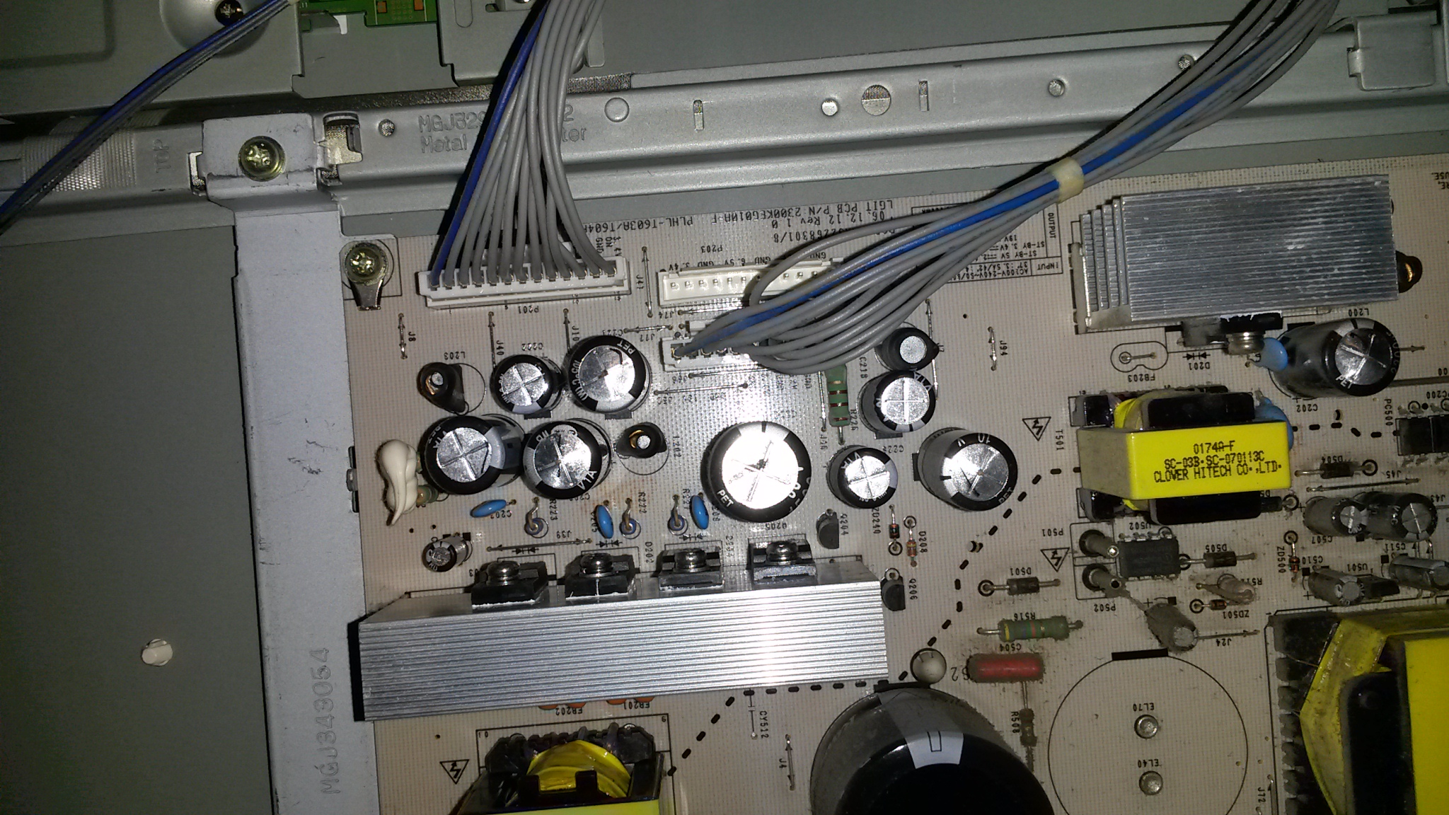

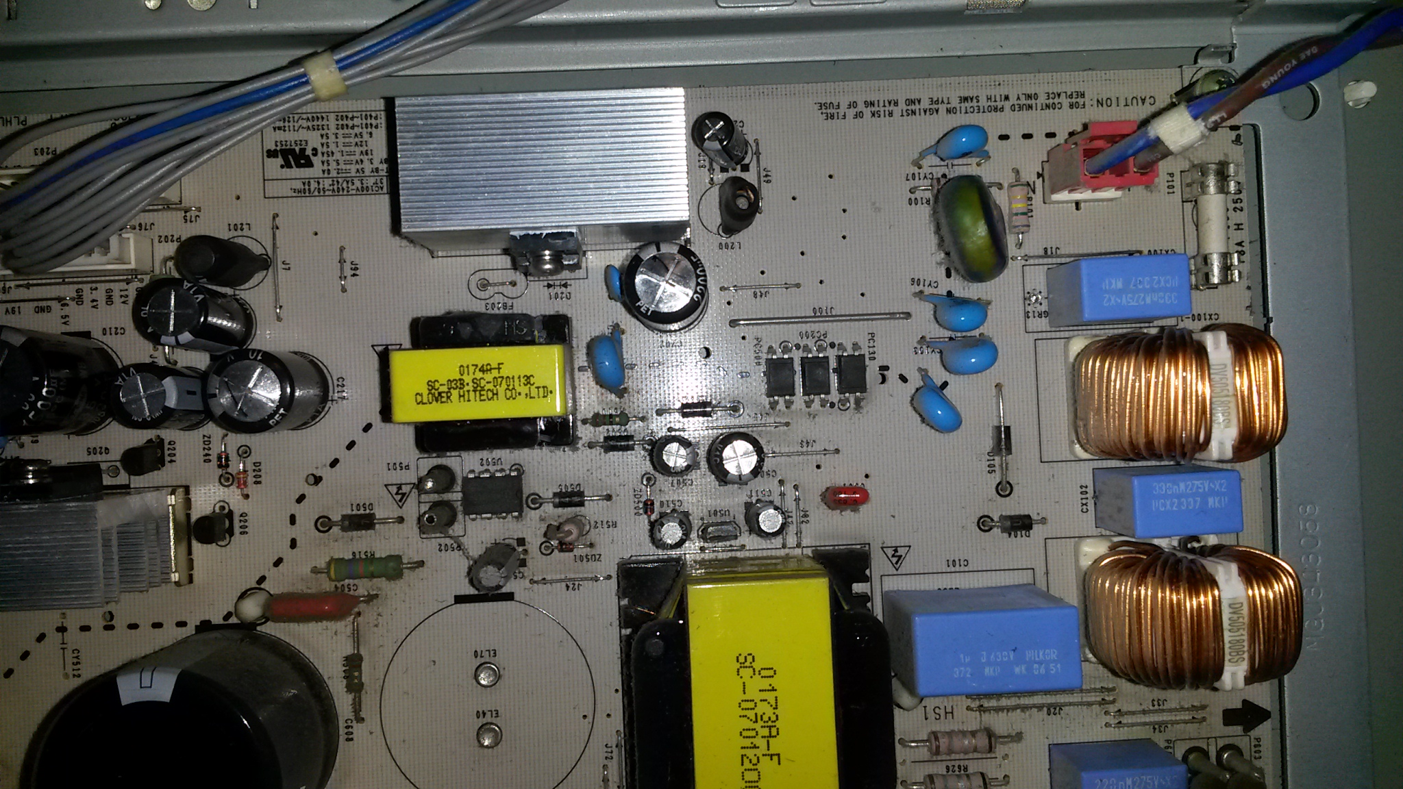

                  Re: LG 37LG55 LCDTV standby problem
                  I put some picture with my board. My TV is LG 37LC51 not 37LC52.
                    Good luck. You have four capacitors that are very obviously failed; replacing those should fix the issue. I would recommend replacing all the capacitors at the same time.
                      I see at least 4 swollen caps on that board. Replace all of the caps above the dotted line (top). Use Panasonic FM or FC series caps. Even though some look ok, they will fail and you will have the problem.
                          Thanks for help, I will order them.
                            I just replaced that 4 blown caps and is working perfectly. Thanks!!
                              Recommend you do all of those caps to make sure it's perfect.
