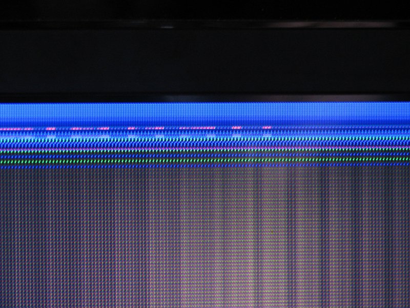

    A Vizio VL370M appears to have a tcon problem:

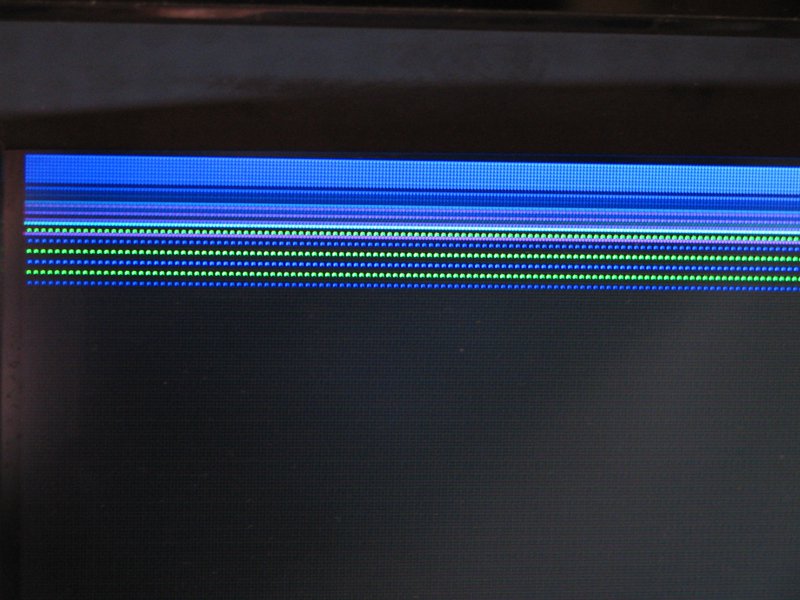

    The first picture is the upper left corner of the screen. The blue part is about 1/2 inch tall. The second picture is the the center of the screen. The orange/red appears to the be the top of a "no video" or other message. The center of the screen has a lighter vertical patch.
    Selecting different inputs doesn't make a difference.
    ESR on the caps looks okay, low on the power board (UCC KMG and Nichicon YXG), a little higher but not terrible on the processor board (Teapo SH and Taicon HF). Backlight comes on and stays on. Fuse and fusible links (FL) that are present are good.

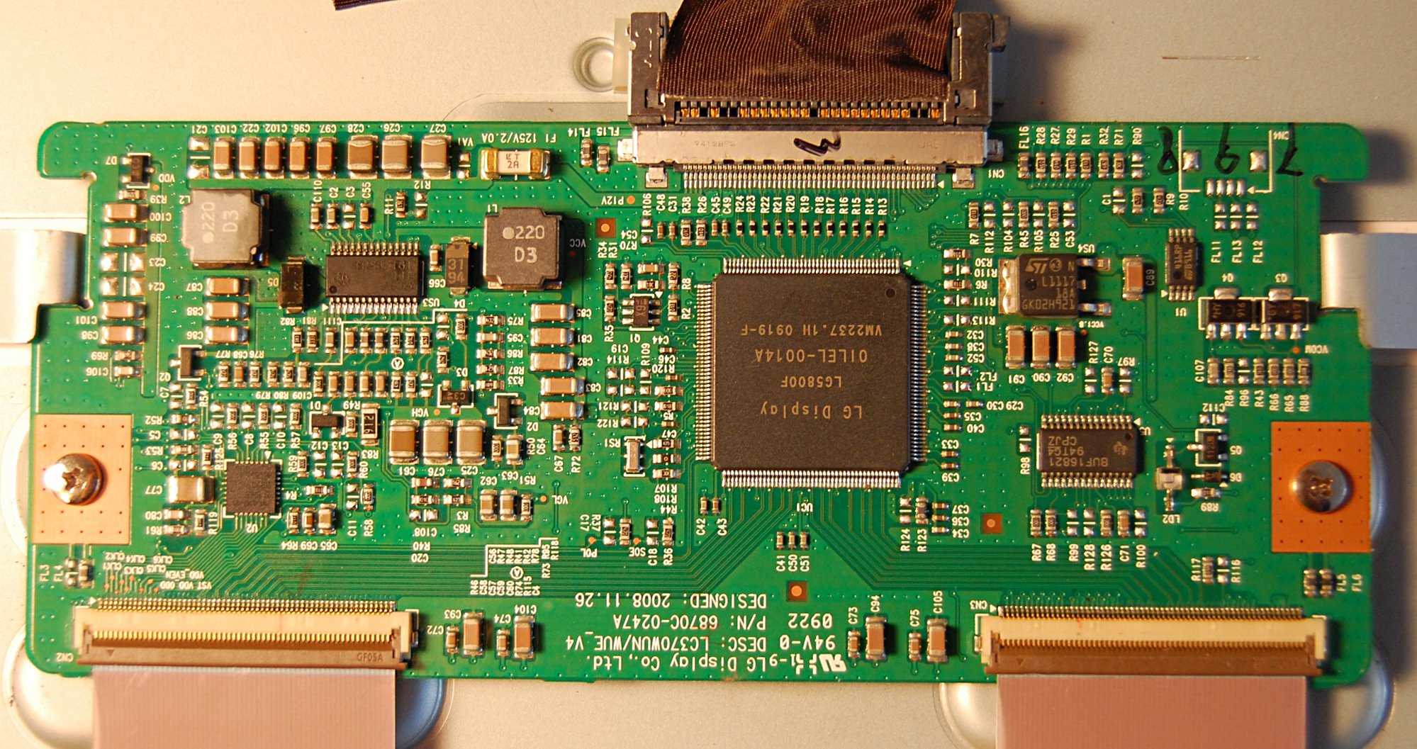

    Chips on the tcon board are
    U2- Maxim
    17180E
    T1920
    1TB1 (not sure about that, it's really hard to read)
    US3- (TI logo)
    TPS6516
    94T
    AEJ5
    U5-
    BUF16821
    94TG4
    US4-
    L1117
    18A
    ...and drat, it measures 1.800V with power on, not just good but tauntingly perfect. The connectors at both ends of the short ribbon cables did have some fine dust in them, cleaned with paper. No difference.
    Any way to tell if this is maybe the panel or the tcon board without a spare of either to swap? Common failures on the tcon other than the L1117?

    The tcon board is LG Display LC370WUN/WUE_V4, P/N 6870C-0274A. That's visible in the picture but the text might be found by searchers.
    With a computer attached to the VGA port, the top sliver of picture shows the wallpaper, and the mouse pointer when moved to the very top of the screen.

      US3 is actually a TPS65161, a DC-DC converter. The output on pin 3 with the power on is 16.08V.

        Oops--the tcon part number is actually 6870C-0247A. Transposed the last two numbers.

            Tried a replacement tcon, no change.

              I have the same issue described. Any info on what was donoe to resolve it? When powered on, everything seems to work fine. its begind to act like this anywhere from 5-15 minutes of viewing.
              Going to try heat or cool components and see if i can find a sore spot
                Re: Vizio VL370M
                Tab bonds... Same cause, different problem, somewhat easy solution:
                https://www.youtube.com/watch?v=purk_SyiT44
