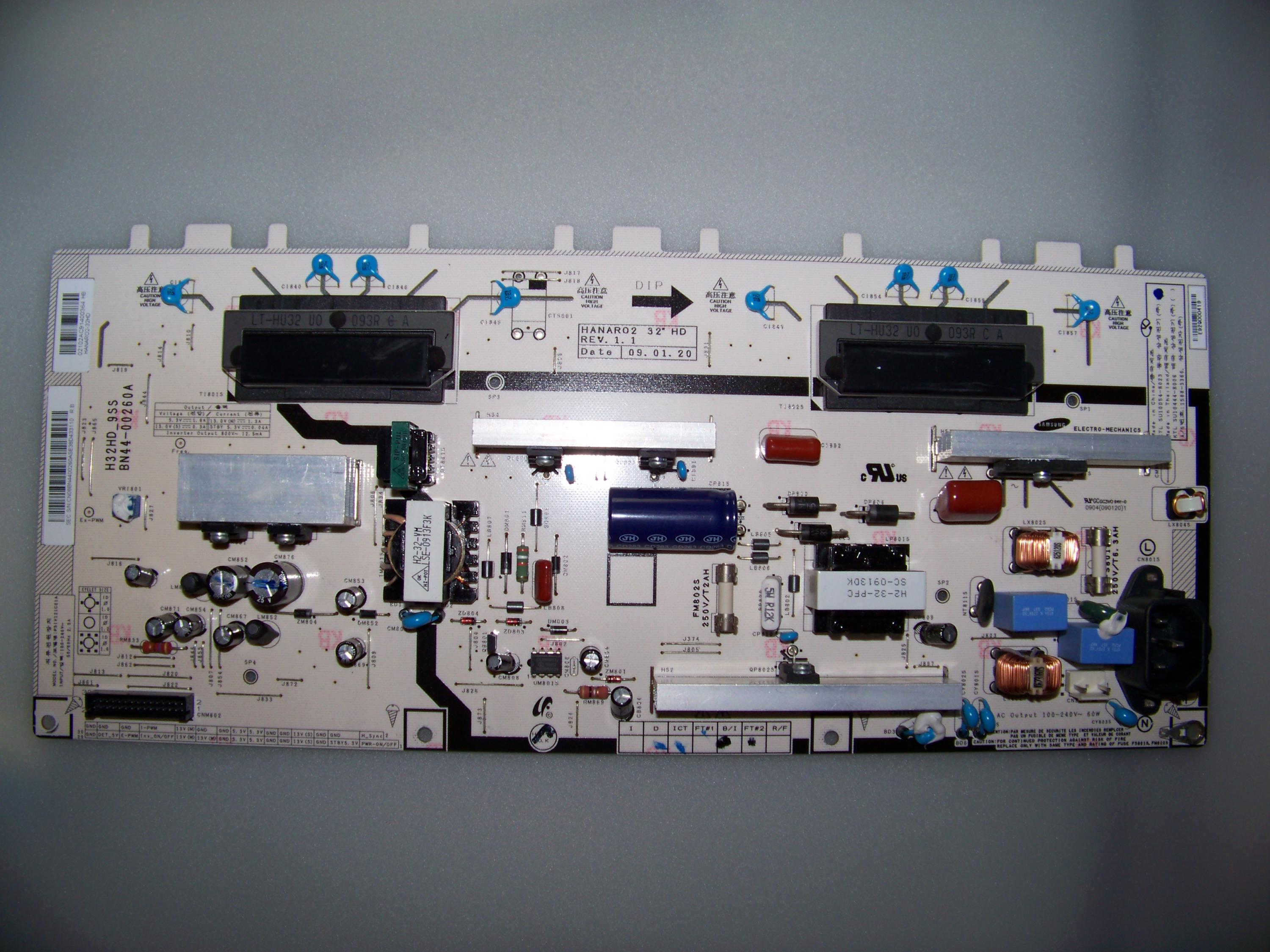

                    I purchased a Samsung LN32B360C5DXZA for $25 and like the title shows, the TV had sound, but no picture.
                    I searched online for the issue and I found Badcaps. I read all the posts and I saw a picture that someone posted where it shows the 3 diodes. I checked the diodes on my power supply board and got the following readings:
                    DP810 - 485k (reverse test showed infinite like it should)
                    DP804 - 506k (reverse test showed infinite like it should)
                    DP805 - Open diode in-circuit as well as out of the circuit
                    I did a search online and I was not able to find the same diode (DP805 - MUR360AX SSG 09083).
                    When it comes to capacitors I can find them online, but I'm having trouble finding the diode. Can anyone give me a hand?
                    I'm attaching a clear picture of the power supply board and marked the diodes reading.

                      Is anyone able to help me with the diode that its bad on the TV so I can purchase it and replace it?
                      I found these two online but I do not know if it will work:
                      1N5408 Rectifier Diode 3A 1000V
                      1N5400 B, Rectifier Standard Recovery NS, FBGA48
                      • rlega
                        • Jan 2014
                        • 93
                        #31
                        Re: Samsung LN32B360C5DXZA Sound OK, No Video
                        I found replacement diodes for the TV, because I could not find the MUR360AX. I ordered them, and walla, the TV is working.
