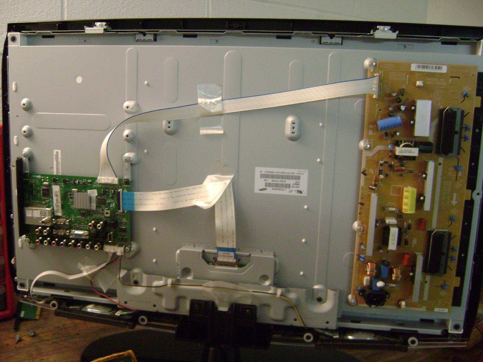

    I'm trying to fix this one I got for about $30.
    This set was working fine for about a day after I got it. Now it's got sound but no picture.
    I changed 2 caps on the inverter board just for the heck of it. - No help
    I found another thread on this set. That TV had a bad Tcon connector from water damage. I haven't checked this yet. I just found that thread. I'll do that next.

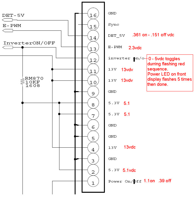

    Here is a schematic, the voltages I got off of the boad, and a pic of the unit.
    My camera is not doing what I want it to do right now, I dont know why. Sorry for the bad pic.

      I checked the three diodes. All three check out fine. Two are the same and the one on the left (closest to transformer) is a different type, but all check ok.

              Some of those voltages look strange. I hadn't looked at them before because I am philosophically opposed to downloading a 1.7 meg BMP when a 76K JPG will do the job. Note the difference.

                        Do you have a 4V 150 Hz square wave out of E-PWM?
                        Somthing that has me concerned is the VCC for UI801 (SEM2006). I have 13 volts going to it as well. I dont know if this is too low for this chip or not. The datasheet below says this chip has a MAXIMUM of 36VDC for the VCC.

                          Here is more of what I am noticing with mine:
                          All voltages seem OK whenever the board is powered up without the processor board being plugged in. It's as if the processor board is somehow telling the power board to shut down. The 5VDC on the connector is solid, but whenever the other board is plugged into this one via the ribbon cable, it goes from 5VDC to 0 four to five times and then quits.

                            Replaced the board alone and tv works, so the problem must be the BN44 board.
                            Problem would be somewhere between how UB802 control INV_UVLO.
                            InverterON/OFF is not staying high after power on.
                            With the AC live voltage in one board is the worst design for repair. I stop at this point since all component is located underneath.
