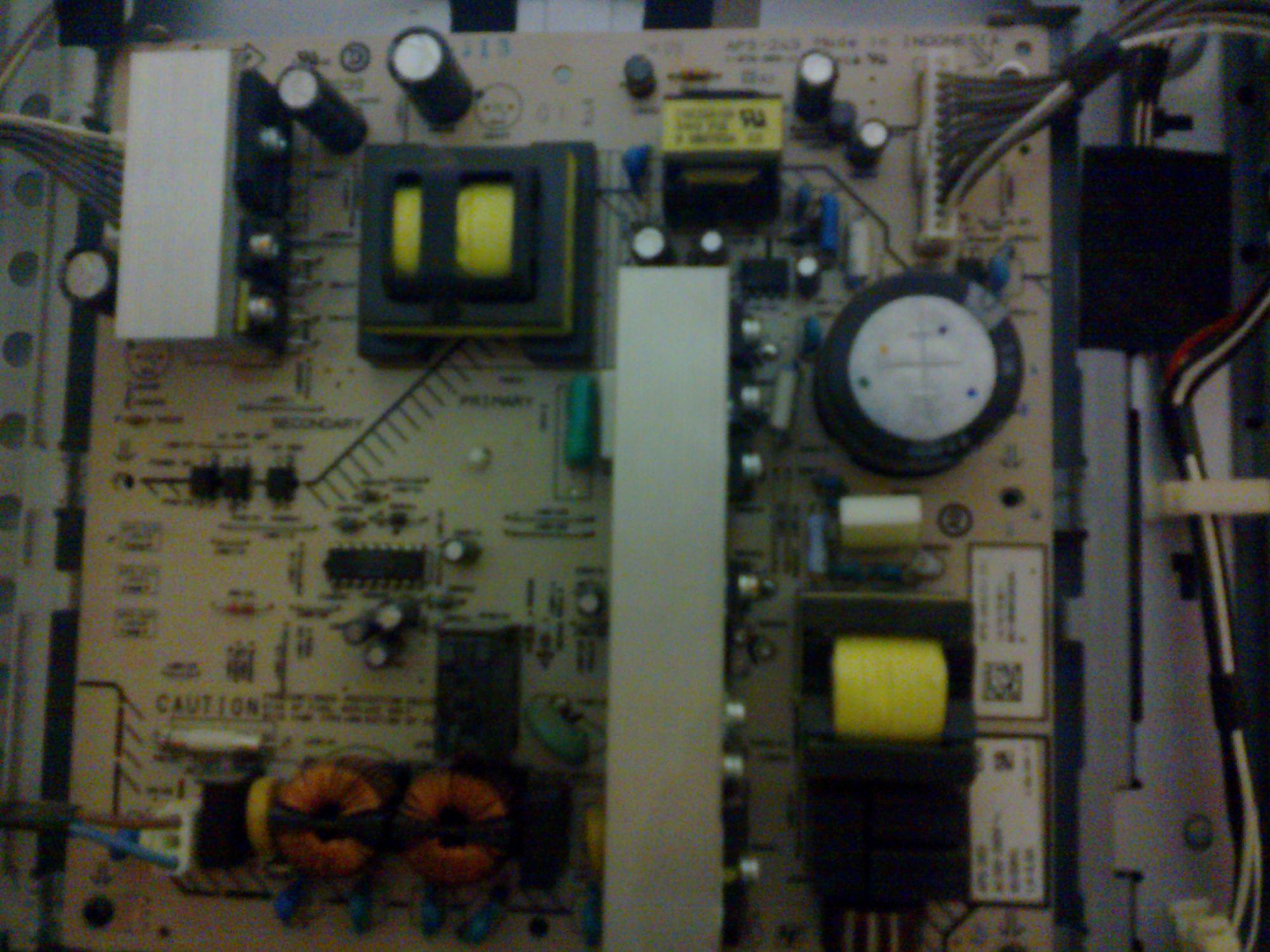

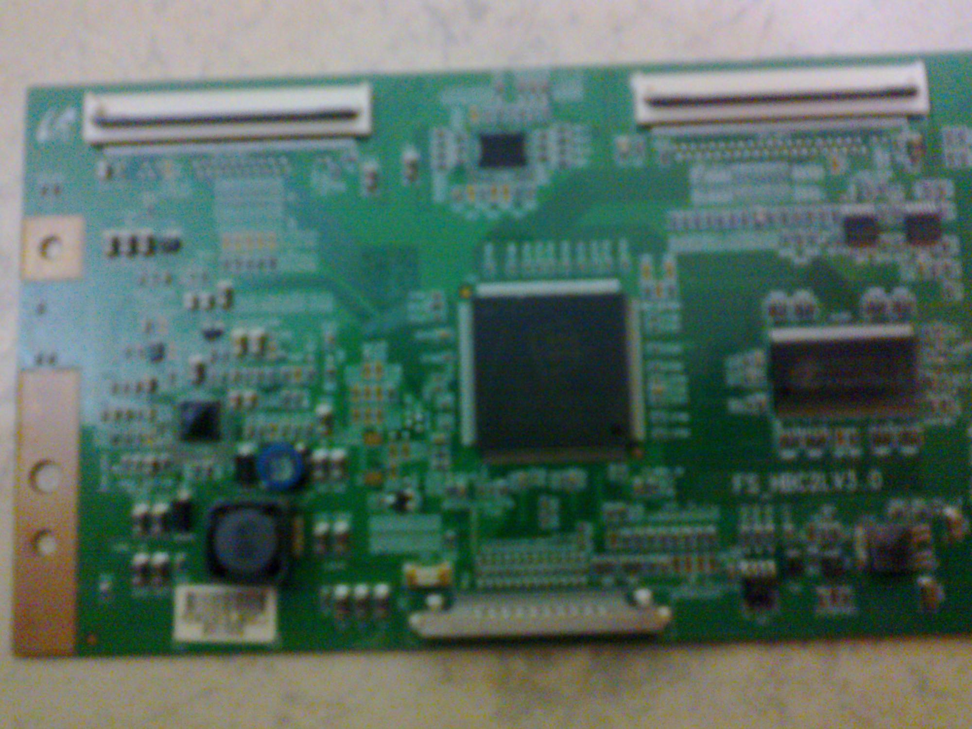

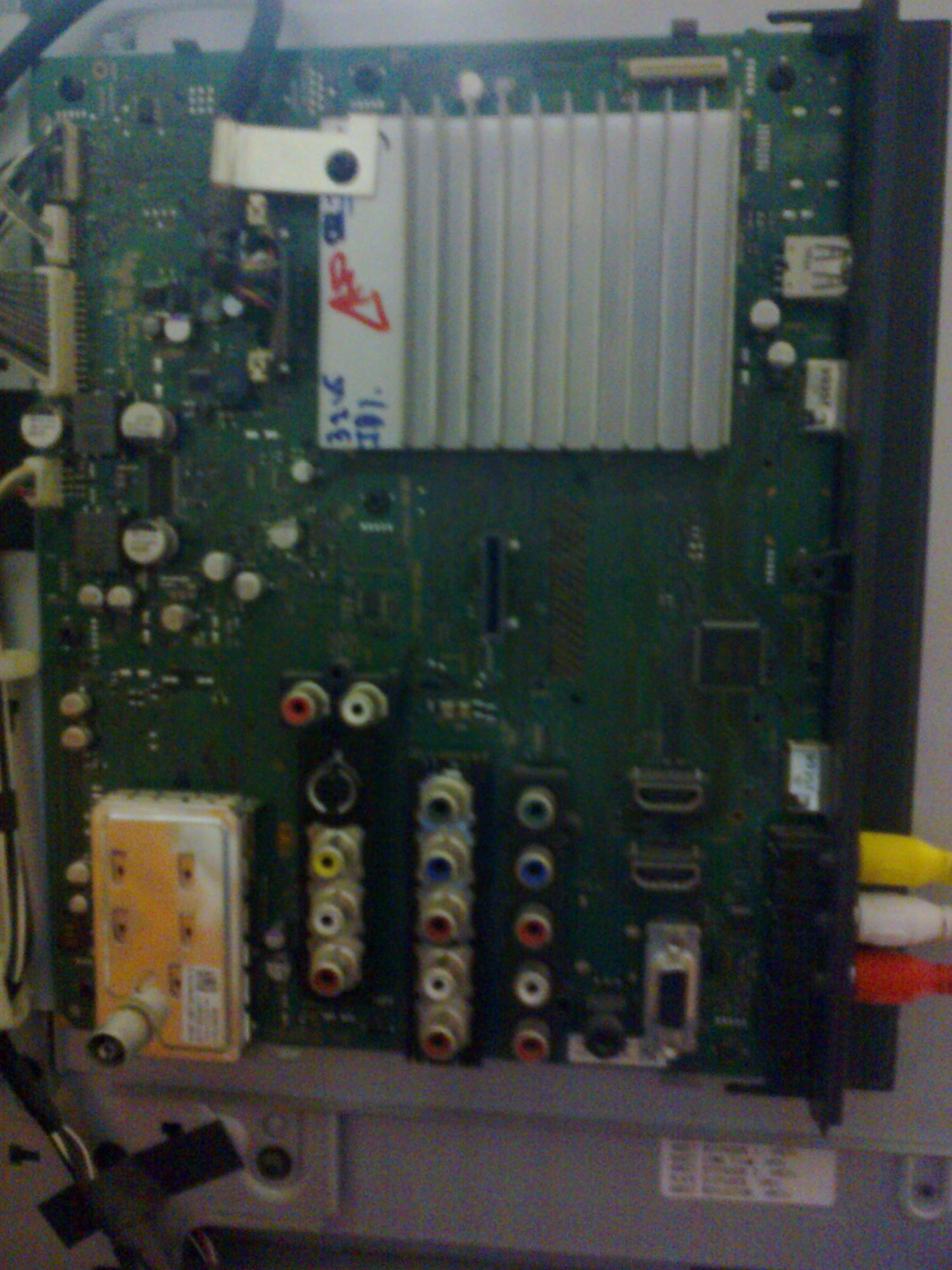

                    Re: Sony Bravia 32-inch, No Picture but Backlight is ON
                    hi,
                    Im uploading some pics. Could anyone check?
                    • cadiman
                      • Mar 2010
                      • 397
                      Looks very similar to kdl. You got lucky!
