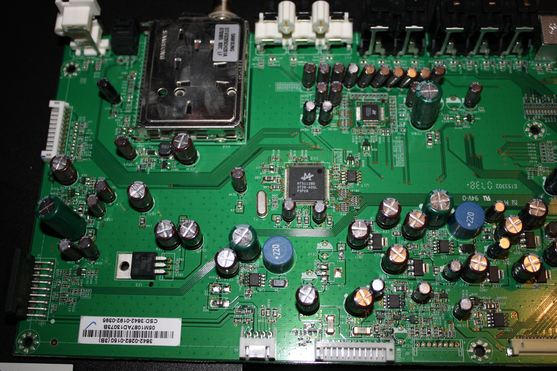

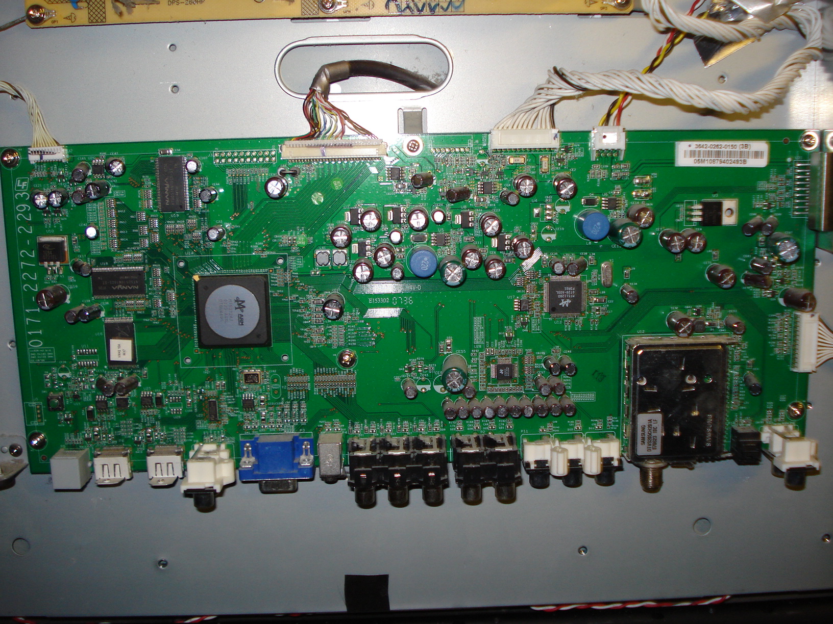

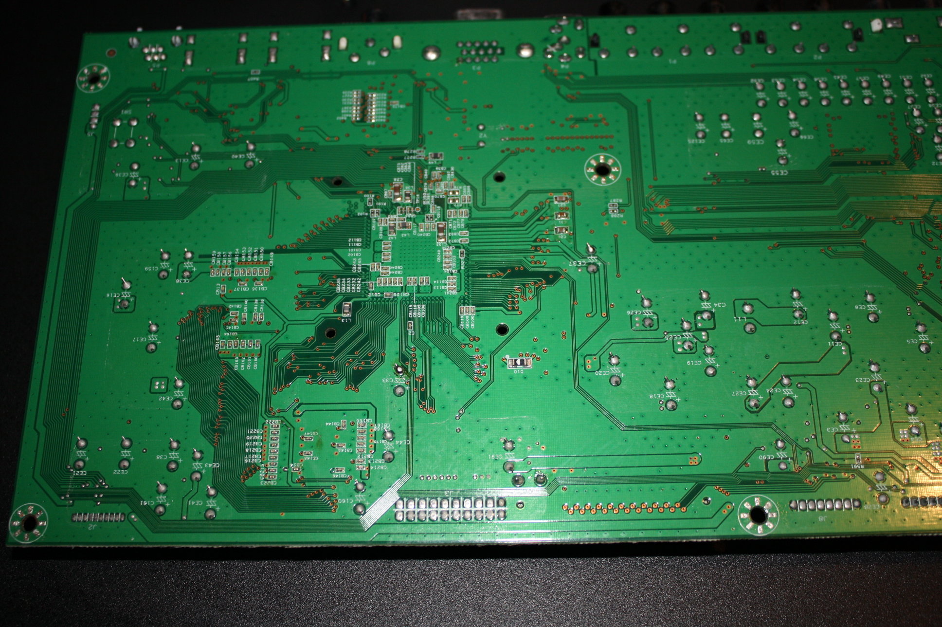

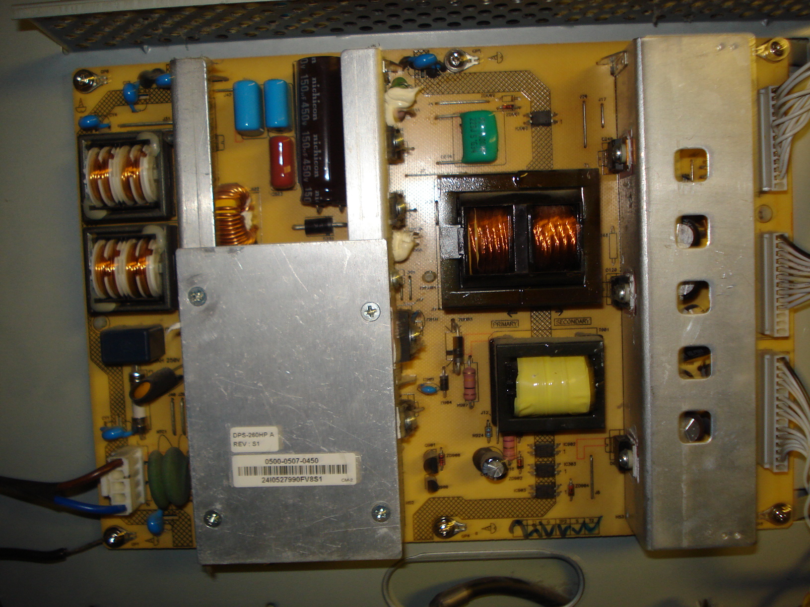

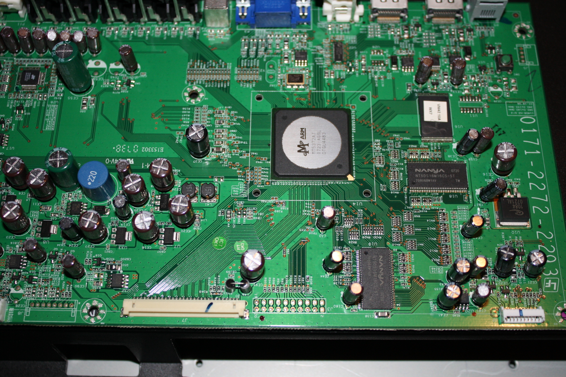

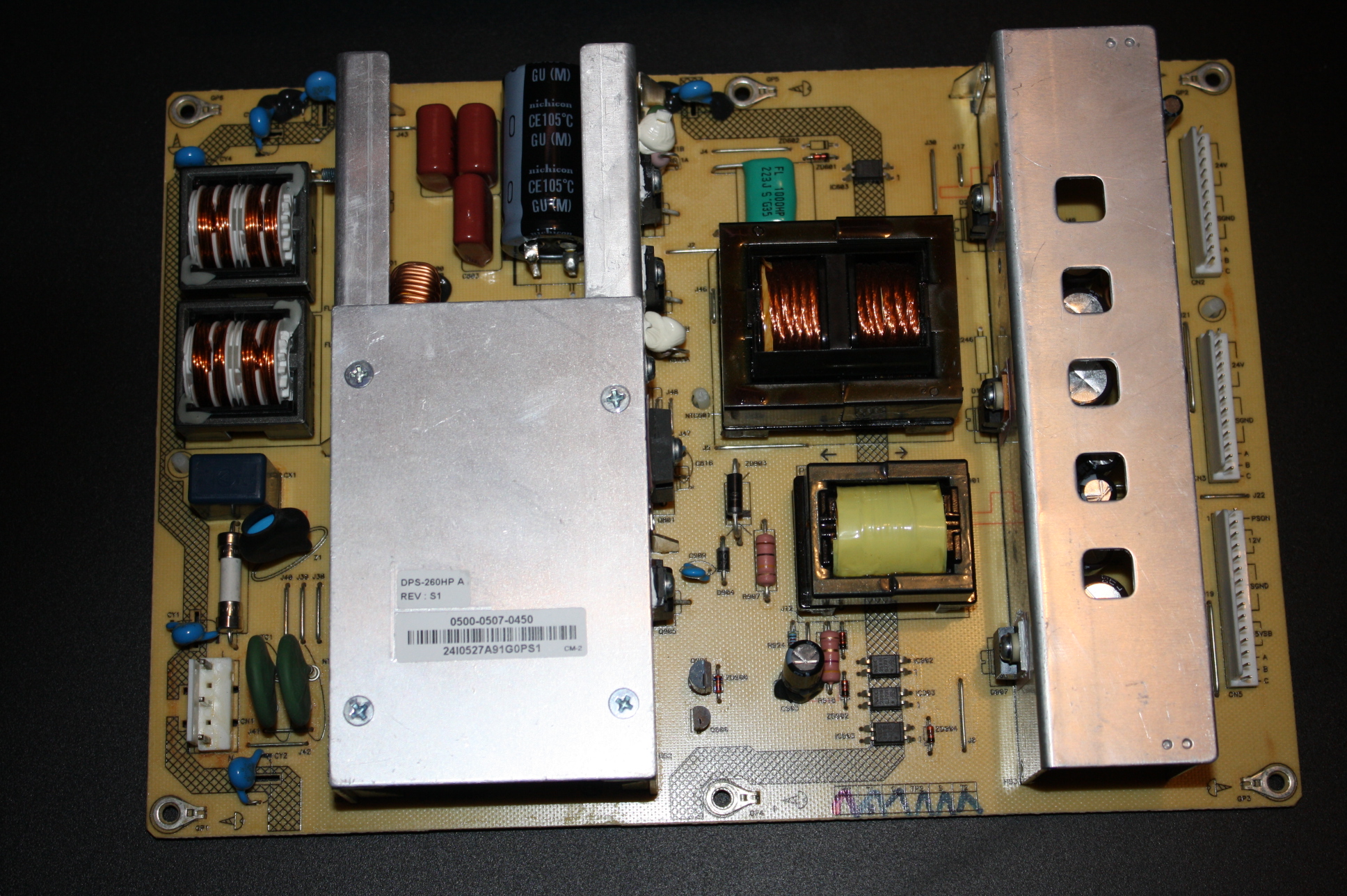

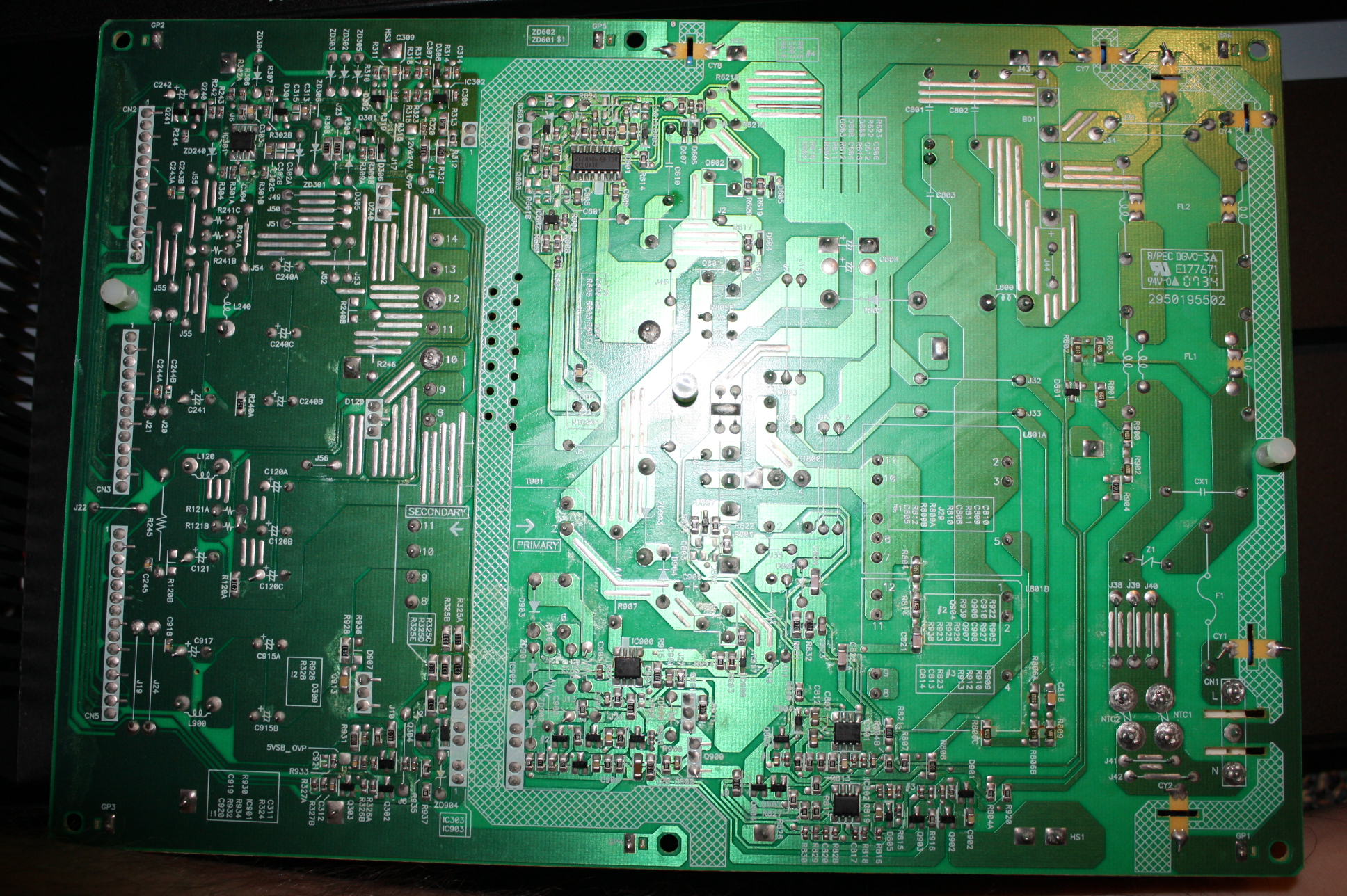

        Alright I took it apart and here are the pictures. If you want closer pictures or a picture of a certain area let me know. I've also read the service manual and I think U8 is probably the problem.
        • PlainBill
          • Feb 2009
          • 7034
          Re: Vizio VW42LHDTV10A No power
          Good (but not great) pictures. It's especially nice that you didn't crop off corners, etc.
          You idea that U8 might be the problem is interesting. The LDOs in that area (especially U33) are one of the known causes of problems, although the symptoms don't match.
          If you don't mind, I'd like you to verify a few points.
          With the boards in place and all cables connected, power plugged in, please measure the SVSB voltage (CN5, any pin 10-12), use any pin 5-9 (SGND?) as the ground point. Also, what is the voltage on pin 1 (PSON)? Try pressing the power button. Does the voltage on pin 1 change? Is there any voltage on any 12V pin (2-4)? (Note: When I specify a group of pins, it is only necessary to measure one of them).

              OK, lecture time. The power supply is two supplies in one; standby and main. The standby supply is on whenever the power cord is plugged in. It provides power to a small section of the main board - the standby processor, the remote sensor, and the control buttons. When the standby processor gets the 'Power on' signal form either the remote or the power button it performs a few rudimentary tests and turns on the main supply by pulling CN5, pin 1 up to about 3.3 volts. That obviously isn't happening.
              The next step is to check the main board. If you look at the picture which includes the tuner (the silver box with the coax connector on it), on the lower edge of the picture is the connector which connects to the power supply. Just above that connector are F1 and F2. With power disconnected, check the resistance of each of those fuses. It should be less than 1 ohm on the 200 ohms range. Alternatively, you can check the voltage at each end of both fuses with the main board connected to the power supply, and the power supply plugged in.

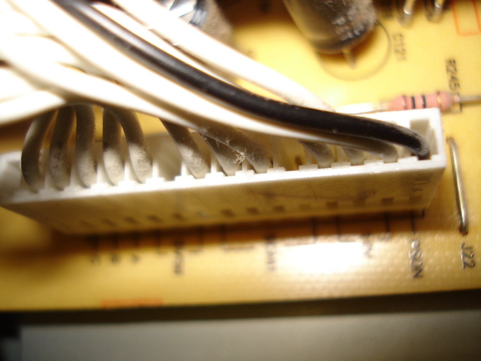

                                • MisterD
                                  • Oct 2012
                                  • 668

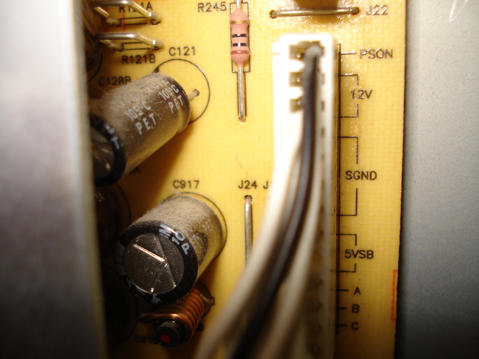

                                  I have the same model Vizio, that will not power on, the vizio on the front lights up orange. I only have 5 volts on the power supply, the other 12 v and 24 v have no reading, my question is: If it won't power on should I get the 12v and 24v readings in standby mode or only if the set turns on? Thanks in advance.
                                    The 5v standby is an always on power supply that runs the minute you plug the TV into the outlet. The 12V/24V is turn on by the main board that sends the PS_ON to the power supply to turn on the 12v/24v section.
                                    So please post the pictures of all the board and closed up pictures of the connectors so we can read the labels on them so we can tell you which pin to test, please use GO ADVANCED and use the attachment function to upload the pictures.
                                    • MisterD
                                      • Oct 2012
                                      • 668
                                      Here are some pictures, I also should say that the PSON pin 1 has absolutely no voltage either, so I'm only getting the 5v standby and when I try to power it on nothing happens, I checked both fuses on the motherboard and they are good but the 3.3 v that is required for the PSON is not present, Is it possible to apply 3.3v to the PSON pin connector without unhooking any connectors to see if the set will then power on? or can that cause damage to other components?
                                      • MisterD
                                        • Oct 2012
                                        • 668
                                        Here's one more picture.
