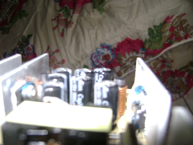

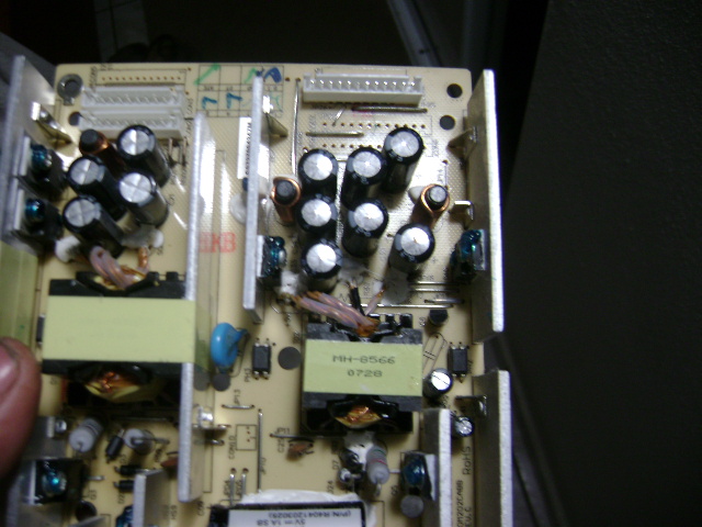

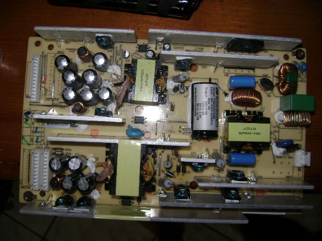

    Hi and thanks for the admin for letting me be part of this forum.
    I have a Digital Lifestyles LCD TV, model : LT26407. It doesn't turn on. When you connect the cable to the outlet, you can see that current is there because the standby red light is on, but when I hit the Power Button, the red light blinks to green for a fraction of a second, (goes back to red) and hear a realy click inside the TV.
    I did a search on Google and found out that the problem is bad capacitors in the power supply. I removed the back of the TV and took a look at the power supply seeing that 7 CapXon capacitors ( 1000uF, 16V) are domed shaped on top of them. I measured them and according with the rule they are 10mm diam. x 20mm tall.
    That site recommend to change them but a higher voltage ones because heatsink is pretty close.
    I live in Puerto Rico, Caribbean Sea and ambient temperature is from 80-100 degrees F.
    I did a search about caps characteristics and saw the good and bad capacitors manufacturers.
    Taking into consideration ambient temperature and quality, should I stick with good brand name caps staying in the 16V or should I pay attention to the recommendation to replace them with higher voltage ones but cheapo brand names.
    Here are the options I have to buy 10 caps bag on ebay:
    Brand Voltage Size (mm) Price
    Fuhjyyu 25V 10x20 $ 6.00
    No brand displayed 25V 10x15 $ 6.50
    Sanyo (Ultra Low ESR) 16V 10x16 $ 6.00
    Nichicon 16V 10x13 $ 6.00
    Rubycon 16V 10x20 $ 13.00
    The seller of the Rubycons is in US, the other sellers are in China.
    According with you knowledge and experience, should I go for the higher voltage bad manufacturers caps or should I stick with the 16v good manufacturers caps?
    I include pictures of the power supply for you to see the bad caps.
    thanks.

    Capxon does not have a good reputation with forum members here.
    Stick with quality low ESR caps like Panasonic FR, FM which you can purchase from digikey.com. Or Rubycon MCZ from badcaps.net at
    https://www.badcaps.net/store/produc...products_id=44
    DO NOT purchase the cheap caps (regardless of voltage) from questionable sellers on ebay. Some are fakes.
    In addition, members will recommend that you replace ALL the caps on the power board except the largest one which rarely, but not never fails (especially if the remaining ones on the power board are Capxon).

      This power board looks like similar to this case
      https://www.badcaps.net/forum/showthread.php?t=12316
      --- begin sig file ---
      --- end sig file ---
        Re: Digital Lifestyles LCD TV
        retiredcaps, you are right. That powerboard is the same one. By the way, those are the same bad caps I have in my board.

                        I ordered the 1,000uF 25V and 470uF 35V caps from badcaps store and installed them in the power supply, and TV turned on finally.
                        Thanks guys for your help.
