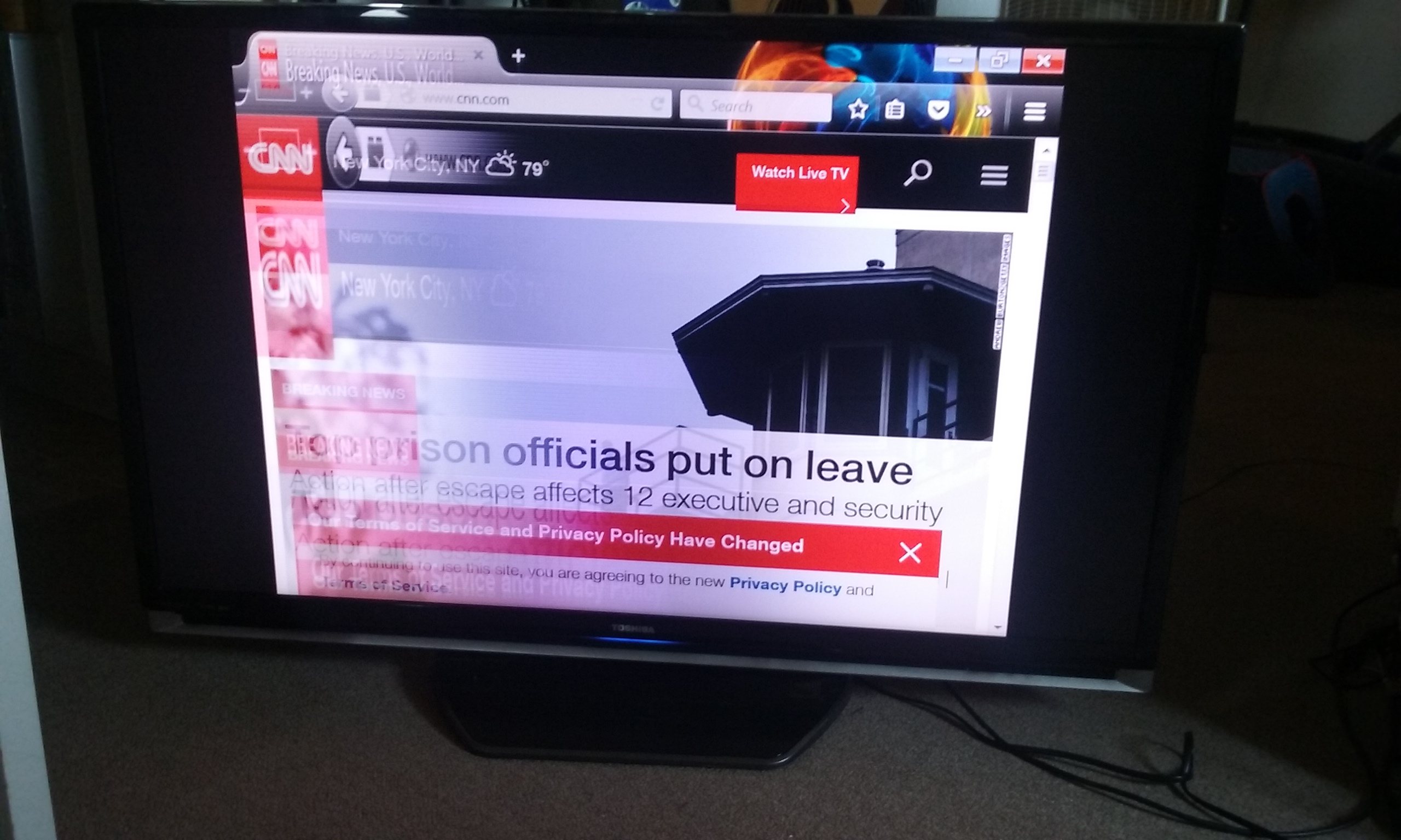

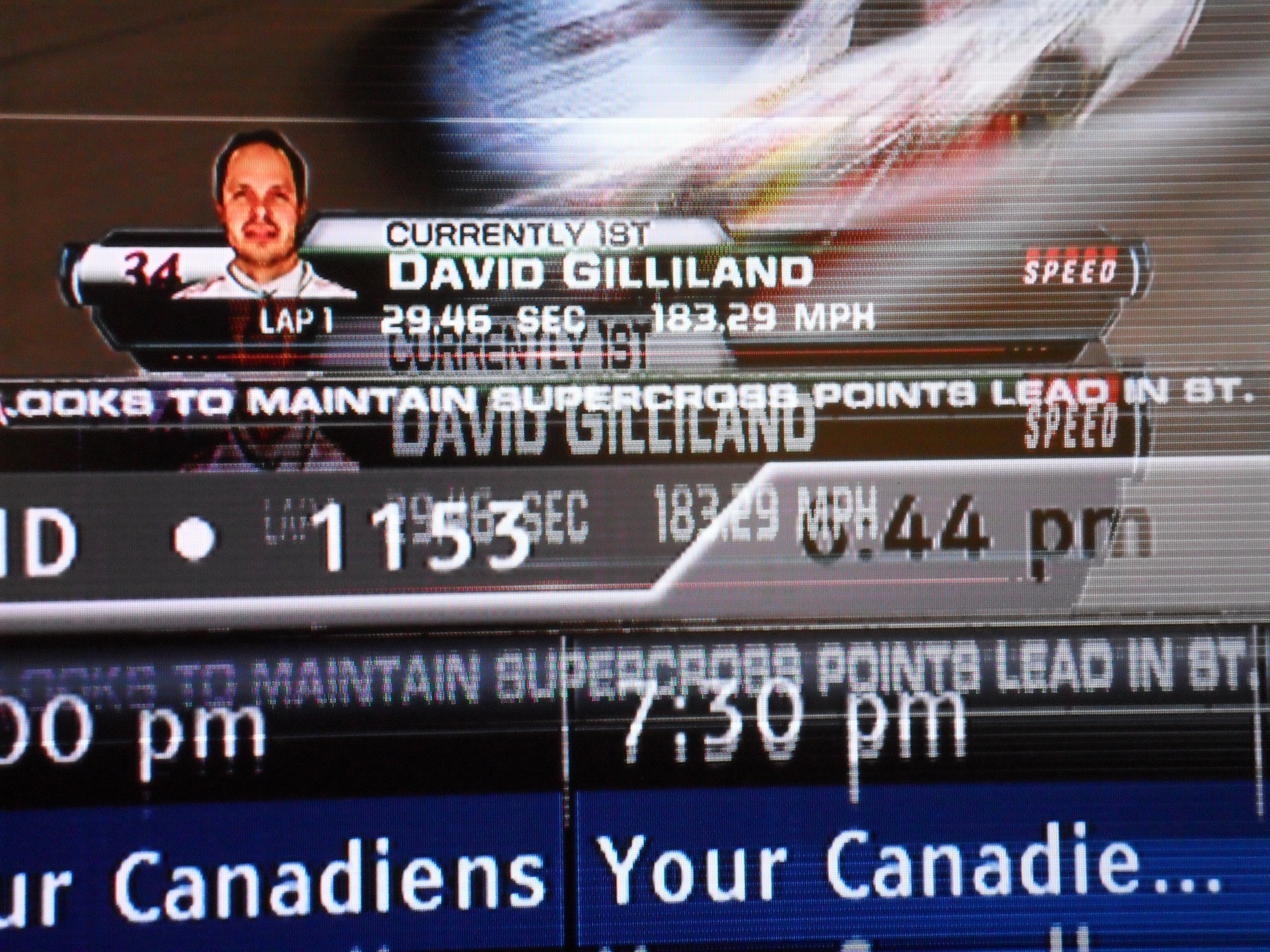

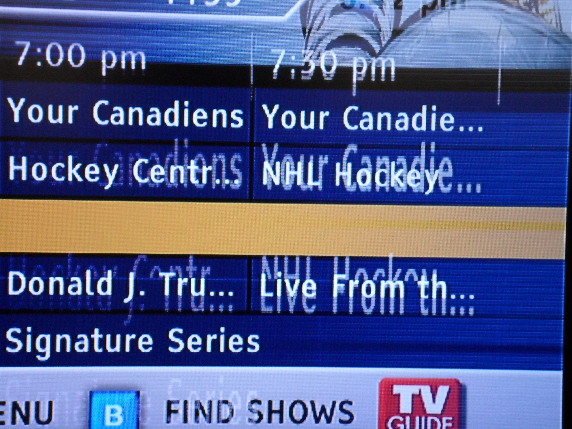

    Hi everyone,

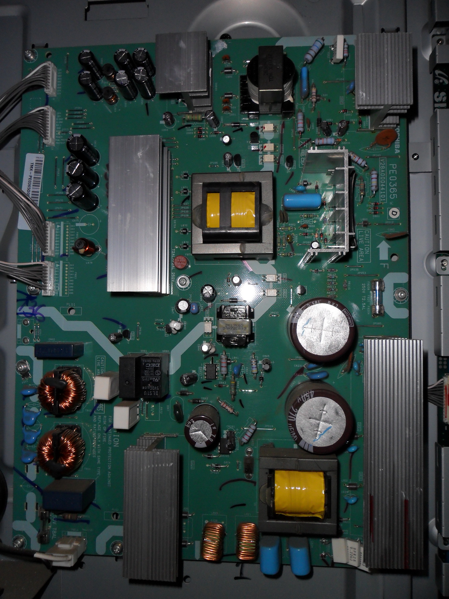

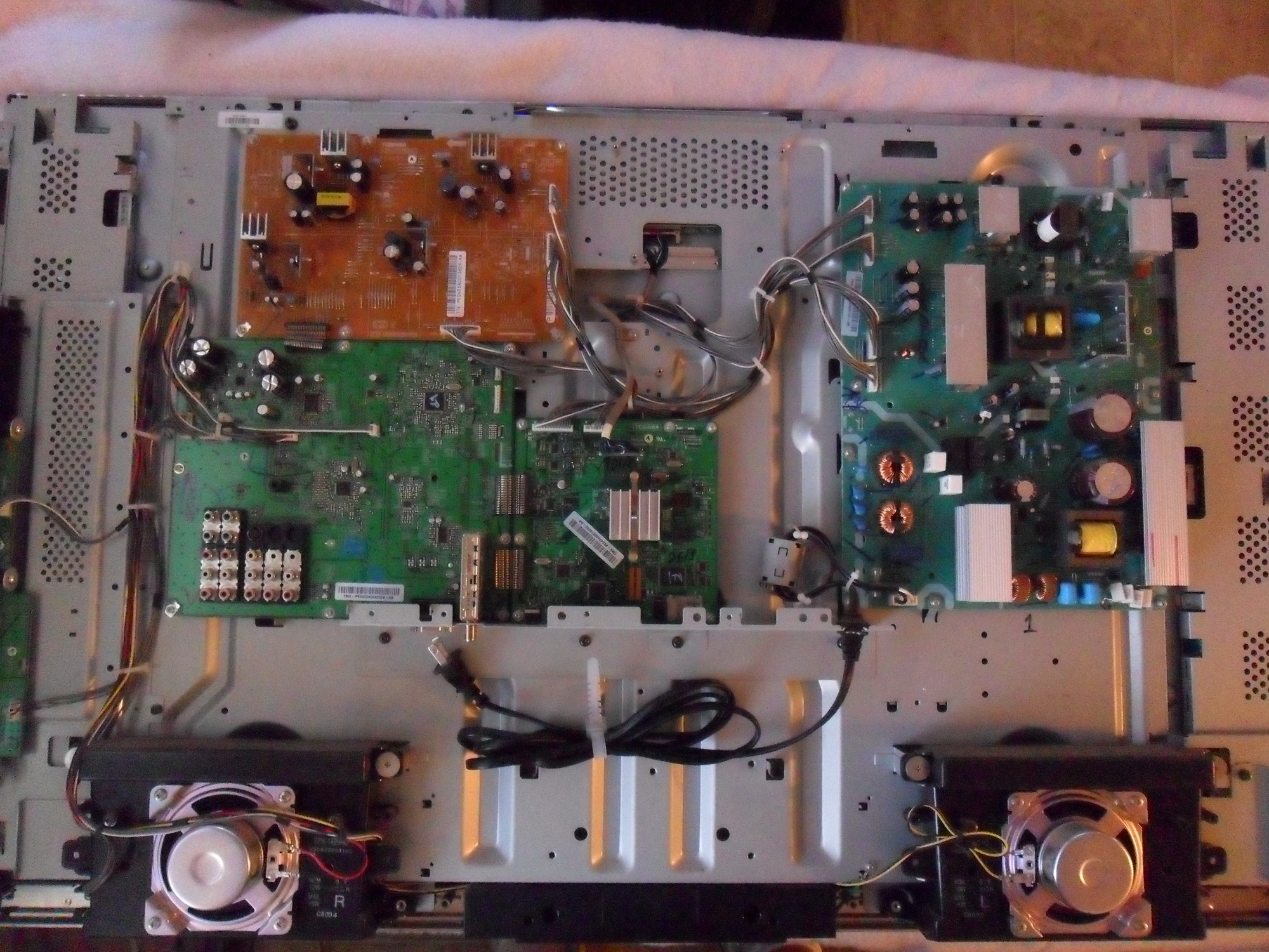

    I picked up my first TV from an electronics repair shop that was going out if business. It's a Toshiba 46RF250U chassis TAC774. I've repaired a dozen or so lcd monitors but this my first time attempting a TV. It's has a couple of vertical lines going down on the right side of the screen, the left side looks like its ghosting in blocks going horizontal and as it gets to the right side it clears up. It looks like the repair shop replaced most of the caps on the power supply board cause there are someof the larger ones are nichicon HE that look brand new, and there are a lot of sharpie marks on the boards. They told me that it probably needs some boards replaced. I will get better pics of the boards when there is more light. I tried to find the service manual but I can't find one.
    Anyone have any ideas what to check or what might be wrong(I hope no one says it's the panel)?

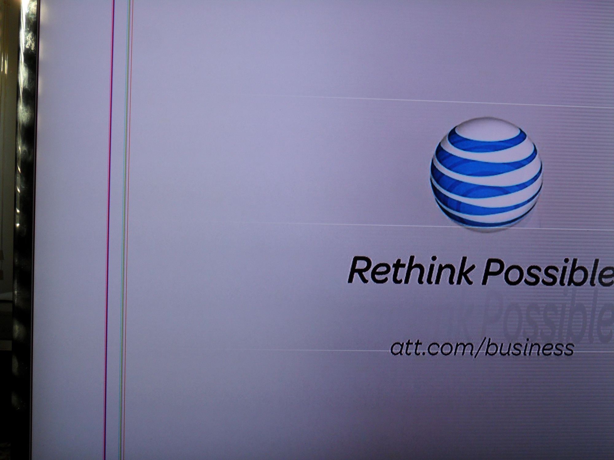

      Those vertical lines are 95% tab bonding on the screen itself & not a board issue look it up its sometimes fixable with pressure but if not its not worth chasing the other issues that may be the t con or the main for the other distortion
        Re: Toshiba 46RF350U 46" LCD chassis TAC774
        I agree that it looks like bad tab bonding, you can see double images.
        http://s807.photobucket.com/user/bud...tml?sort=3&o=2
          The stuck lines may be a sign of a bad driver IC though (not repairable)

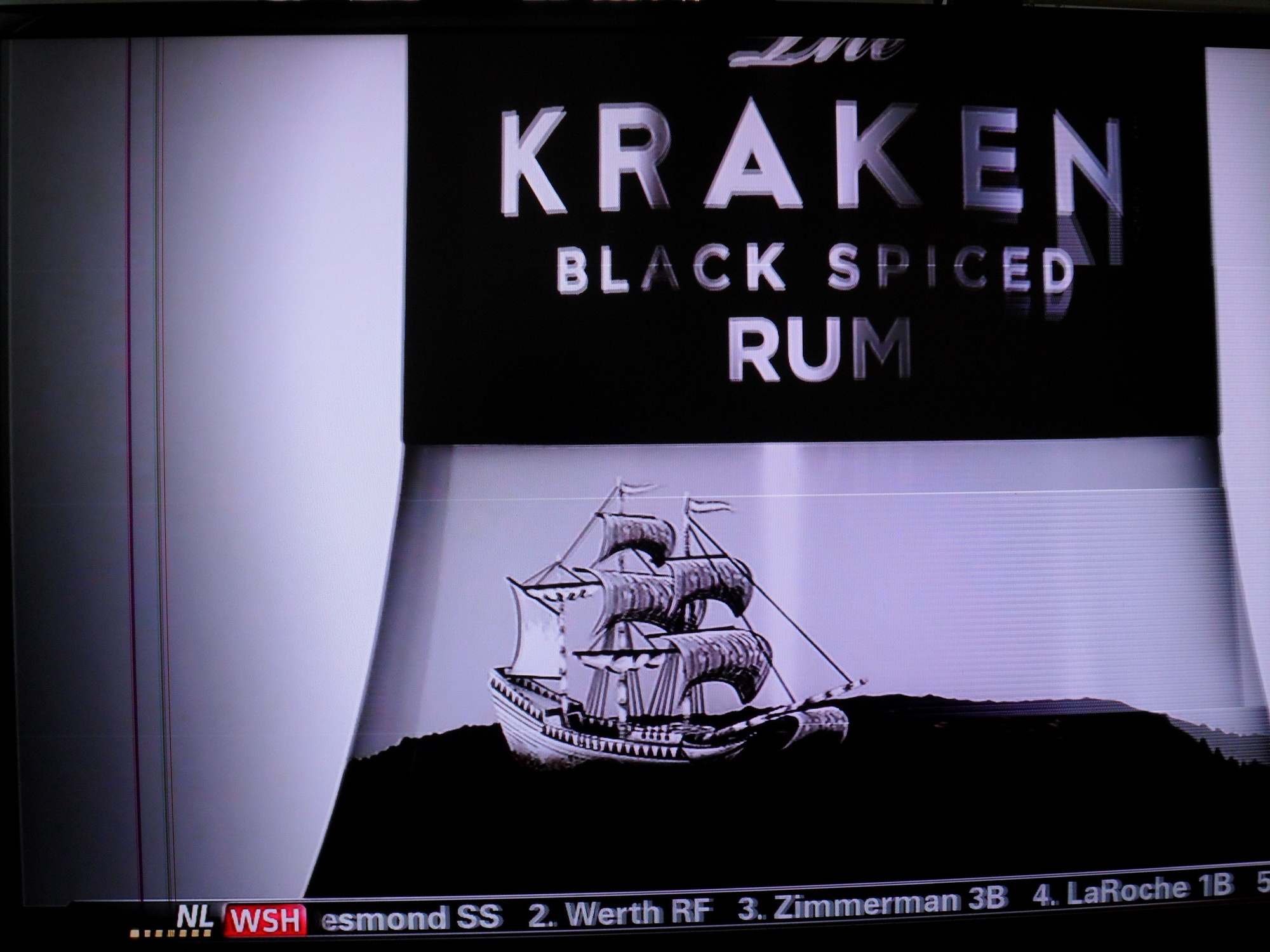

            Just picked this same model up for free, same issue. Bad tab bonding? I assume it's something that happens over time?
            • JDC
              • May 2015
              • 273
              Update: I was fiddling around trying to figure out how to get the front bezel off when the issue seemed to have corrected itself.
