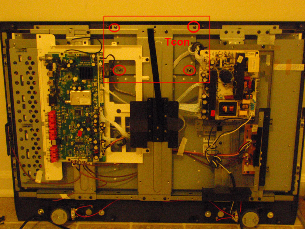

        Re: vizio 50 hdtv 20a have sound no picture
        Do a visual inspection for swollen caps, burned/overheated components, etc (especially on the power supply and inverter). Also check the fuse(s) on the tcon. The attached image will show you where the tcon is located.
          What is the exact model number of the TV? There is no Vizio 50 HDTV 20A; there are Vizio VP50 HDTV20A and P50 HDTV20A and they are plasma TVs.
          Odds are you've got a shorted buffer(s) and blown Y-Sustain.
            My fault...forget what I said if it's a plasma TV
