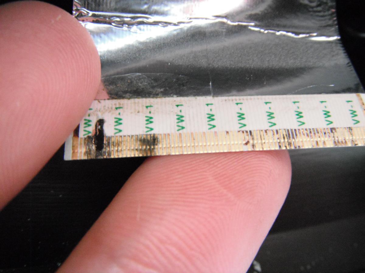

    I recently acquired this tv and it doesnt post a display. It has sound and volume and channel controls all work just doesnt display. The backlight is on and does flicker while changing channels and source but its just a dim white blank screen. Inside are three boards a power supply/inverter board, a main board BN41-01181A printed on board then on sticker is BN96-11410A with all the inputs rca/ hdmi/ vga/ also on this board goes to the speakers. then through a ribbon cable the final board is a 320ap03c2lv0.1 LCD controller tcon board. I can take pictures of any board needed just need some advice where to begin to look with no display symptom on this link http://www.justanswer.com/tv-repair/...ure-shows.html it looks like case 14 fuse open, abnormal power section

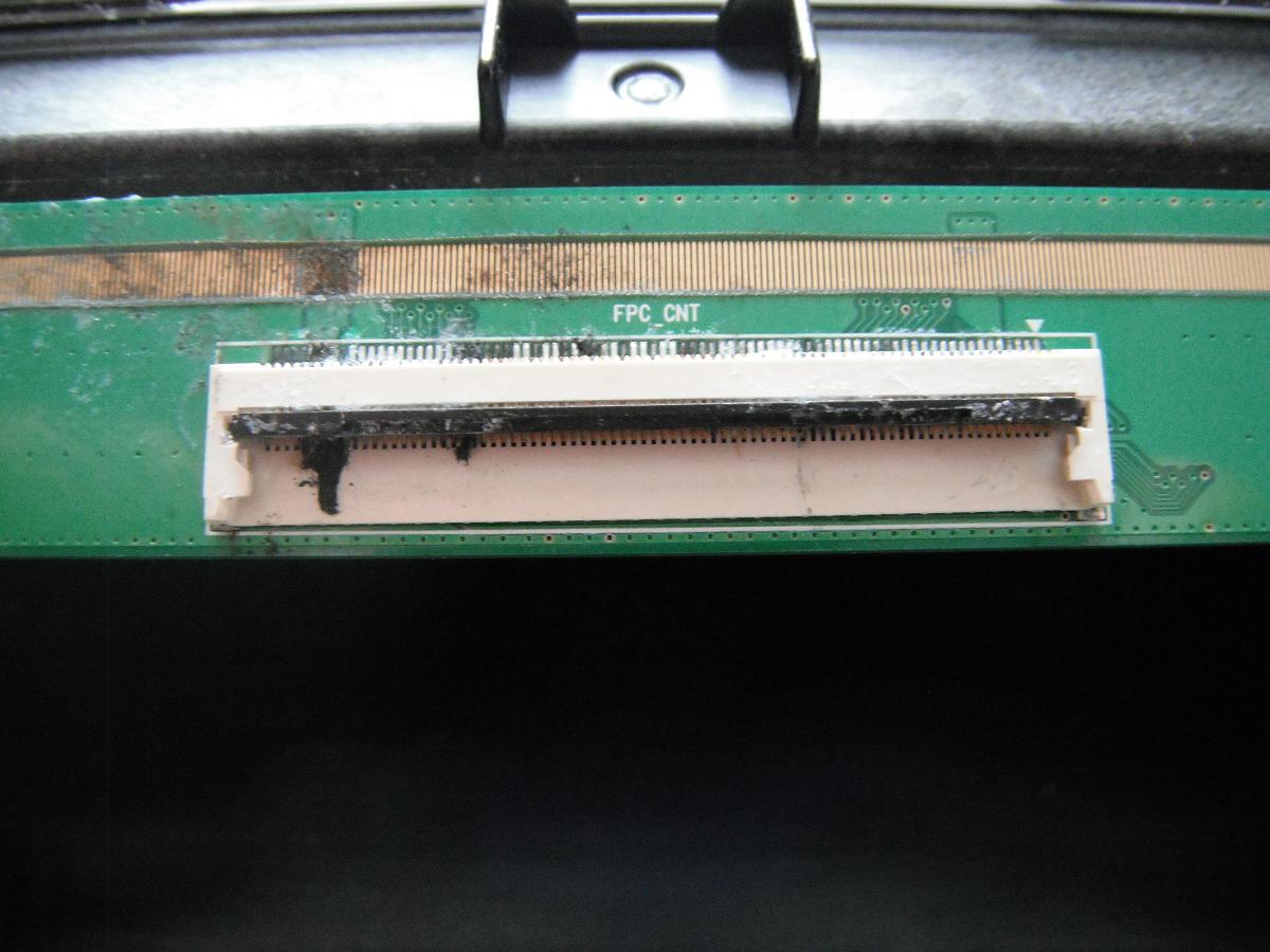

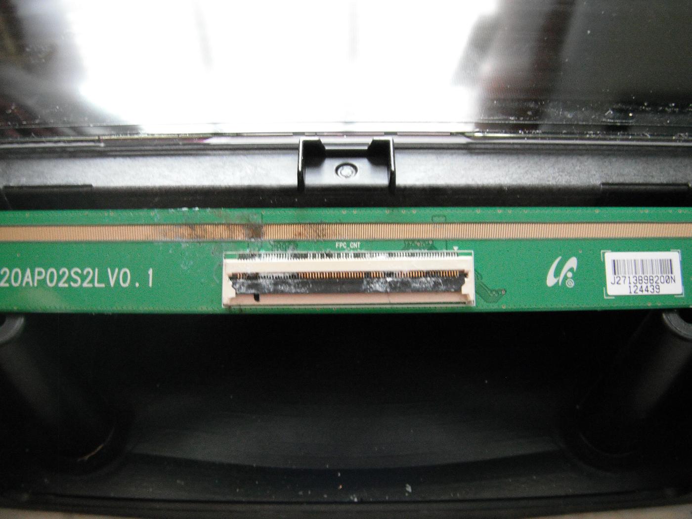

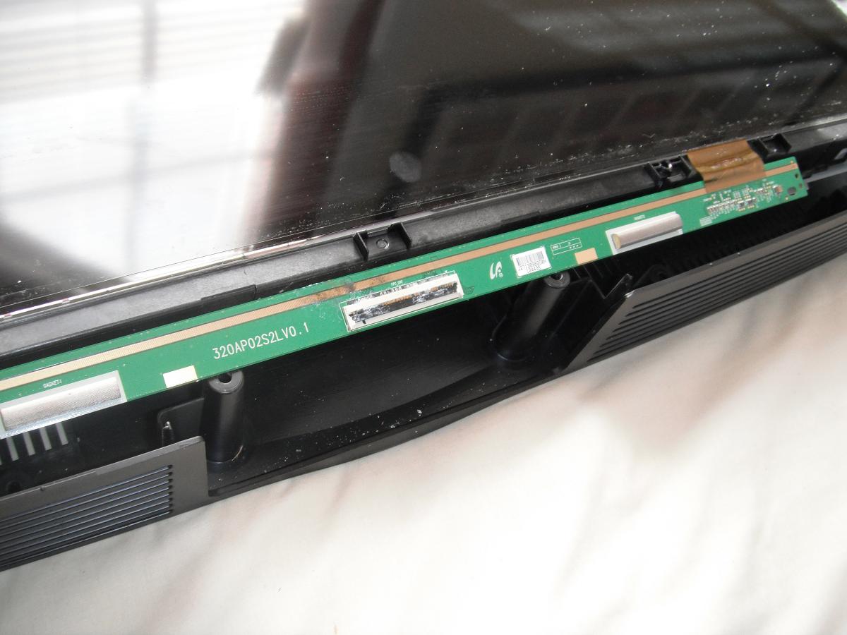

            ok after reading through the troubleshooting guide I came to the conclusion that its not getting signal to the panel itself. and I found it! I am having trouble uploading the picture to this site but on the bottom of the lcd panel there is a small skinny board with a ribbon cable from the tcon and then two tiny ribbon cables soldered? to the board that feed directly into the lcd panel. the ribbon cable from the tcon to this board was all corroded and small piece burnt? I am going to tempt in cleaning up the grooves but the ribbon cable looks done hopefully the connecter could still be good the board does look fine I do have good pictures but cannot upload them and will try later but now is this fixable? I dont think I could replace this board because it has very fine ribbon cable soldered to it?

                here are the pictures

                  ouch... looks like somehow water got on/in there and shorted stuff out

                    Yes, junked. Liquid got in.

                      nothing could be done? i cleaned it up pretty good with a toothbrush not sure if i could use some kind of cleaner its just this one connecter all others are like new maybe somthing splashed it?
