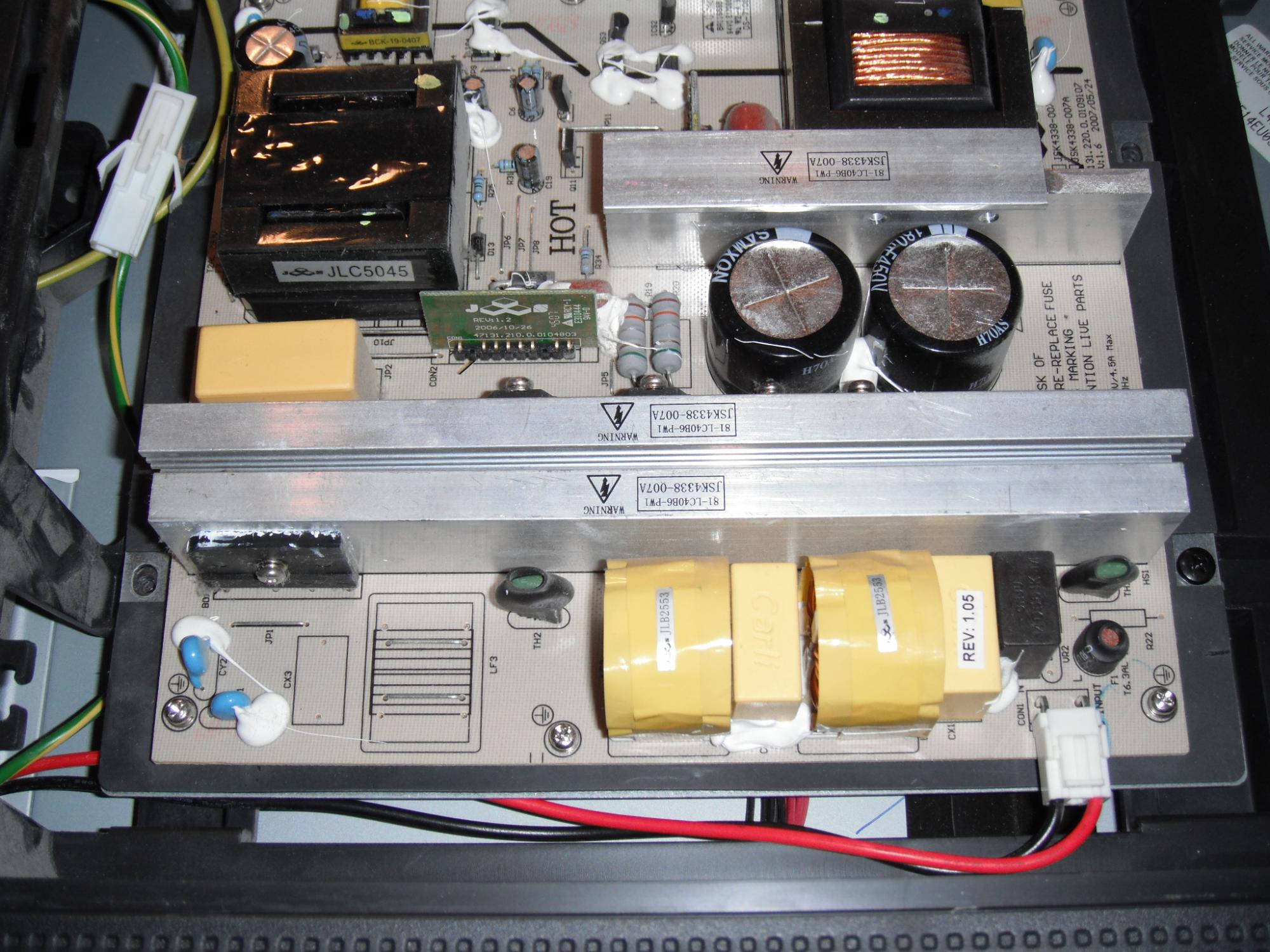

    Ok.

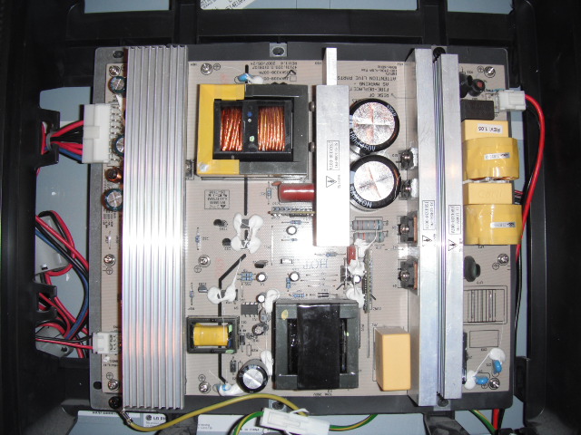

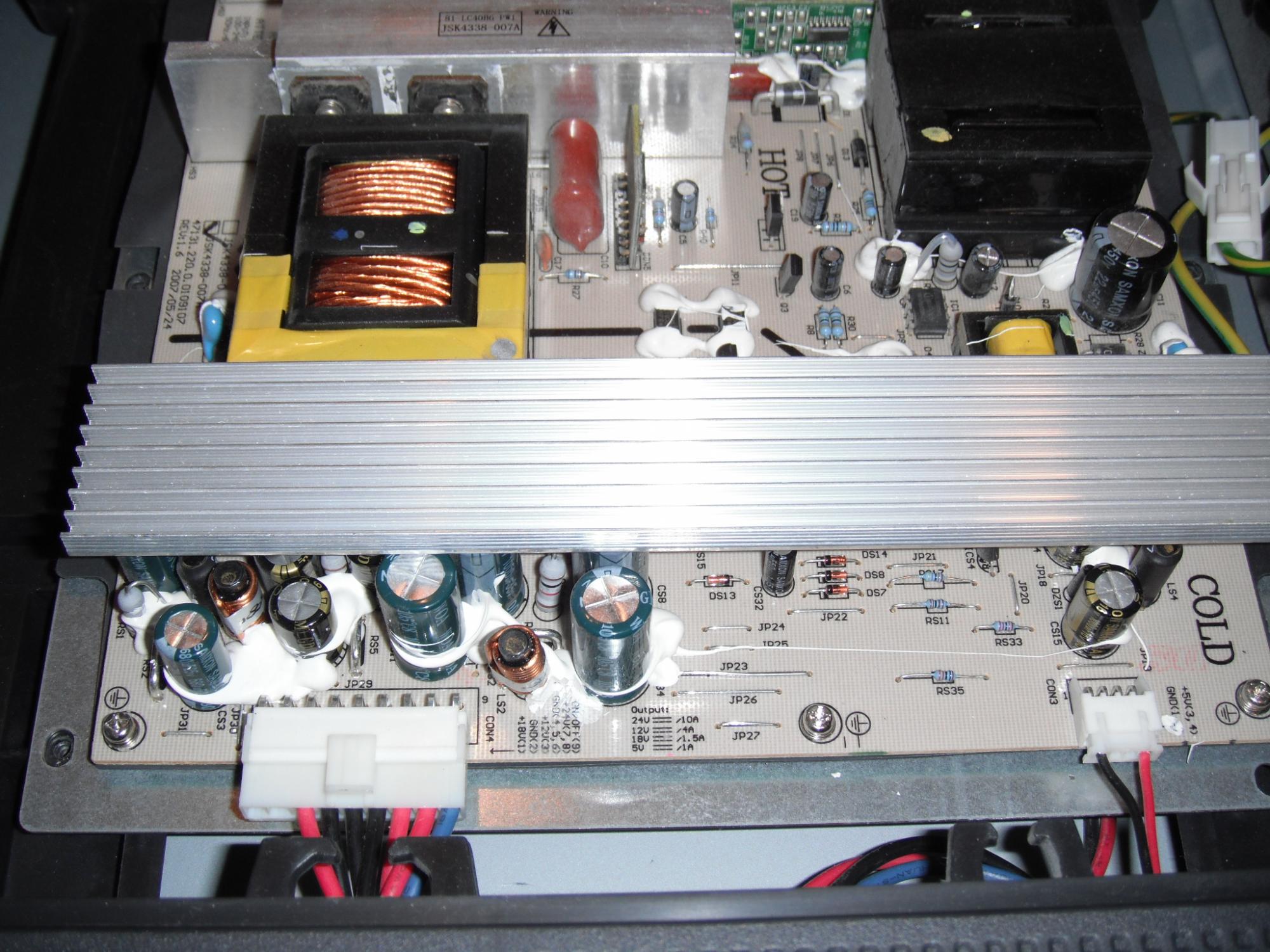

    Tested the power supply. Bear with me i am new at this and trying to learn.
    Might of bitten off more than i can chew but i'm still moving forward.
    Power Supply
    110v coming in.
    i have to 'outs' on the power supply.
    One read +5v(3,4) gnd(1,2) i get 10v coming out
    second says +18v(1) i get 25v
    gnd(2)
    +12v(3) i get 25v
    gnd(4,5,6)
    +24v(7,8) i get 50v
    On-Off(9)

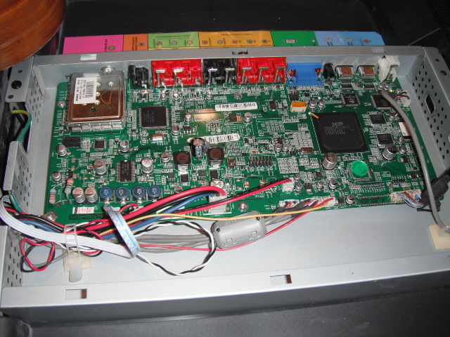

    Video Board
    I followed the wires to the video board and get the same readings
    There are two green light that light uop on this board when i power on the unit. After 15 sec(approx) one goes off and the other stays on. If I hit the power button on the console of the tv it does the same thing.
    Anybody know where i should look next.?!
    I have included some pictures.
    Power supply
    video board

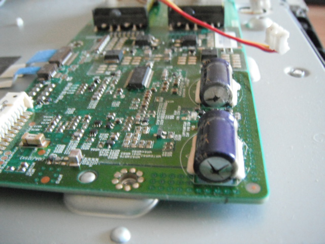

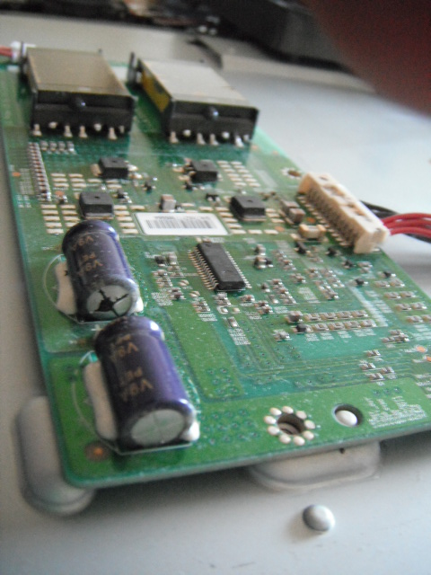

    old lcd master and slave with burned caps

      Re: RCA l42wd22yx6 no video or sound
      Hmm, all the voltages are almost double what they should be.
      Let's make sure the multimeter is working correctly first.
      1) Put it on 200 ohms scale if manual. Touch the 2 probes together. What reading do you get?
      2) Measure a fresh or new AA or AAA battery? What DC voltage reading do you get?
      3) What make and model is your multimeter?
      4) We will need a picture as close to 2000x2000 resolution (the forum max) of your power board. The current one is too small to read. PS. Thanks for using the manage attachment function to post your picture.
      5) If your multimeter is working correctly, you may have a solder bridge or short somewhere that is doubling up the voltage?

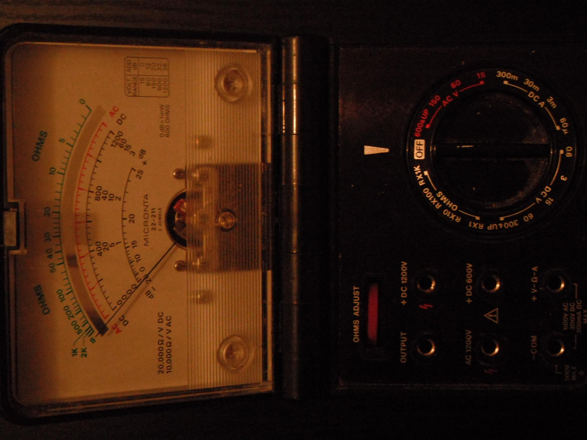

        Hmmm, yes i thought that to be wierd.
        Considered the multimeter to be defective( or the user )
        1. I do not have a setting for 200ohm. In ohms i have RX1, RX10,RX100,RX1k. If i set to RX100 and touch the prbes i get a reading of 12-12.5 ohms. There is an adjustement on the multimeter
        2.dc v 1.5
        3.dont laugh but its old. Needle style Micronta 22-211 2 jewels, pic attached.
        4. pic attached
        5.???? Is this bridge from the manufacturer? Is a short a short circuit that might be repairable by an amateur?
        Are these pics better resolution? I took them in 12m mode.
        It wont let me upload my hires photos, it says contact admin.

              • retiredcaps
                • Apr 2010
                • 9271
                Here is one idea to verify the voltages.
                Remove all your connectors from the power board so that the power board is "standalone". That is, the main board, inverter, etc are all disconnected so the power board is running with no load.
                Remeasure the DC voltages and compare it to the legend. See if the voltages are still doubled or not.
                PS. 12.5 ohms is a high reading for shorted probes. Check your battery inside the multimeter. Maybe you need a new one? If working correctly, it should read around 0.2 ohms.

                  I changed the battery in the multi meter. The needle seems to stop before maxing out at the other end. I will get a new one tomorrow, maybe an updated version. :-)
                    1) On the power board, are those green caps Samxon GF? If yes, they are a problematic series.
                    2) I forgot to ask what brand and series you used for cap replacements on the inverter?
                    --- begin sig file ---
                    --- end sig file ---
                    • HotHead
                      • Mar 2011
                      • 43
                      Yes, it looks like most if not all cap are samxon. Oh lucky me...
                      The replacement cap are nichicon. The tech told me they were good quality.
                      Is it safe to assume that some of the samxon cap are duds even though they show no signs?
                      Is it worth checking and replacing theses caps or buying a new board? I do have some time on my hands.
                      Anyway first things first, new meter and test again.
                        Samxon makes a number of series. Samxon GF are a bad series. If you look at the caps, do see the markings GF?
                        Nichicon makes a number of cap series as well.
                        Before buying a new board, let's verify what is wrong first.
                        edit: Think of car. Honda makes the Accord, but it comes in different "trims". E, EX, ER, etc. Same for caps with their "series".
                            The nichicon has the inscription... a9829 pl(m)
                            See FAQ at
                            https://www.badcaps.net/forum/showthread.php?t=2280
                            Nichicon PL are not low ESR caps. On the inverter, it may not matter if the caps are low ESR or not. Low ESR caps are required on the SMPS.
                              It would be very unusual for all voltages to read nearly double; there are two power supplies on that board. I suspect you were reading the wrong scale. If indeed it is putting out double the proper voltages, I'd say the TV is toast. Some (many) LDO regulators died.

                                my digital multimeter starts to display random results once the 9v battery is done (around 8V or below)
                                was quite a bit puzzled when i measured AA batteries and it showed 4 Volts lolol
                                even more odd that it doesn't show the low battery icon till the battery is all the way down to 7.0V (so you'll be measuring bullshit for a while till it actually tells you the battery's dead..)
                                just saying.. your multimeter might be messed up like that too..

                                  8V? Wow, that is pretty poor design (as Dave Jones of the eevblog would say). What brand and model do you have?
                                  In his $100 multimeter shootout, the UEi DM391 (using a 9V battery) low battery indicator came on at 3.2V DC and was still within spec.
