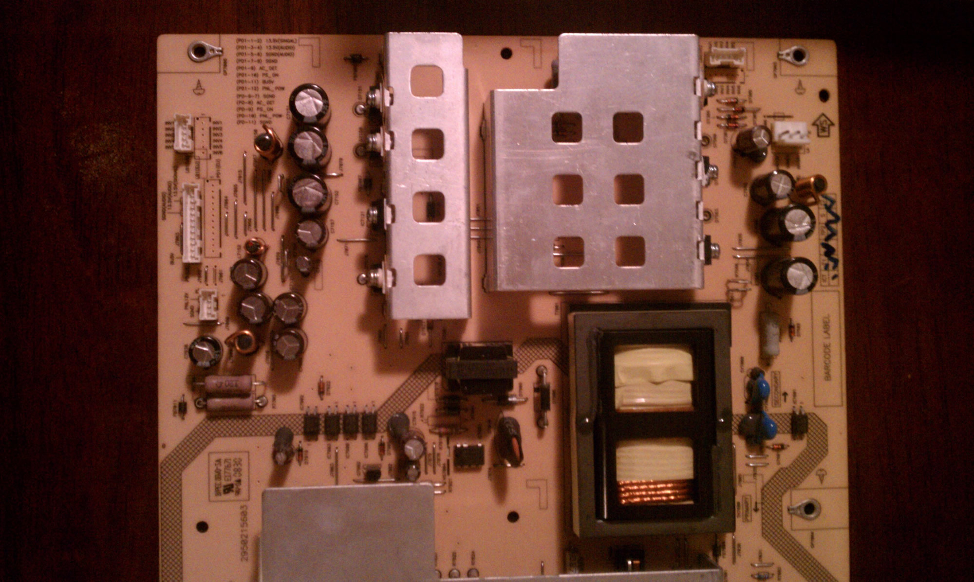

    I picked up a 52" Sharp LCD TV that has what I think is a power supply issue.
    I am not a total noob but I haven't repaired a TV before. I have repaired XBOX's, XBOX 360's, Spa packs and other smaller items. I can solder fine but I am not sure what the problem is or where to look first.
    So when I plug the TV in a relay clicks on and the power light comes on, shortly after another relay clicks(maybe the same one) and the Power and OPC light blink twice then the OPC blinks 3 more times and it just repeats that until I hit the power then it starts over.
    I have tried a few reset techniques like holding the power and plugging in with no change. The TV is apart and I skimmed over everything and it doesn't look like anything is fried or bulging.
    From what I have read it is probably the power supply, I'm hoping I can just replace some caps, relays or something instead of more expensive parts. I will post some pics shortly.

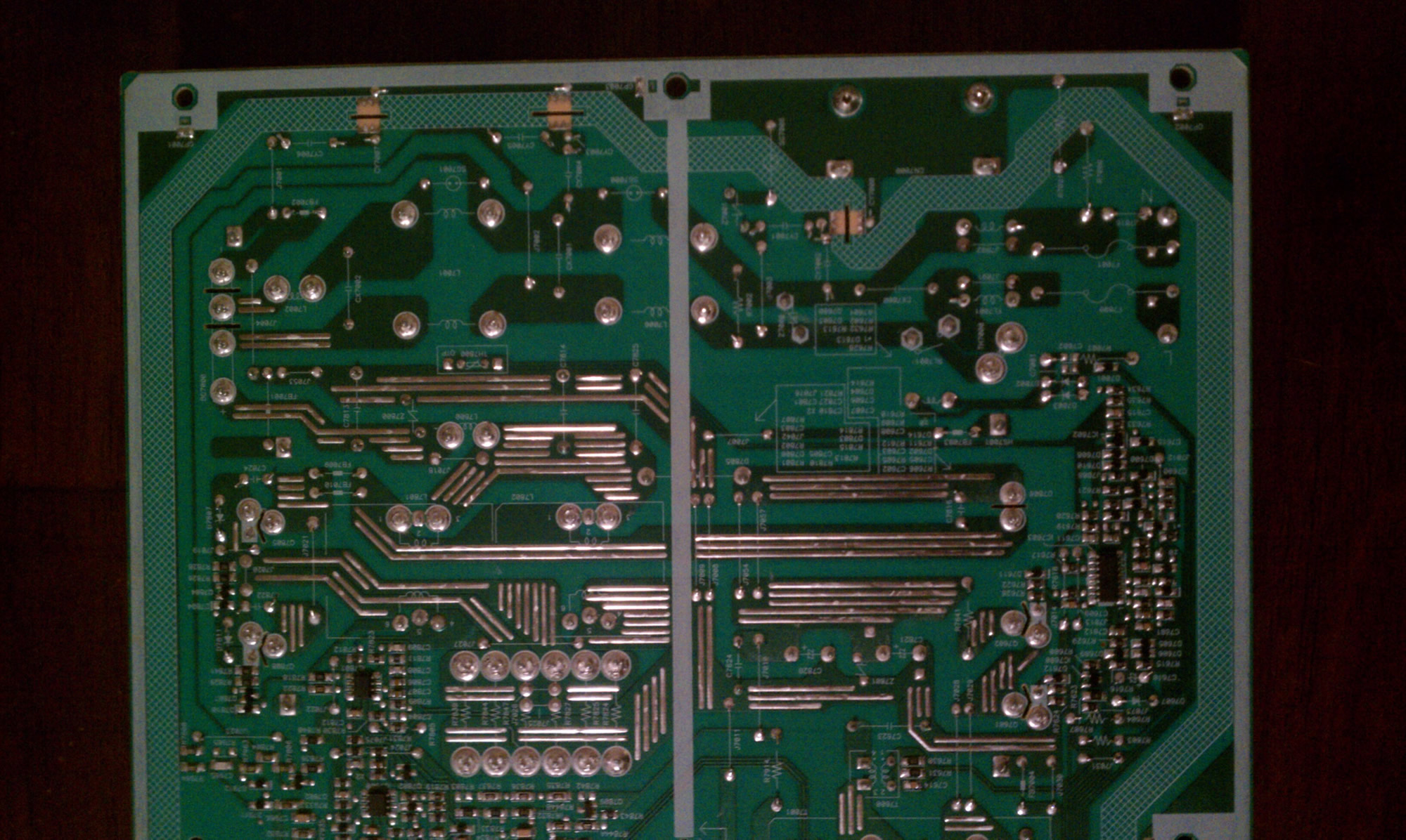

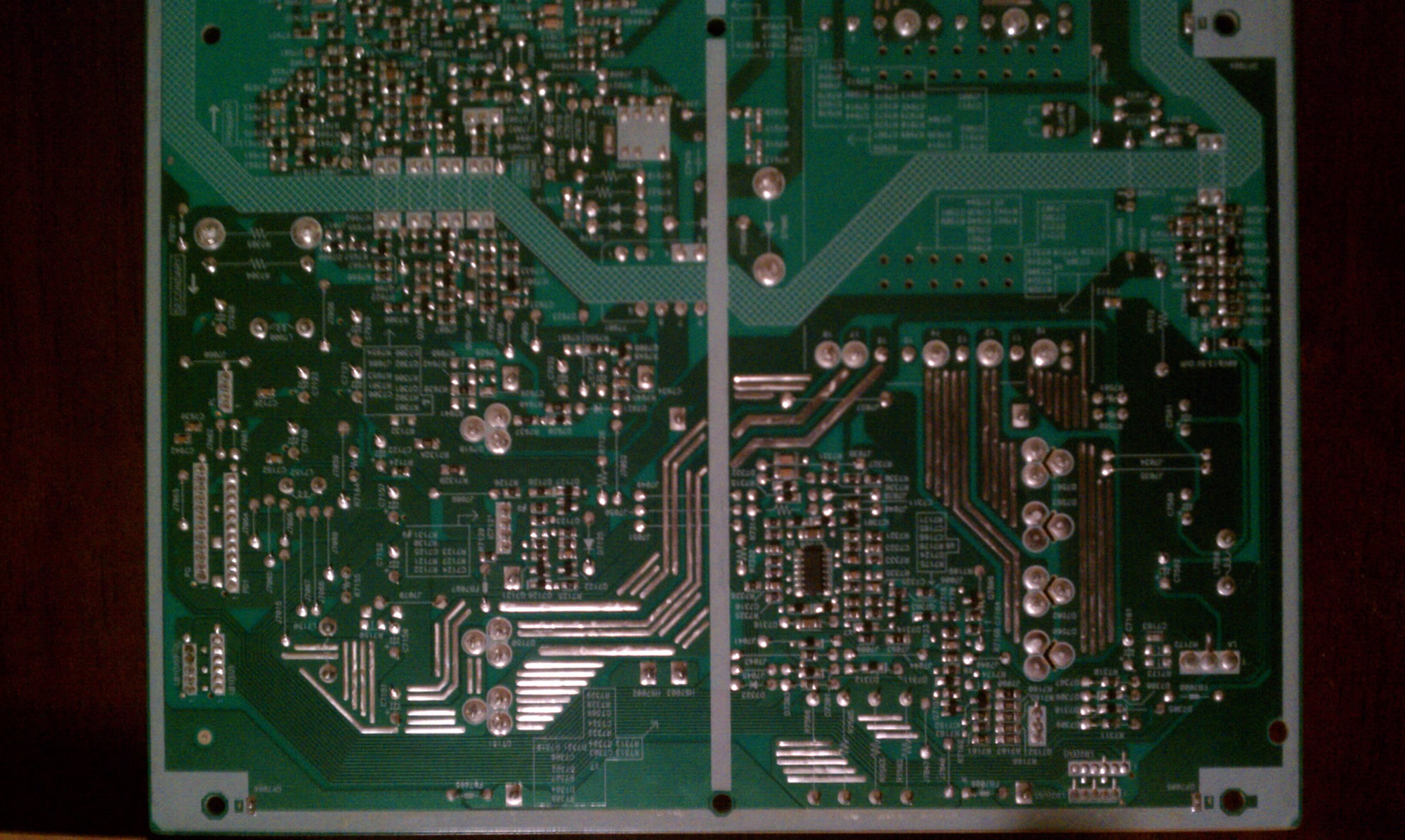

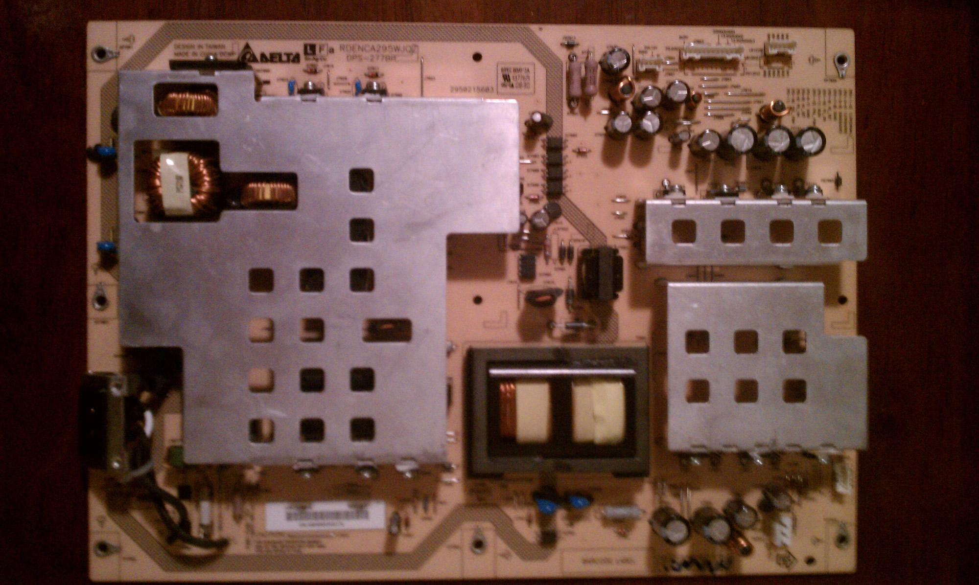

    Here are the pictures if there is a better way to post them let me know.
    Board model
    http://img837.*************/i/imag0328x.jpg/
    Full bottom
    http://img850.*************/i/imag0323.jpg/
    1/2 bottom
    http://img232.*************/i/imag0324y.jpg/
    Other 1/2 Bottom
    http://img153.*************/i/imag0325b.jpg/
    Full top
    http://img35.*************/i/imag0329x.jpg/
    1/2 top
    http://img268.*************/i/imag0326.jpg/
    Other 1/2 top
    http://img849.*************/i/imag0327.jpg/

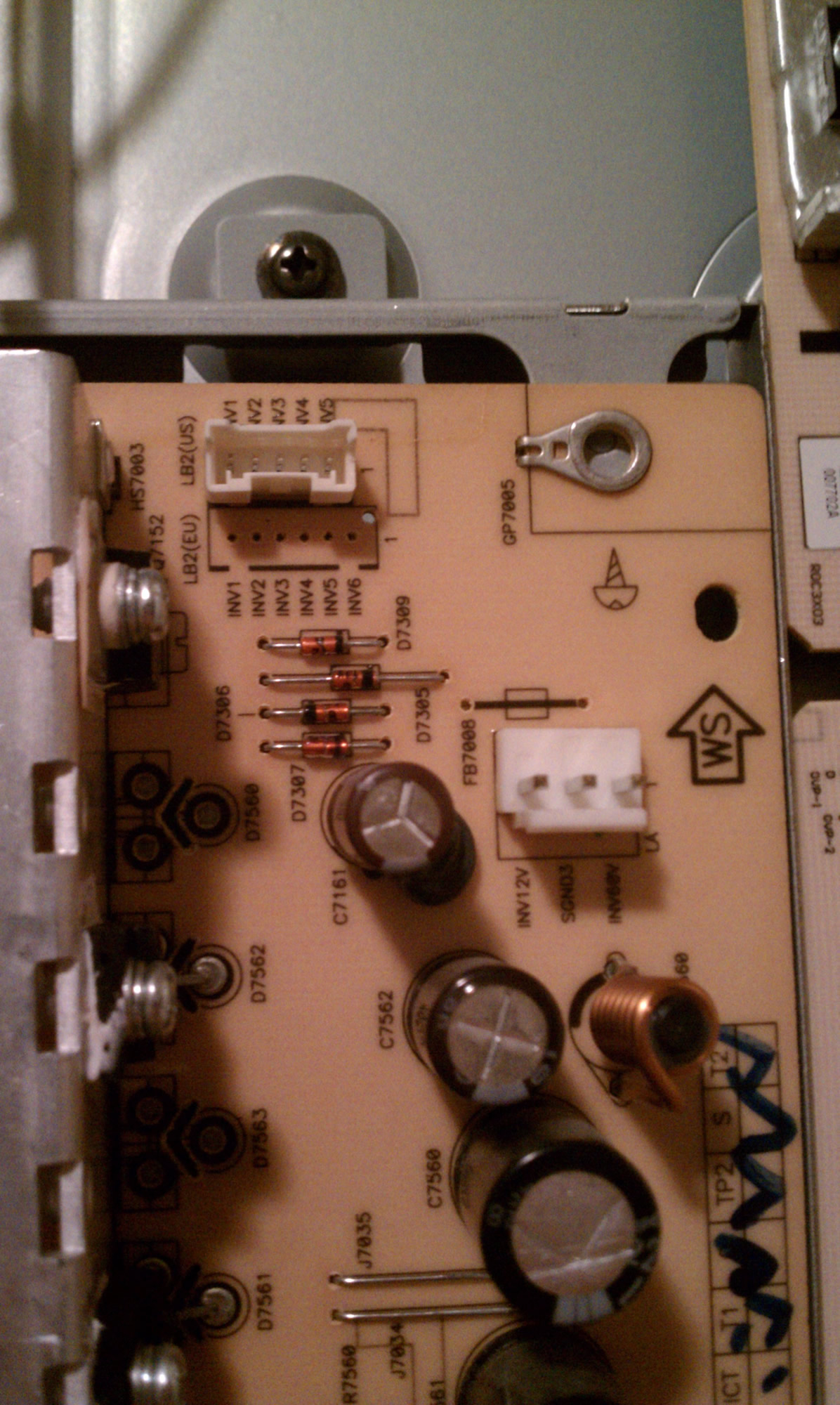

                          Here are some pics of the plus on the PSU. I am guessing caps could cause the no power what else should I look at?

                                    • rayrod81
                                      • Oct 2010
                                      • 205
                                      Re: Sharp LC-52SB55U Power Opc Blinking
                                      It is hard to say without having the board in hand. I would start by checking the voltage regulators attached to the heat sink near the connectors. Then you would want to check any diodes and transistors on the 12V circuit (there look to be quite a few SMDs on the back of the power supply).
