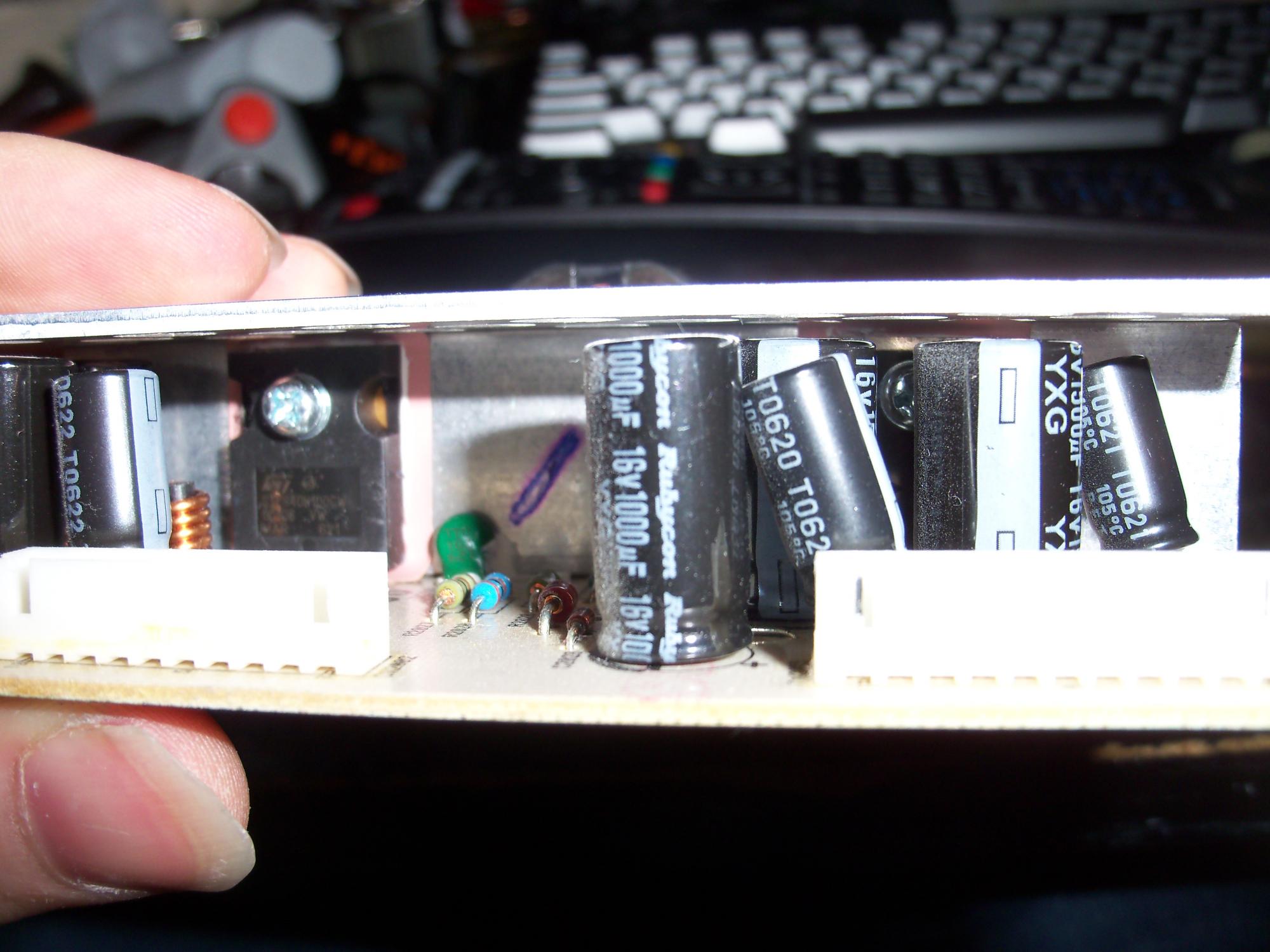

      • mockingbird
        • Dec 2008
        • 5484
        Re: Westinghouse LTV-32W6 intermittent fault
        Can we have a pic of these "Rubycons" on the PCB? I have an inklink that they are fake.

          • rubicondsrv
            • Nov 2010
            • 39
            pics of caps

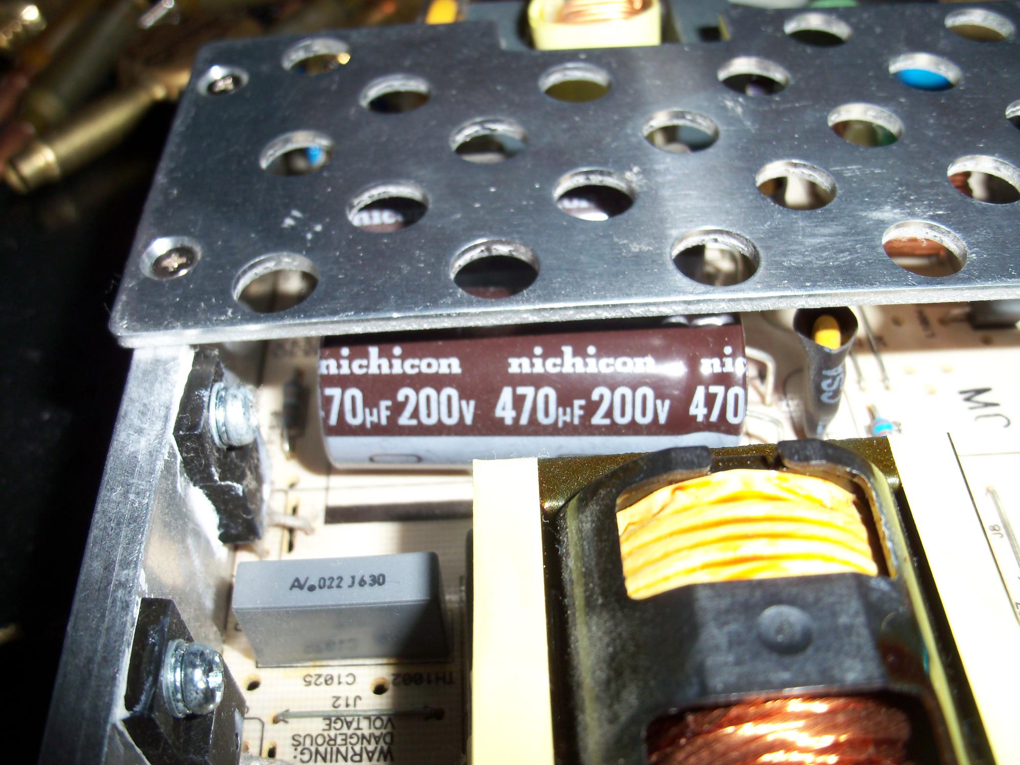

            • mockingbird
              • Dec 2008
              • 5484
              They look ok. The bunge (Underneath the cap), well at least the Nichicon which is sideway soldered so you can see it, what does that look like?

                • mockingbird
                  • Dec 2008
                  • 5484
                  But what does it look like... the underside of the nichicon.
                  Do the bunges look like this:
                  Or like this:

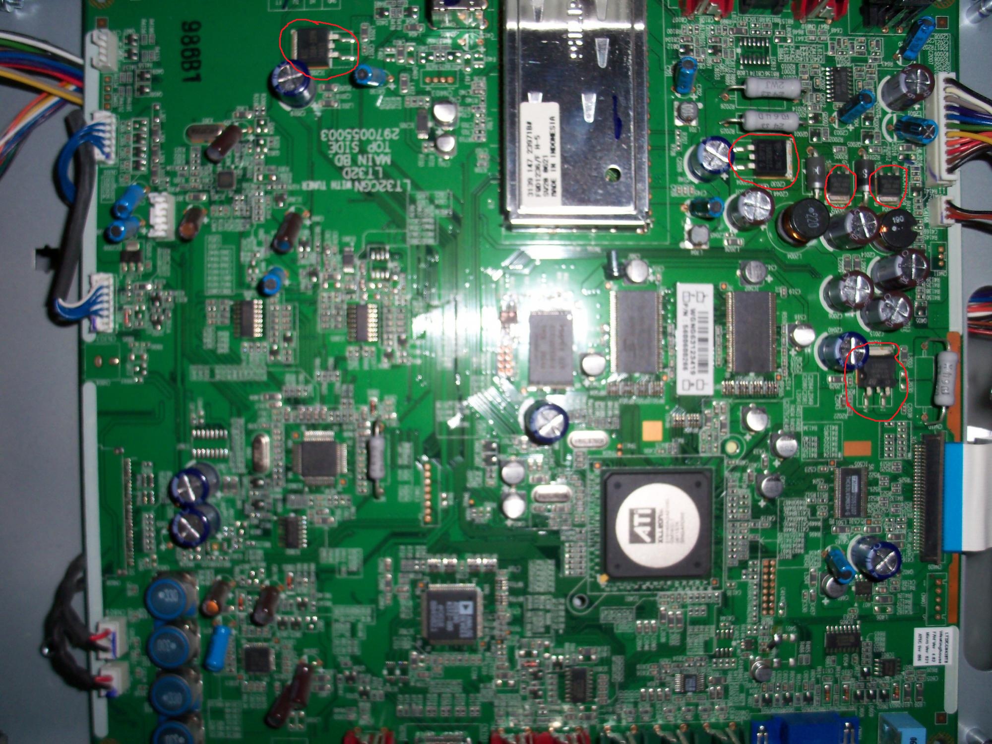

                  • PlainBill
                    • Feb 2009
                    • 7034
                    Originally posted by rubicondsrv
                    looks fine, no leaks or bulging
                    also when the unit cuts out, the blue power light stays on, and the tv must be unpluged and reconected before ot will start again
                    One possible cause of those symptoms is a failing voltage regulator on the main board. Check the output voltages.
                          main board
                          Good move; I was going to comment that it helps to have a picture. I've circled them. For each one, identify the part number. Select a convenient ground point, and measure the voltage on each pin. Post the part number and the voltages you measured. Repeat after the TV fails.

                            • rubicondsrv
                              • Nov 2010
                              • 39
                              ok, i have voltages amd part numbers for the circled parts, but no voltages for when the unit is failed, because now it refuses to go out.
                              7805bd2t
                              2.03,6.54
                              1084-33pm
                              -3, 1.9
                              LD1085
                              1.88, -1.68
                              fr9024n
                              7.68,9.27
                              4.67, 9.27
