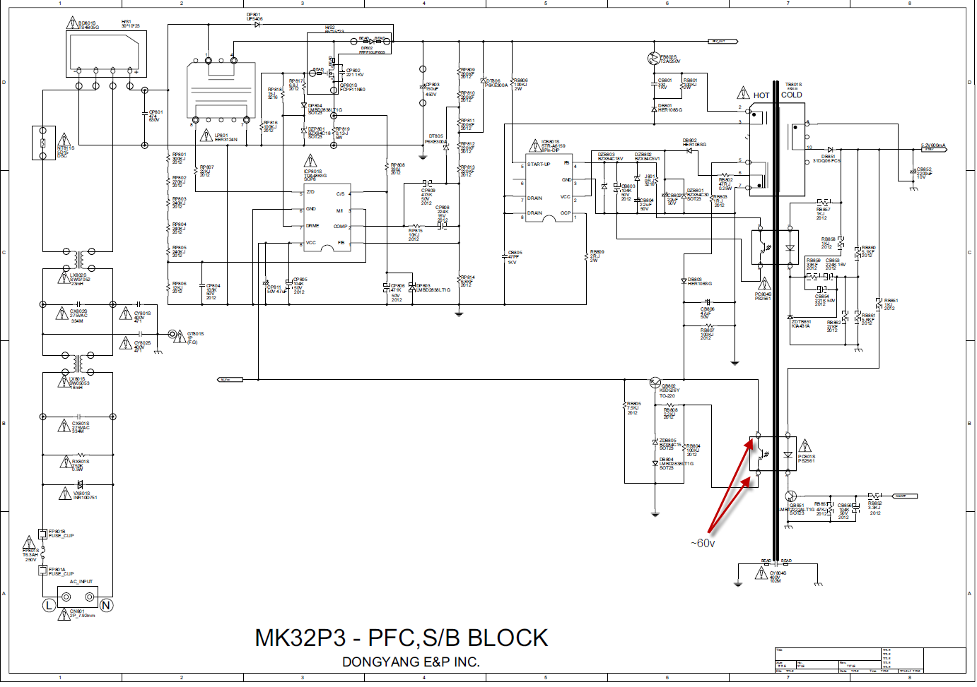

                            i got the new parts on the board, its not shorting out but it wont power on. I am just getting the red standby light and it will flash every once in a while. at the moment i am stumped.

                              since i was stumped, i plugged the board in and took some voltages. while i was doing that the IC at ICP801S got so hot it started smoking and almost took it self off the board. before i order the new chip, is there something else that could cause that chip to fail? thanks.

                                Re: Samsung LN-T3242H power supply
                                i was also getting about 60v at the points shown on the pic. does that seem high?
                                  Not necessarily. That is in the Hot (or Live) ground area. Use the negative lead of CP803? (150uF, 450 V) as the ground point, not the chassis.
