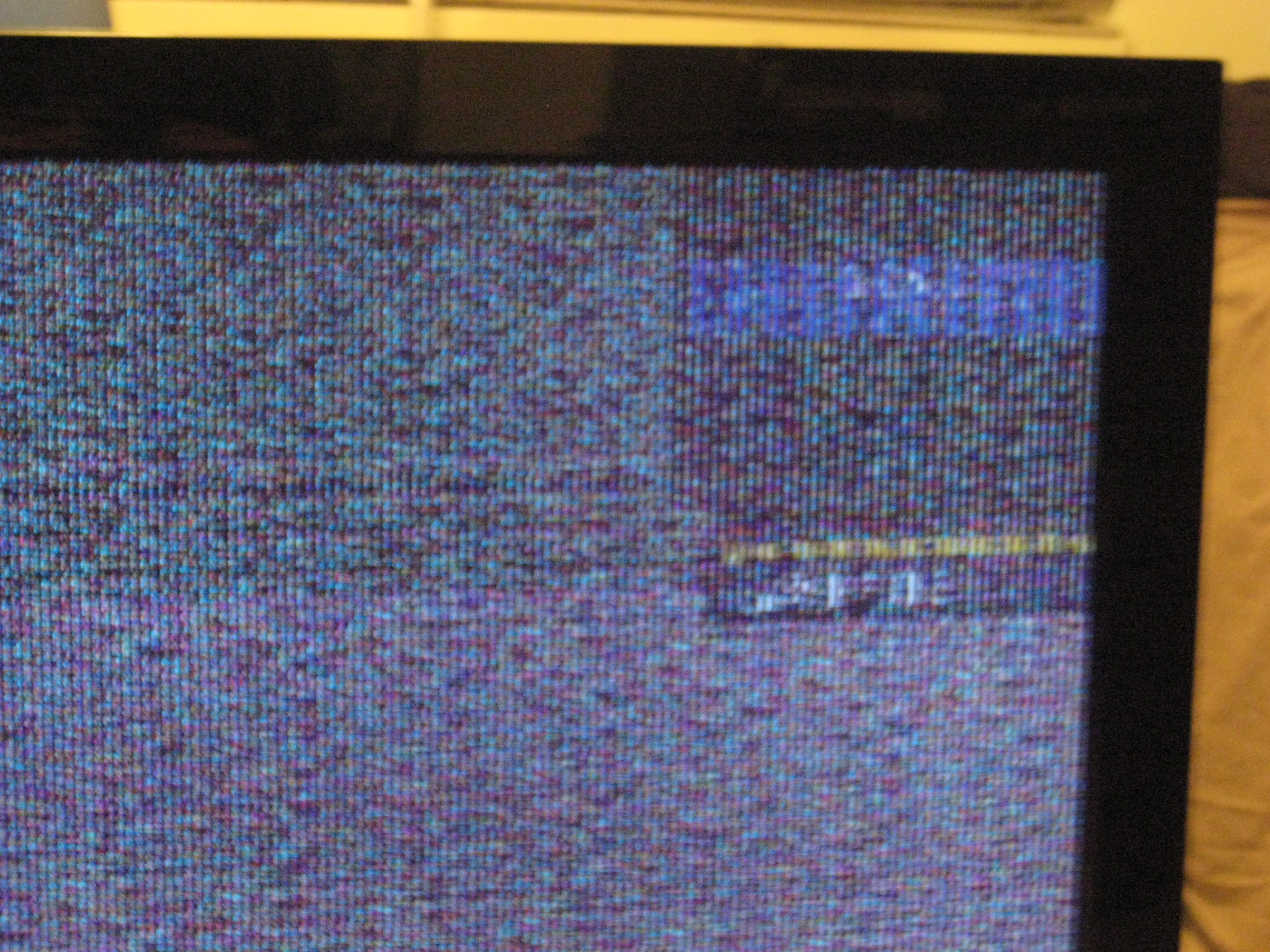

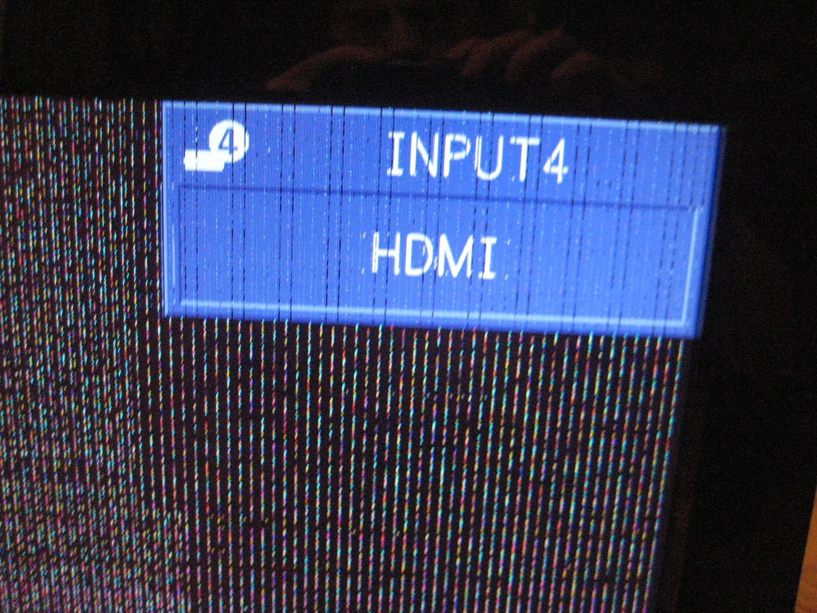

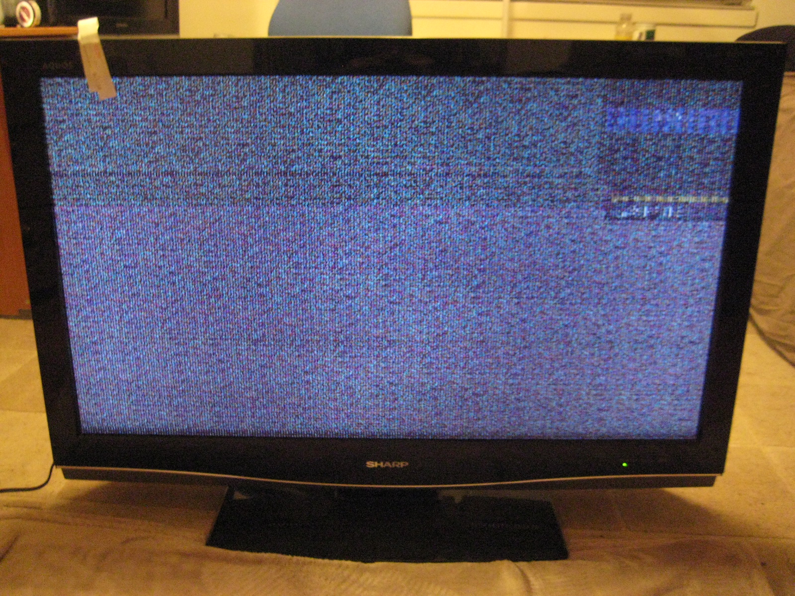

    Hello, my TV display output is not working right. I have multiple horizontal and vertical lines running throughout the display, similar to the infamous scene in the movie The Matrix. The lines are symmetrical, like graph paper. Varying in colours. I have had it diagnosed at the repair shop but I want more opinions. His diagnosis was that the mainboard needed to be replaced. The cost: $400 plus labour. What a joke. Well indeed the price for a mainboard on this particular model is listed as upwards of $400, I have one on its way for $74 all in. I have already disassembled the TV and removed the mainboard. So all I have to do is wait. So why am I posting?
    Well I had another technician look at the TV with a different result. Unfortunately, he didn't speak English well and was reluctant to verify the exact part number the TV needed (maybe he didn't want me to figure out he was going to burn me for $600 minus the $100 part he was going to buy offline). Anyways, I was able to make out a little of what he said. He attributed the problem to the power supply. Now I have examined the psu, no bad caps from first examination.
    So my question is, does anyone have any input? I don't understand why the psu could be the issue if the TV has no problem getting power, lighting all lamps and turning on and off. Perhaps the mainboard isn't getting enough power due to the failure on the psu. Regardless, I am willing to install the new mainboard and if this is unsuccessful, I will order a psu aprrox. the same price.
    Finally, I have also read about the tcon board also causing these similar issues. Any input would be appreciated. Sorry for the long post and I have images if needed.

    Pics. Thanks again.

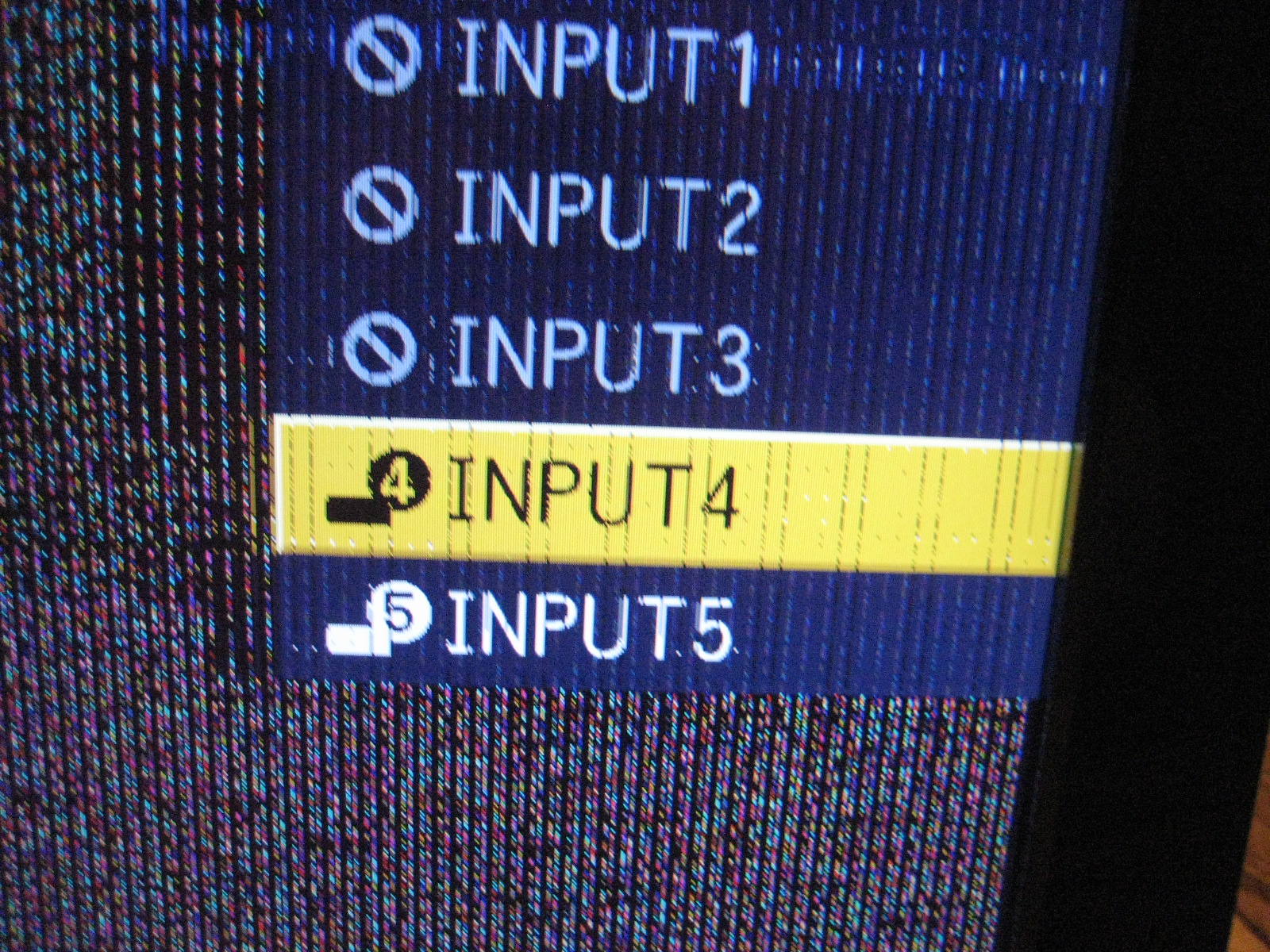

      When you press the menu button, do the above lines show up?
      edit: Ignore the above question. Pics were not posted when I asked the question.

        Re: Sharp Aquos LC-42D62U Display Output Problem
        Yes they do. When the menu goes away the lines remain.
          I've seen this before and fixed it. Its the main board with the input connectors on the side plate. Its not the power supply board.
          • Hobby 1
            • Mar 2010
            • 86
            It is also not the T-con board. The set I worked on, the owner was sold a t-con board by another tech who said that would fix it. It didn't. This problem also shows up on other older Sharp models. Fixed 3 so far.
              So I'm assuming that I will require a new main board from what you have experianced. Will I also need the cables to connect the two inputs (psu to main board)? Or is it just the input harness that is sodered to the board?
              Also, if the main board isn't the problem, could it perhaps the input harness located on the psu that is causing the issue?
              Thanks again.
              • Hobby 1
                • Mar 2010
                • 86
                Just the main board. The cables should be fine to re-use. I have all the parts from one of these sets that had a broken screen, if you need it and if its allowed to sell on this site.
                    So I installed my new main board. Turned on the TV, and it fixed the display problem. As soon as the TV turns on, the screen goes to white with no lines that were previously there. However, the TV turned off, and now will not turn back on. So I know that the new main board fixed my orginal problem. But now my TV won't turn on. The green LED light in the front is flashing. I don't want to have to buy a new psu. Is there any suggestions? Like a sequence to return to factory defualts, or new firmware? Thanks.

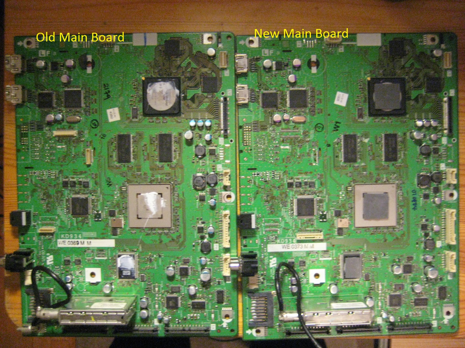

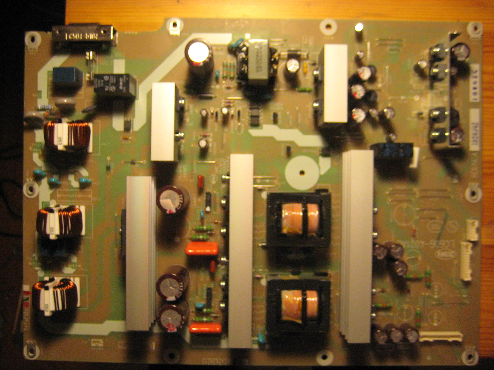

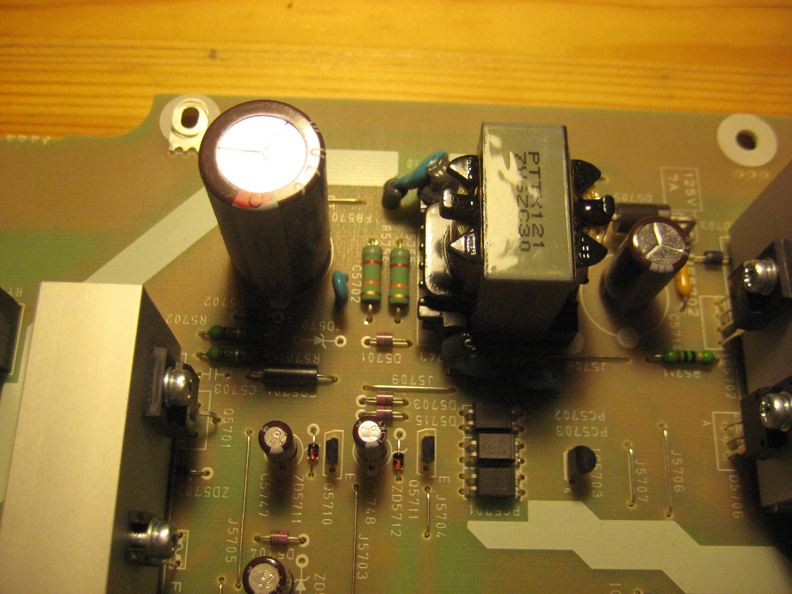

                                  Just for fun I thought I would throw up some more pics. The first one is the two main boards. I took close up shots to show that even though they are the same model number, they have different assemblies.
                                  The other pics are the psu. Just wanted to show that all the caps seem perfect. I really don't know whats going on here.
                                  I have a faulty main board, as told by even a pain tech. so I get a new one. Plug the bugger in, now the TV won't turn one?! WTF. These things are so temperamental. You'd think a display problem such as mine could be solved simply by a plug and play method. Arg!

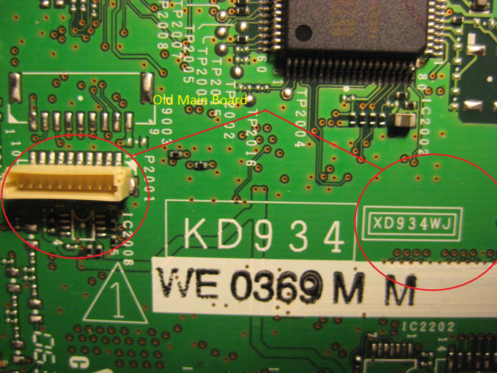

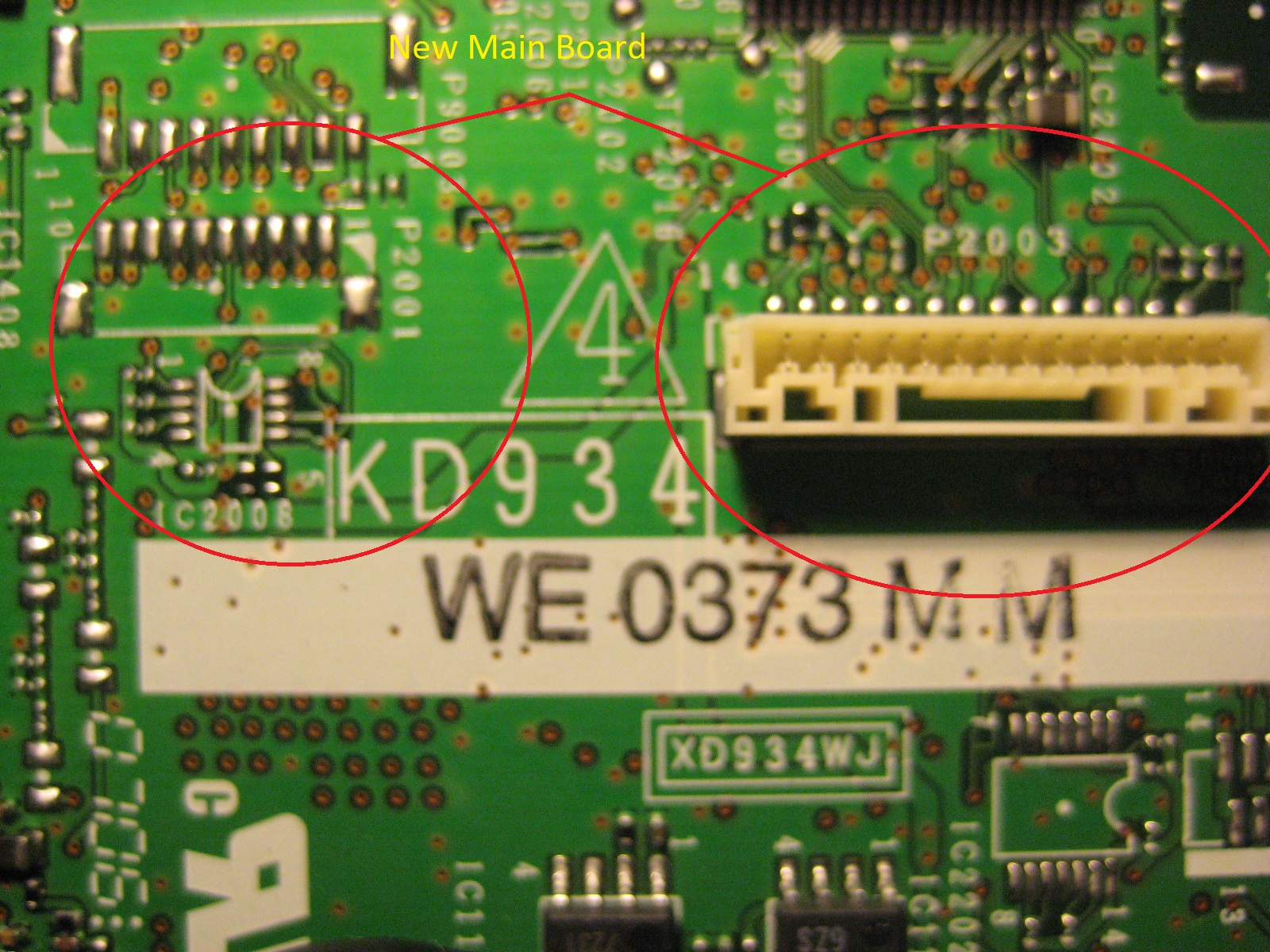

                                    Those two main boards are not the same, one has one version and the other another. One is a W1 and the other is a W3. Wont work.
                                    • trusean
                                      • Dec 2010
                                      • 17
                                      You are correct, but mine is a W5, not 3 (I know, in the pic it does look like a 3). Regardless, thank you for pointing out that small, but very important observation! You rock. Now I'm sure I am out $74 as I'm sure they won't refund my money because their model, which is the same as mine, is different than mine, if that makes any sense. I guess I will try and send a nice email explaning the situation. Thanks again.
                                        Sorry again, by any chance would you know the differences between the two? Or the what the "Wx" repersents? It might be good for me to know to support my case when emailing the store.
