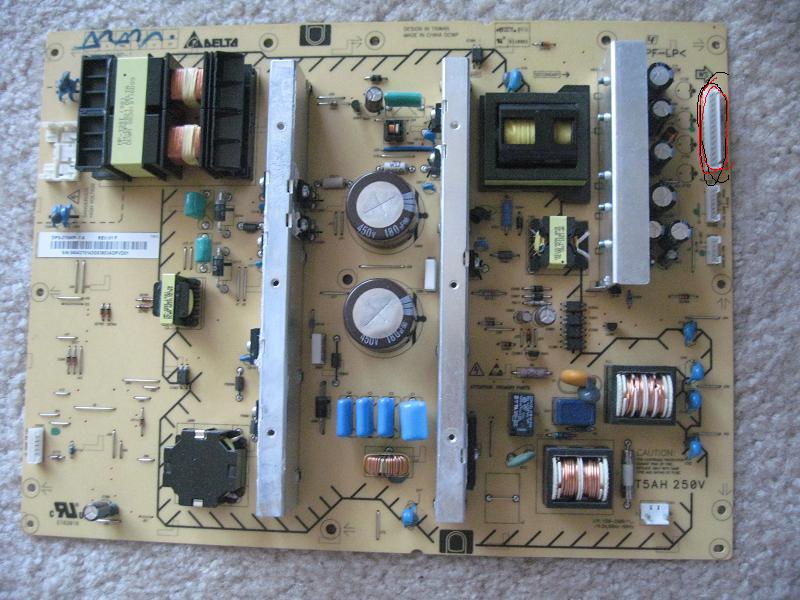

              Re: KLD-46S4100 No Picture/No Sound
              I had the exact same brand and model number and the exact same problem.
              Have you fix your problem?
              I would like to know how you fix it and probably I can do the same to mine.
              To restate the problem.
              Sony LCD TV KLD-46S4100 46in. HDTV
              About a year after warranty, one day it suddenly can not display images.
              The remote control can only turn the TV on and off.
              The on and off green LED light and the click sound indicate there is something happen.
              All other buttons on remote control do not work. All control buttons on top of the TV do not work.
              TV has no sound no picture, nothing other than the green indication light at the bottom.
              When I open the back, I did not notice any strange smell or any electronic component burn, leaking, bulky problem.
              Sony said it is out of warranty, local repair store said $75 for problem diagnosis + other fixing fees and labor.
              It can easily goes to several hundreds which does not worth it.
              If a guru here has some opinion, that will be really really of great help.
                            Hi, I have no offense. Just my personal opinion.
                            so here are some logic
                            1. This model is discontinued, on ebay, it is 599 buy it now. May be find a new one ~700.
                            2. with price ~800, I can buy a 47in LG LED TV which is lighter and more advance.
                            3. This 46S4100 model, as we can see in this forum, has a lot of problems.
                            someone had T-con failure, someone had A board failure, someone had power board failure.
                            Dig through this forum seems the problem may be bad fuse, bad connection or bad capacitors.
                            Most repair stores won't trace down to which part causes failure, if they found one board doesn't work. They simply buy a new one and replace the whole board instead of fix the component.
                            So one time fixing can easily goes to $200, parts + diagnosis+labor.
                            For this model if I have to fix twice in repair store, I would rather sell the good parts and buy a new one and enjoy the new technology.
                            Now I become a geek now, I am pretty happy to look through this forum, open the TV and trace the problem of a HDTV which I never thought of before.
                            Back to my question, I tested my power board.
                            The 12 V, 6.5 V and 3.3 V connector, which supply to A board, doesnot function.
                            There is no sign of burning parts, capacitor leakage, capacitor bulky etc.
                            Any one can have a hint of what's going on and how can I trace further?
                            Thanks so much.
                            shougang
