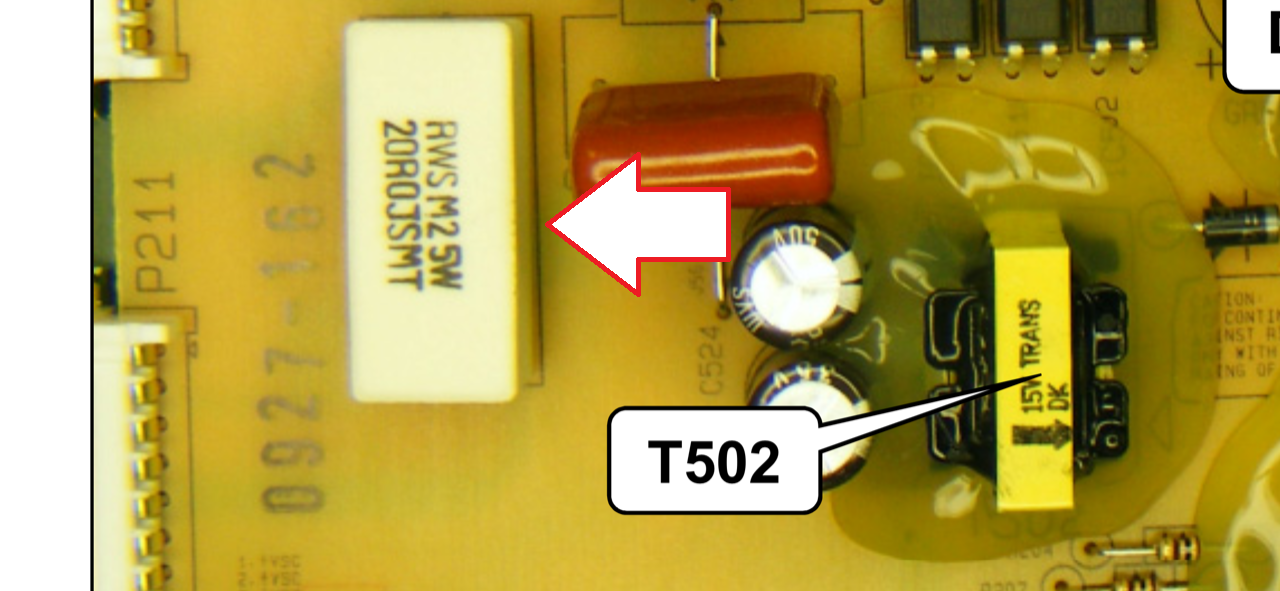

    Looking for this Component
    can anybody tell me what this component is and a similar from other brand???
    cannot find a source

    Re: Looking for this Component
    it seems a power resistor 20ohm 5w
      Hi @Davi.p thx man,... is it possible to solder 2x power 10ohm resistor together?
      can not finde a supplier for this component
        3x2w in parallel, the most near value to 60ohm, have you checked Conrad in Germany? RS, Distrelec, Farnell..
          Yes,.. Unfortunately there is no more conrad in Germany, they have closed all branches. Maybe on reichelt, i will try it there,...
          Isn't it better to use 2x 5w 10 ohms in series or does that cause problems?
          The device is an LG Plasma TV.
            No, Conrad still exists, no more shops on the road but all there in the web...
            i think you haven't room for 2x 5w..
