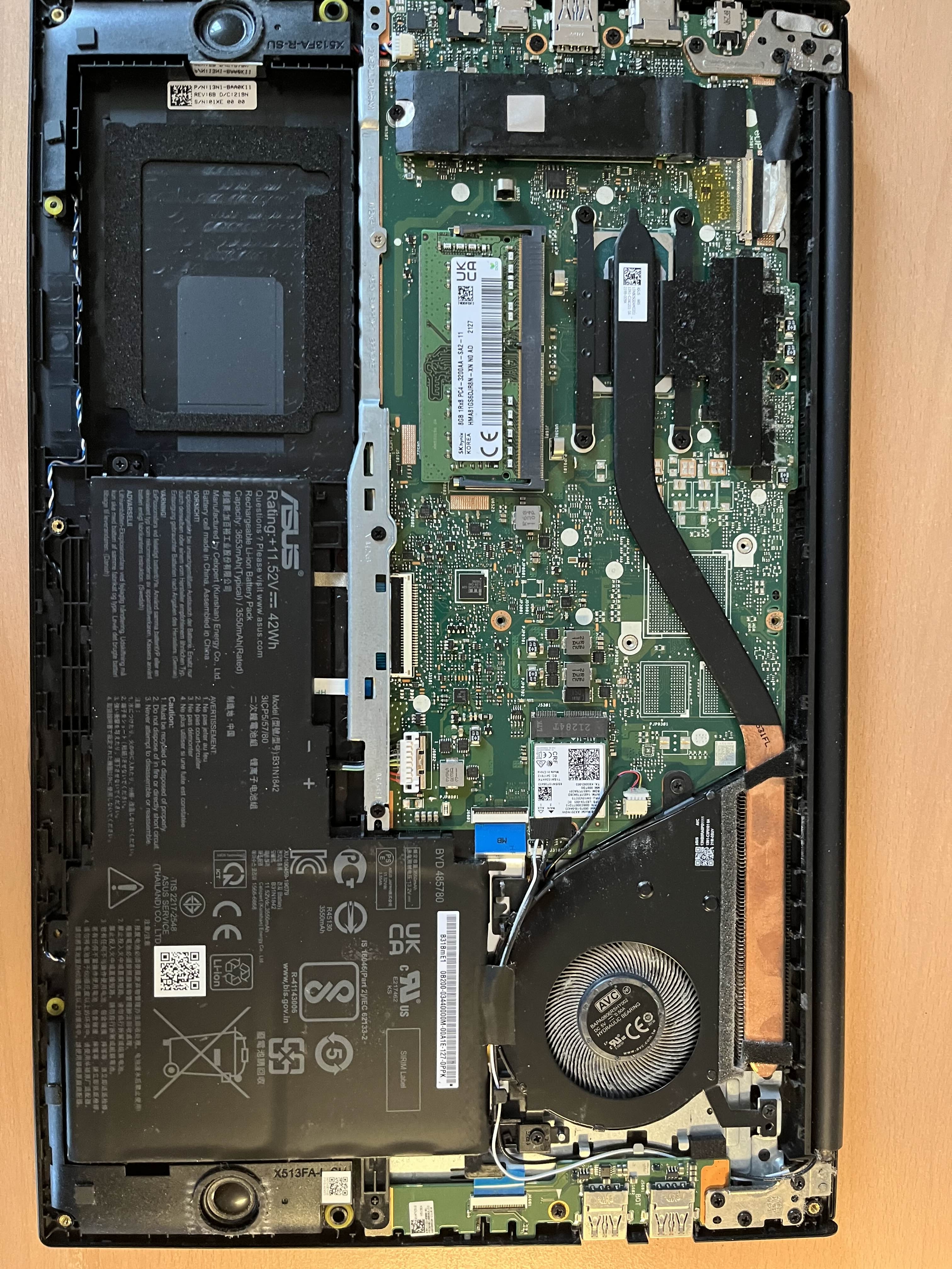

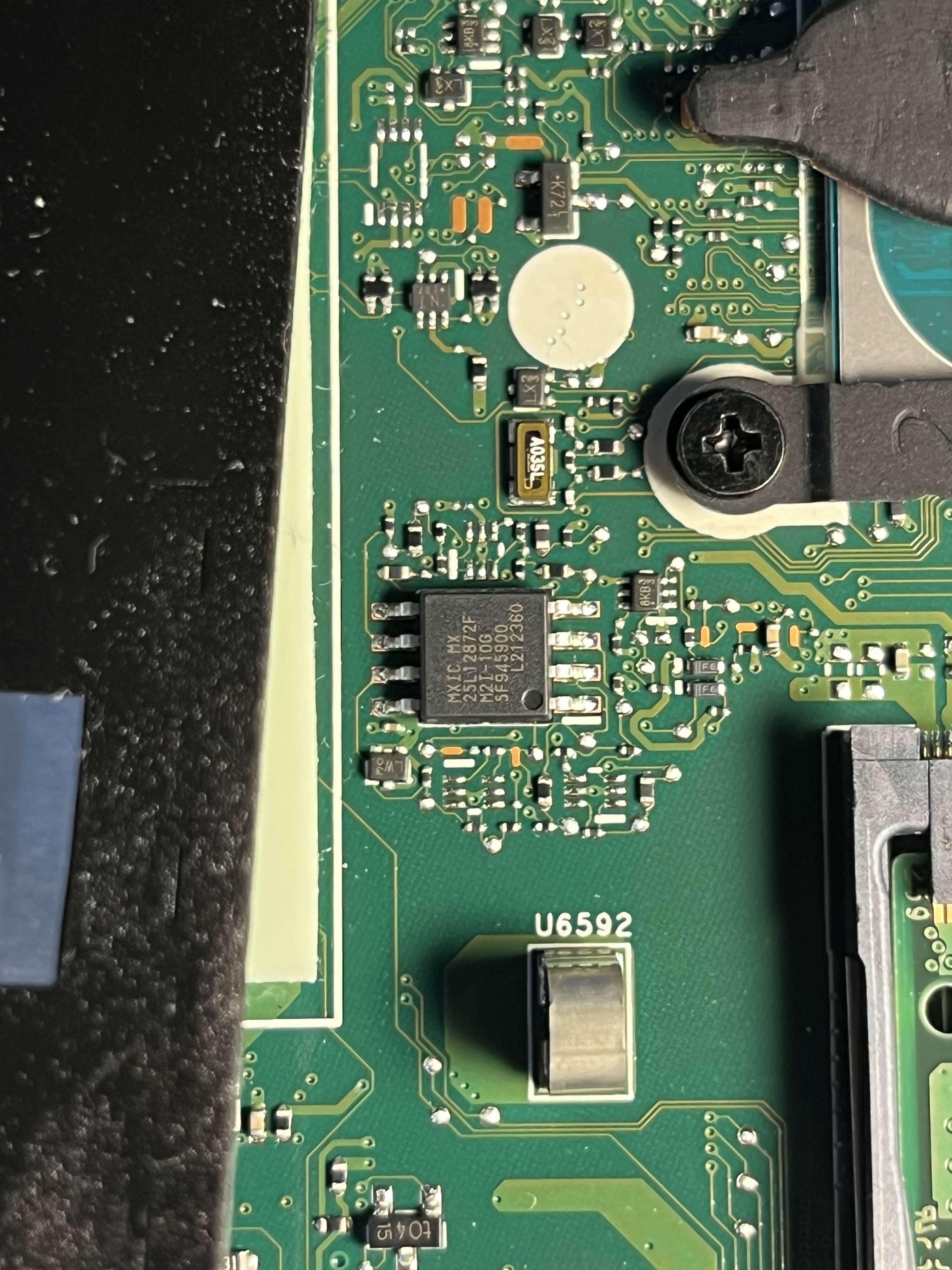

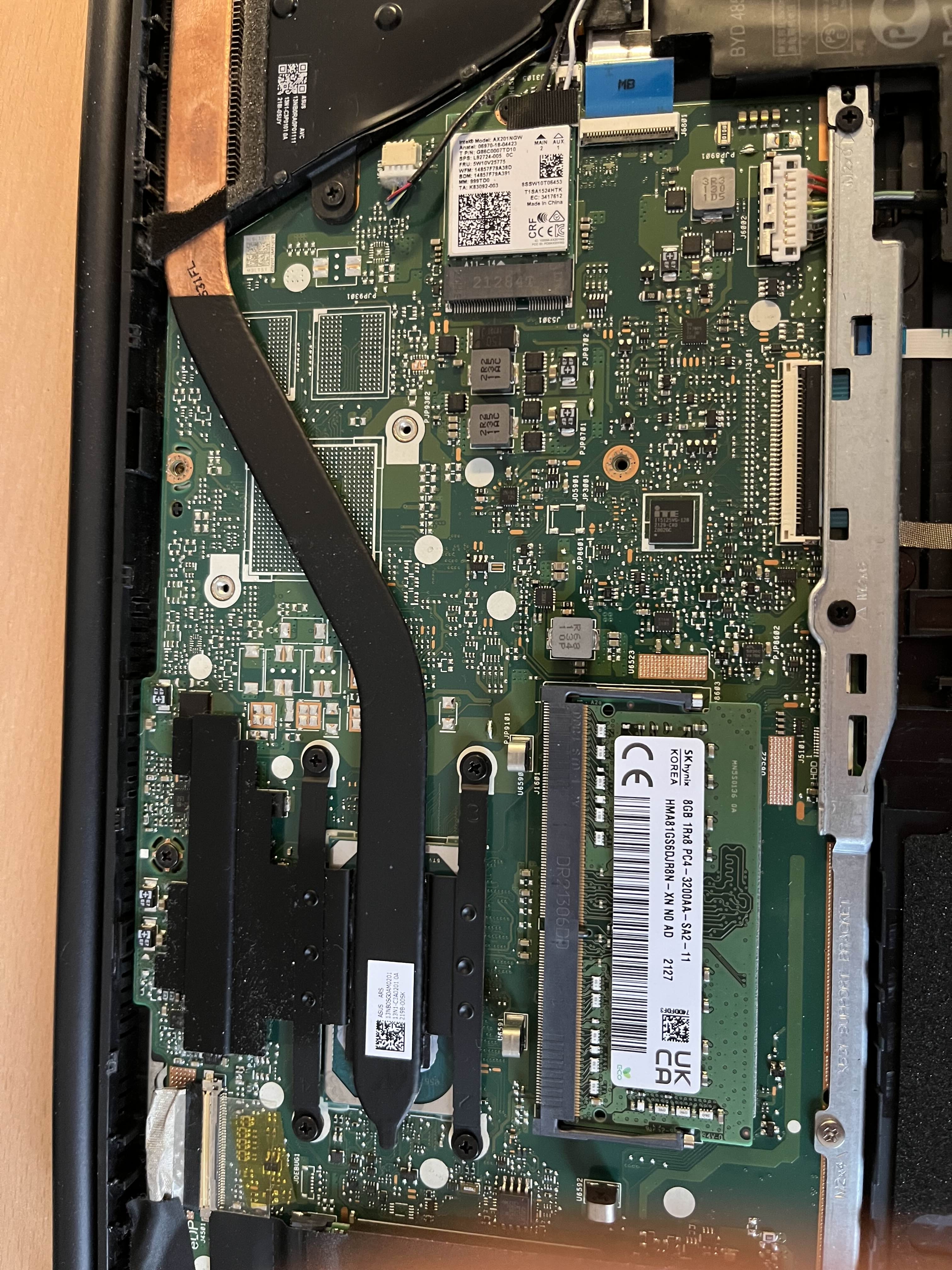

          Hey,
          I've got some more stuff to post. I took my laptop apart and managed to identify the BIOS chip (see attached picture). I haven't looked at the back of my motherboard yet, but I reckon this is the chip I'm looking for. Do you think you could take a look and let me know if I'm right?
          My baseboard is as follows: ASUSTeK COMPUTER INC. X513EA M938NBCV00U06EMB 1.0
          I've found an eBay listing with a picture of the whole motherboard: https://www.ebay.de/itm/266902106201
          How I would proceed:
          I've bought the CH4131A programmer and will read the BIOS chip with it.​
          Best regards!

                Hello Guys,
                i am back after quite some break. I have extracted the bios using the Ch314a programmer (files attached for every chip version, read1 -> first in list etc)
                I have read the bios chip using ASProgrammer 2.1.2, and compared the data through certutil, for these specific chip versions (MX25L12833F/MX25L12835F/MX25L12845E/MX25L12865E/MX25L12873F)
                The extracted encrypted password is still the same. }FÓKZqÝ´ZjT"âAç‡áÇÁd)qàèò‘Ü or 7D 46 D3 1A 4B 5A 71 DD B4 5A 6A 54 22 E2 41 E7 7F 01 87 E1 C7 C1 64 29 15 71 E0 E8 F2 91 12 DC
                Thus i am thinking of reflashing my chip like Ali_Khan suggested.
                For this i am trying to get rid of the "gibberish" that starts 006474D0 and filling it with 00.
                Is this the right approach?
