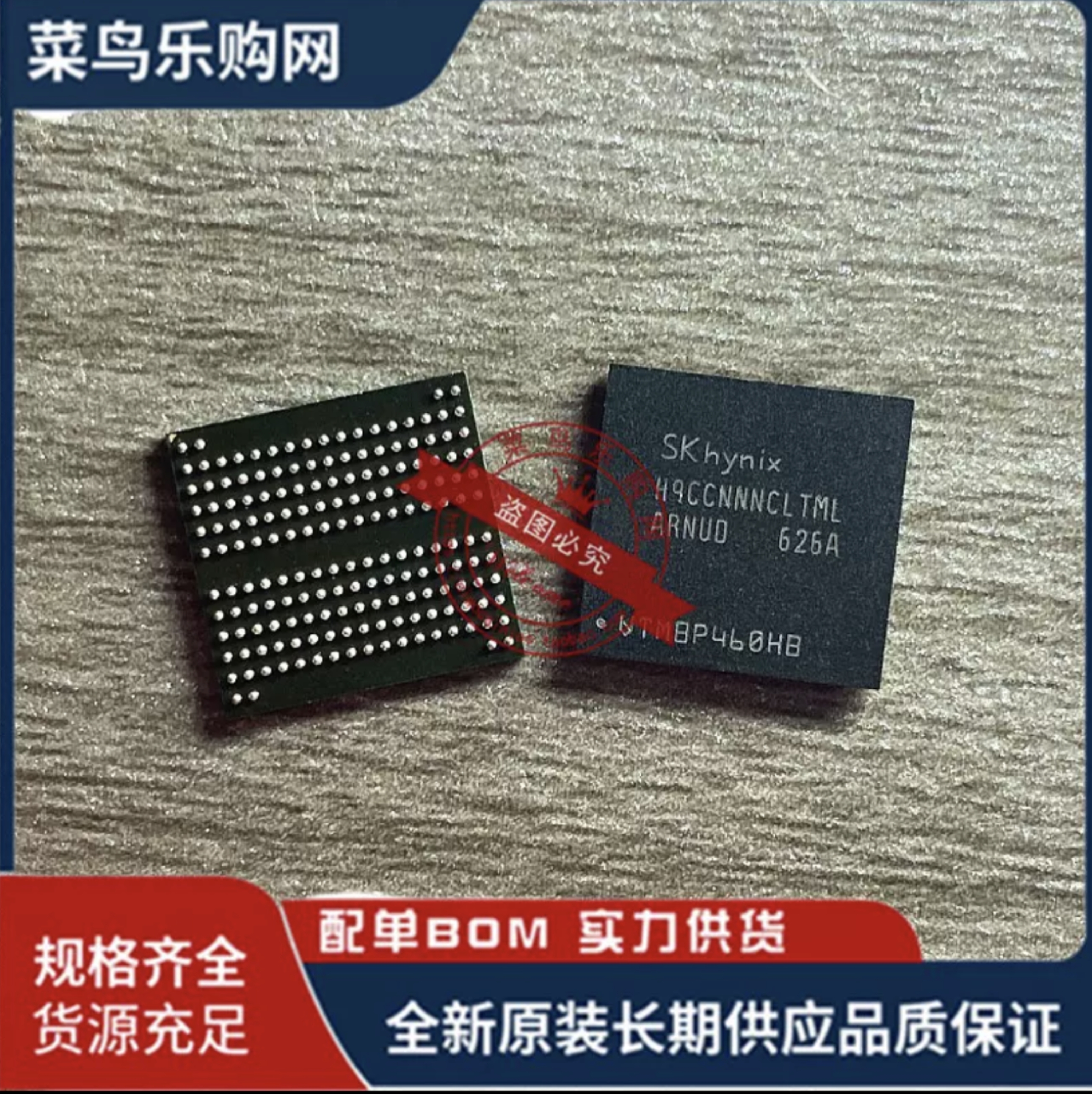

    Hello Everyone , I own a dell Latitude 5285 2in1 with 7th gen core i3 , Unfortunately the ram in this tablet PC is on board chips. the original ram on the device is 4G (1GB) for each chip in the motherboard 4× Skhynix (H9CCNNN8GTAL-ARNUD 752A)
    I made a small research I found in the Chinese market the (Skhynix H9CCNNNCLTML ARNUD626A) Chip
    which is 4G DDR3L Chip. I bought 4 to upgrade my tablet PC to 16GB.
    Can I just reball the new chips and upgrade the ram?
    or do I need to remove or add some transistors or maybe bios mod , I saw the boardview and didn't understand it well.
    any information shall be helpful in my conquest .

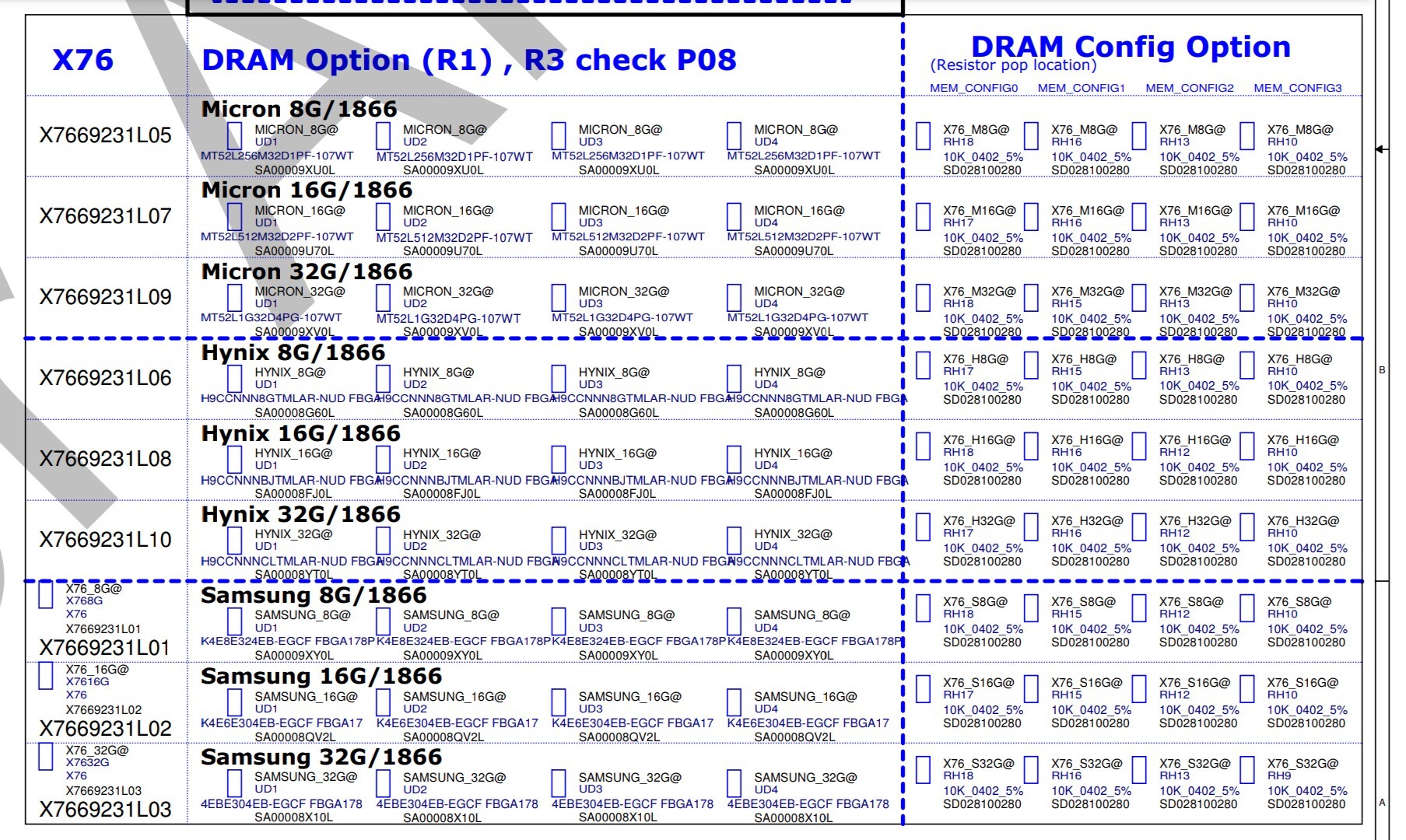

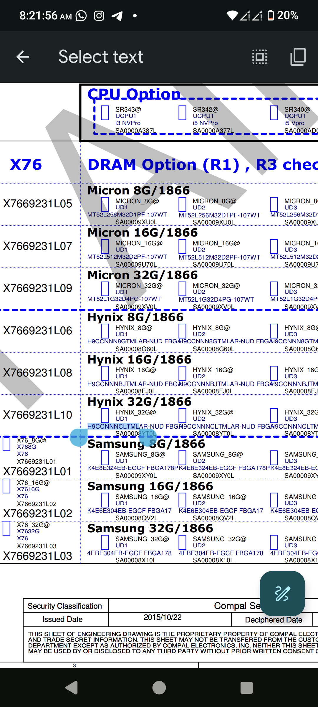

      Thanks for the info , The ram chip is listed in the service manual what isn't clear for me is the configuration in the motherboard.
      BTW , the maximum supported ram is 16GB as there is model that comes with an i7 processor - 16GB.
      What about the resistors in the mobo , don't they need a modification?
