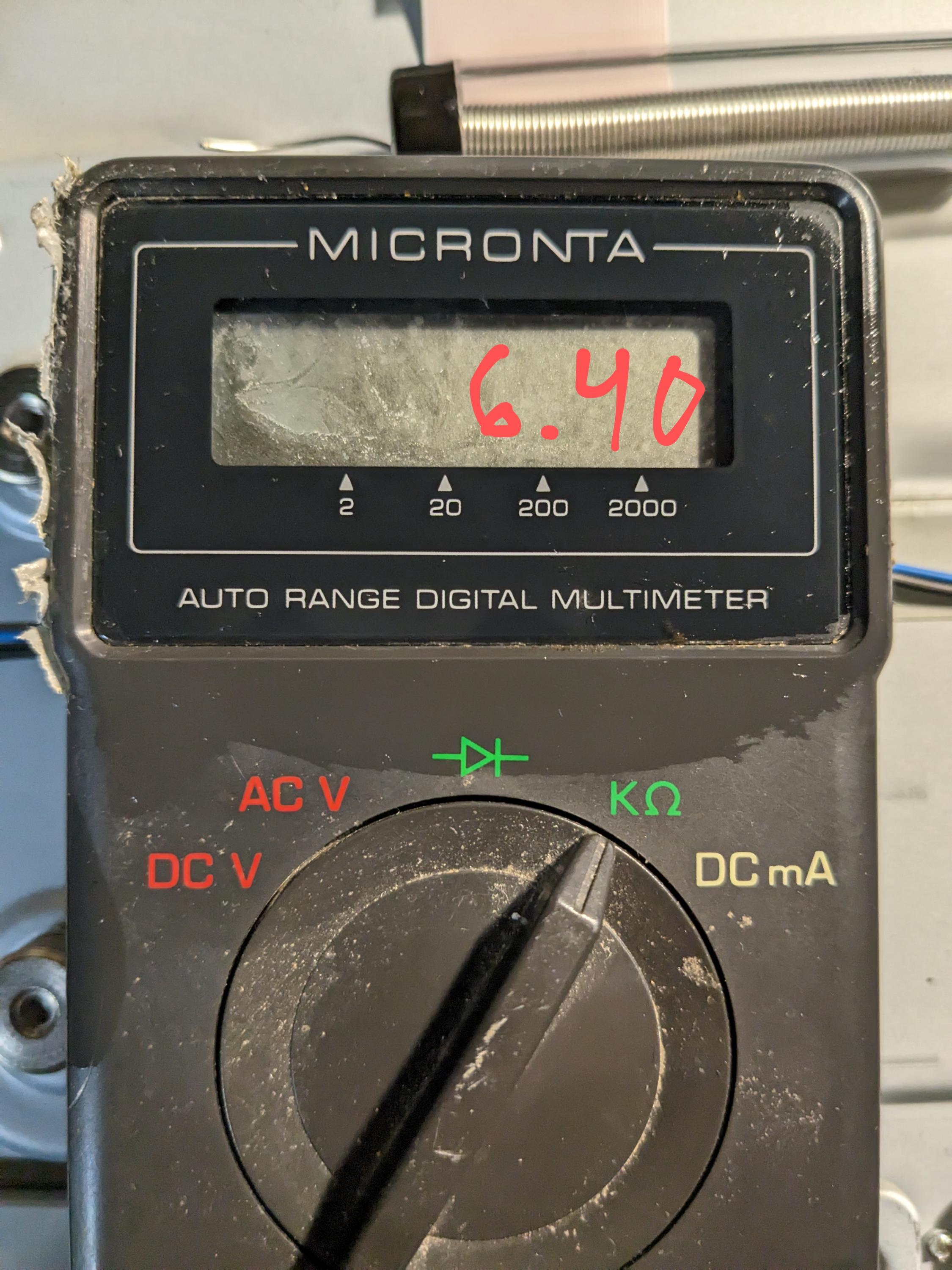

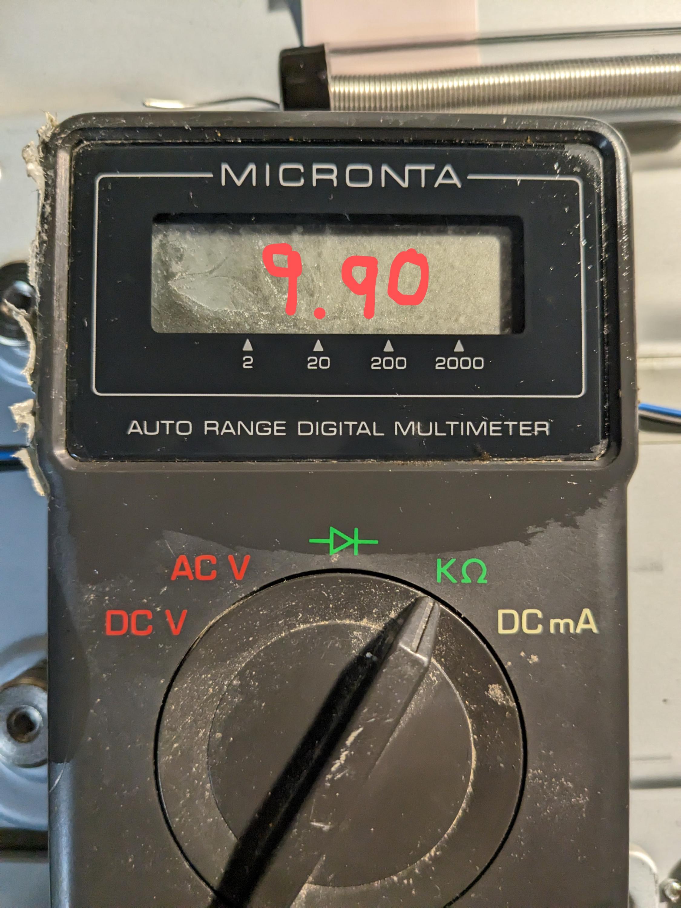

Update: I followed these instructions (hopefully correctly) and have results.
Connect the negative probe of the multimeter to the base output (usually it is a black probe), and the positive (red) first to the collector and then to the emitter. Obtaining a value in the range of~500 -1500 Ohm confirms correct operation of the transistor.
On one transistor I get 9.9 on both the collector and emitter legs on the 20 scale. The other transistor showed 8.6 on the collector and 6.4 on the emitter on the 200 scale. My meter is auto range so that's why the results are in 20 and 200 scales. I'm guessing these are substantial differences and might indicate one of them is faulty? I checked this with no power as well.Last edited by x_orange90_x; 11-10-2023, 05:20 PM.Comment
Re: LG 55UH7650-UA needs a capacitor!
It's fixed. I replaced the transistor with the mismatched resistance and also the fuse. I got a new multimeter today and that helped.Comment
