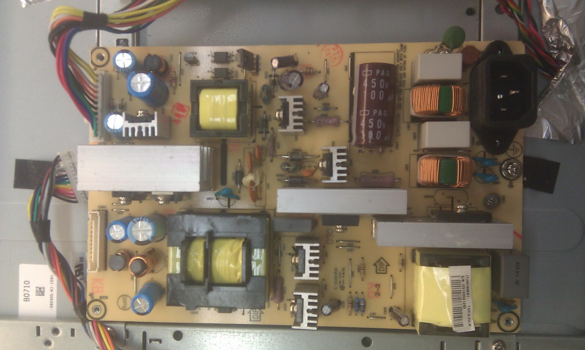

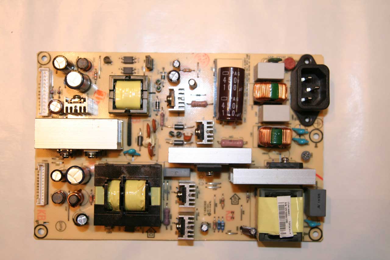

    I have an Insignia (Junk, I know) 32" that was obtained dead. I bought it for a few bucks thinking I could change a few caps and presto! I had done this on two other TV's with good luck.

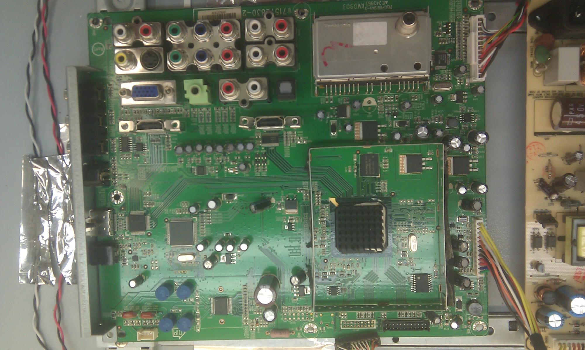

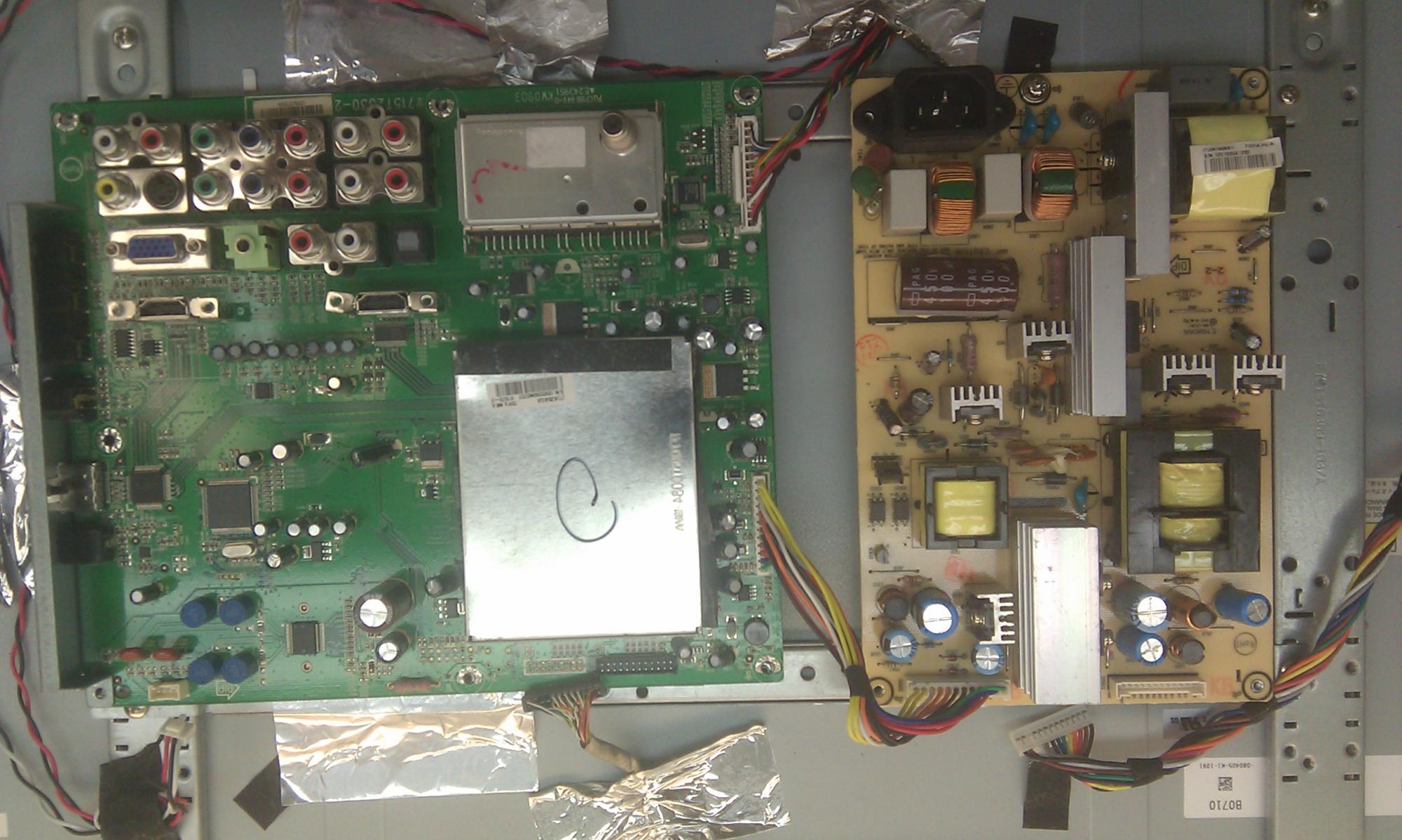

    Now the problem: When the power cord is plugged in, the LED blinks constantly every second. The color of the LED is a mixture of red, white and blue. I examined all boards with the microscope and saw no obvious board problems. I do have 5 Vdc coming out of the power supply board with all other boards disconnected. When I connect the logic board, (with all other connector unhooked) that 5 Vdc drops to 1 Vdc, pulsing a 1/2 volt.
    On a long shot, I changed all the caps on the output end of the power supply. I used locally obtained caps just to see if it can be fixed. Upon fixing the TV, I will change these to the proper cap.
    Attached are some photos. I can take better ones if needed... all I had today was phone camera.
    Anybody have a similar problem?

      Re: Insignia LCD32 No Power
      well if you go from 5V to 1v pulsating when plugging in the logic board, its a pretty safe bet you have a short in that there ol' logic board.
      Either in the PWM voltage regulators on-board the mainboard, or possibly shorted IC.
      might be easier just to swap in a new mainboard and be done.

          Spend the 12 bucks on the correct caps, including the small ones around the SMPS and see what happens.
          Al.

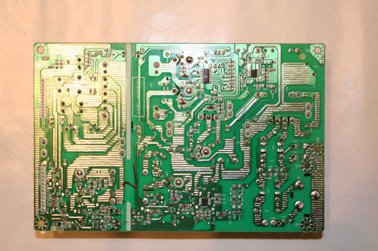

                    UPDATE: Insignia LCD32 No Power
                    Well I found a logic board for $40 so I thought I would give it a try. It did solve the blinking LED and the pulsing 1 volt issues above... BUT, the power supply is still not switching on the 12v & 24v.
                    With all boards connected, I now have steady 4.9 on my 5v posts, and a steady 4.3v on my PS post. I replaced all the caps on the low voltage side with FM series. I did not change the high voltage side.(They are all Elite)
                    I included a photo of the bottom side of the board.
                    Any help will be appreciated.
