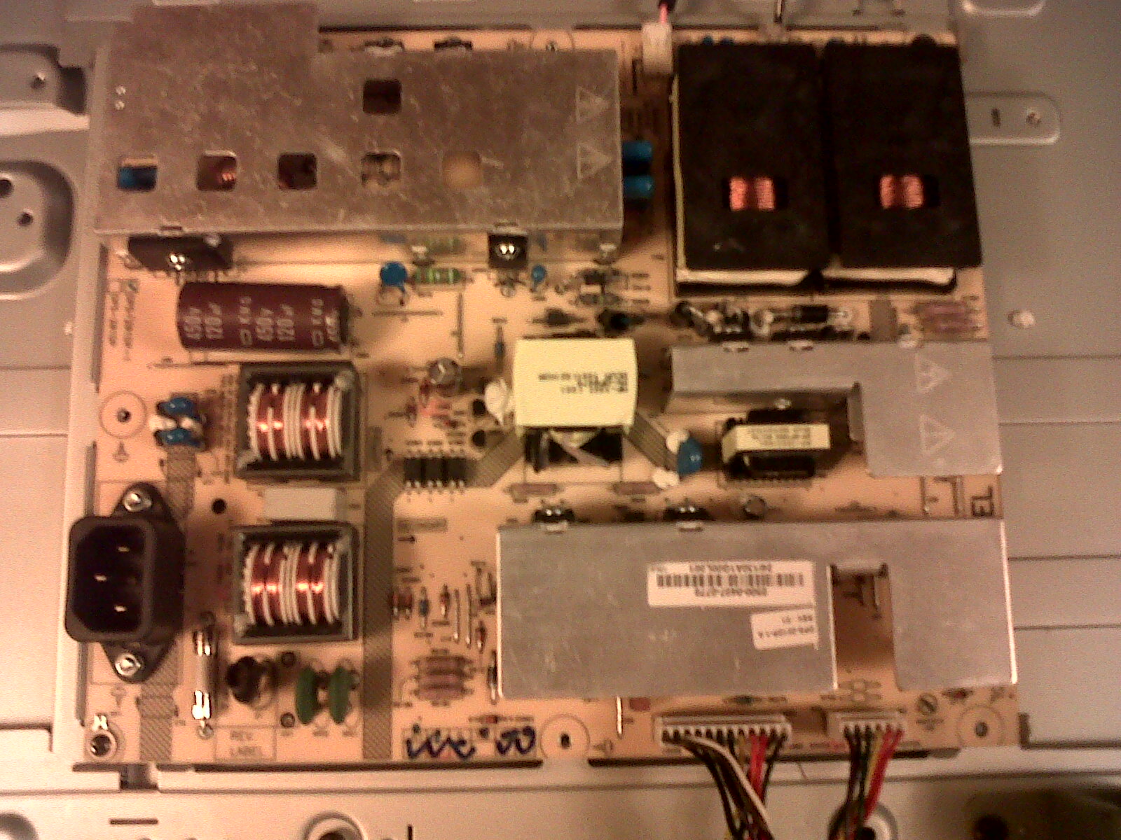

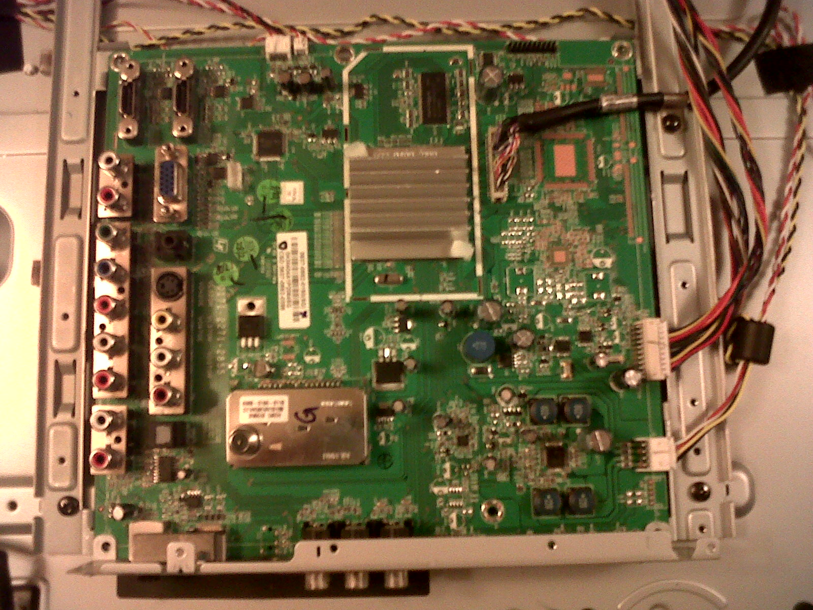

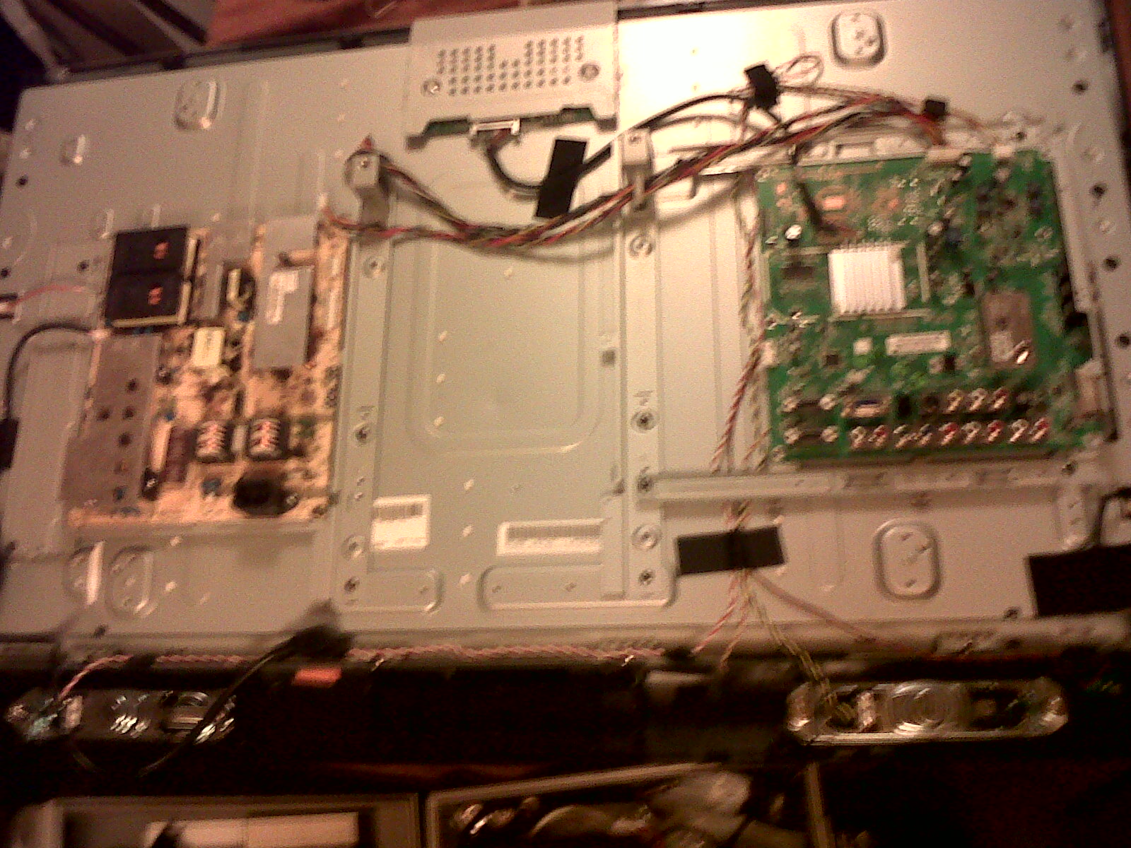

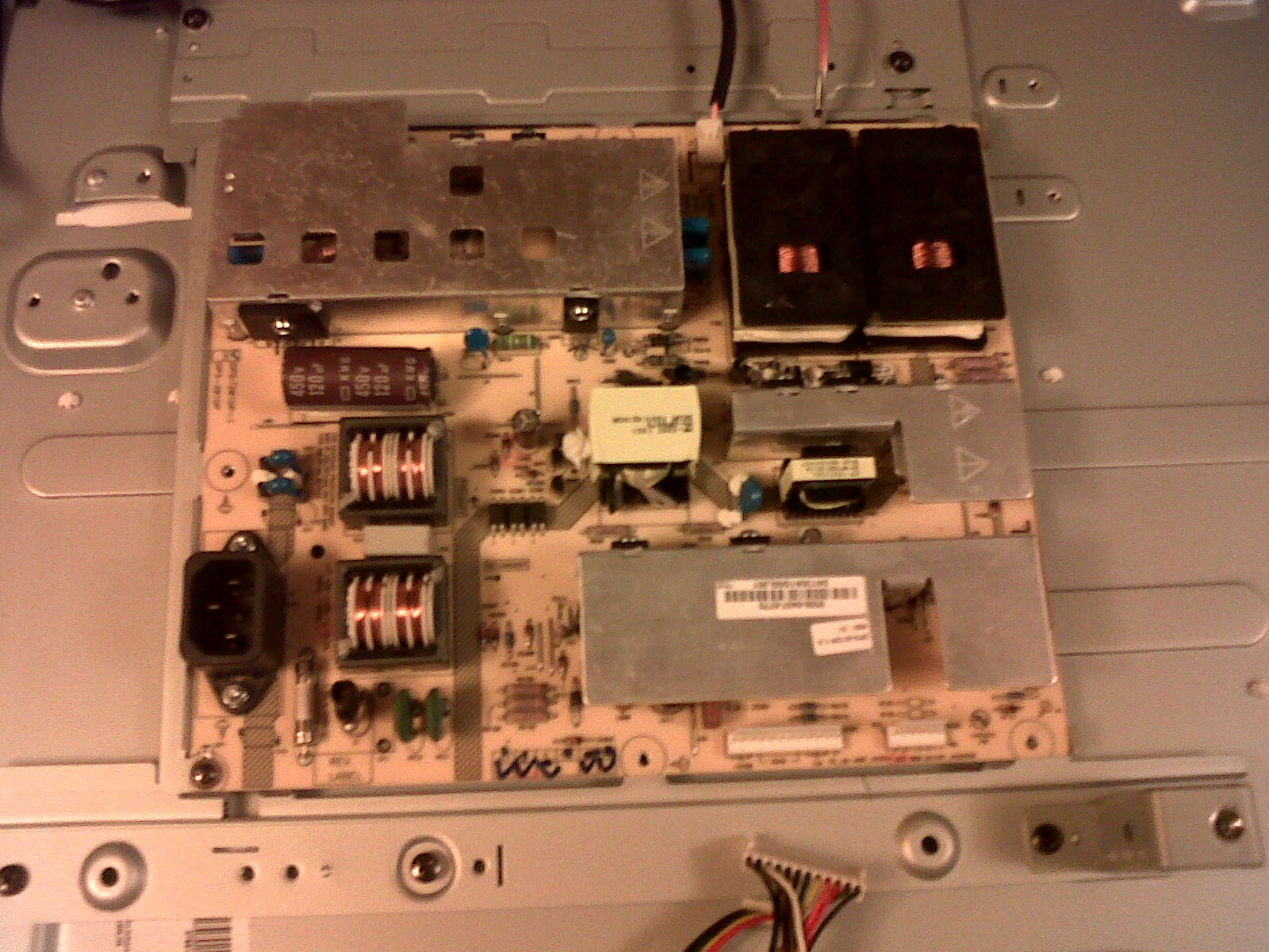

    Re: vizio vl370m dead
    Post some pictures of the set opened up. Pictures are our friends. Please use the "manage attatchments" on the post page instead of inline pictures.
    • gaplayer31805
      • Oct 2010
      • 15

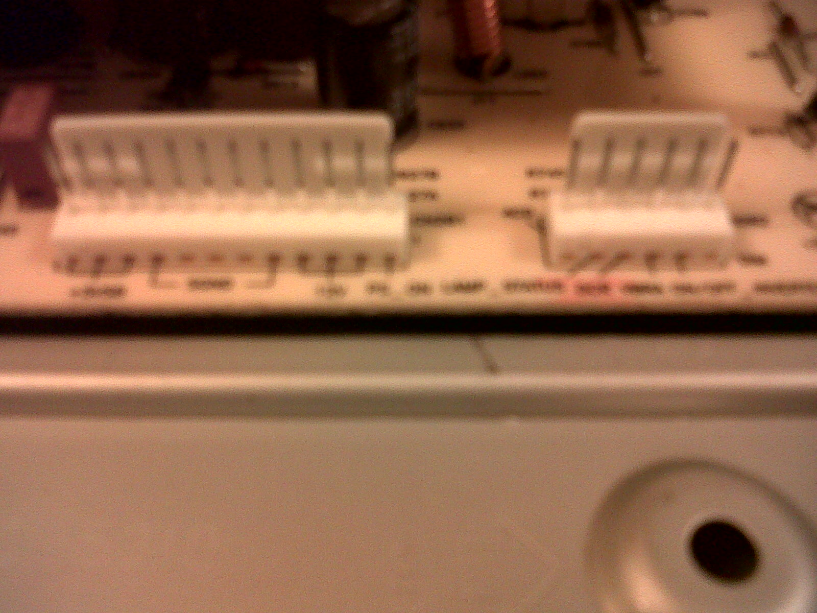

      Here are some pics of set inside as requested. After several tries, these are the clearest pics, I was using a blackberry, on the pinouts on the power board starting from the left on the large one is 3 - 5v, then sgnd from pin 4 to 8 , then you have 3 - 12v, and the last one is ps_on. On the small connector labels are from left to right ACD, Lamp_Status, DCR, VBRA, On/Off_Inverter, DIM. Numbers on both connectors go from right to left, IE. DIM is pin one, and PS_ON is pin one. The only voltage I get is 5.18 with the old board in place, and 5.27 with the board I just ordered, on pin 10, 11, 12 on the larger connector. No other pins show any voltage. Used magnifying looking glass to view both boards, no evident damaged components. This set was turned off one evening, the next day nothing. Voltage readings taken with a Fluke Digital Voltmeter.
        Did you check the 5V on the old board? I had one that had 24V on the 5V due to a shorted transistor. I had to replace the main board, the pushbutton board and the infra-red board (for the remote. as well as the power supply. Then it worked fine except the power/standby light wouldn't come on. Couldn't find one.
        Phil
        • truep
          • Aug 2010
          • 373
          bty, The power board must be connected to get anything other than 5v.
