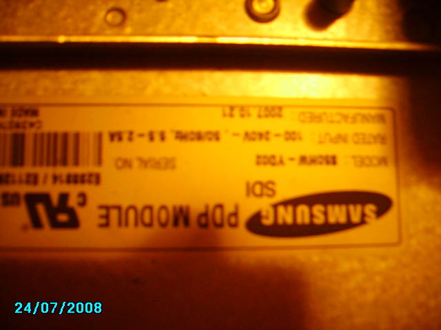

    Also, what is the model number of the plasma panel? It should be on a small label on the back of the panel (NOT the back of the TV). With that information we can track down a service manual for the plasma panel, which includes the power supply.

      yes the panel is samsung model # s50hw-yd02. I will start checking ps supply voltages here in a few min , ty so much for your help .
        Re: Vizio VP50hdtv20a 5 blinks ps board any suggestions?
        I also started looking for the service manual for it , and can't find one anyone know where I would get 1. Even if I have to pay I would be more then happy to

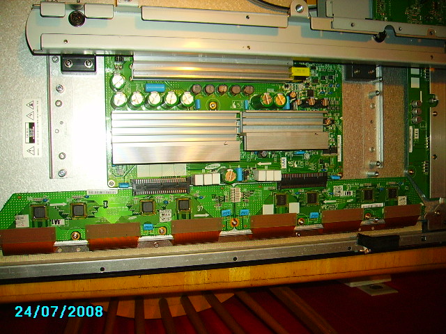

          How about posting some pictures of the set (inside guts). I have seen a different set with these symptoms.

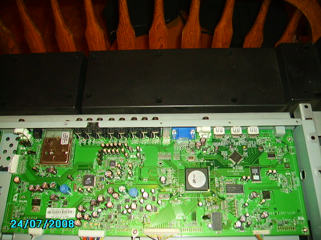

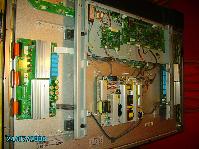

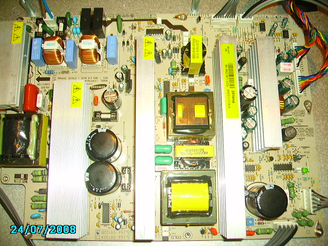

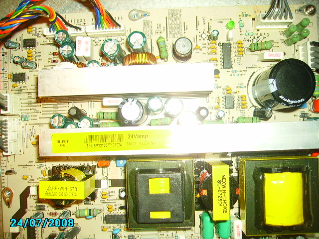

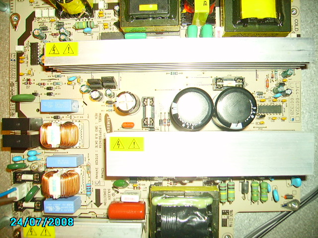

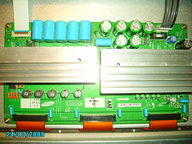

              Ok Here are some pics , I have tested some spot that were labeled on the ps board , ones labled were 5v and 12v , some where there when the tv was in on mode and others were there only for the few seconds on turn on . Im still searching for the schematic atm so I could try to test some more.
                Here are Pics

                  Sanyo DP50747 (Chassis P50747-00) uses the same power supply, I know there is a service manual on the web but you need to pay $5 to download.

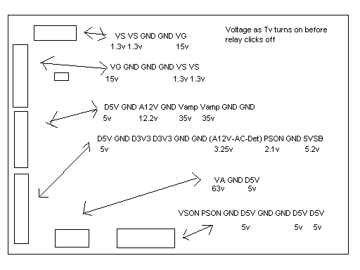

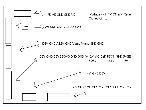

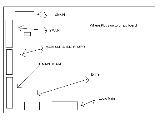

                          Ok so I started to mess around with the tv again since the wife is getting angry at me since i have had this thing on the kitchen table for past few weeks lol. I took Voltage tests from all the plugs off the ps board and the voltages are under the pins in the diagram I made. One Diagram is for When the TV Turns on Right away before relay clicks off . Other is after the relay clicks off , and the other is just showing what plugs go where . Also for some reason I didnt see that on the ps board it labels what the led blinks mean . This one blinks 5 times and under 5 times it says Vamp UVP. So I hope that will help . Also While I was taking Voltage tests my buddy says what would happen if I unplugged a jumper(CN8010) that was next to the blinking fault led on the ps board . Well I did and The Backlight came on and i Could here the Y and X main boards hum and led's on logic main board stayed on . I put the jumper back on like it should be and just the green light on front and 5 blinks of led on ps board just like it used to be. Well I appreciate any help that anyone can give thank you for looking at my post .
                            UVP = Under Voltage Protection
                            You might have a problem with that AC-12V AC DET (Detect maybe)
                            This may be a voltage feedback to monitor the 12V.
                            Just a guess.

                              well I just realized that i tested the ac 12v on dc with the mm. Tested for ac i get a few volts that drop to 0. Well all i can do is keep testing stuff...
                                also ac12v should be 12v ac even if the relay clicks off?

                                        Well I sat down tonight and worked on the tv some more , I just barely moved the va voltage adjustement and tv fired up with sound , no more blinking on the ps with cn8010 jumper on like it is supposed to be . Tv is working great and still on YAY! not bad for 115$ total investment Im figuring the tv repair guy that had the tv before me ajusted the va voltage and never set it back trying to fix it . The main board was bad still I retried it so I did also still need that too . Im so happy now and thank you everyone that helped me
