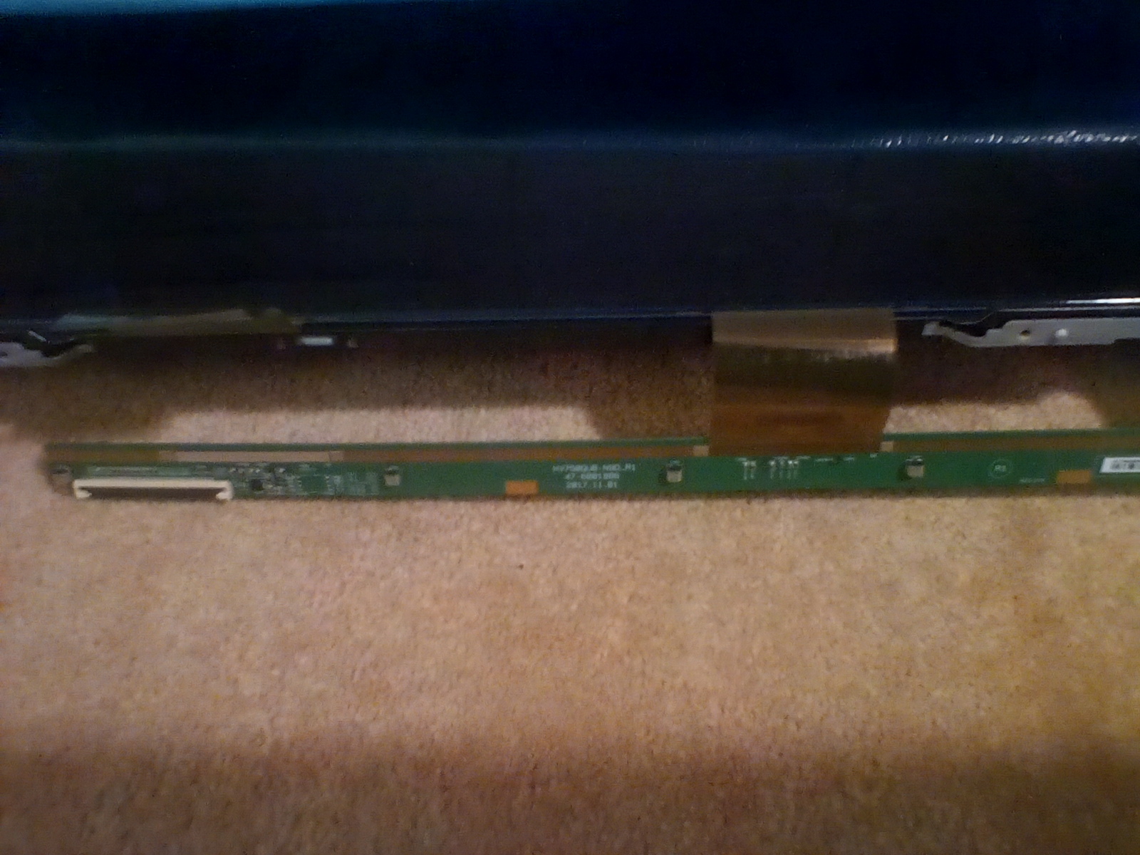

    Doing backlight LED strips replace. All good till I decided to clean the screen with the address bar taped to screen.
    I accidentally dislodged the flex cable on the LED screen.
    I was choked after reading it was a pain to repair.
    Anyone out there have a solution for a layman without a bonding machine.
    I saw a square heating attachment to solder iron but have no idea where to get it.
    Any suggestions appreciated.
    I was so close to getting this damn thing assembled.
  • Grasshopper2Ant
    • Jul 2023
    • 15
    Re: Vizio Flex Cable / Address Bar Repair
    Here is the flex cable that I tore off.
      It looks like one side came off clean but it tore the the other side ?

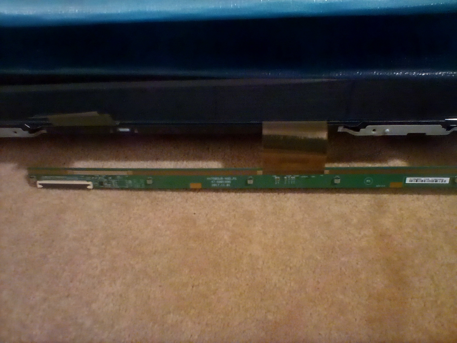

        Sorry for the bad pic. It tore off clean. The flex ribbon is in tact.
        After some reading, I have to use ACT remover (G-450 product) to remove the film on the traces.
        Does any know what I can use as a sustitute. Would acetone work as it is more readily available or any other
        Is this pic any better?
