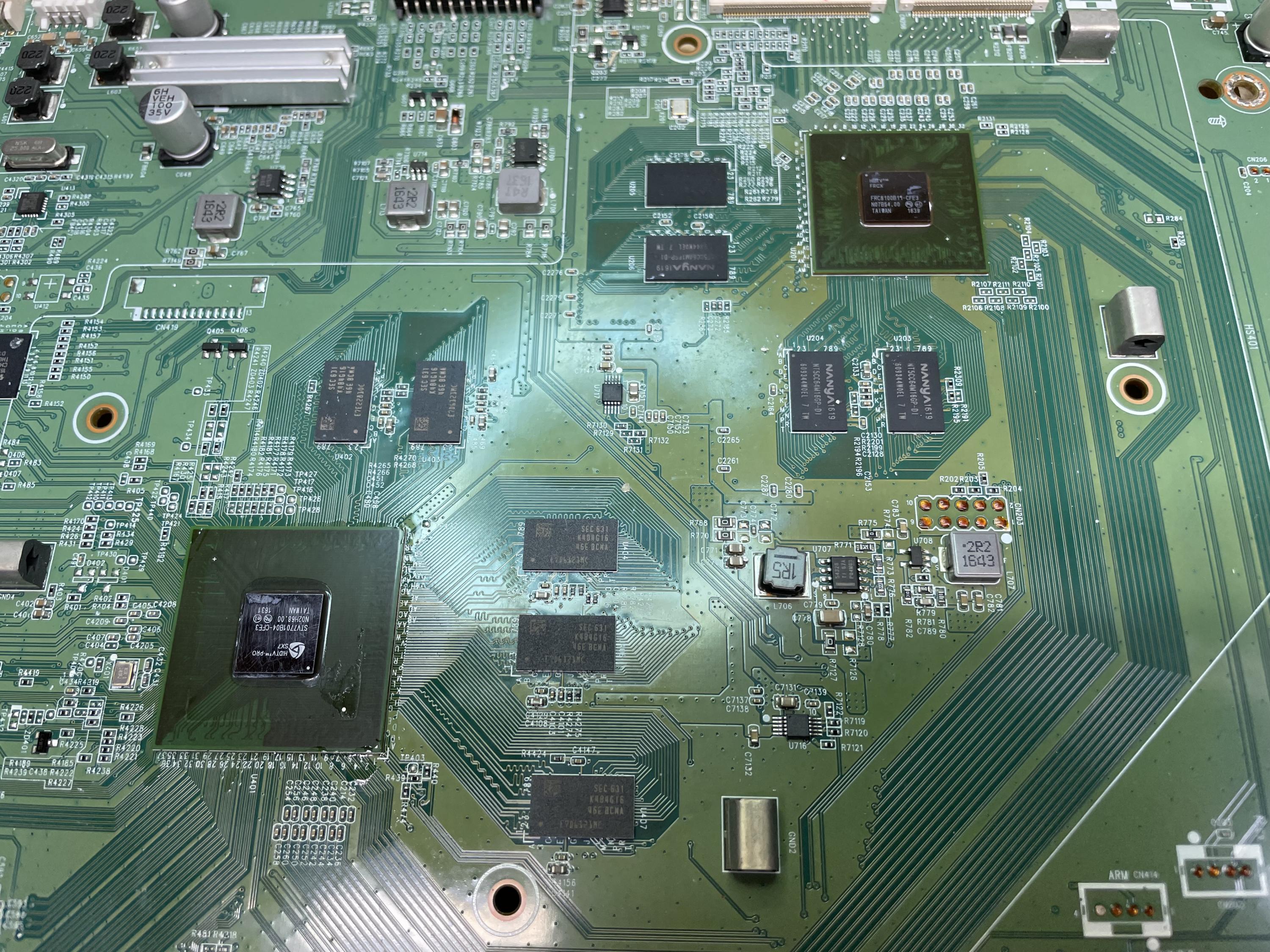

      Test it, hit the bga with a hairdryer for a couple minutes then try it, don't wait til it cools off try it while it's still hot.

          Don't think it's meant to fix it, just a test that quite often but not always, will let an image show for just a bit, which confirms a bga issue.

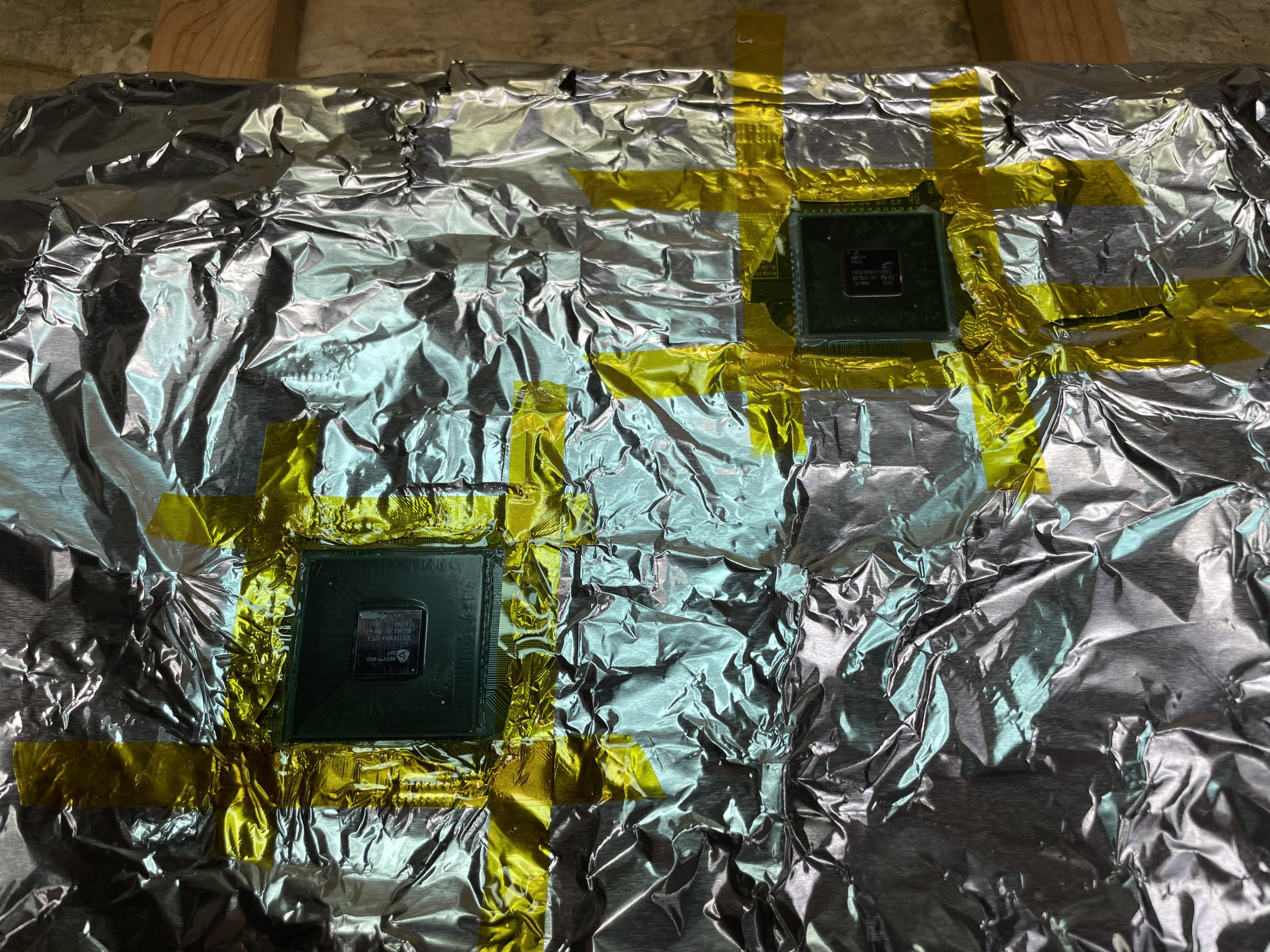

            That would be your diy reflow, can be good if done right, check youtube, many diy reflows there, I like the one the guy does with a halogen lamp, need to be careful with the temps, specially when using heat gun, too much will kill it, too little no solder melt, need to be careful not to blister the board also, I use no clean flux, if you get a fan blowing on your bga it should last a lot longer than no fan.

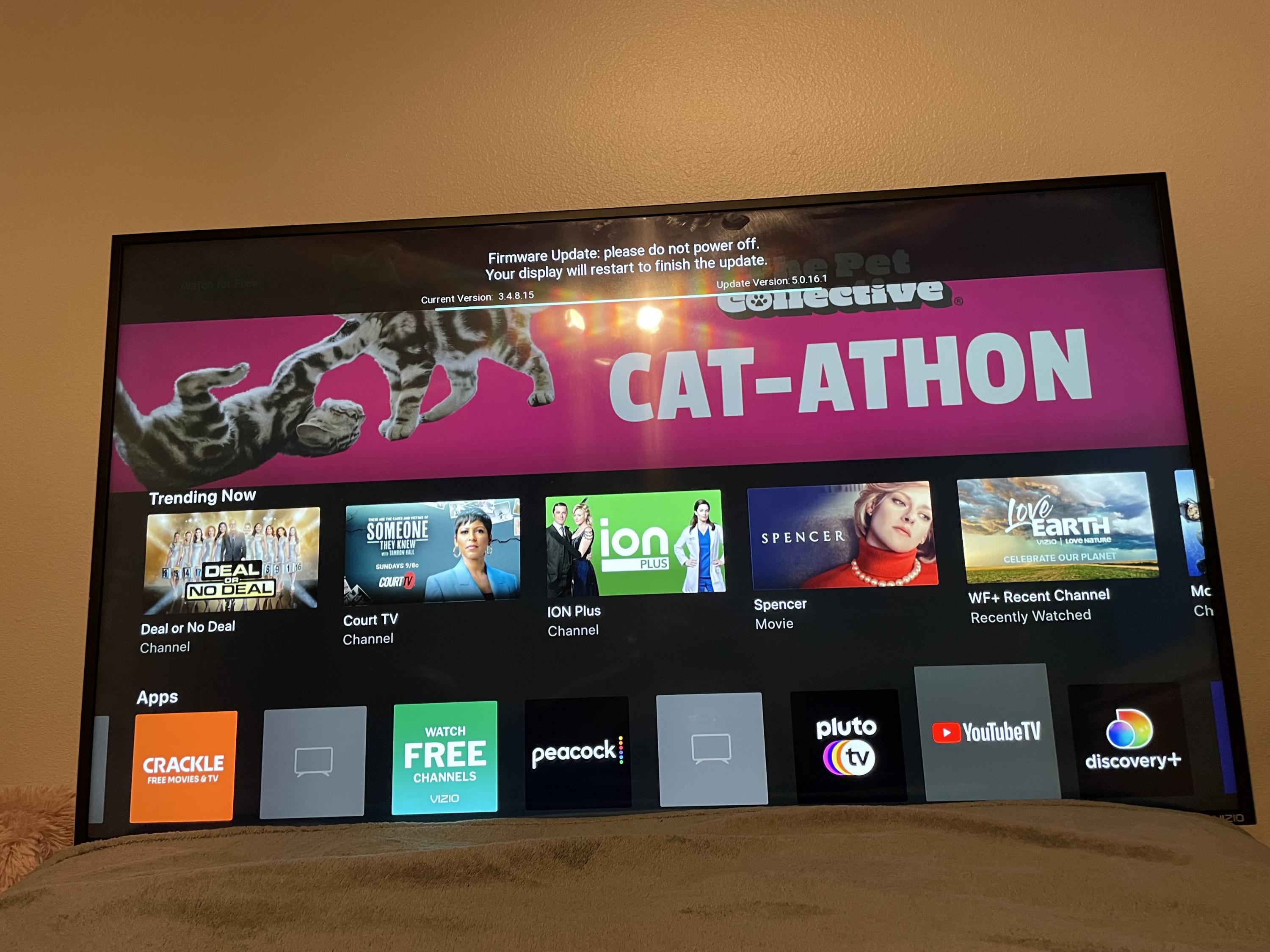

              Prepped my board as shown with a small bead of flux around the edge of each BGA. Heat gunned both BGAs for about 30 seconds each until the flux bubbled up. Cleaned the board, new thermal paste and then put it back in. Success!!!

              Thanks for the direct and indirect help here. Great to get a few knowledge bits from some threads and responses around here!
