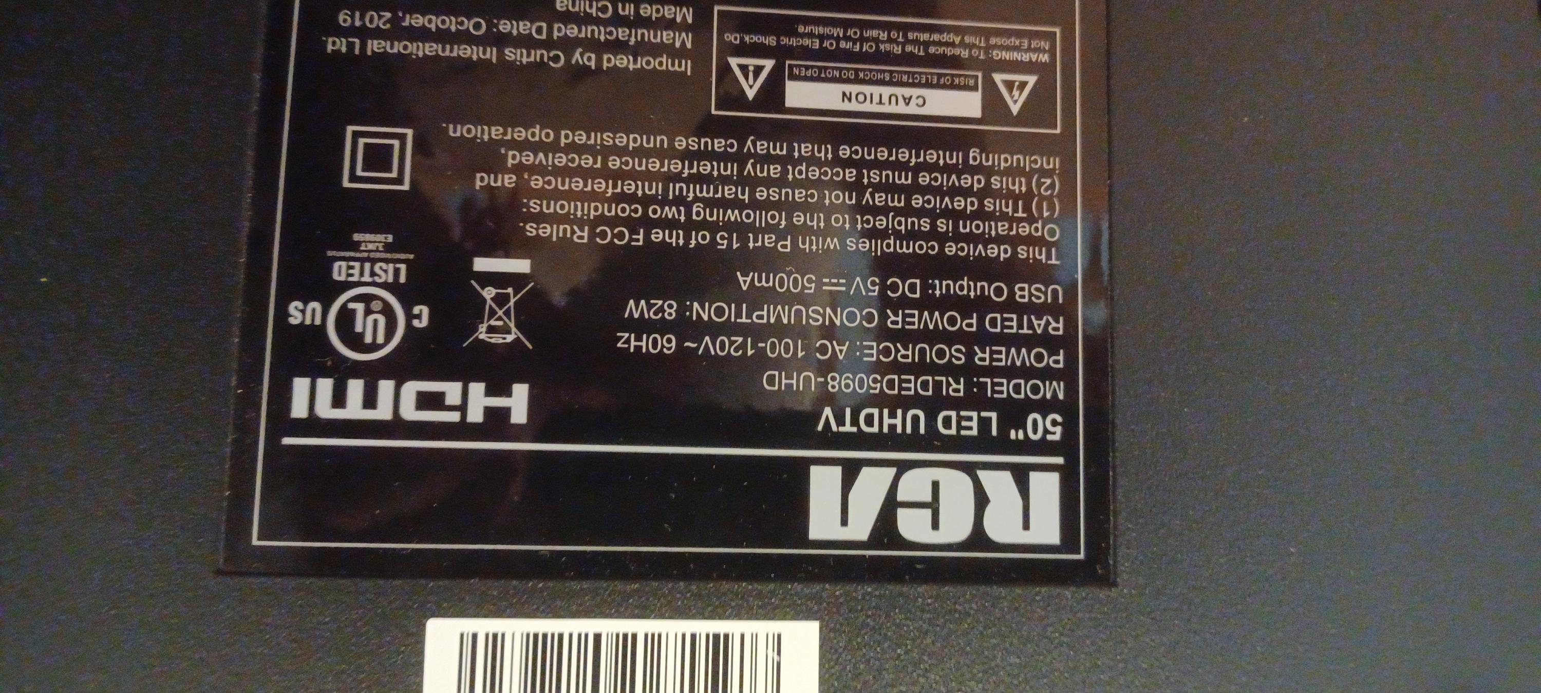

    I have a 50 inch RCA tv that is only 3 years old and now some of the SMD need to be replaced. My question is I have some 3030 1W 6volt I would like to use and the SMD on the tv show 2.5 bolts with a Led tester. Can I use the 6 volt for this replacement?

    Please post the TV model number
    Put make and model number in thread title ! ! !

      Re: SMD replacement for tv backlight
      Model number
        Model is RLDED5098-UHD
          No you can not.
            they are 3v apparently and are cheap from ali
              Just get the right ones, see if those are what you need: https://www.aliexpress.us/item/32568...d=Guk9Ki8mQor6
                  No problem, just take it slow, be very careful with the panel, when you put the panel back in take EXTRA time to make sure it's in properly, a lot of the failures are from folks tightening up the frame with the panel not in right and it cracks, maybe check some youtube backlight replacement videos on same or similar models and be sure to test the new backlights before installing.
