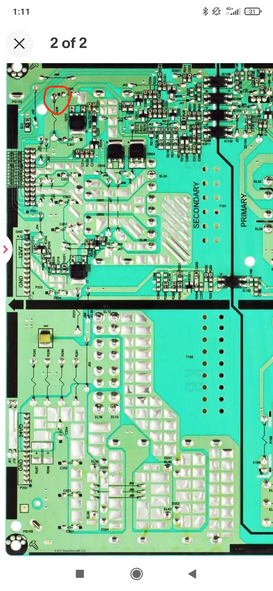

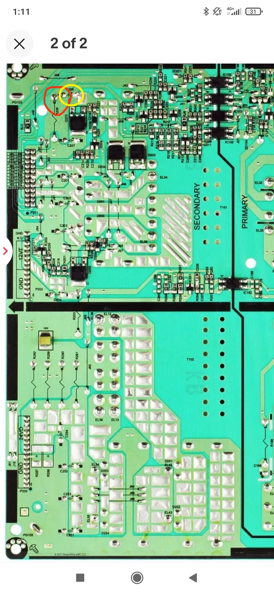

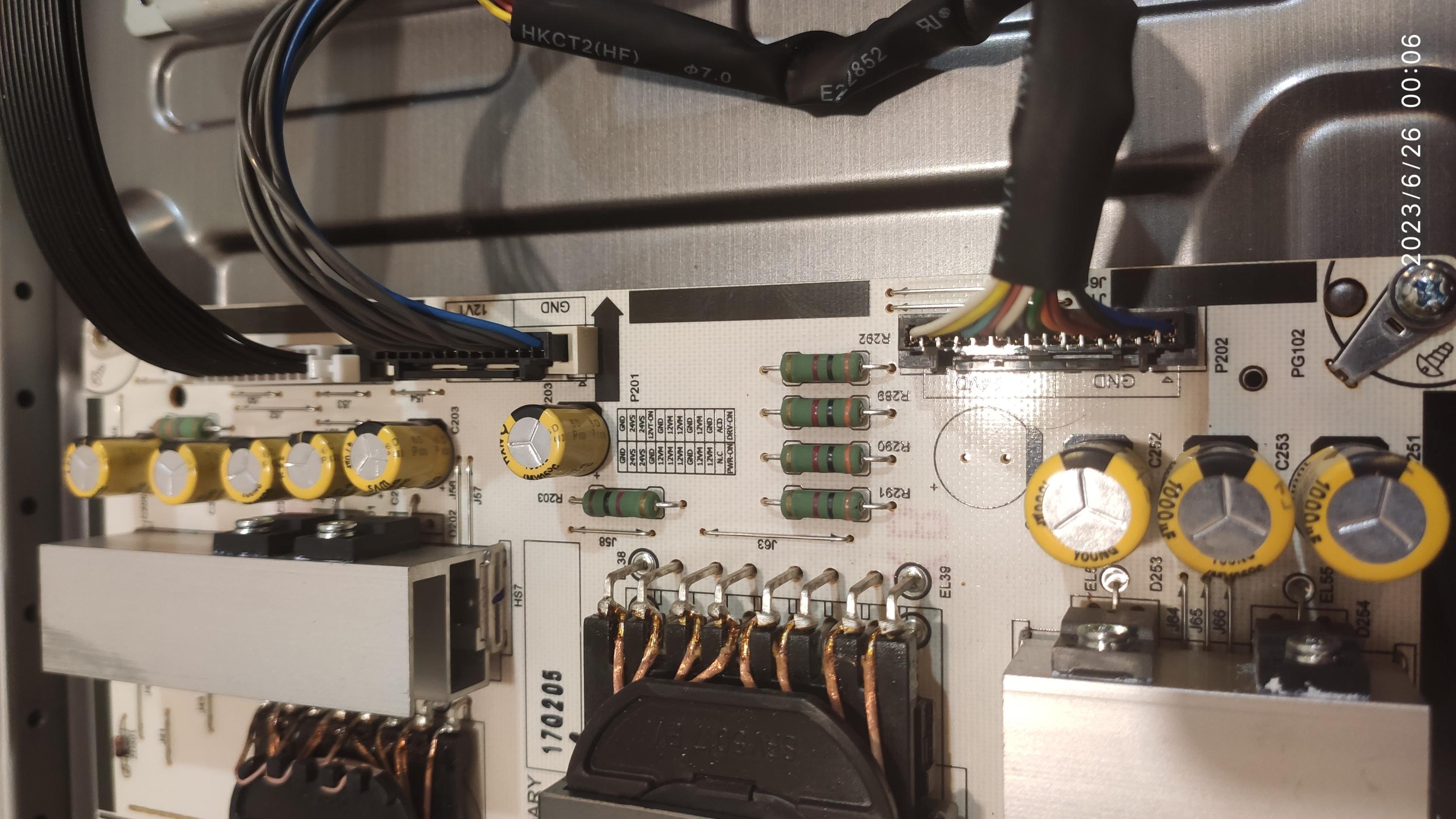

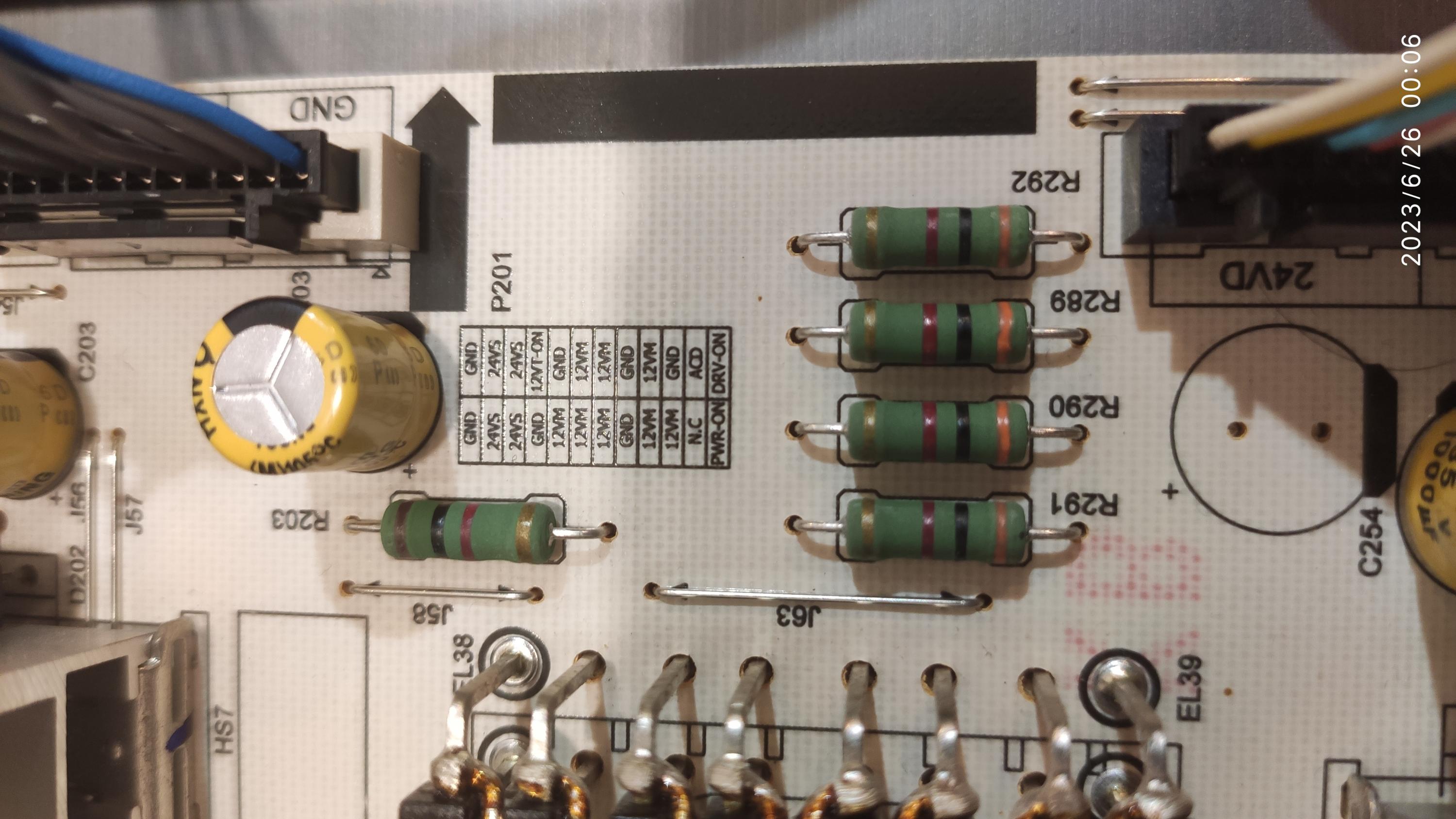

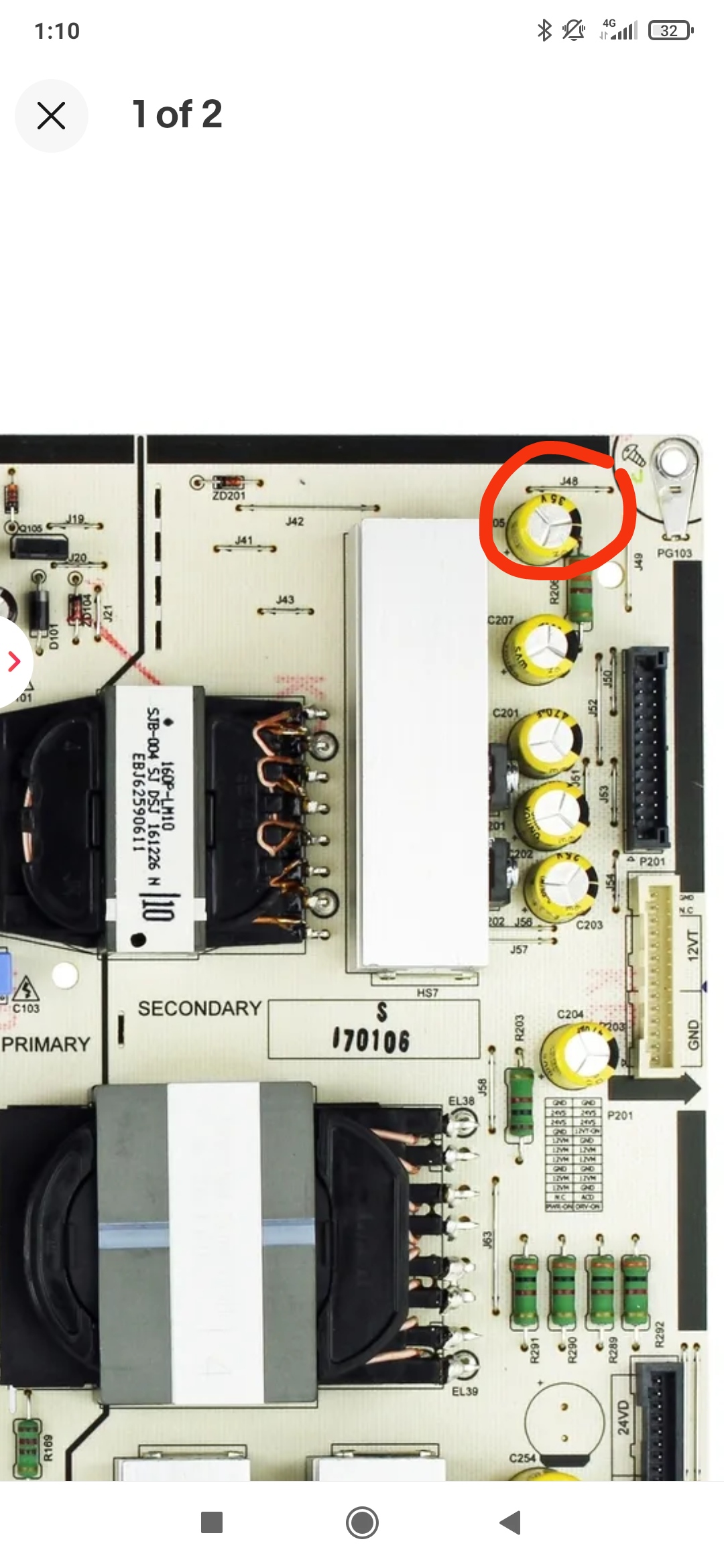

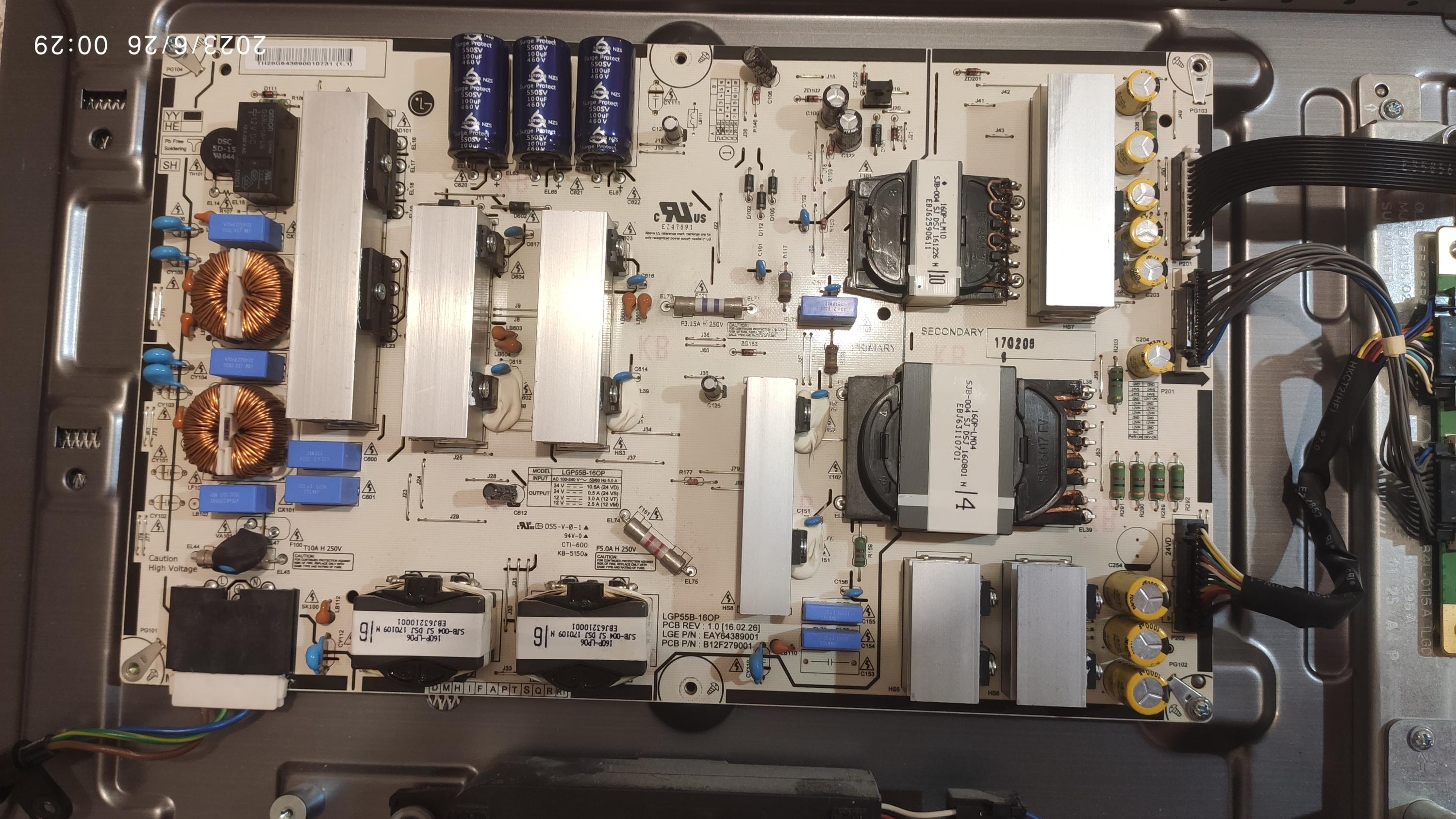

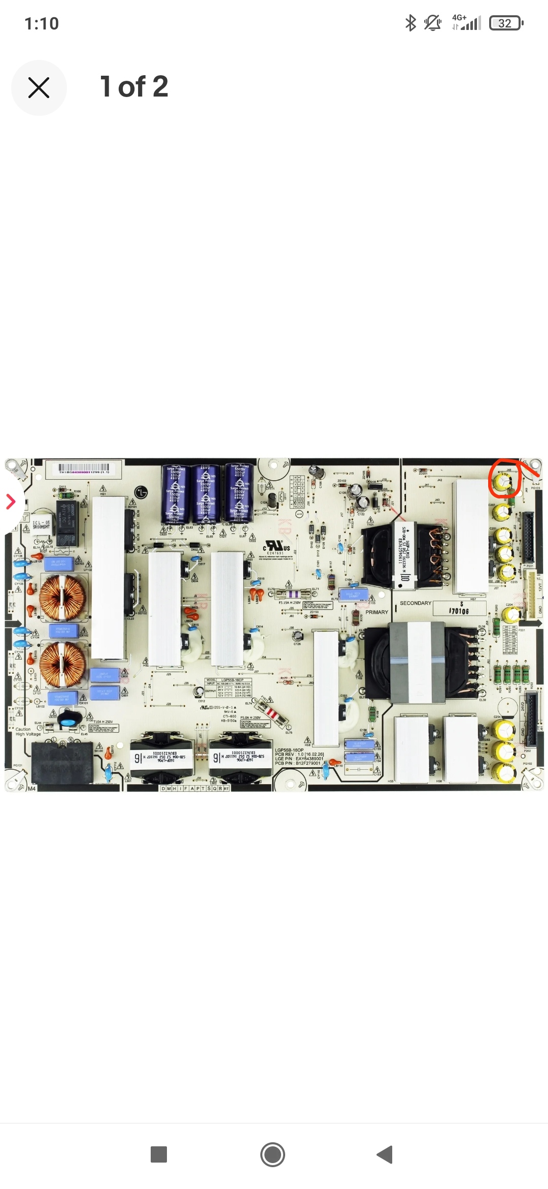

        aaaah. which capacitors have high voltage (primary) or low voltage (secondary) at a glance, they are all ok.
        the big ones that are put together at the primary voltage show me 250Uf, all three together. i.e. 80uf x 3, it says that they are from 100Uf.
        but I found 1 yellow capacitor first from the right and it is short circuited.. maybe but that's how it has to be?? the rest are not..
        I will mark it in the picture.
        Model of Power Board is: lgp55b-16op
        • R_J
          • Jun 2012
          • 9623
          Re: LG OLED55B6V dead ! Please help.
          The point you circled on the trace side of the board is NOT the capacitor, they are the same points of the trace.
          Check the power supply voltages, they are marked on the board.

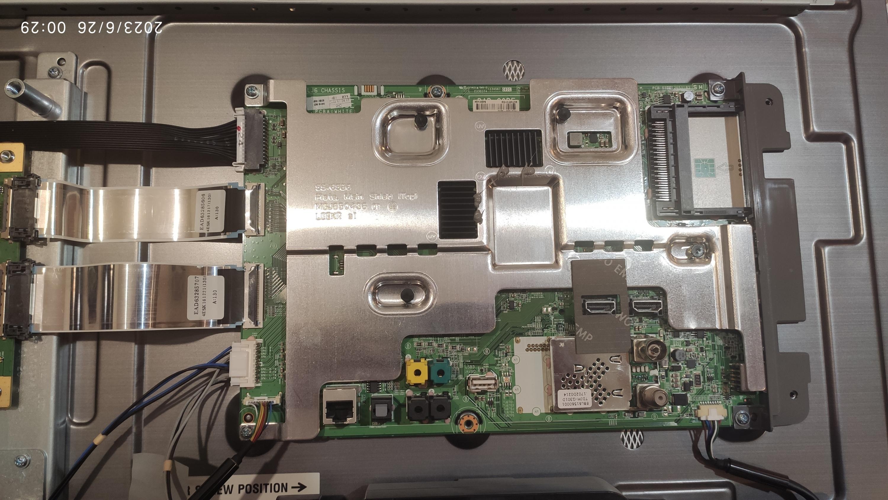

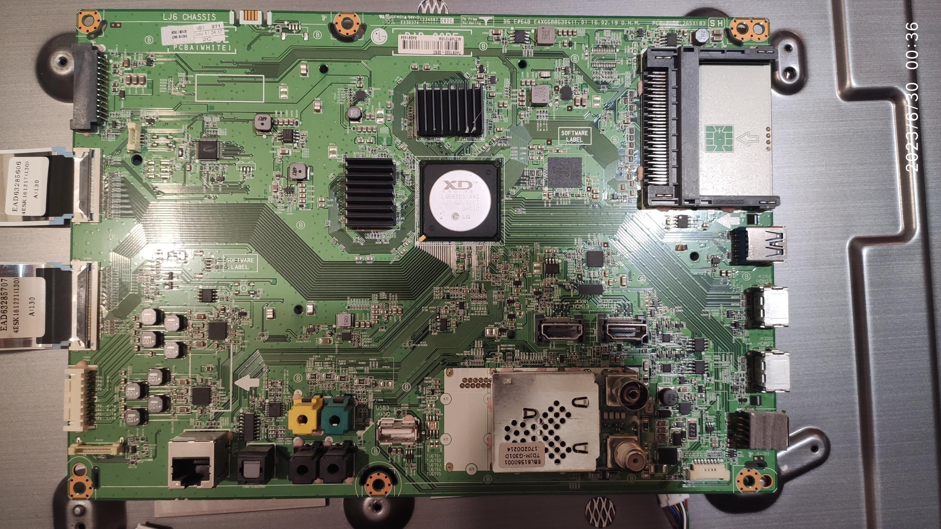

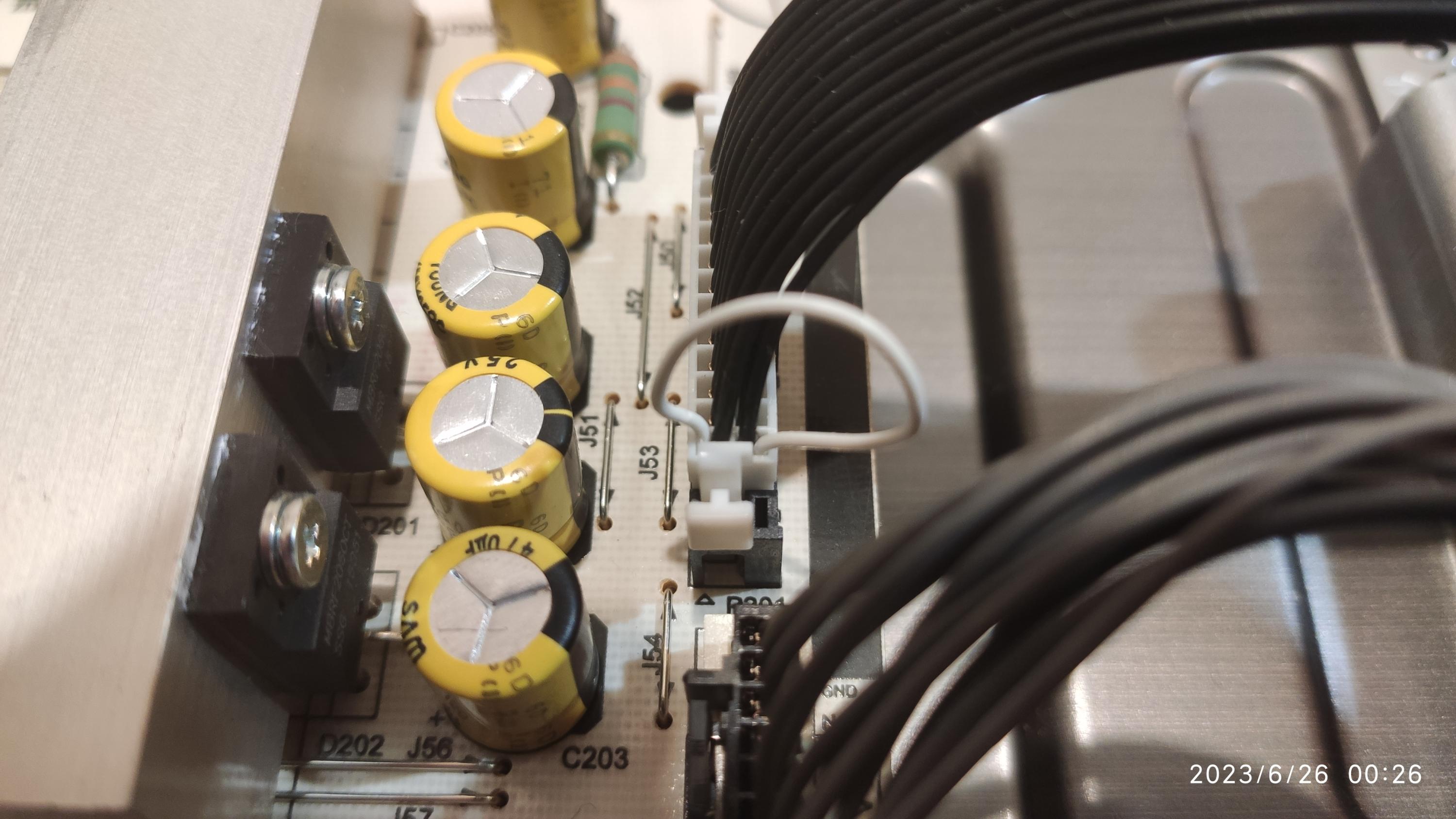

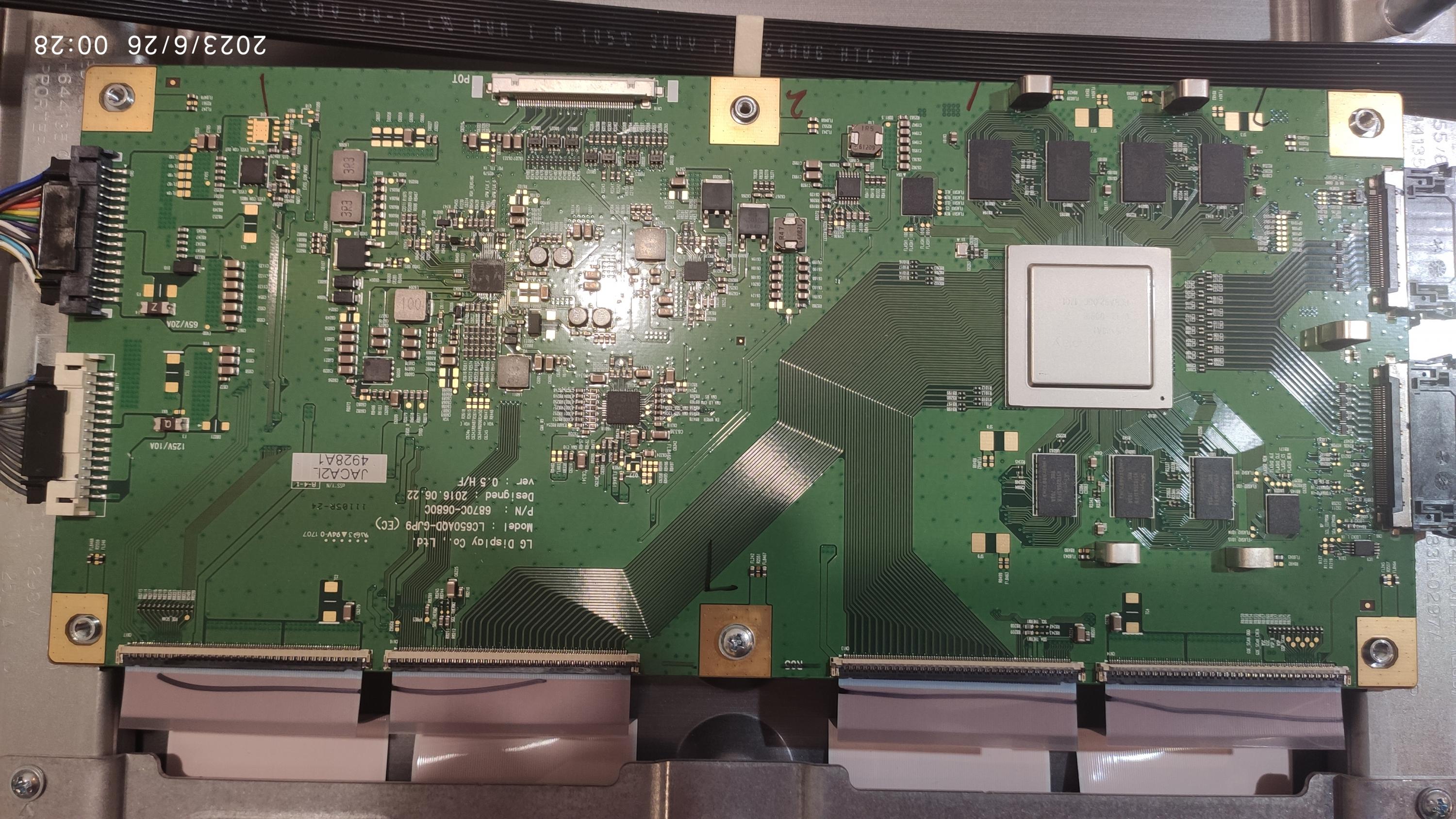

                      I made measurements when everything was connected normally, I had accurate measurements on all pins, except for 24V, there was none.
                      when I turned on the TV, it showed 7V on the pins where it goes to the T-Con
                      and on the return from the MB on the DRV-ON pin it was 0V
                      PWR-ON has 3.7V
                      then I made a jumper between PWR-ON and DRV-ON so as to force the power board to trigger 24V
                      and here I really turn on the TV, the relay click shows 24V on all the pins that go to the T-Con board, but there is no picture. The theme is perfect..
                      so I conclude that the Power Board is working...
                      but I don't know how to force the power board itself without MB to start all the necessary voltages? because with PWR-ON I need 3.7v and DRV-ON equally..
                      any advice?
                      below are some pictures..
                      I also tried disconnecting the LDSV cables from the MB to the T-Con.. the thing is the same, there is no picture.
                      I tried to disconnect all 4 flat cables leading to the panel.
                      In short, I assume that here the MB board is not working as it should... because it does not trigger DRV-On

                        This is LG. The motherboard has locked up due to panel errors.

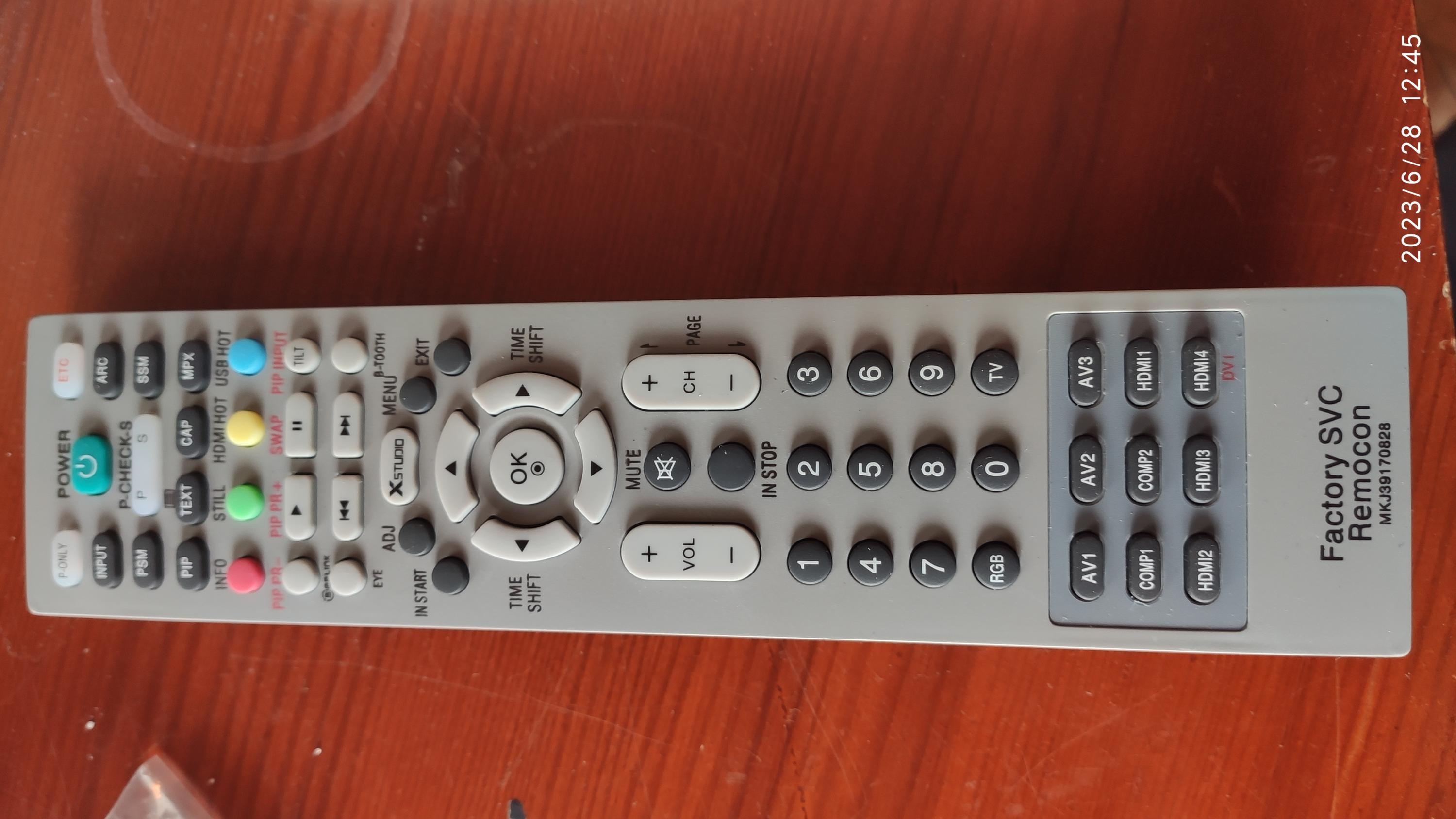

                            so I have nothing to do without a service remote control?
                            • markolino
                              • Mar 2020
                              • 109
                              • Slovenia
                              the thing is like this. Here I bought a service remote for an LG TV
                              where on the forum can I get info on how to use it?? where do I know how to factory reset the motherboard? I'm looking but I can't find it
                              please someone help me.
