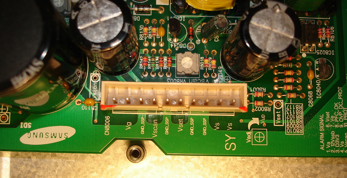

      Voltage readings on SN8006 & SN8007 is :
      Vg - 15.0V
      Vscan - -187.6V
      Vset - 195.4V
      Vs - 199.7V
      All fuses are O.k, I cant see "Vg" on the label with voltages. Also I attached two images, one of label with various voltages listed and second of connector. Please take a look at them. Thx.

        If you haven't already done so, download the panel service manual. They cover troubleshooting the panel, sustain and main control card. Note: IIRC, the second manual is the prefered one. The first one is in Spanish.
        One test that can be done is putting the main control card into a test mode. This eliminates the SSB and the cable from the SSB to the main control card.
