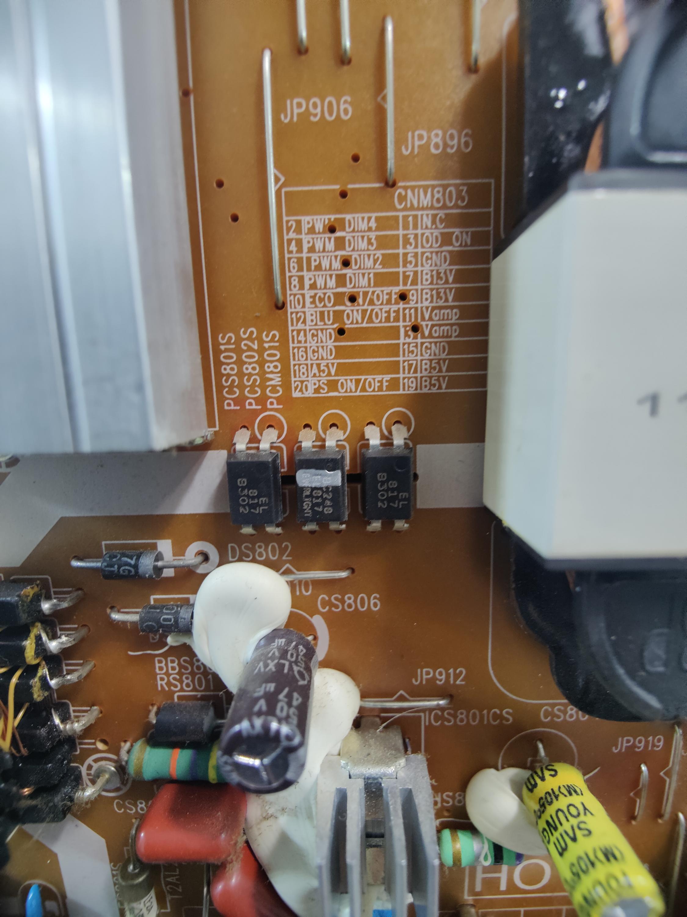

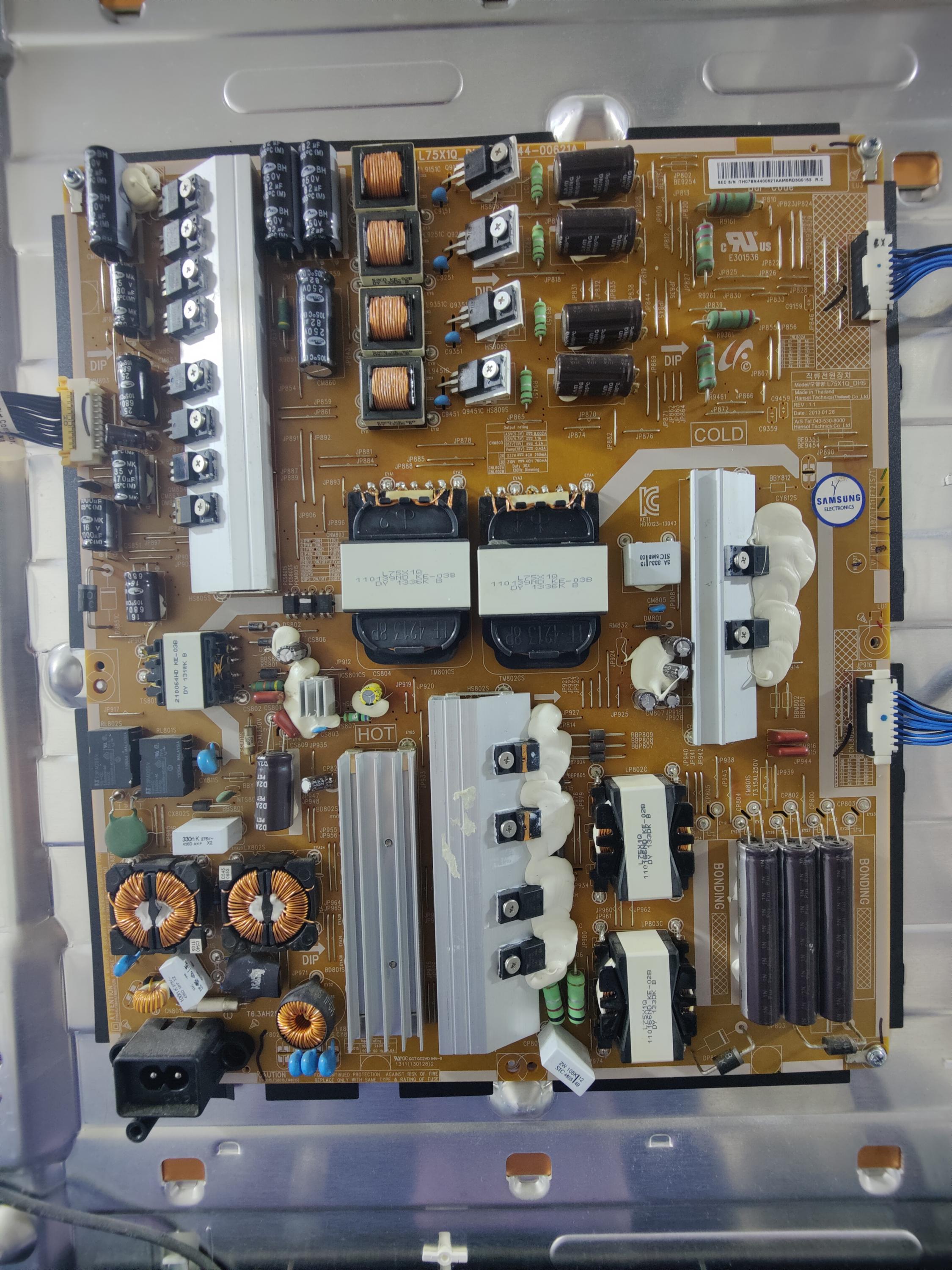

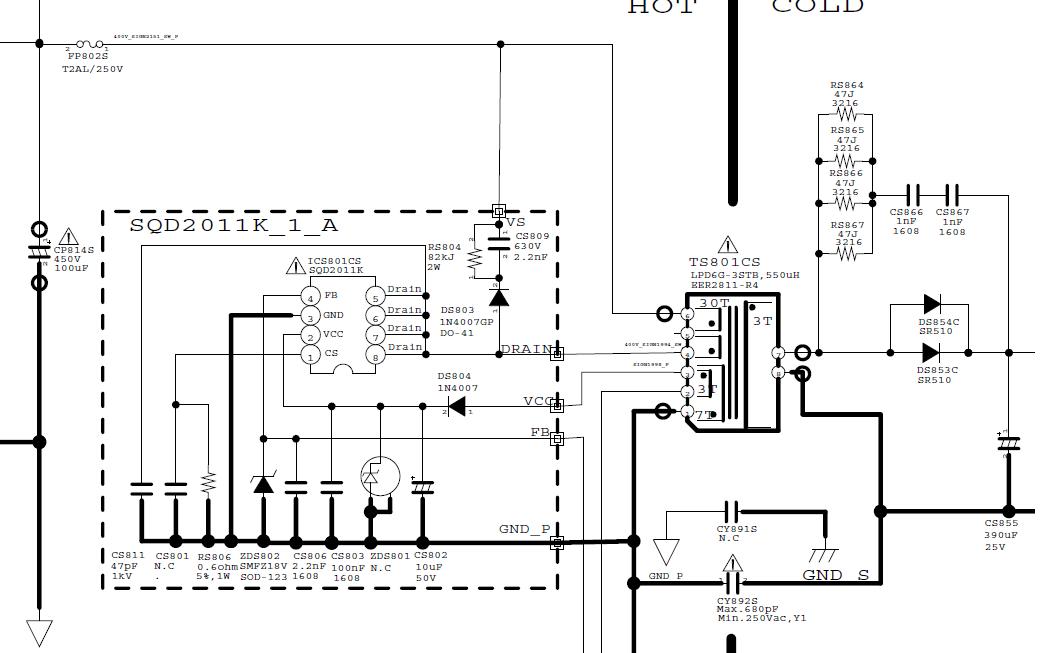

    Power Supply BN44-00621A Dead, no voltages on CM803, fuses OK, Transistors with heatsink OK, Diodes OK.

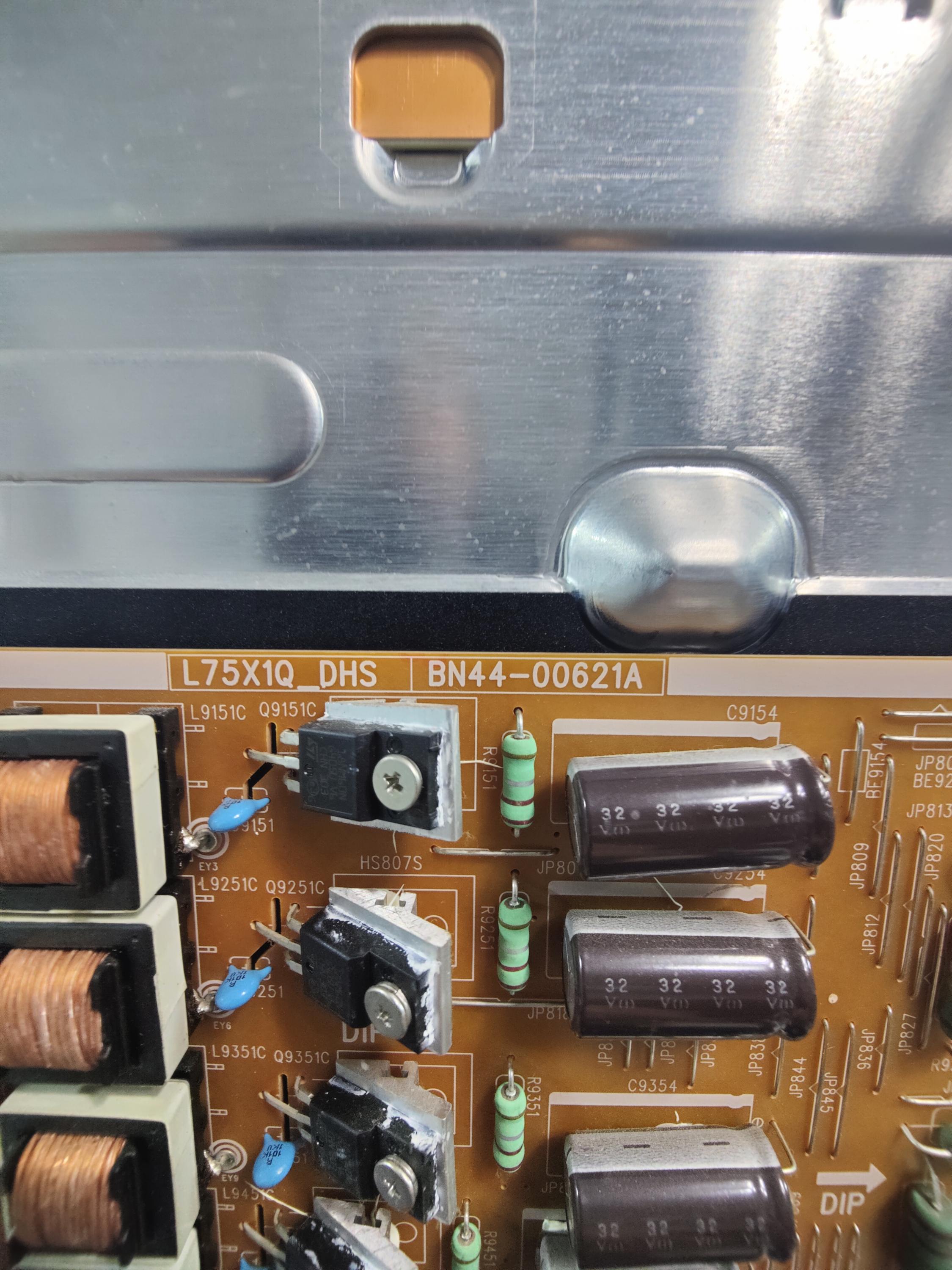

    Re: TV Samsung 75F6400AFXZA Power Supply BN44-00621A Dead
    what voltage are you seeing at the big caps bottom right picture 3 ? this is the rectified mains power if no voltage check between there and the mains power socket there should be a rectifier .
      Check the voltage ACROSS one of the primary caps CP800,CP802 or CP804, (Next to the word BONDING) should be around 165vdc. If you have that voltage, check the voltage ACROSS CS851, this should be your standby A5V, this voltage needs to be there before anything will work.
        0v across the main capacitors.
        • R_J
          • Jun 2012
          • 9627
          Check the voltage ACROSS CS809, this is the standby circuit supply voltage (165VDC), if not, check that you have A/C voltage on the inlet plug, I suspect you might have broken solder connections or broken traces on the plug where it connects to the board.
                    CS809: 157v DC
                    JP910: 0v
                    • R_J
                      • Jun 2012
                      • 9627
                      You should have that 157v on the 3 pins (6,7,8?) of ICS801CS If you do I suspect the ic is bad, it could be that CS806 is bad but not likely, Also check that the 5v output diode, DS851C is not shorted. You will need to remove it's heat sink to see the number.
                      • alfredomfr1
                        • Oct 2014
                        • 318
                        • usa
                        ICS801C is SQD2011K, it is receiving 157v but nothing is coming out, DS851C is OK
                        • R_J
                          • Jun 2012
                          • 9627
                          It is a very simple circuit, so if it is getting Drain voltage, check that the CS resistor RS807 is ok and not open, if it is ok, it is likely that the ic is bad, there could be a zener diode between pins 3 & 4, make sure it is not shorted.
                          Here is a similar circuit using that ic.
                          • alfredomfr1
                            • Oct 2014
                            • 318
                            • usa
                            ICS801C replaced.
                            Thanks to you R J the board is working.
