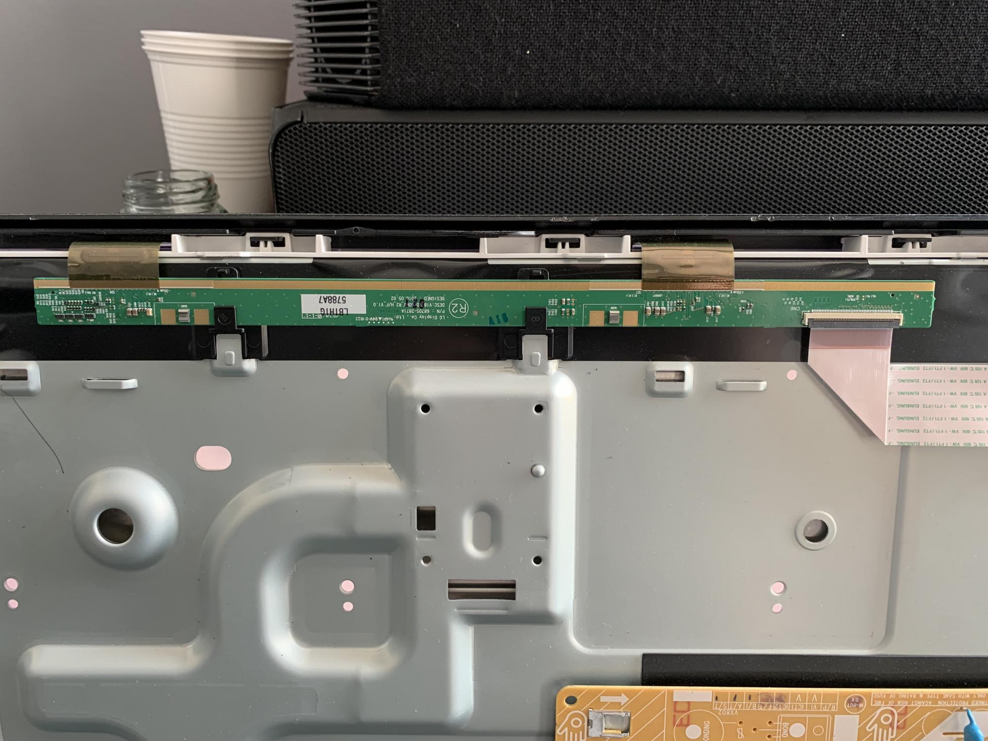

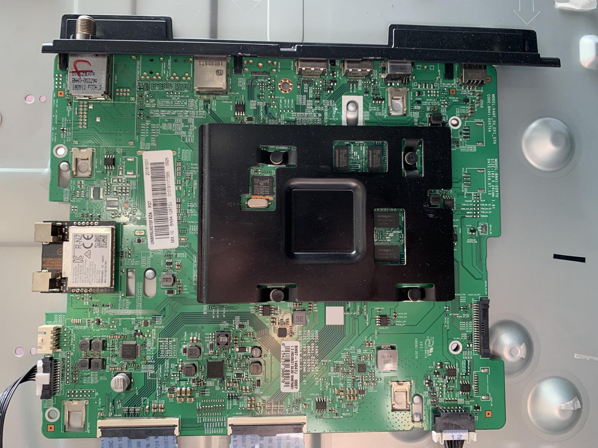

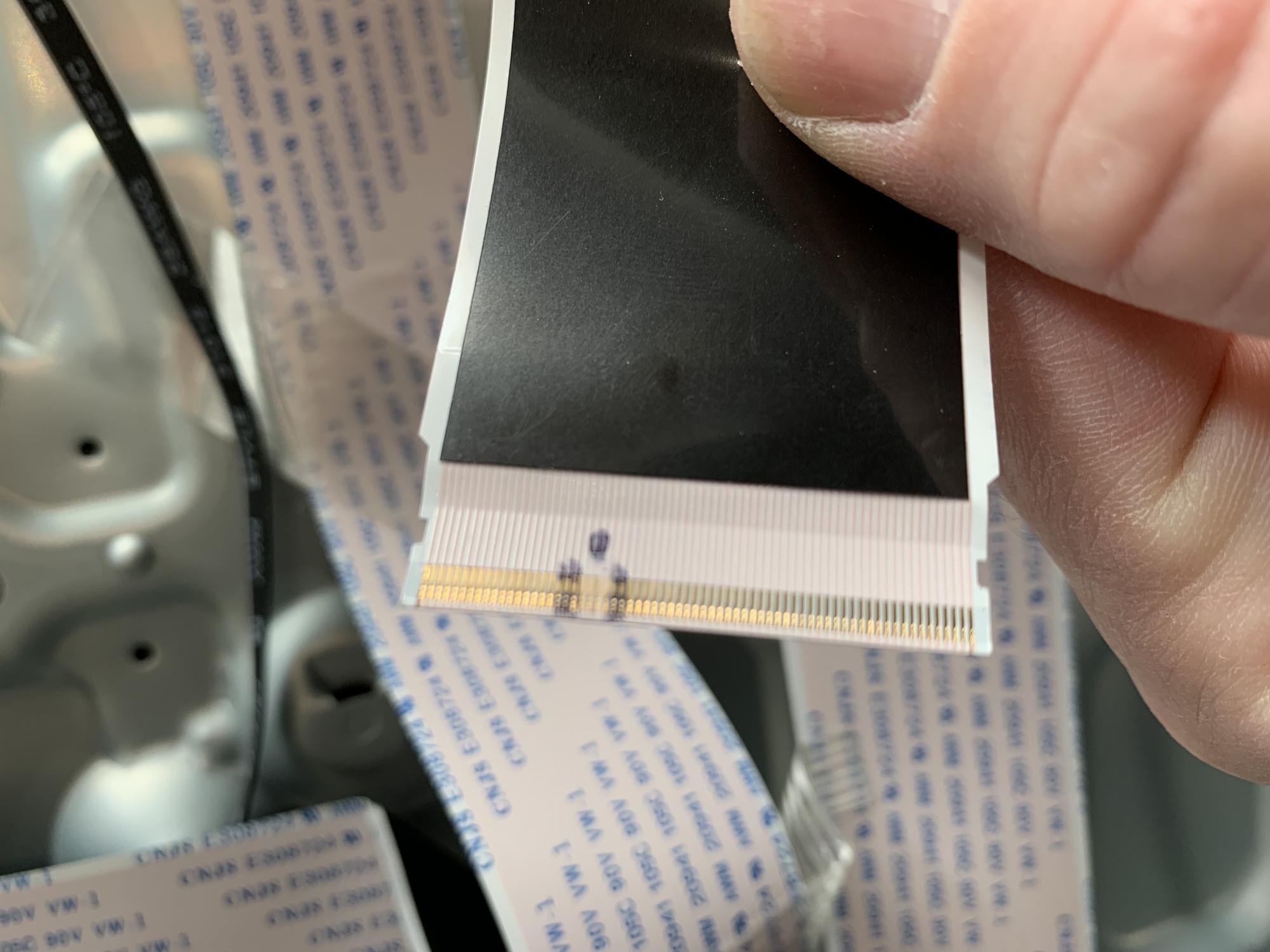

    I have this TV and at first no picture/ display.
    I traced it down to the panel I believe. If I cover a few pins on the lvds cable the display works and has a perfect picture.
    However after watching it for a week it reverts back to same problem. When I turn it on it's a blank screen again.

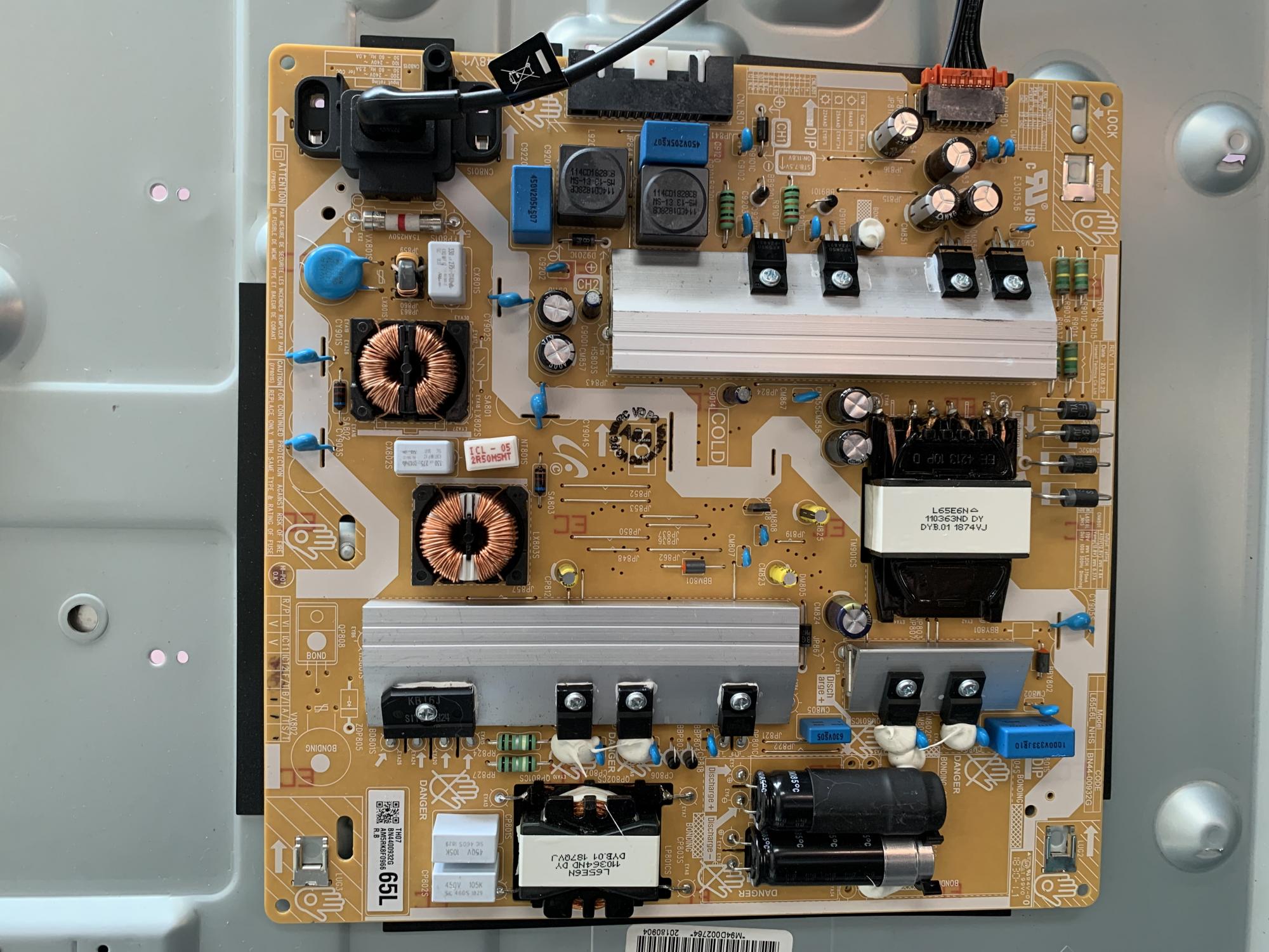

    I can verify the power board has all the correct voltages and I can still hear the tv and it powers on and off like it's supposed to. So assuming mainboard is good.
    Now after sitting for 2 weeks I turn it on and perfect picture again.
    Not sure what else it could be. Any insight would be helpful.
    Note I'm only covering 3 pins on the lvds cable there inside the black lines I made

    i don't know which pins you masked..
    but in general. Panel cells need an discharge action.. if you by chance blocked this action trace.. the panel after while of use will be blind /Jam

      Ok thanks for the explanation. I’ll count the pins masked and see if I can find out what they’re for.
      Someone, I think Lotas had a pin out of the lvds cable for another tv I was working on. Maybe he could chime in with the info for this model as well to identify the pins.

              So I have pins 21-24 covered.
              Pin 21 is fsc1, pin 22 is ground, pin 23 tx_ch8_a+_usit, and pin 24 tx_ch8_a-_usit

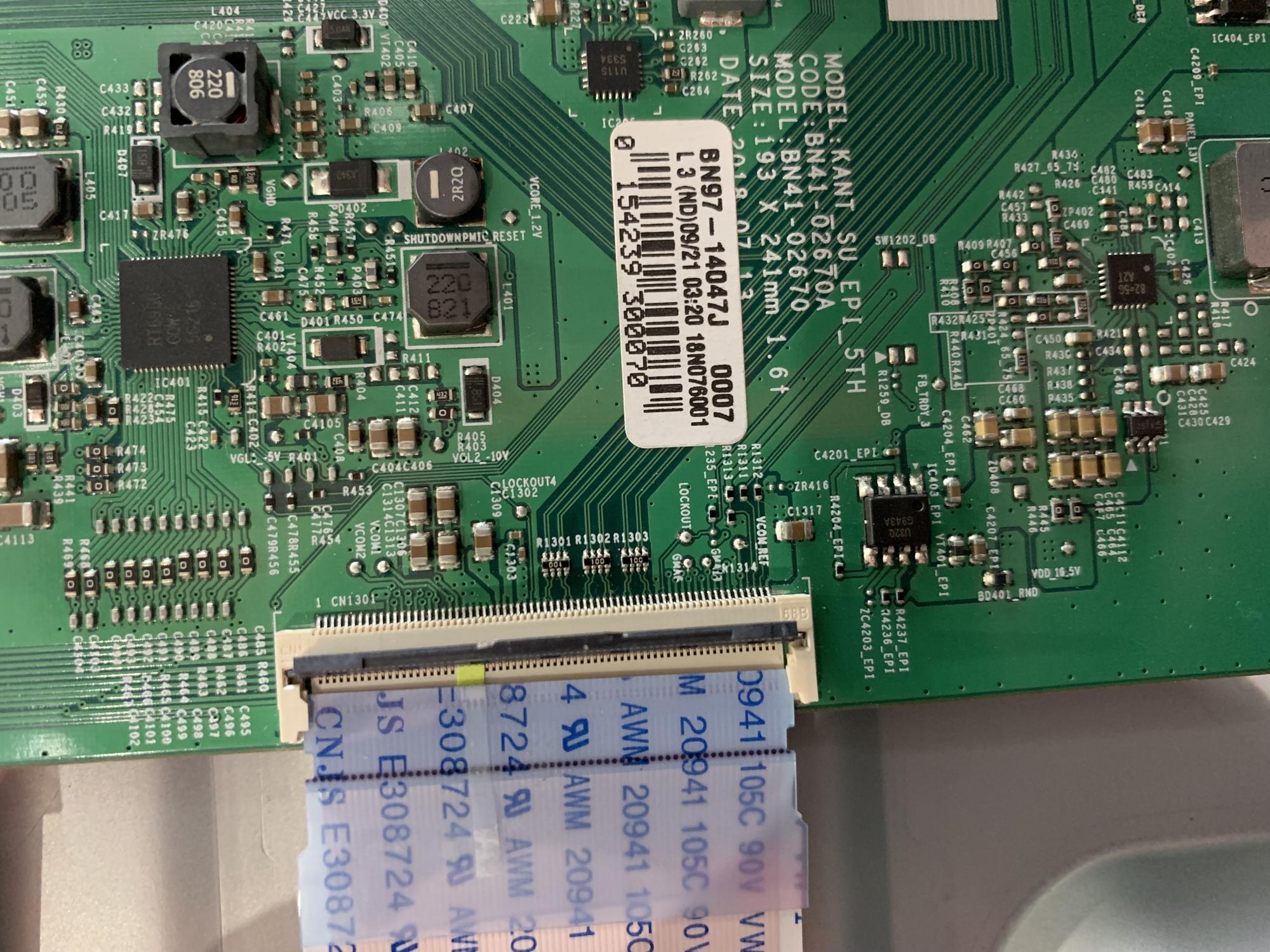

                Can you take a pic like this?
                https://www.badcaps.net/forum/attach...1&d=1681884737
                Its really easy to get the pins reversed between service manual and actual cable.
                The pair of USIT lines transmit pixels for a section of vertical column. If these are used by t-con (not all USIT are used, read on) and blocked, you will see a picture like this
                https://www.badcaps.net/forum/attach...0&d=1681883964
                Samsung often don't use all the USIT pairs lines on the cable. Since you don't have any picture problems, this USIT pair maybe unused OR got the pins backwards. Thats why I asked for the first picture. If you look at my first board picture carefully, you can see many trace pairs running to the flex connector. Each pair is a USIT pair responsible for a column section of the screen. flex and connector specification usually have more USIT connections than the board actually connects so some pairs are not used.
                There are many GND lines on the flex so blocking one should be okay (I guess?) Don't know what FSC1 is. In any case, lets start by making absolutely sure we have determined the correct pins that are blocked.

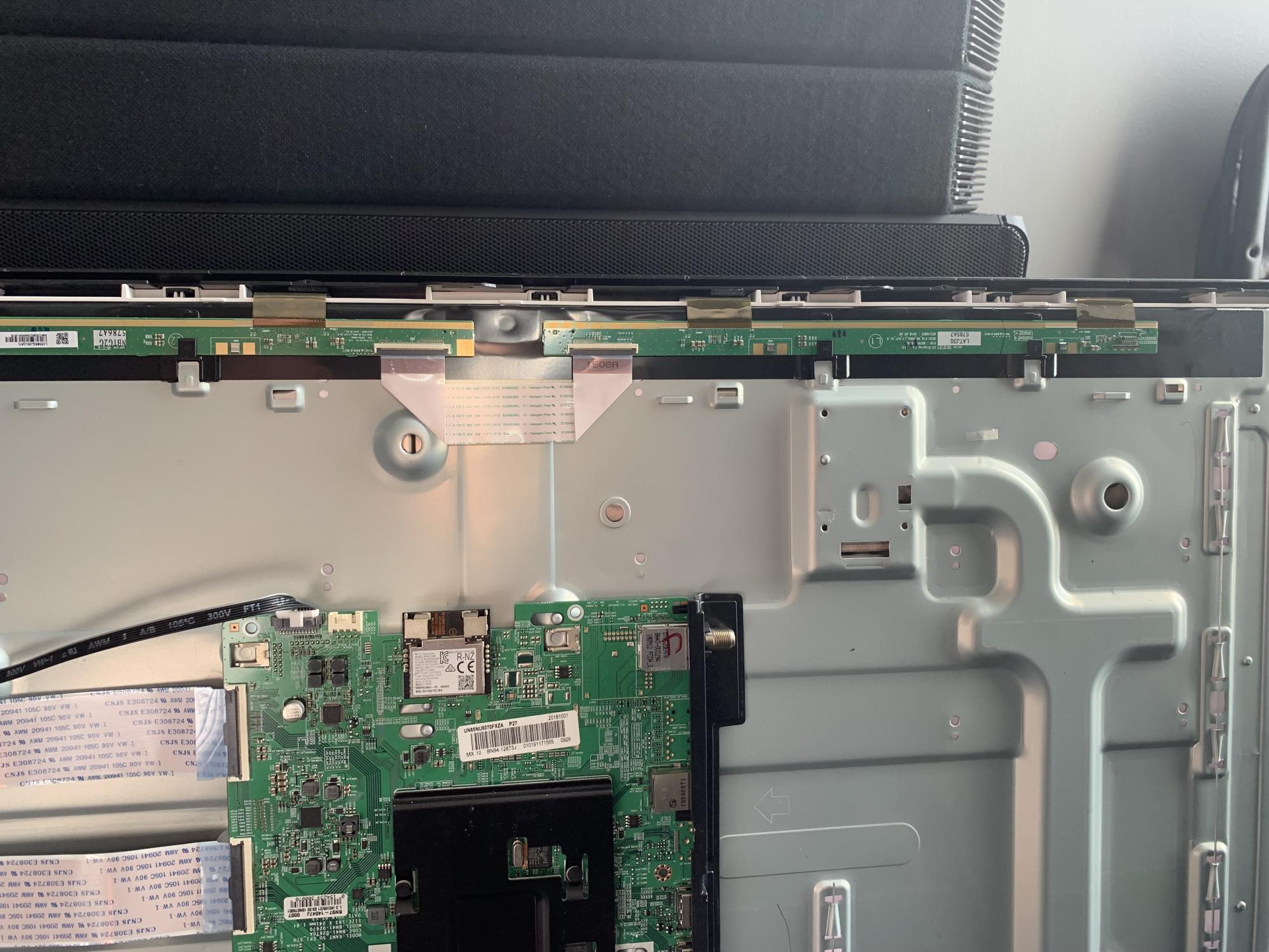

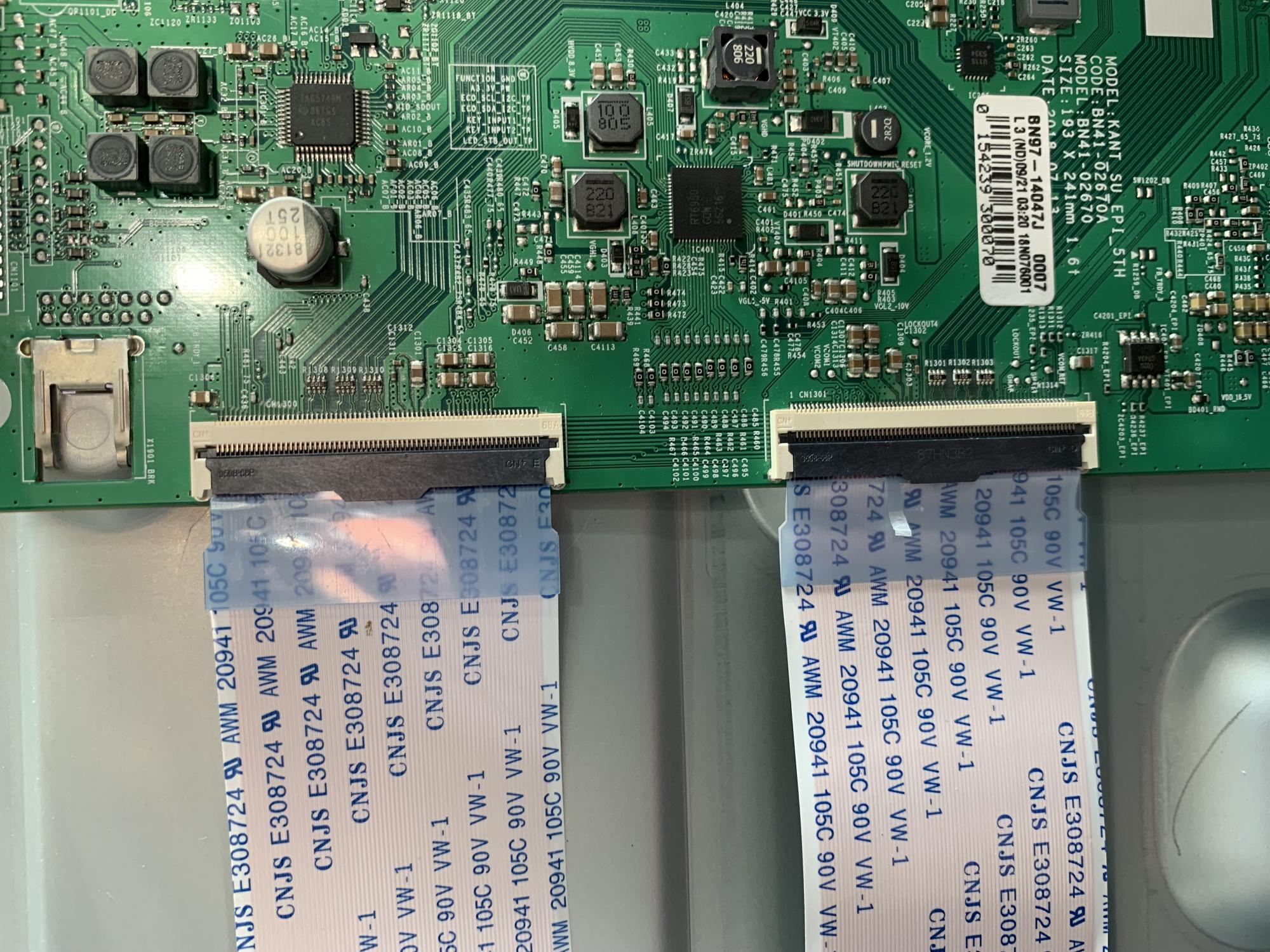

                  Hope this helps. I don't use paper to mask off and it was a little difficult with it leaning against the wall. Laying it flat down would have been much easier but no space at the moment.
                  • howardc64
                    • Jun 2017
                    • 654
                    Re: Samsung 65NU6070 strange panel issue???
                    Originally posted by Storyteller12
                    Hope this helps. I don’t use paper to mask off and it was a little difficult with it leaning against the wall. Laying it flat down would have been much easier but no space at the moment.
                    Your main board's (BN94-14047J) t-con trace doesn't match the UN65NU6900F service manual I provided despite being very similar.
                    TVPartsToday's main board compatibility shows your board PN (BN94-14047J) matches UN65NU6900FXZC. But this board pic also doesn't match t-con trace of the UN65NU6900F service manual. Perhaps there are panel factory and t-con differences for FXZA FXZC etc... Don't know.
                    https://www.tvpartstoday.com/BN94-12...n94-12873j.htm
                    So while you blocked out pin 21-24 on CN1301, we don't know what signals you they are. But there are some clues
                    CN1301 shows pin 22-26 are all ganged together. This is likely a power rail (see the big SMD caps nearby. Likely board GND on the other side of these caps) But you didn't block 25-26 so the power rail is unblocked. Maybe it is unnecessary to block 22-24 as well?
                    Maybe pin 21 is the only pin that requires masking? To find out what this pin is, use multimeter diode/continuity mode to find see the equivalent pin/trace on the 1) other T-con connector (CN1300) or 2) the buffer boards and hope there is a label

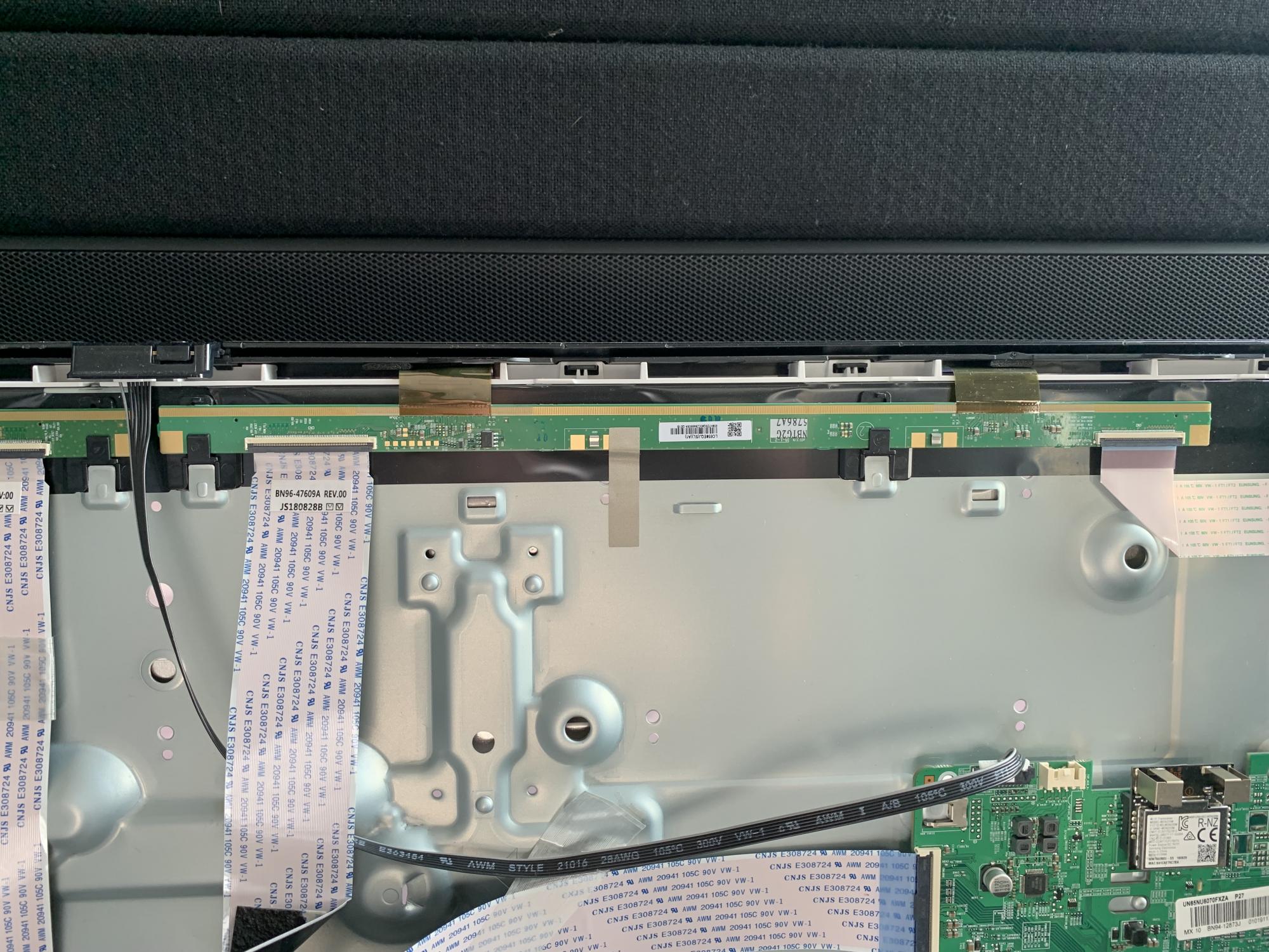

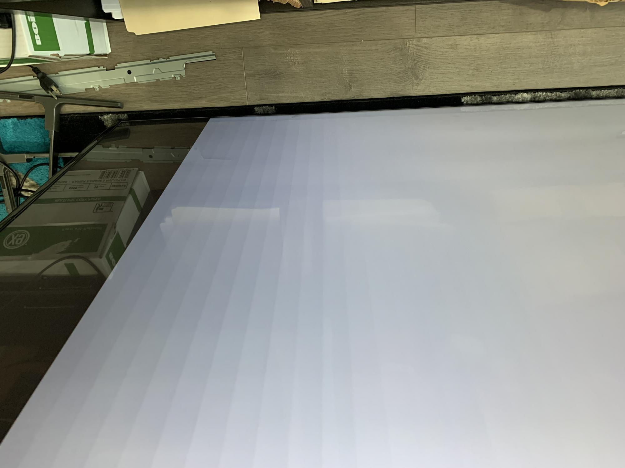

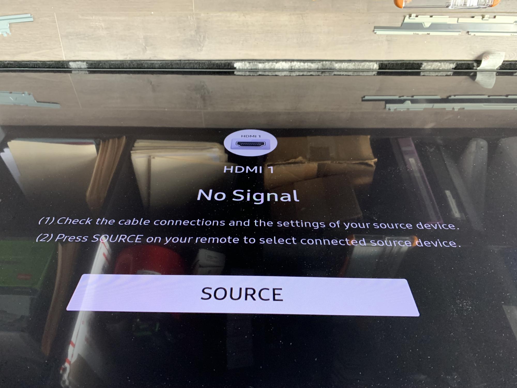

                        Ok, today I come in turn the tv on and here is what I get.
                        • Storyteller12
                          • Jun 2020
                          • 625

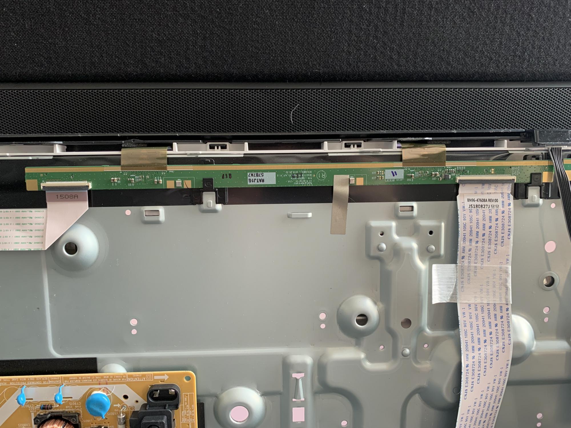

                          Diah: I did try to remove tape and unplug the u ribbon on the buffer boards but got no image still.
                          • Storyteller12
                            • Jun 2020
                            • 625
                            Just now I turn tv off and back on and perfect picture again. I'm at a loss
