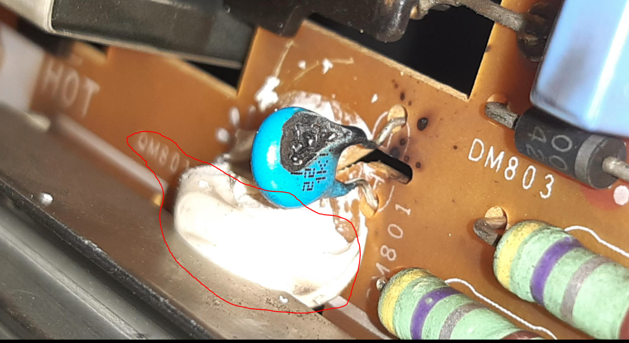

    Hello.

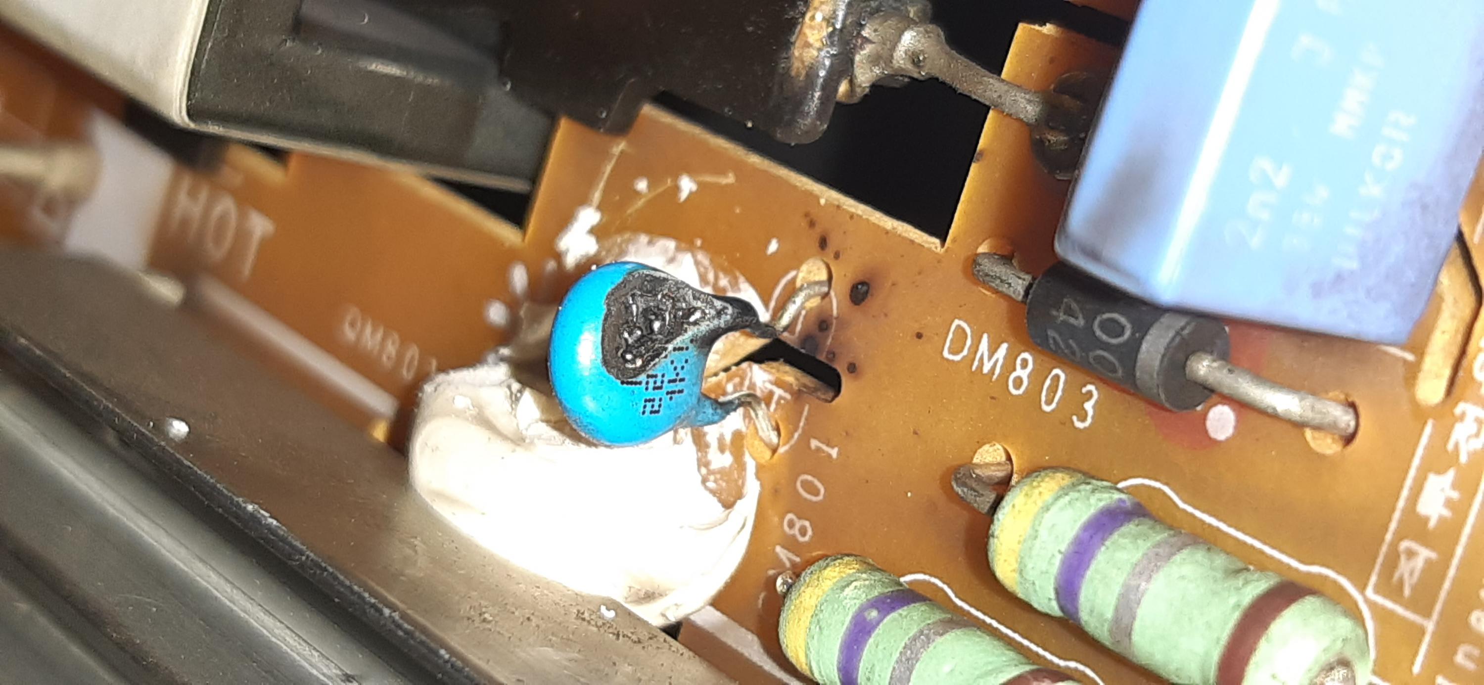

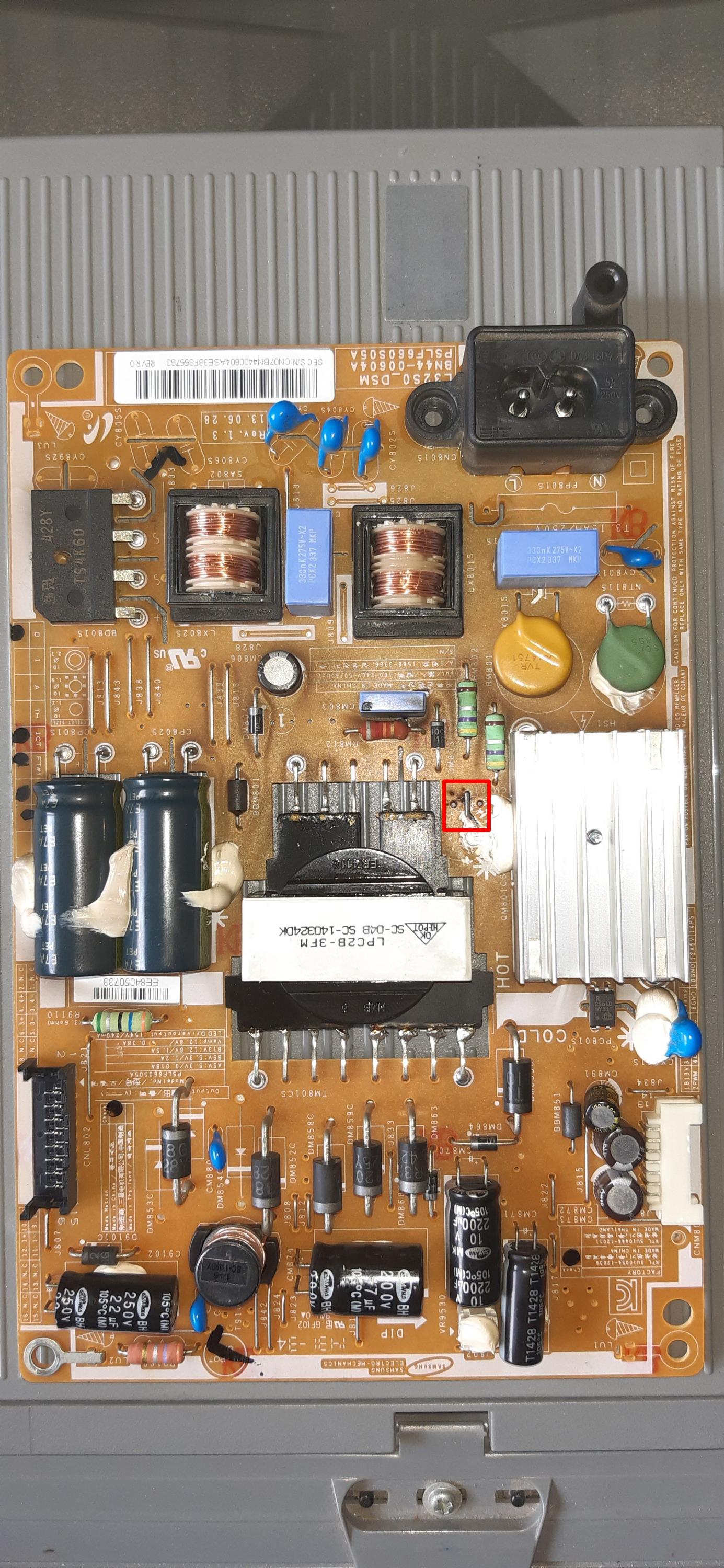

    My mother in law turned the TV on it said no signal, she then unpluged the tv plugged it in and big bang happened. After that no led indicator was glowing.
    Took the tv apart and fuse was dead, rectifier is ok, but found the blown blue capacitor near the 9NM60N mosfet between drain and source. Can anyone tell me the value of this cap.
    And the mosfet driver model is unreadable like its spilled with some foggy glue.
    This is my first time trying to repair a TV, any help would be apreciated.

    Re: SAMSUNG UE32F4000AW dead no power
    221k 1kV
    220pF 1000V
    Thomas
        Originally posted by krsta
        Thank you for the info.
        I have ordered some from ebay. i hope it wont blow up
        When this capacitor explodes, it can take this transistor with it, and the transistor takes a bunch of other components with it, you need to check everything carefully!

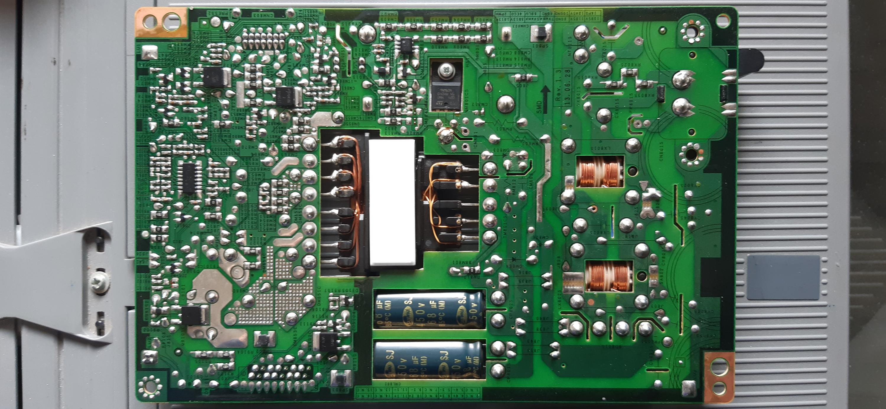

          All diodes and resistors are ok, no shorted caps arround s3310 mosfet driver
          (cant find the datasheet).
          Mosfet :
          D -> S 0,54V (red probe on source)
          D -> S OL (red probe on drain)
          G -> D OL (black probe on gate)
          G -> S 0,65V (black on gate) resistance 9Kohm
          G -> S 1.2V (red probe on gate) resistance 9Kohm
          Looks like mosfet is dead. Ill replace mosfet and the driver and try then.
          This aluminum heatsing is a pan in the a** to remove, have any tips?

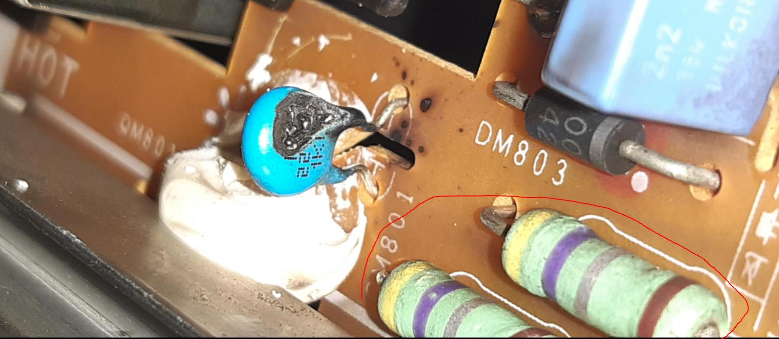

                Are these resistors alive?
                • krsta
                  • Nov 2020
                  • 33
                  • Croatia
                  0,3 Ohms each
                  • lotas
                    • Jan 2016
                    • 4649
                    • Russia
                    Ok
                          I had to order a new set of capacitors because the post office lost the package.
                          They arrived yesterday, soldered a new fuse and cap -> it works
                          Thank you all for help.
