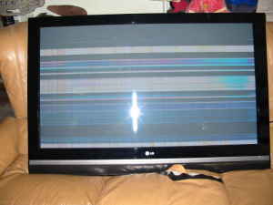

lg plasma fixable?
  • dchoiper4
    • Sep 2010
    • 2
    lg plasma fixable?
    can anyone tell off hand whether this tv would be worth attempting to fix? it is a lg 50 in plasma

    Re: lg plasma fixable?
    You could at least tell us what model this is.
    Give us half a chance to help you.
        Do you think you can fix this tv?.....I don`t think......I know!....I don`t think you know either! The real answer is...yes you can fix this tv! Start with ribbon cables. Make sure they are seated properly in the control board. ( The board just below the power supply behind the tuner board it will have green leds on it) You want to check the flat cable going to the y drive from the control board. The y drive board is the large board on the left side of the tv as you look at the back of the tv. start with that then give us a model number.
        be careful with the connections they are easy to break.
