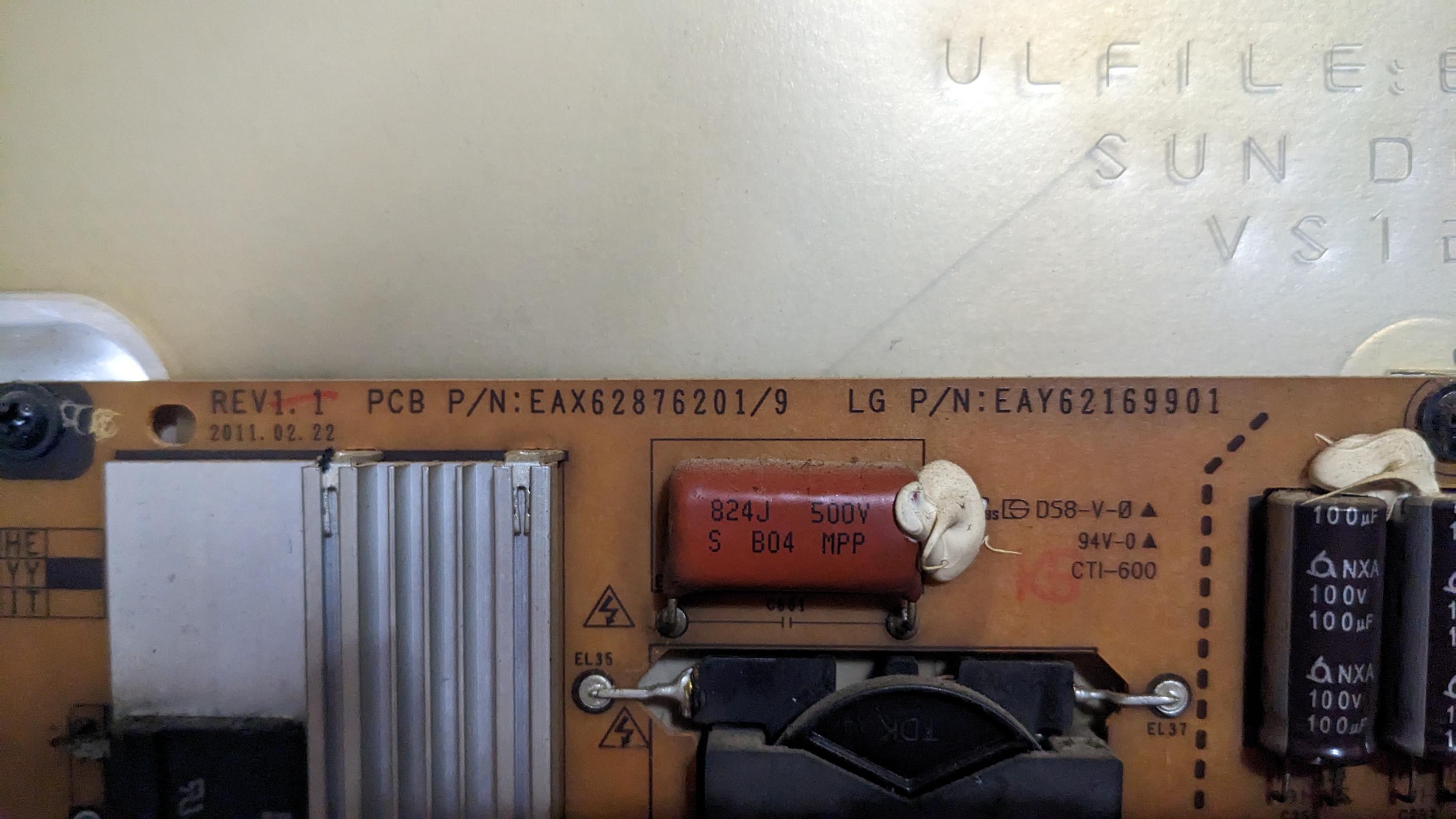

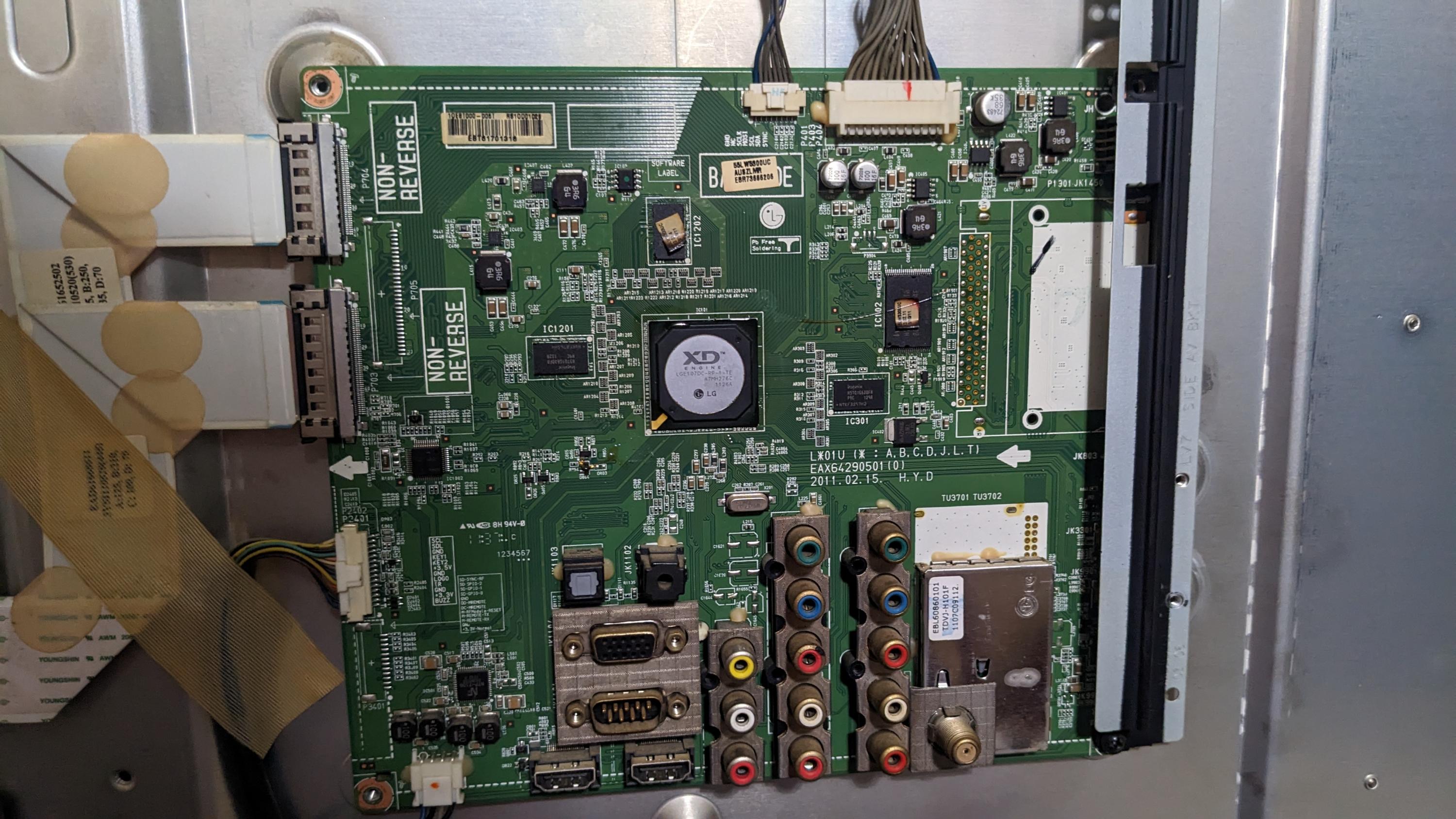

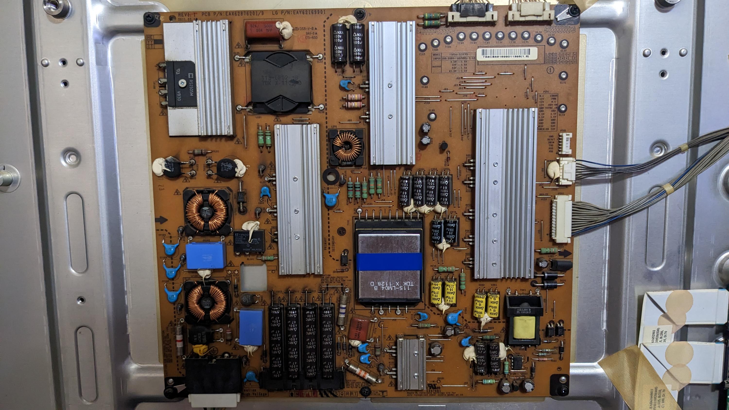

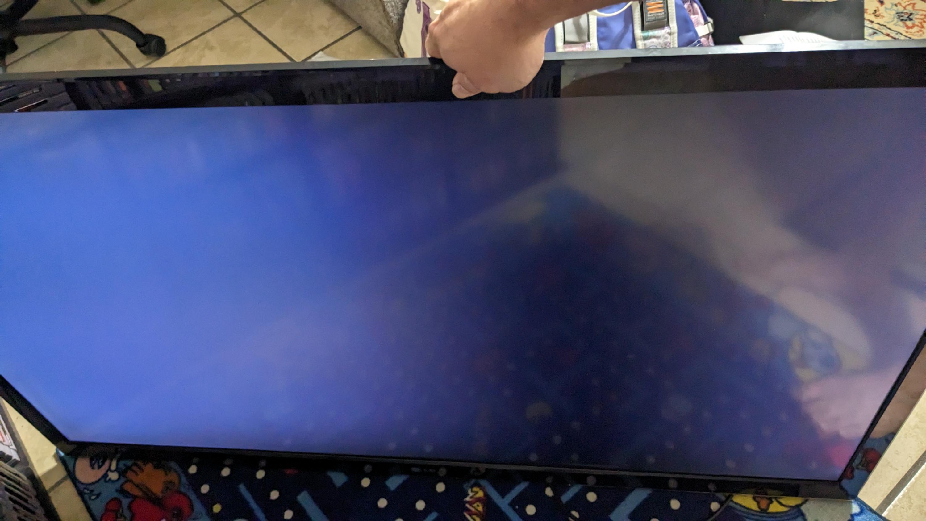

    Hello all, I was given an LG 55LW5300. When plugged in I get backlights but no picture. I checked voltages and found the Power On voltage to be 3.4V instead of 24v. All other voltages are normal at a powered on state. I did look around for solutions and found it could possibly be the IC's needing reflowed. I did this with my hot air rework station and this did not solve the issue. I'm not above replacing a board but I'd like to know which board it might be. Seems like a motherboard problem to me but I'm not 100% sure. Any ideas what the problem could be? Photos attached of boards and TV at On state. Note: I temporarily removed the heat sink on the main IC when I reflowed the solder.

    Could be nand and spi, see if panel gets sca. Could also be a panel level short or tcon.

      What's an SCA and how do I check it?

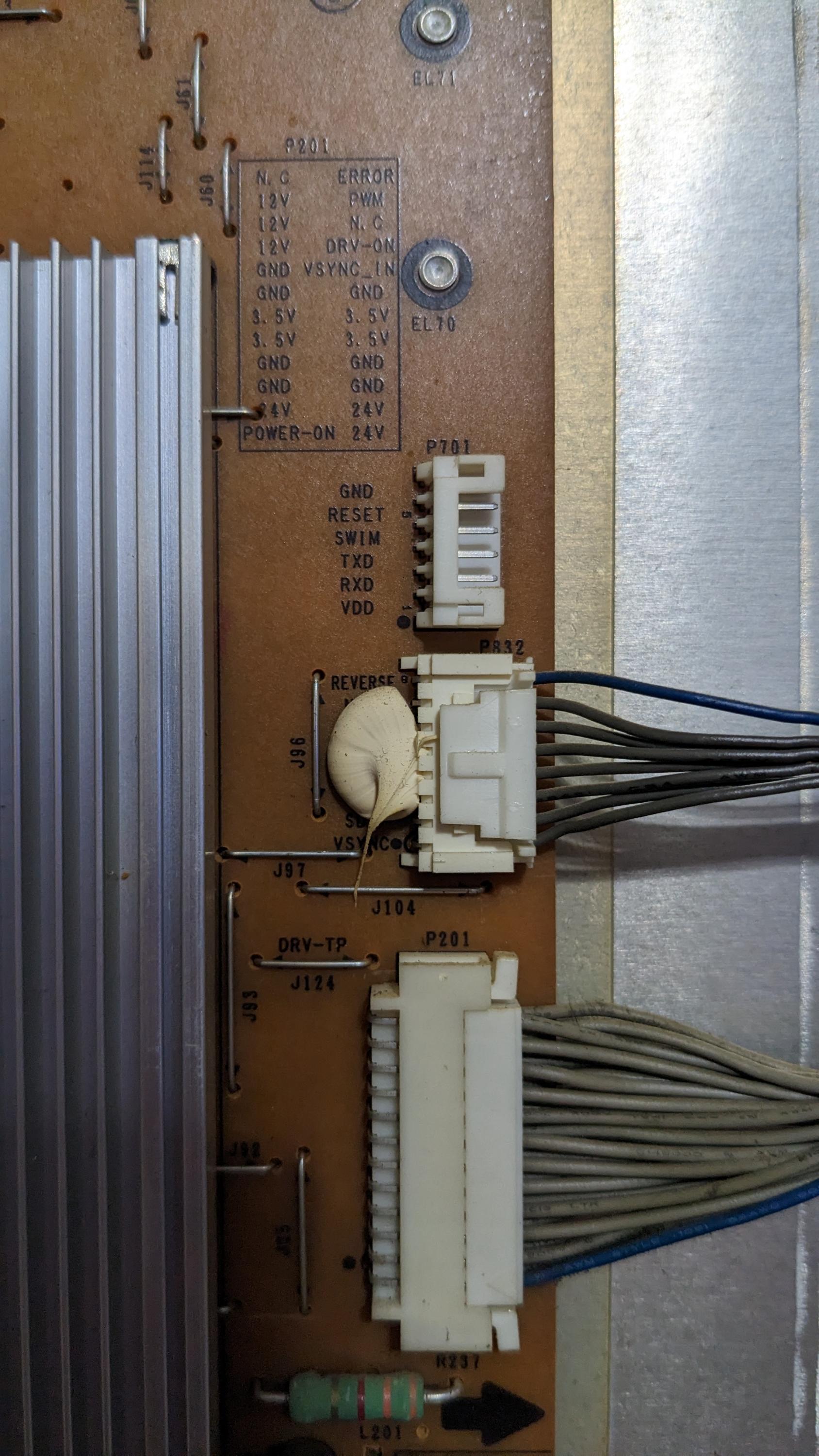

      Also I'd like to correct something from my opening post. I didn't see there were a second row of pins on the main connector between the power board and main board. The power on pin reads 3.4v and the pin under it reads 24v. I checked all voltages on the second layer and they were all fine. No voltage on the error pin.

          Thanks, I checked the power on flow chart and seemed to be getting voltage everywhere it wants me to check. Everything seemed normal.

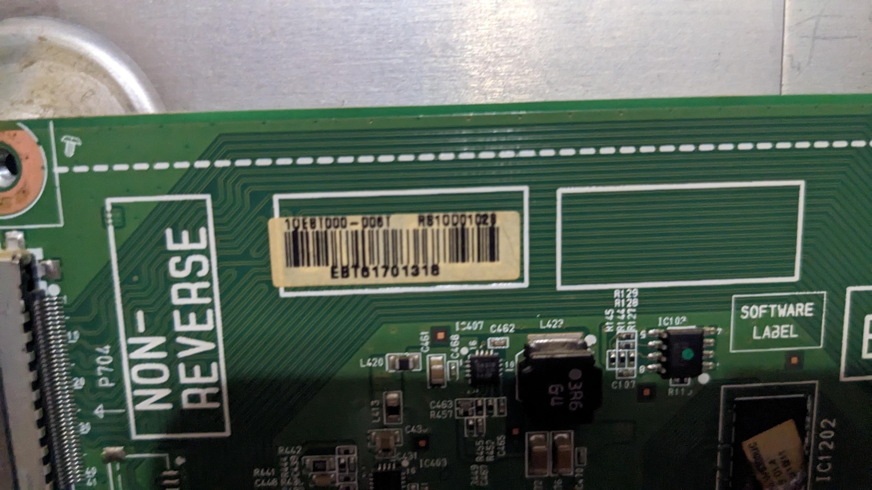

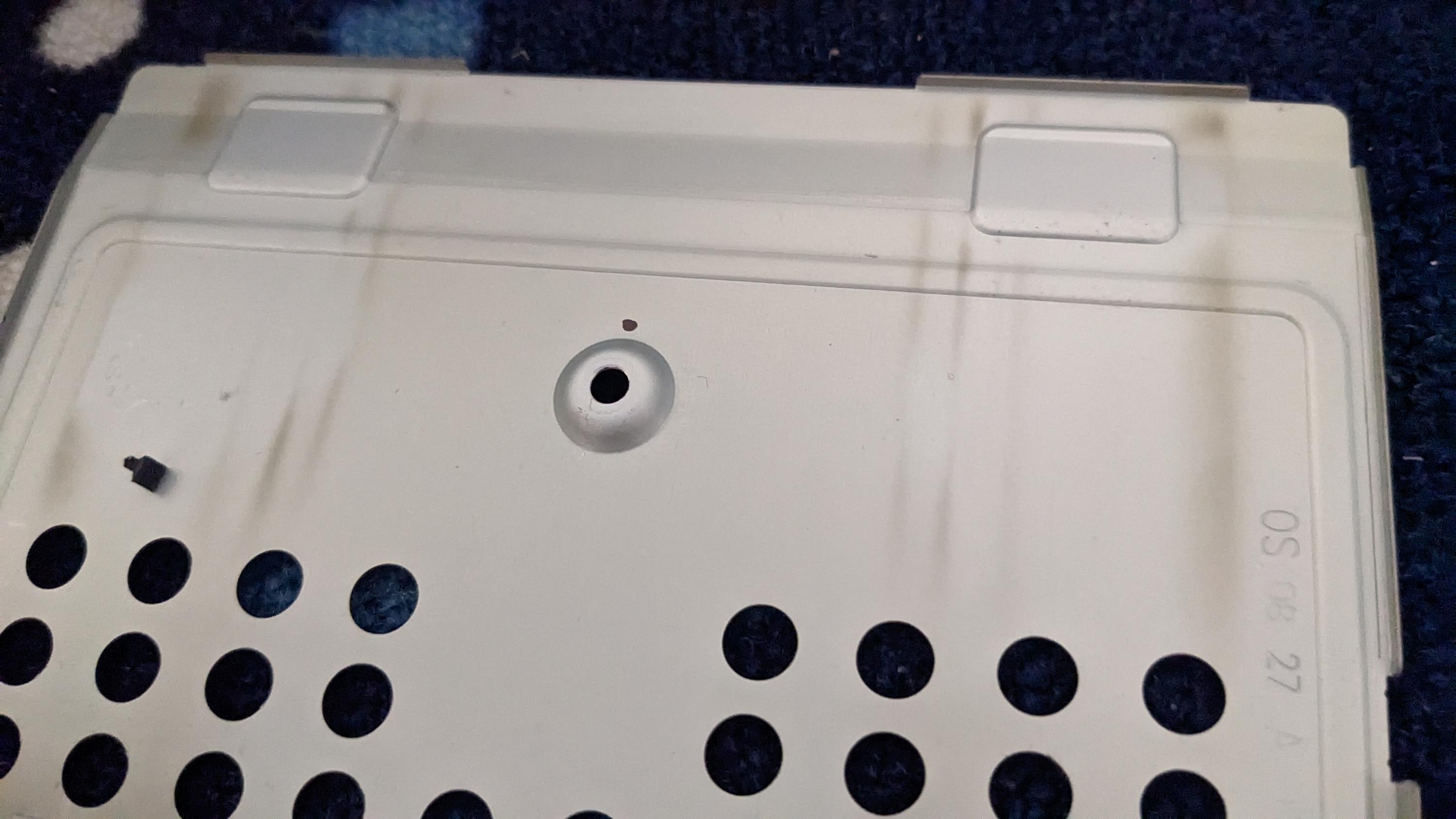

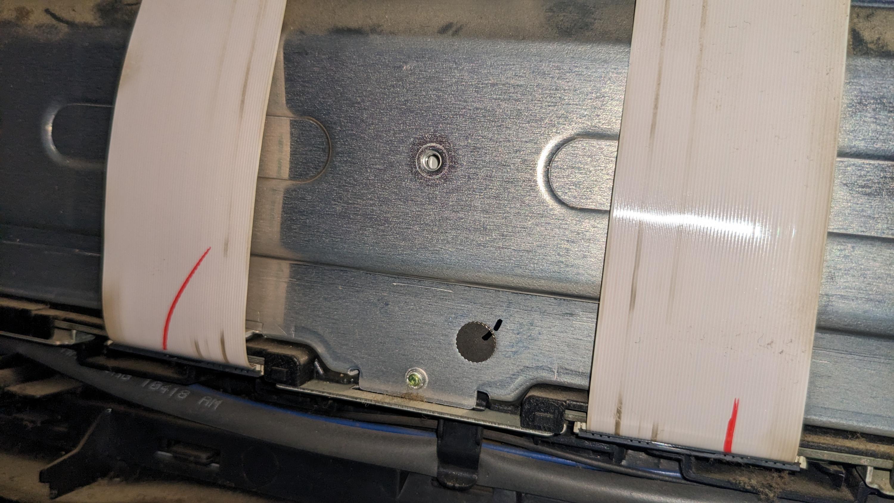

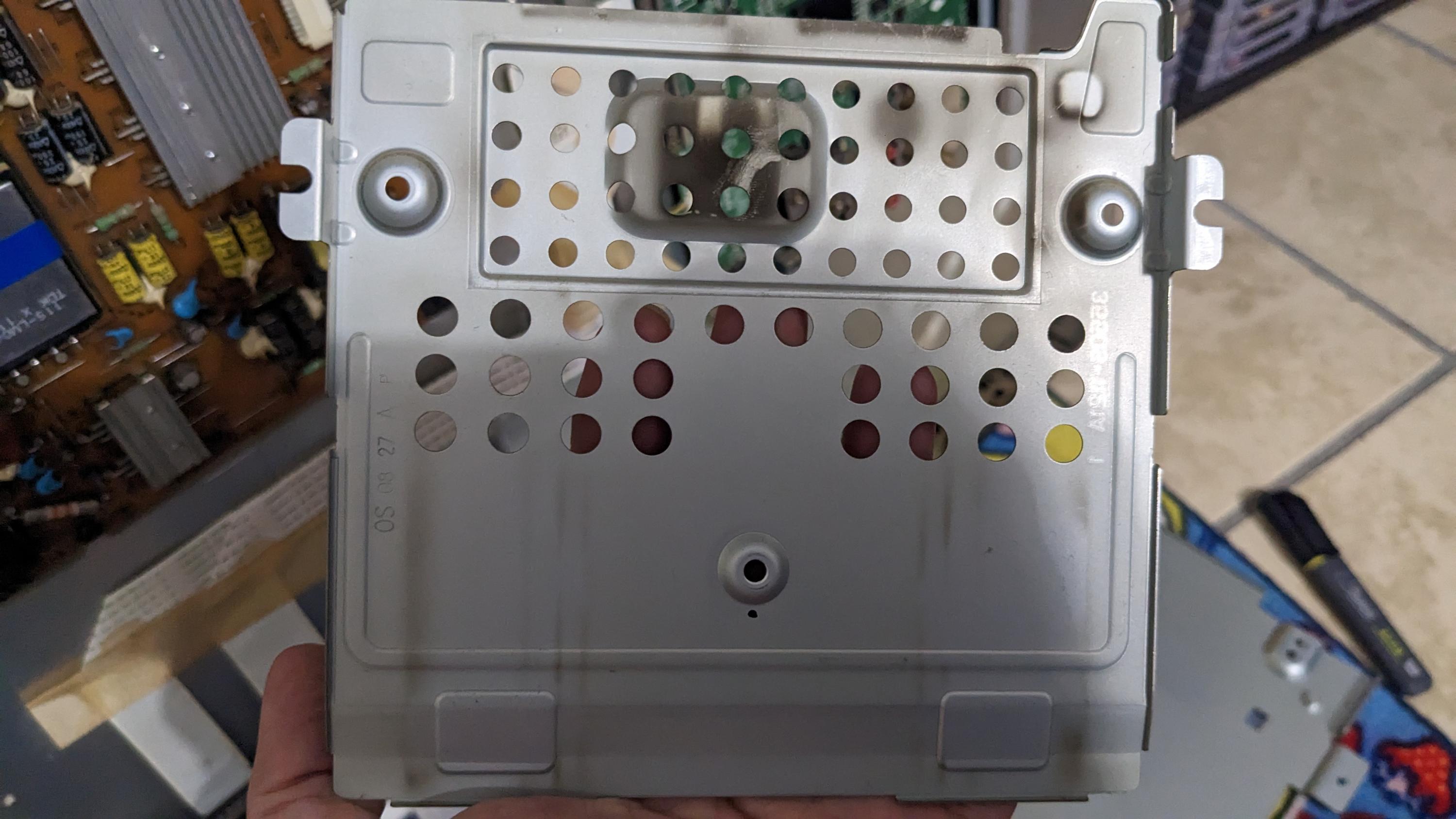

          EDIT: Just looked at the T-Con board and the shielding and ribbon cables look a little toasty to me. Photos attached.
