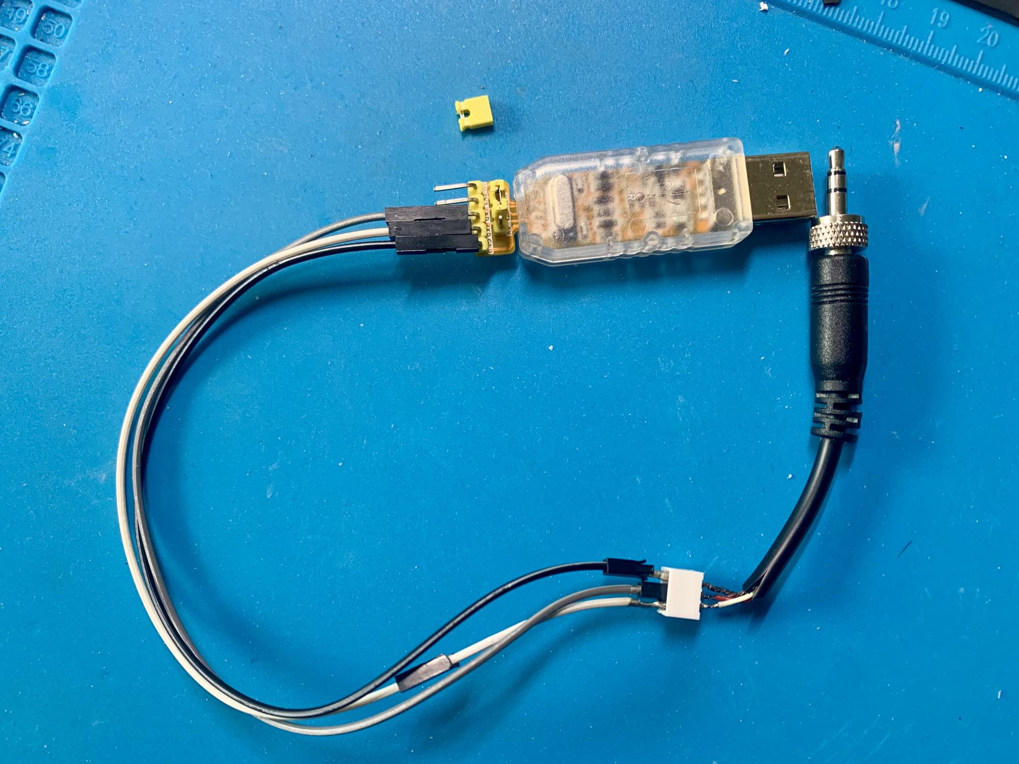

                        Require more diagnostic effort to be more certain. TV's user manual ( link ) shows a 3.5mm audio jack serial port (RS232c, pg11) for remote control. Maybe it will show boot up log msgs? But you will need USB to serial 3.5mm jack dongle. I built one here ( link )
                        Probably keep on doing other easy diagnostic efforts ( like @Diah's post #30 ) before taking the gamble replacing main board.

                            sorry formatting error and link was on top. Fixed now. Anyway link is here again
                            https://www.badcaps.net/forum/showpo...2&postcount=28
                            fastest cheap dongle ( link ) from Amazon with Prime in US. ebay 2nd fastest. AliExpress cheapest + slowest.
                            Can buy multiple dongle specs. CH340G is good enough. Set TXD/RXD to 3.3V (use jumper thats pointing up. Here is final product
