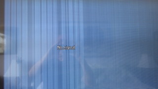

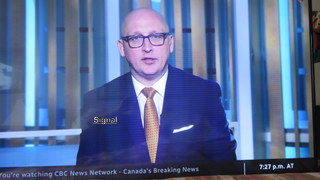

    LG 60uf7650 uj T-con or Main board Problem

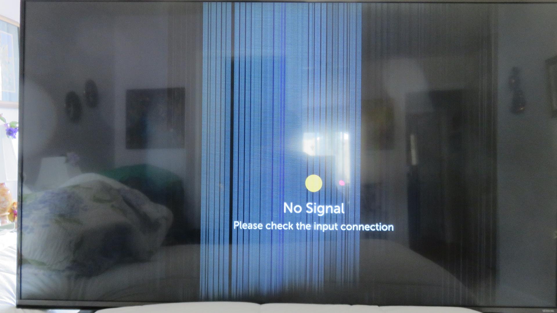

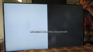

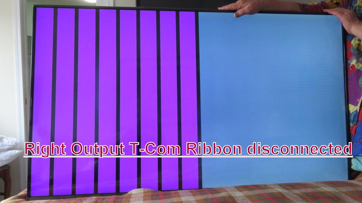

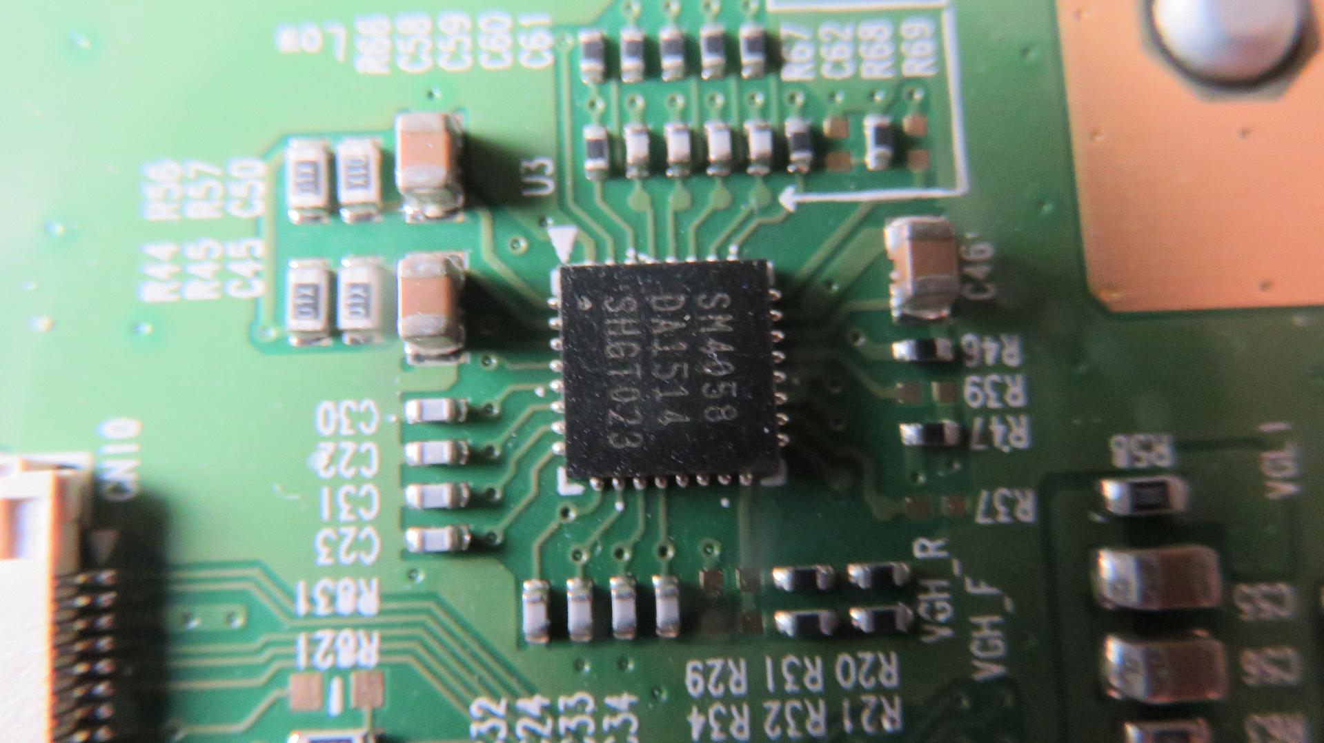

    I have a pic problem with my 60uf7650-uj
    PIc attached, would like you tell me what board to replace , T-com, Driver Board

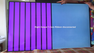

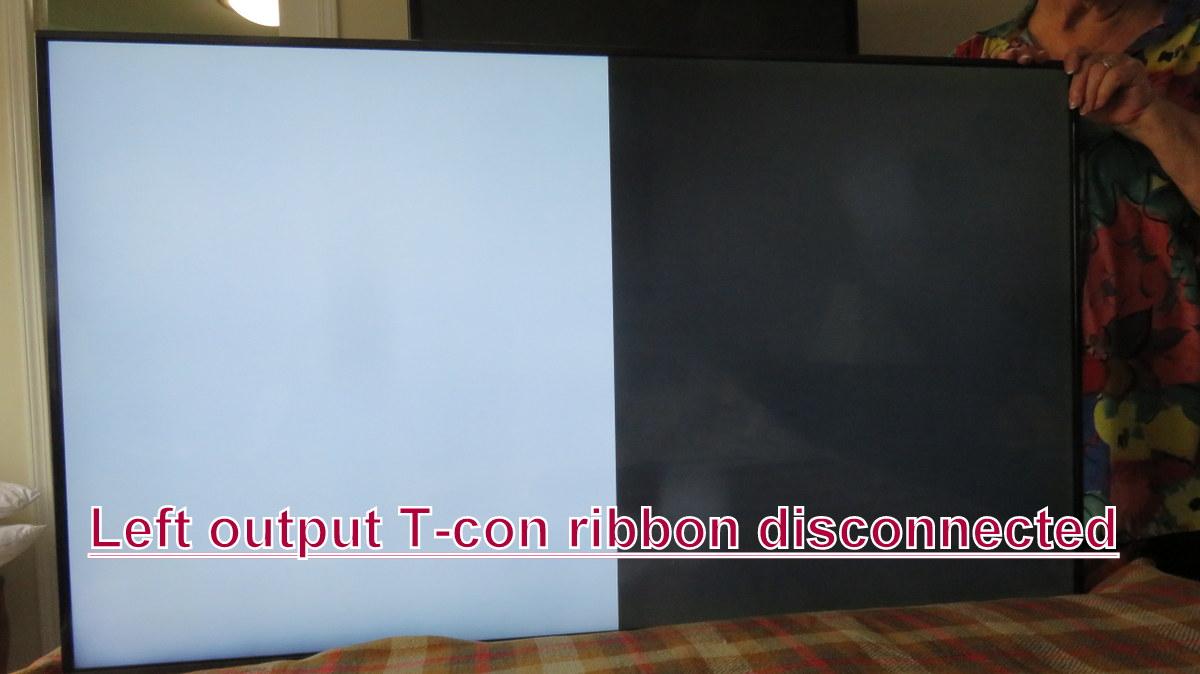

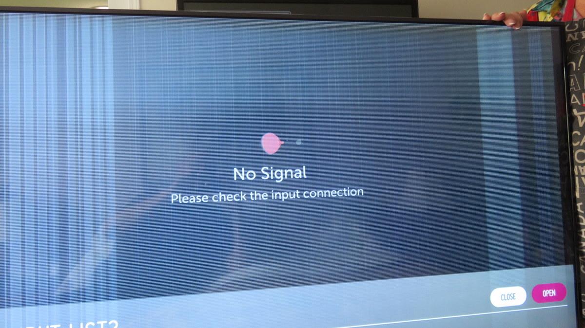

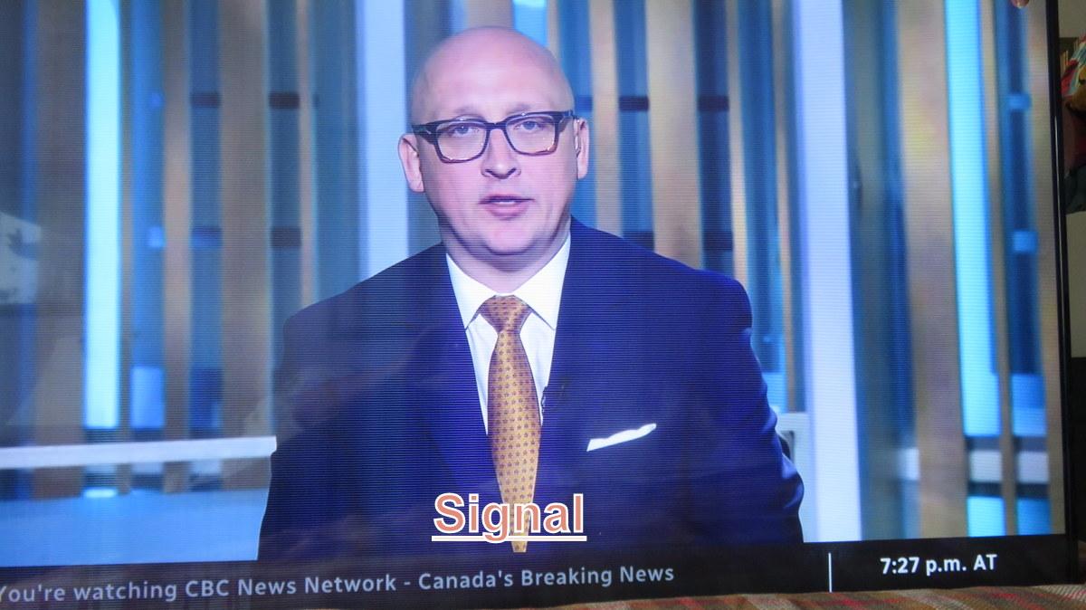

    I have disconnected ,one at a time, the Output sides on the T-Com Board and took a pic each time,
    and a pic with signal and without.
    Help
    Fred

    Re: LG 60uf7650 uj T-con or Main board Problem
    Defective panel, need tape masking method, but photos are small

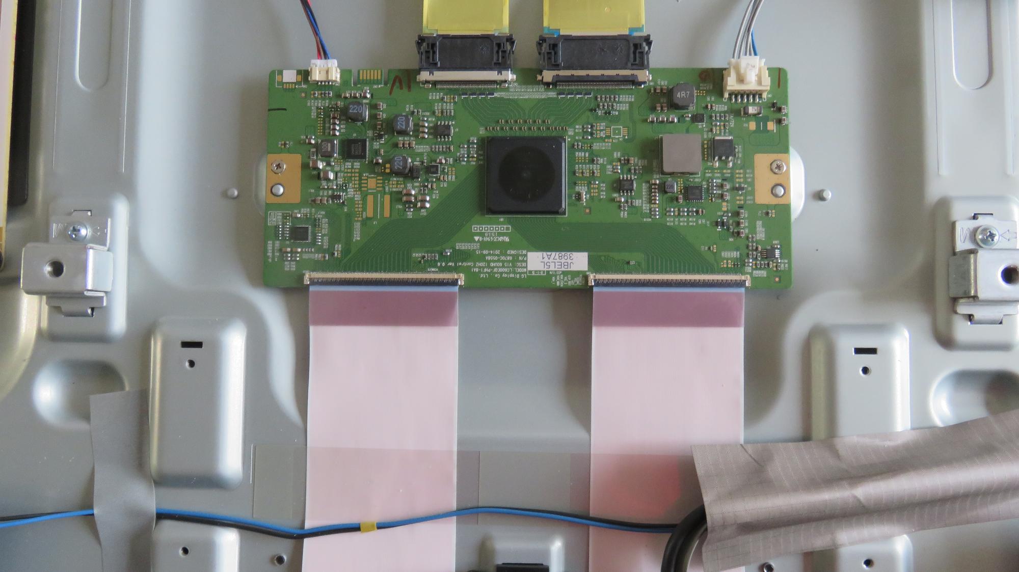

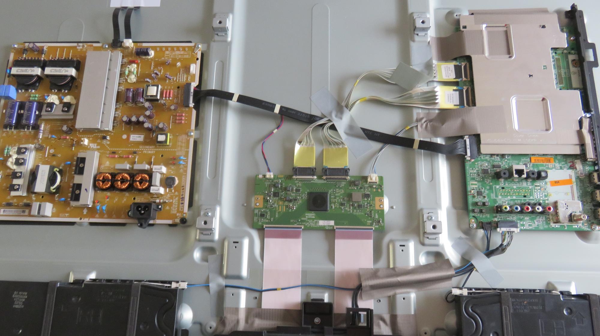

      show us please photo of the back side of all boards to see how they are connected and if there are separated T-CON or build in Panel.. either to see how many LVDS going out from MB 1 or 2
        Hi
        Thanks for the Quick Reply.
        Will add Bigger Pic and back Layout.
        The T-con Board is separate from the Main Board.
        The pic are with the output ribbon cables of the T-con board removed one at a time and pic taken and also with both output cables attached with out signal and with signal (labeled)
        Fred
          for me the panel are fine. the issue are with video buffer. T-CON and MB responsible on it, but because the T-CON look solo with out any heat sink i will go to replace t-con first.

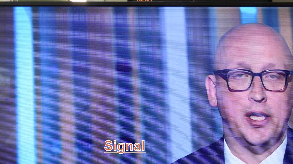

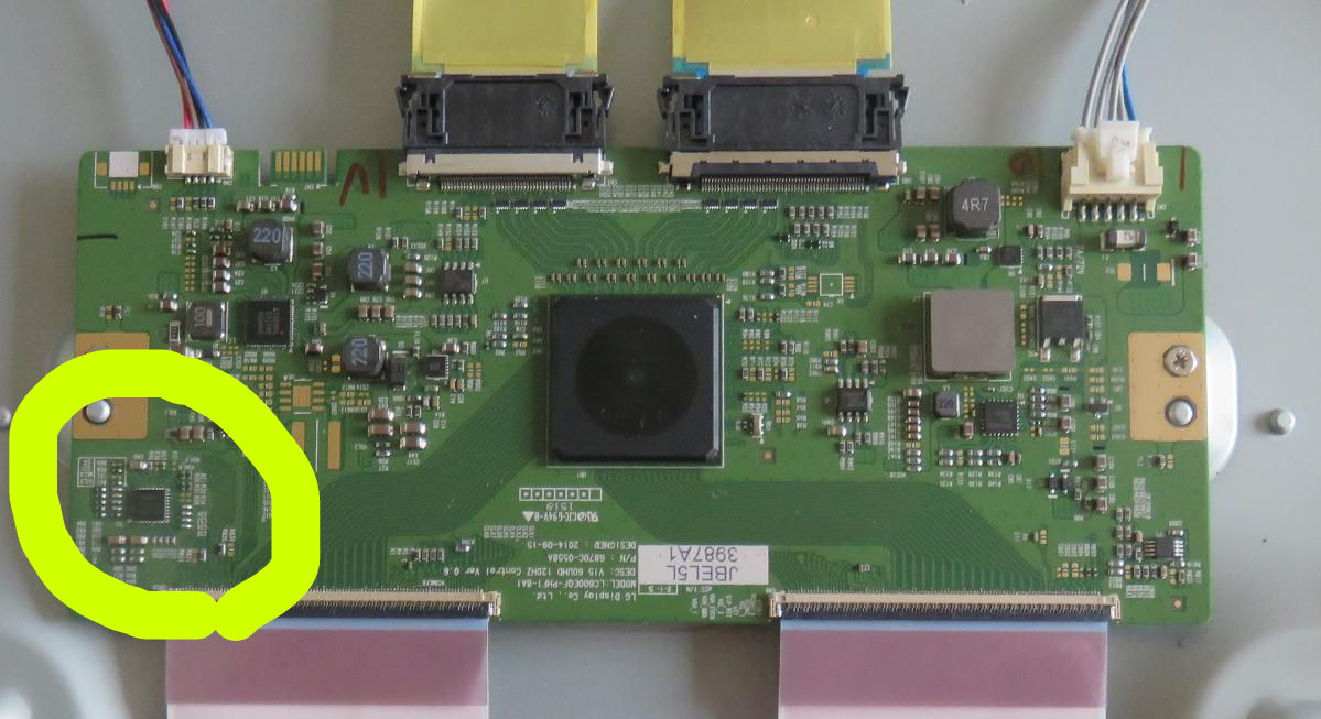

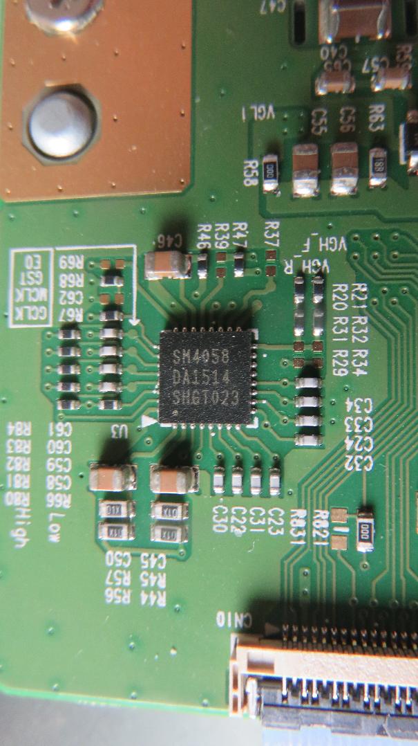

            Can you make a zoomed photo of this region? possibly take the board out and then outside under the sun
            Do you have a frequency meter or Oscilloscope?
            It's important that you remake the photo to the no signal image but at the whole screen

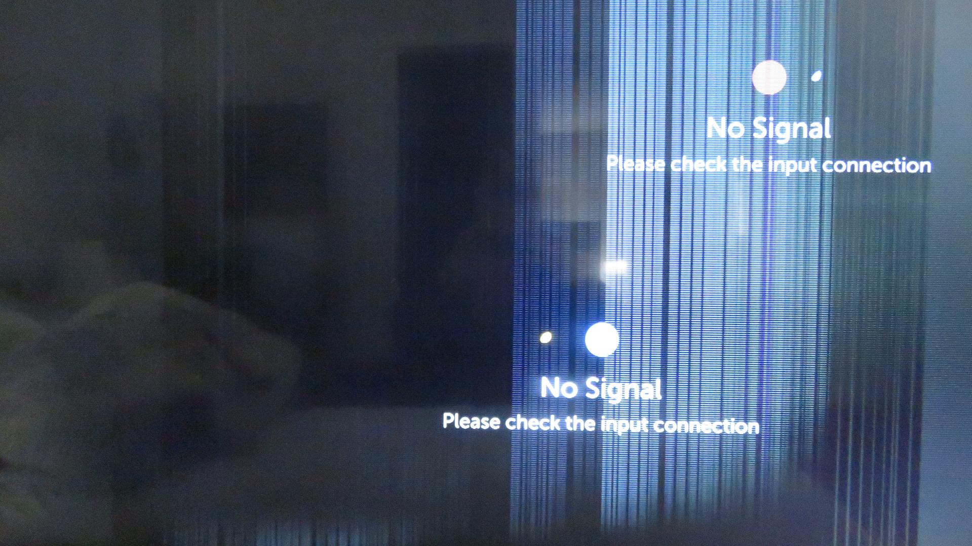

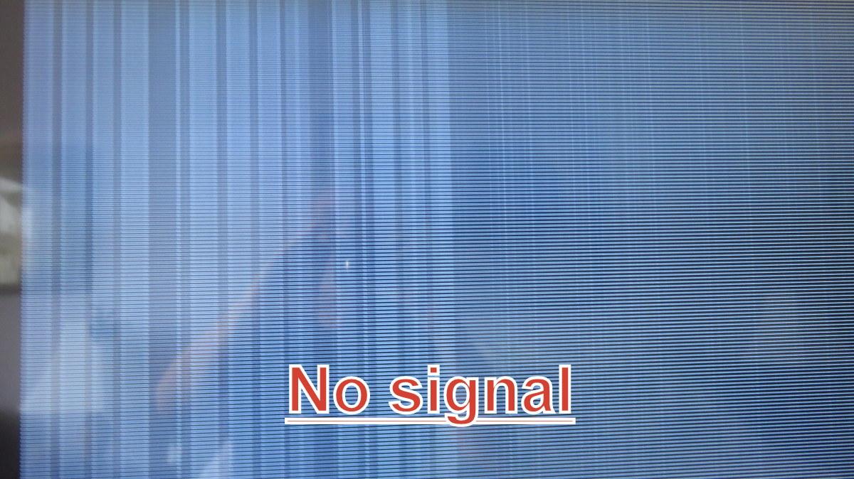

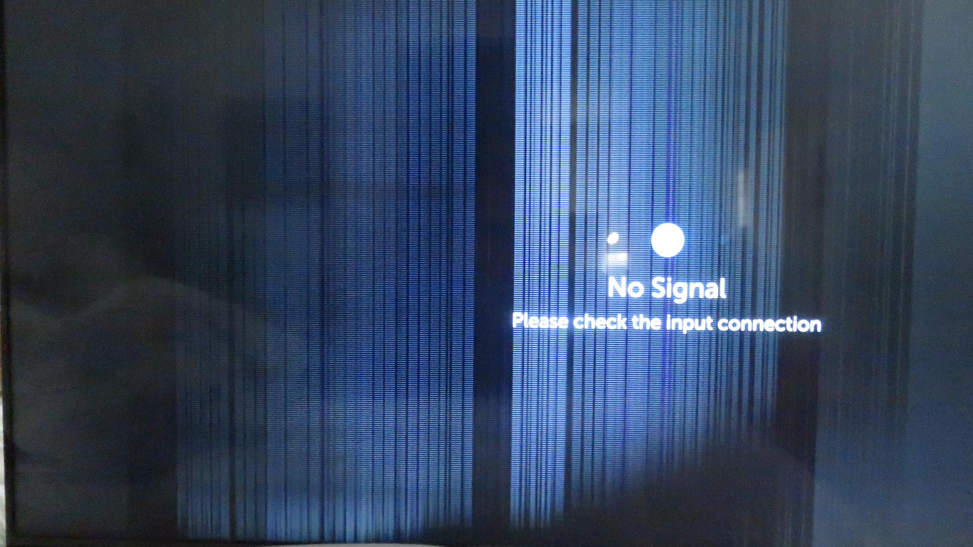

            • fredseesred
              • 9

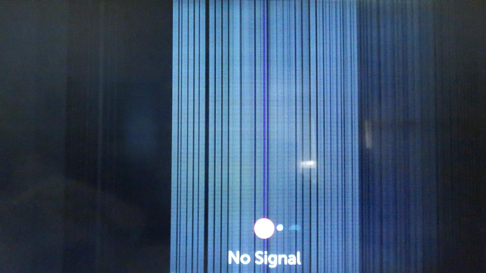

              Happy Easter
              Ive taken a few pic of the IC you circled and of the Screen with no signal , what I notice on the screen is that the Vertical light line junp from left to right very slowly.
              Yes I have a scope , not used it for a while, but will set it up and try what you suggest Davi.p
              Fred
                scratch the test points gclk, mclk, gst and test them for the frequency, them are clock signals, test also the voltage range if possible (swing)
