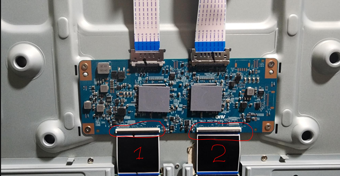

Hisense 65P7 Blank screen
  • lotas
    • Jan 2016
    • 4459
    • Russia
    Re: Hisense 65P7 Blank screen
    First, disconnect 1 cable and turn on the TV, see how the TV will behave and what will be on the image, then turn off the TV, connect 1 cable back and disconnect 2 cable and do the same.
