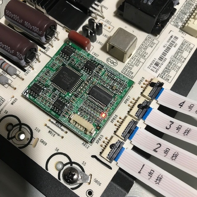

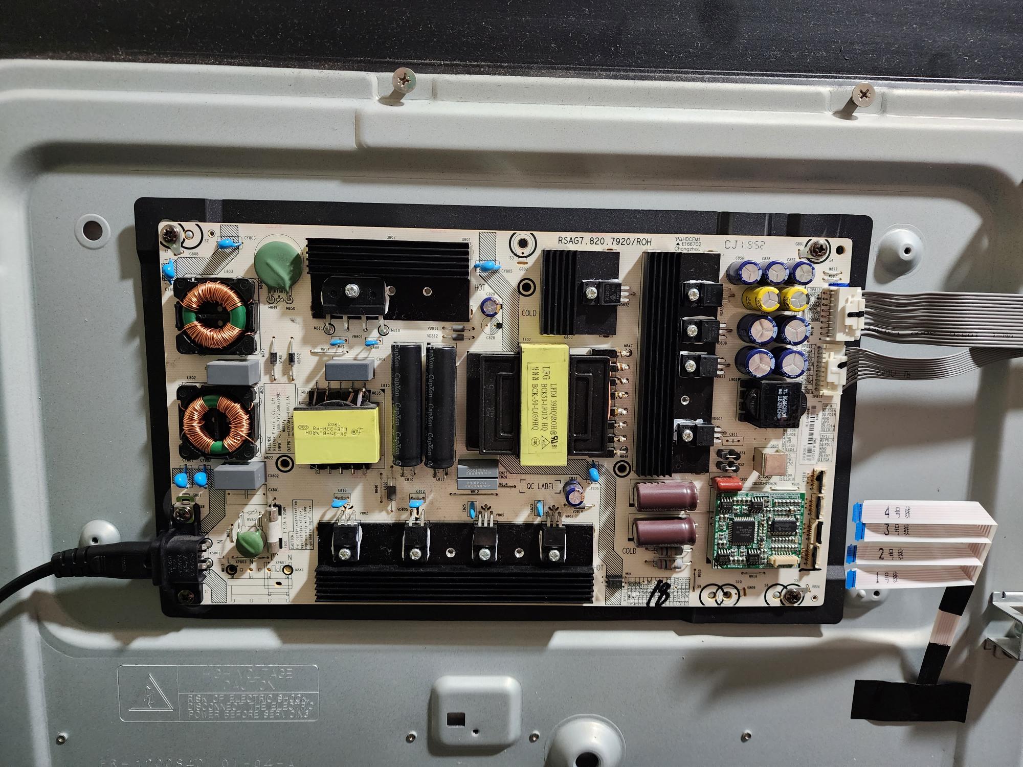

    I have a 65 inch Hisense 65P7 LED TV which has suddenly decided not to show any picture or sound.
    The TV still has the standby red light on when connected to power and when turned on either with the remote or power button, the TV screen will turn from Black to a dark Blue and the red LED will flash a total of 17 times and stop blinking.
    I have removed the back cover and with the TV turned on, the LED backlights are all working.
    I have noticed a hum and clicking coming from the Power Board and also a flashing red light (picture attached) on the Power Board close to the Back Light connections.
    I am new to this Forum and just trying to rule out which components will need to be replaced in order to have the TV working again.

    Re: Hisense 65P7 Blank screen
    Check all solder joints on power board, look them over very closely, reflow any that look suspect, careful not to bridge any, examples of bad joints there: https://www.google.com/search?q=bad+...ih=607&dpr=1.5
      Thank you nomoresonys.
      Given that there is 4 LED's in a row to which one is the blinking red light in the picture, will this represent which section maybe faulty?
      The detail next to this LED is 'VD701'

              Did some search for you but unfortunately can't find much info. But can share some observations
              TV has local dimming backlight array. Can't find how many. These backlights require more wiring than the non local dimming backlights. Obviously need to drive each LED individually. Individual LED voltage rails are on the LED strip with additional flex cable connecting the strips.
              There are total of 4x6 lines coming out of PSU to drive backlight array, printed label on PSU suggest LED flex cable has 4/6 lines for LED+ 2/6 is probably GND (V0?)
              I believe your picture shows only a single LED on the daughter board on the PSU near the LED flex cables. Maybe someone knows LED on means good or failure? I'd imagine the daughter board is a switch matrix to pump proper voltage and current to the individual LEDs. Main board surely calculate each LED's brightness and sent to PSU on the smaller of the 2 cables between PSU/main.
              Searched for the service manual and didn't find any. Googled result says high # of blinking standby light on HiSense usually means backlight. Don't know if true given many designs over many years.
              If know the local dimming wiring circuit, then maybe an LED tester can reveal which one/section is bad. Searched for LED strips for 65P7, didn't find any. Seems local dimming LED replacements are quite rare?

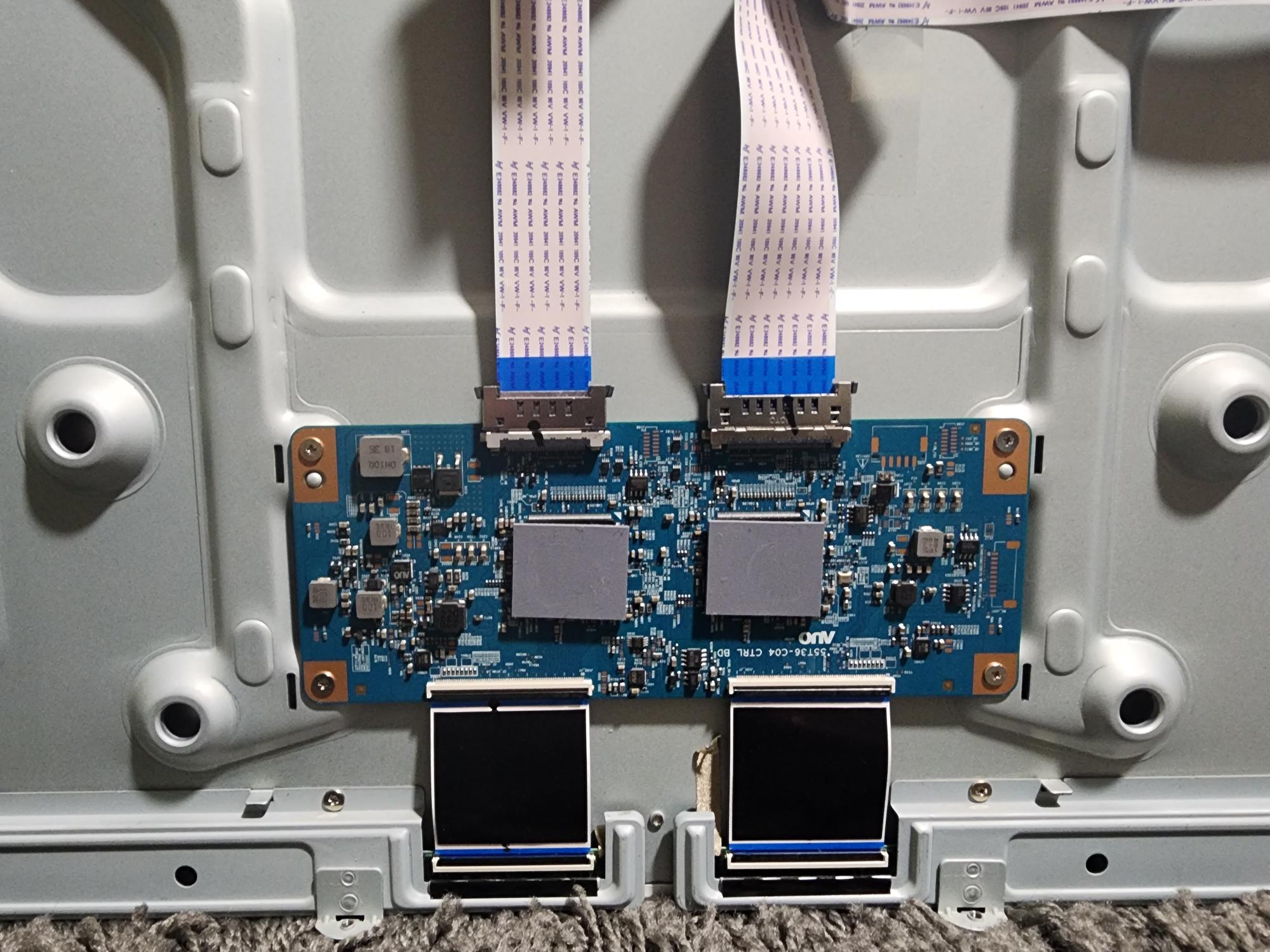

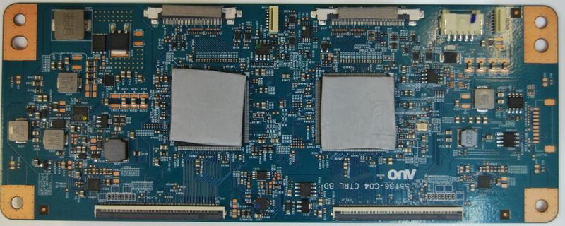

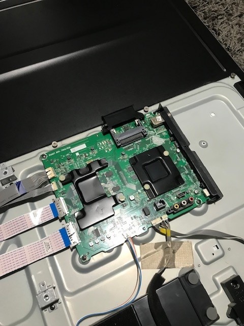

                                  Originally posted by Hisense65P7
                                  I have tried disconnecting the flex going from the main board to the T-con board one by one without any luck.
                                  You disconnected the wrong cables, you need to disconnect from the T-CON to the panel strips (left and right). You have two cables coming from the motherboard to T-CON and two short cables go out from T-CON to the left half of the screen and to the right half, these are the ones you need to disconnect in turn.
                                  Do you have such a T-CON?

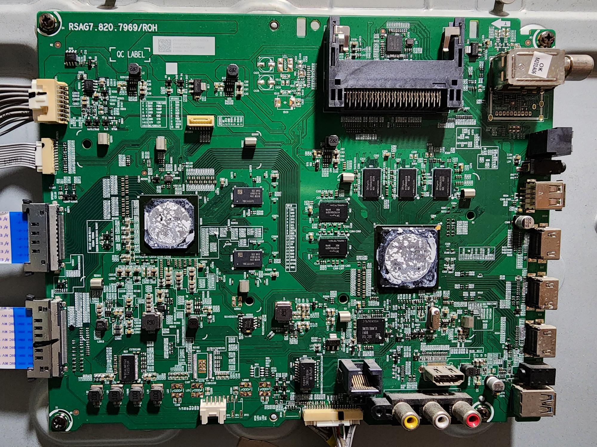

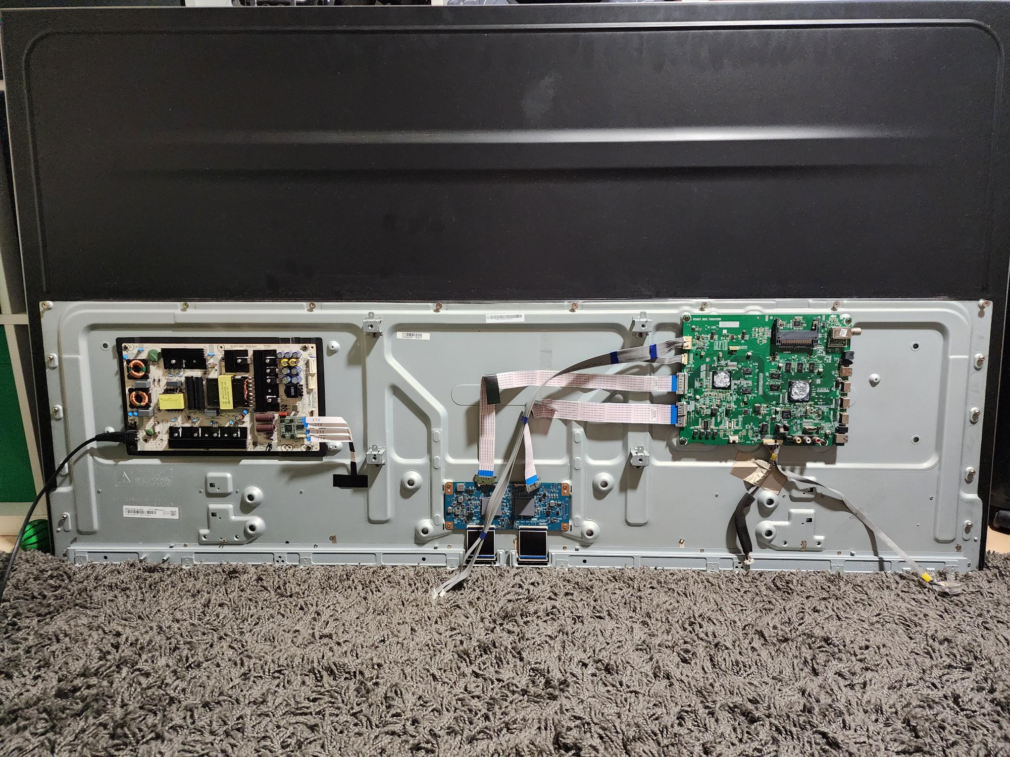

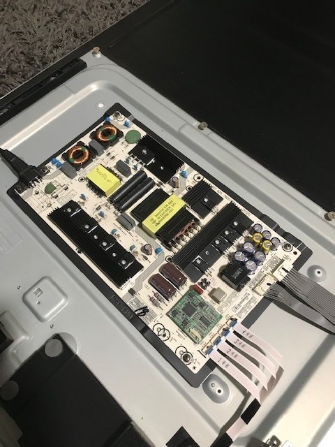

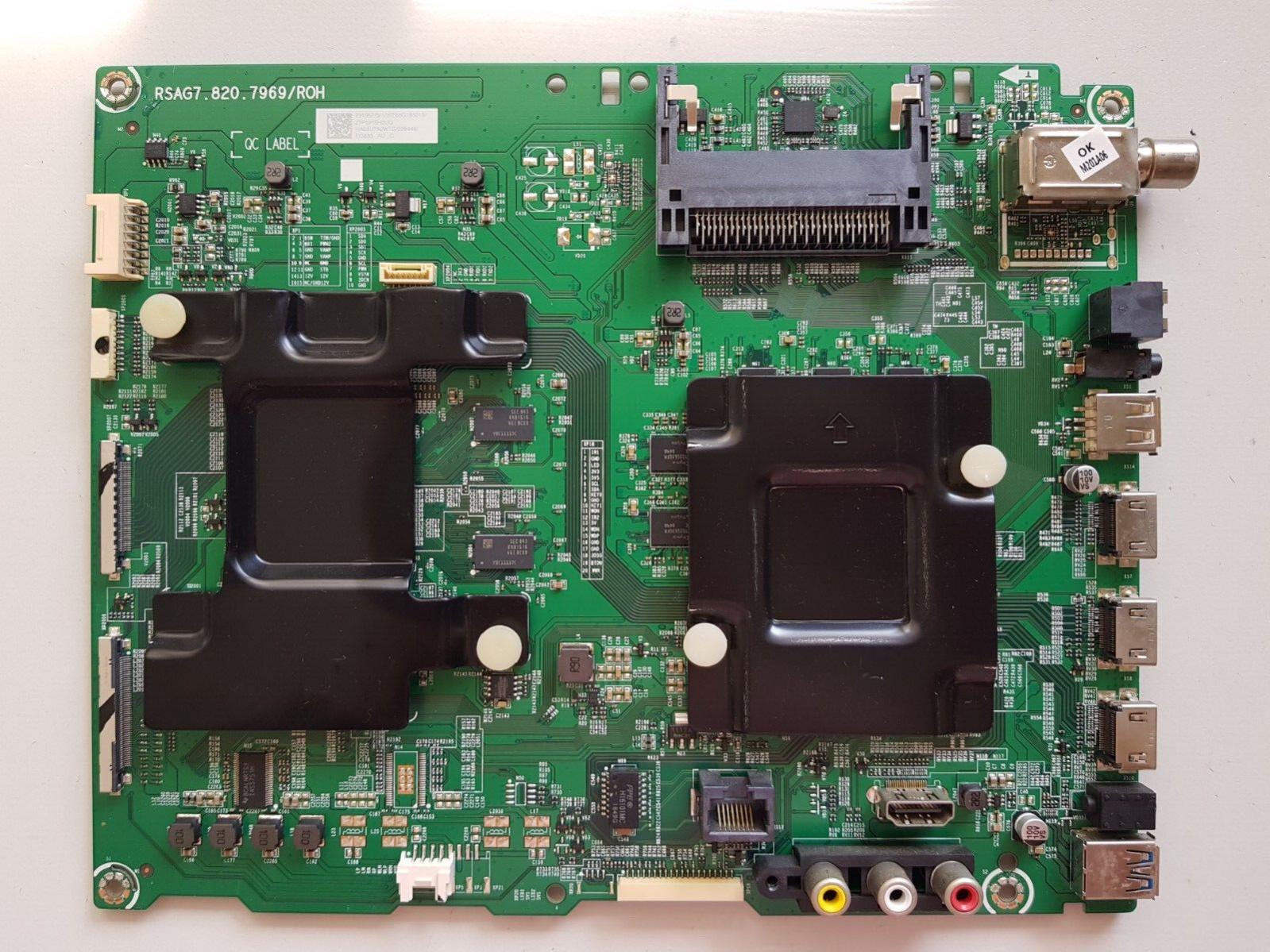

                                    @HiSense65P7, can you provide pics according to the following forum customs?
                                    • Pic of entire back of TV showing how boards are connected
                                    • Pic of each board in good lighting and highest resolution possible
                                    • Pic of model # sticker on back of TV
                                    • Hisense65P7
                                      • Mar 2023
                                      • 12
                                      Hi Howardc64,
                                      Not a problem. I will be able to take some more pictures tonight.
                                      Thank you lotas. I will certainly try this also tonight.
                                      • Hisense65P7
                                        • Mar 2023
                                        • 12
                                        Hi howardc64 and lotas,
                                        Please find attached pictures as requested.
