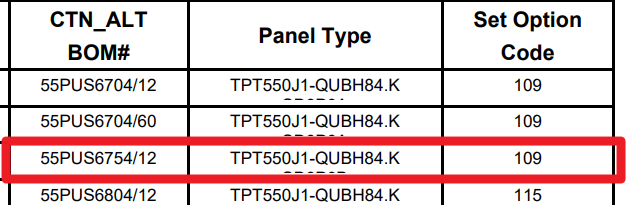

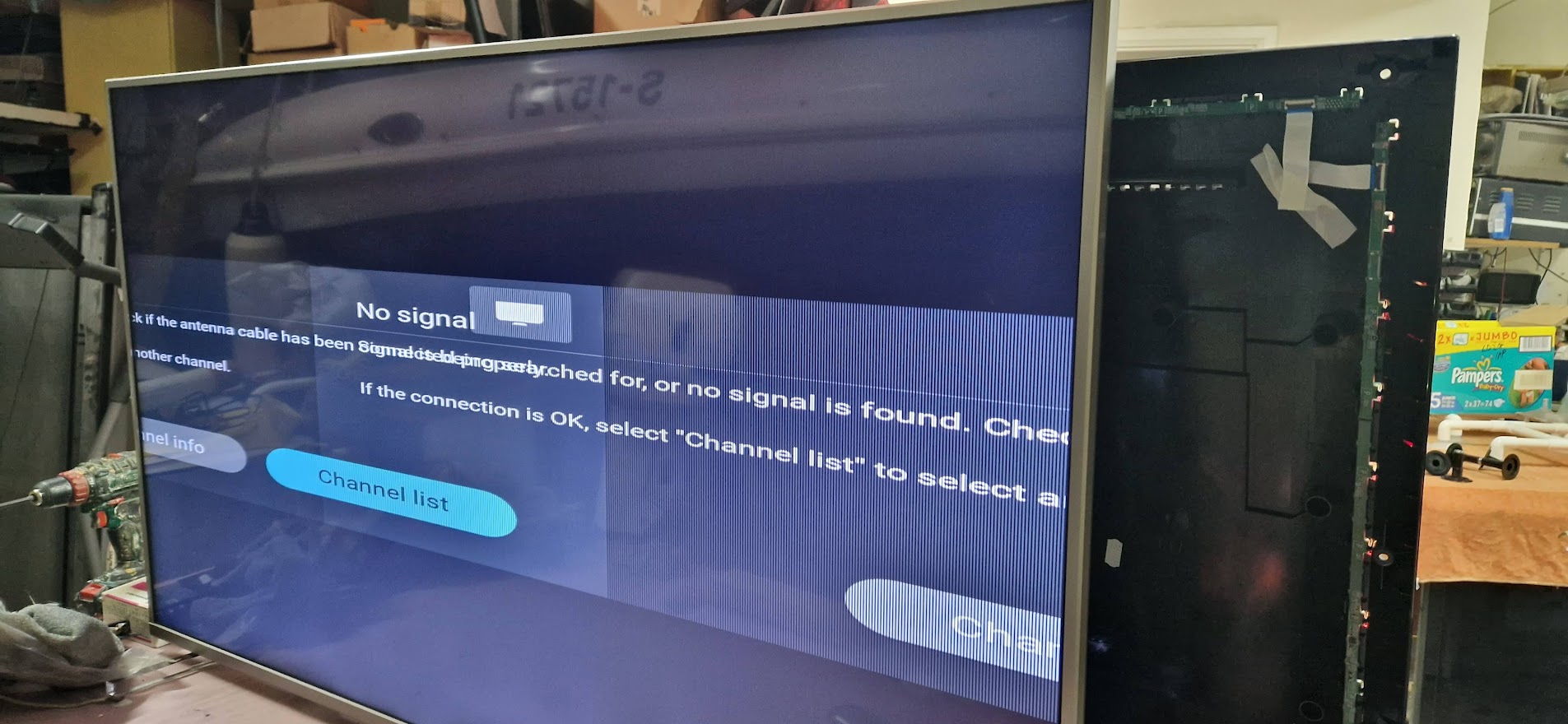

    I need to change the main board for this set. I have a new identical board but for a smaller model 43PUS6704/12 FZ3A
    The picture is not good and remote seems not to work either.

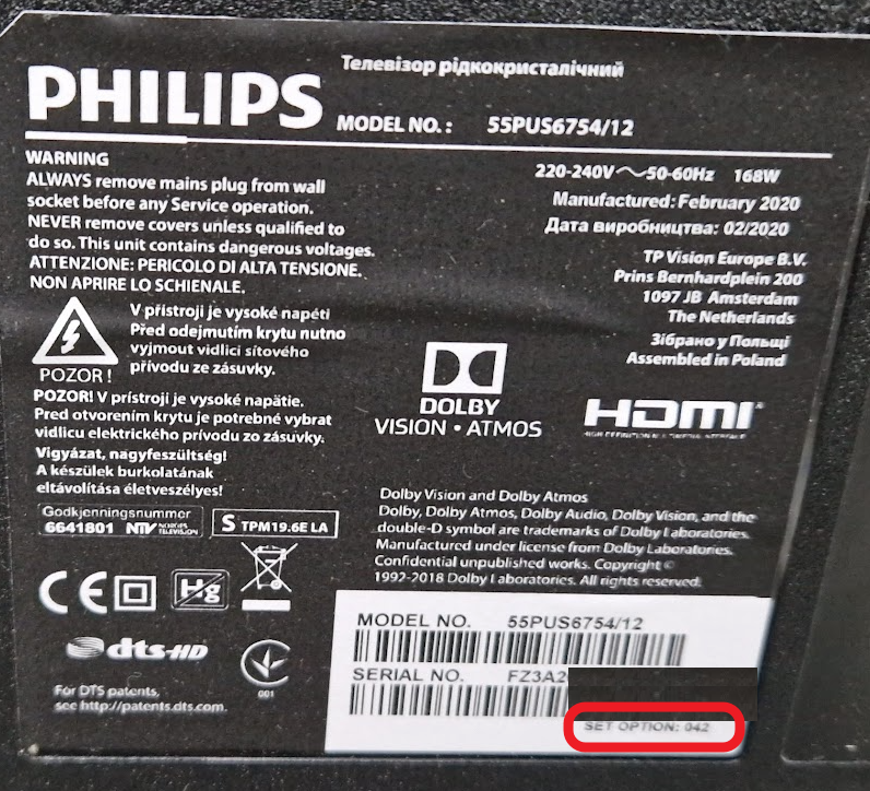

    The Set Option on the rear of the TV says 042 as shown in pic.
    The Service manual lists this model but with another screen with a mentioned Option Code of 109. I assume that I need to use the one on the back of the TV.

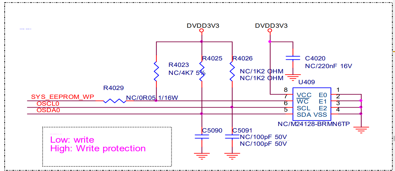

    The Manual mentions U409 Eeprom. Need to locate it and try to swap just in case.

    Check if the IR sensor is present on the small IR PCB, some IR sensors have bad soldering and some are gone.
    The setoption code is 042, enter 062598 HOME 042. If that does not work try panel ID 128, this can be entered via Factory mode. Home-1999-backspace.
    The list you have could be from a different FZ serie and is therefor not valid.
    If the setoption does not work it might be possible that the software must be updated to install newer NVM numbers so the tv can recognize the code.

      Option numbers:
      080 001 020 068 002 096 004 077
      235 002 022 004 001 008 128 000

        Re: Philips 55pus6754/12 FZ3A Set Option value dilemma
        The option codes you shared were spot on!
        Tks for your help as well. Issue resolved.
