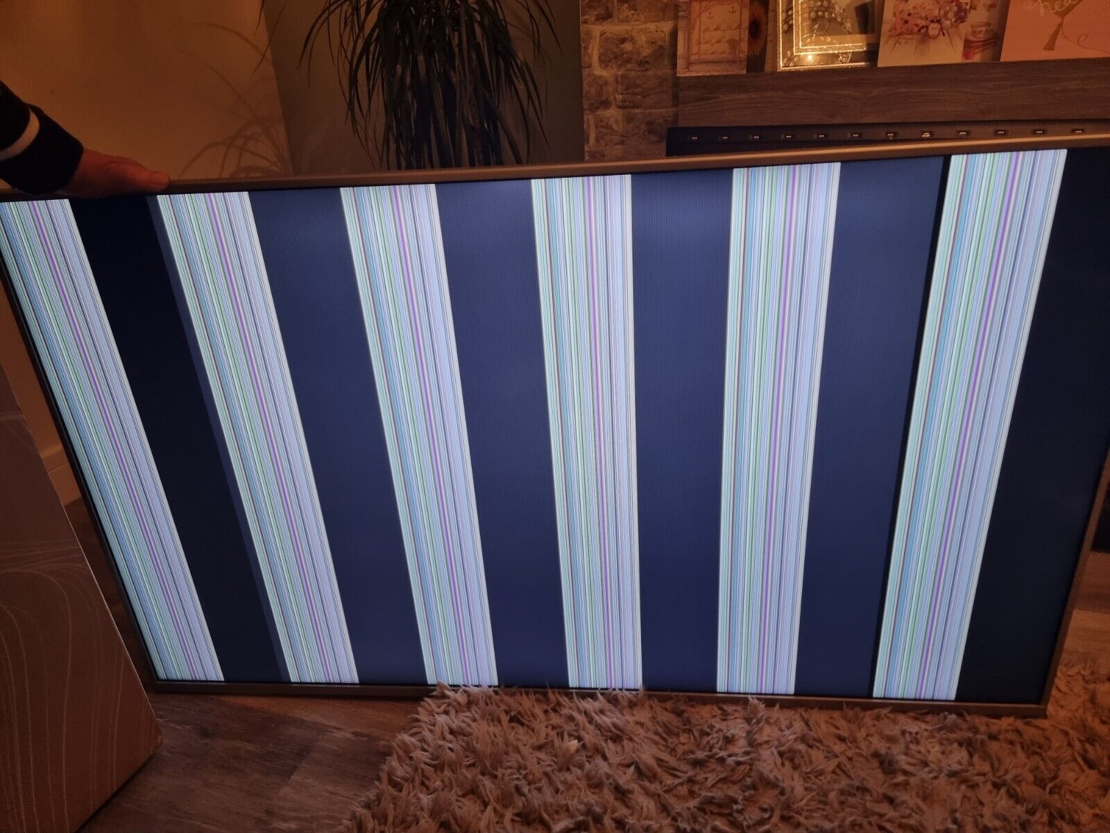

    Philips 55PUS6754 with lines after few seconds
    I have tried to replace TCON but it didn't help.
    The strange is that it shows Philips logo before the lines. Tried to cover some of the lines with tape on the ribbons to the screen but had no success.
    screen: tpt550u2-eqya3.g
    tcon: 6870C-0769A
    I will appreciate any help
    Many thanks
    Marek

    Re: Philips 55PUS6754 with lines after few seconds
    are you saying you replaced tcon and have the exact same display?
    • marekk
      • Mar 2013
      • 36
      Yes, I have replaced tcon and I got very similar lines after a few seconds
      • Davi.p
        Hobbist Tech
        • Sep 2009
        • 4367
        • Italy - Milan
        replace original tcon, first, then make clear photos of main board, frc board eventually, no flash, direct sun light..
