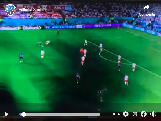

PANASONIC TX-L42EW6K sinc error
  • hugmax
    • Mar 2023
    • 8
    • Spain
    This tv I masked some lines on the right flex to block clk and now it has this problem.
    The left side is very slow to refresh.
    https://www.facebook.com/10000215023...1464075559576/
  • Davi.p
    Hobbist Tech
    • Sep 2009
    • 4466
    • Italy - Milan
    Re: PANASONIC TX-L42EW6K sinc error
    there's a problem with vgl/vgh lines, maybe bad contact, try first disconnecting one ribbon at a time of tcon outputs and notice wich one presents the major symptoms
