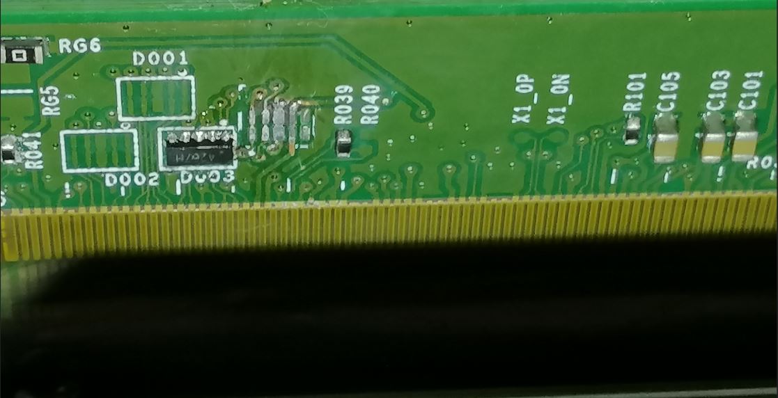

    I spent around 2 hours reseating and wiggling all the tcon and cof strips, but I cannot stop that pulsing loss of video on the last bit of the screen.
    I did note that when I had my finger on the spot where I removed the D004 chip, that I could feel voltage on my fingertips...like heat.
    I took out the solder iron again and used some more solder wick to clean the area, just in case there was still some solder residue etc, but that also didn't seem to stop it.
    I'm sort of reluctant to want to try to remove another chip, as if I do so, and it ends up with no picture etc, then there is no way I can put a replacement chip in it's place.
    Any suggestions please?
    So close...yet so far !!!

      I cleaned all my desoldering with isopropyl today...it is nice and clean, but unfortunately, I still have the little 3 second micro busrt happening at the bottom of the picture......suggestions please?

        #163
        Re: Hisense 50P6
        Well as per post 140, BOTH esd diodes were shorted, may be your problem too? you will not lose the picture if you remove the other one, just be careful not to damage anything during removal.

          #164
          Re: Hisense 50P6
          I wonder if it is the diode on the same end to remove, or one of the two on the other edge board?
          When I tested all four diodes, the one that was removed was the only one showing a fault.

              #166
              Re: Hisense 50P6
              I removed the diode chip next to the one previously removed, the tv is back to working in all areas again, no picture problems now.
